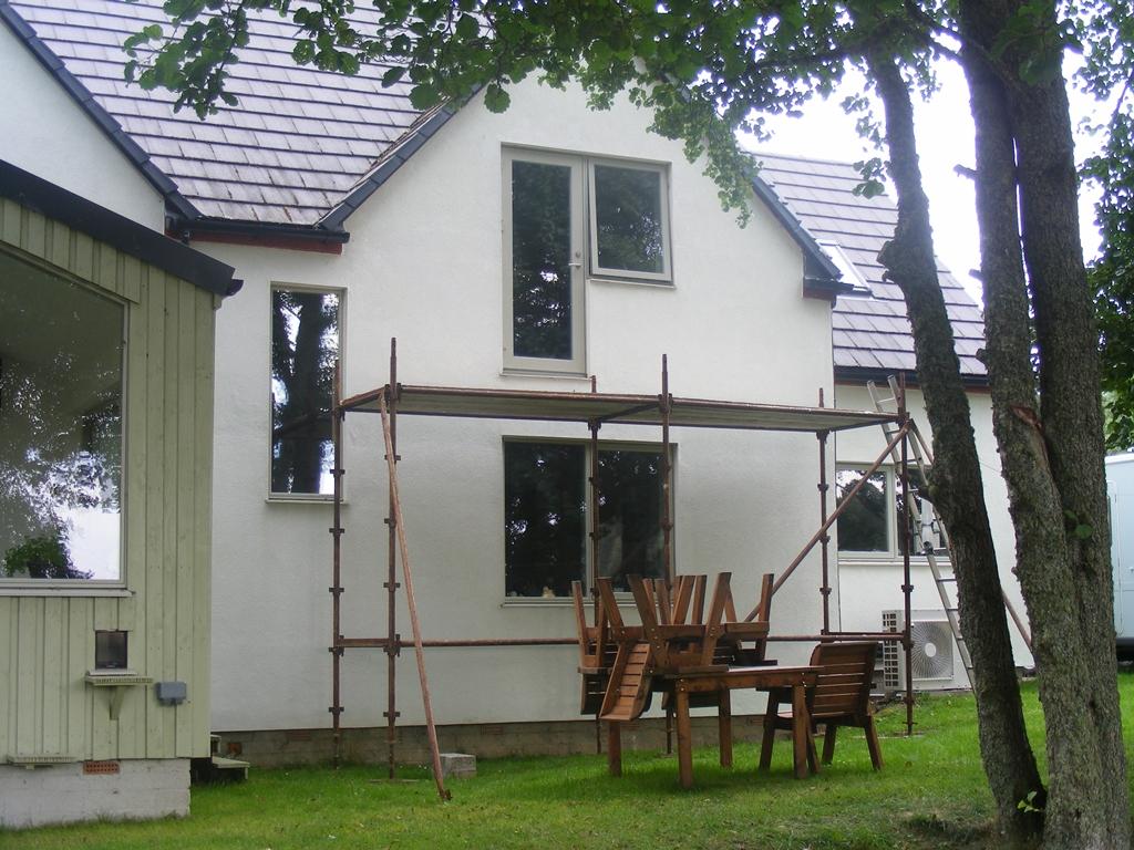

ProDave Posted September 3, 2022 Author Posted September 3, 2022 That's the balcony finished, it only took just over an hour. Only joking in case anyone thinks I am serious. The actual balcony will be a little less wide than the scaffold, it won't overlap the landing window, and a bit deeper than the scaffold, I may later put another bay in front of that if I need more working room. Now I am seeking some ideas. I would like the space under the balcony to be pretty dry, i.e. I don't want water dripping through the gaps in the decking planks. so either some form of waterproof sheet under the deck boards (with a spacer?) or does anyone sell interlocking composite deck boards that click together like some flooring and make an almost watertight surface? And thinking of ideas for the banister and our thoughts are turning away from glass towards stringing it with stainless steel "yacht rigging" wire, but not wanting to pay chandlery prices. Does anyone know a source of the wire and end fittings at more of a consumer price aimed at this sort of application?
