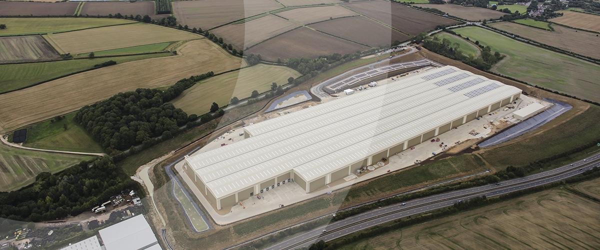

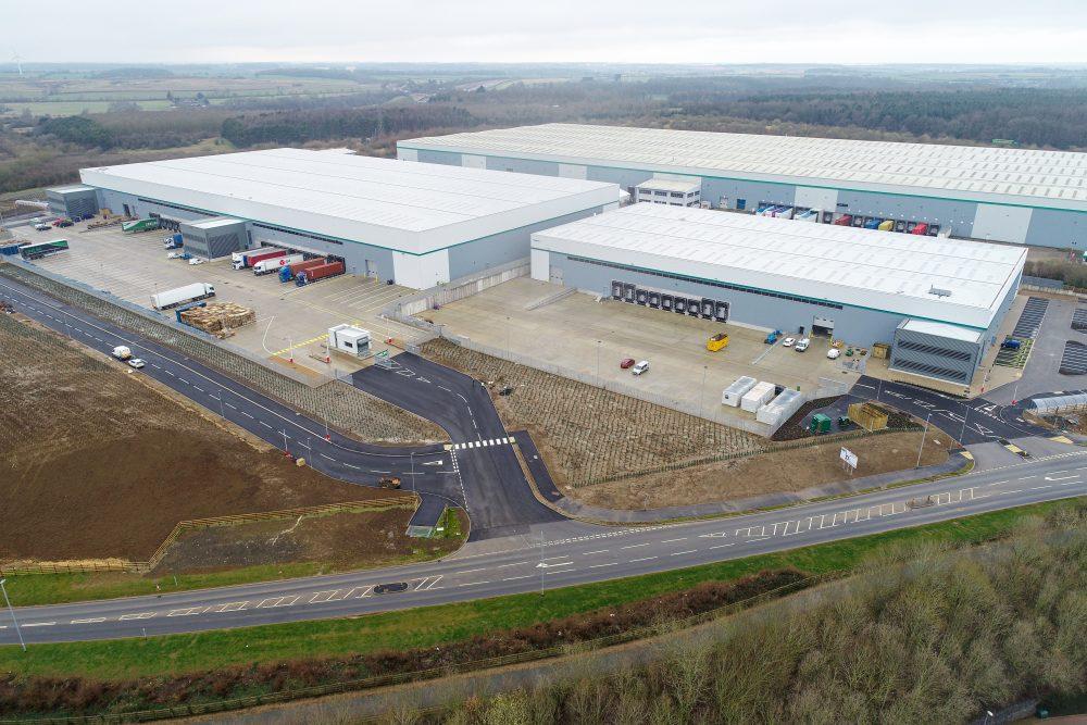

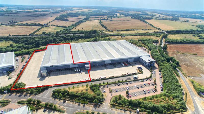

Posted
All over central England we have been build massive warehouses in recent years. None that I can see have pv on the roof. Some are millions of square feet. Then up the road there are PV farms being built on agricultural land. Madness.

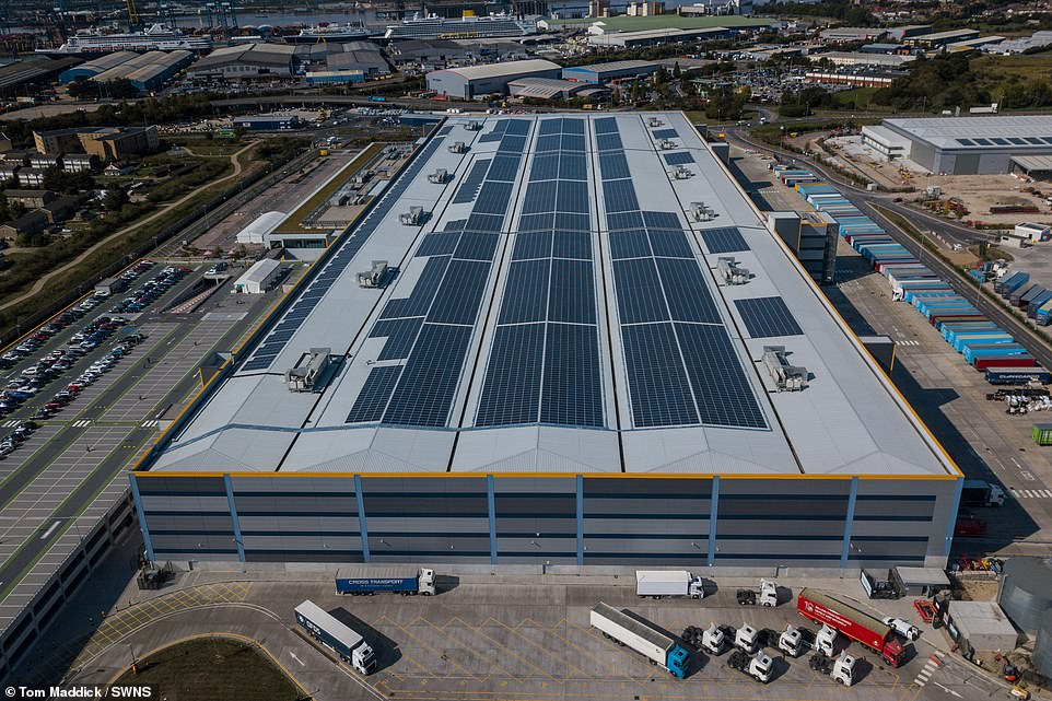

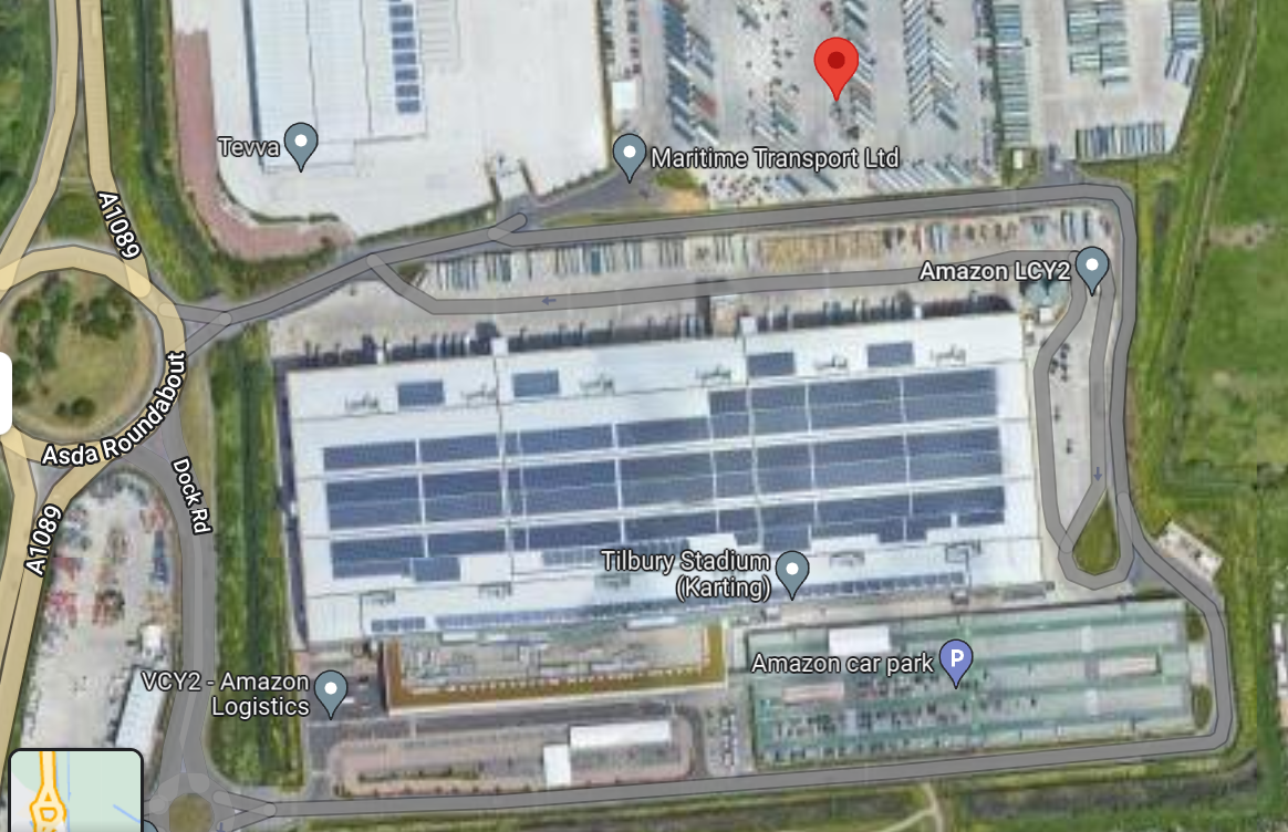

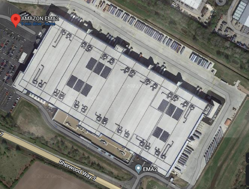

Posted
I'm not sure if I posted it here, but Exeter has car parks with panels for the roof, and here is a recent Amazon warehouse in Tilbury with a 4.83MWp install.
That's 11,500 solar panels.
My local one seem to have some, too:
