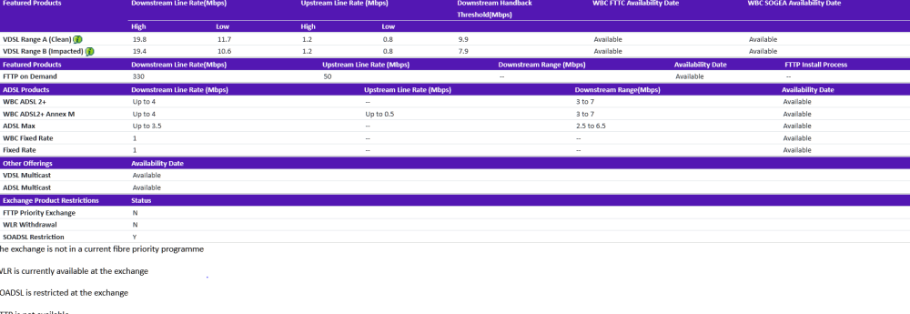

ProDave Posted August 13, 2022 Posted August 13, 2022 We have BT wired copper ADSL broadband at a staggering 3 MBPS connection speed. We also have a BT landline rarely used but nice to have mainly for incoming calls. Although slow, baring faults it has worked well. But daughters boyfriend has moved in, he is a computer game junkie and now his XBOX seems to be almost continuously downloading stuff leaving the rest of us with little or sometimes nothing. I have been tasked with pricing an alternative on the basis the BF will be expected to pay the additional costs. Now there is an alternative (only one) that is a local company that provides broadband via a wireless service. It is basically a series of point to point services, with some houses hosting a relay station. The system is already installed in this locality and we have the required line of sight to the nearest dish in a nearby neighbours garden. This wireless service offers broadband speed of up to 50MBPS. I will be questioning them (and neighbours that are already using this service) to see what real world speeds are actually like. And it will cost about £10 pm more than BT (when you include a VOIP landline as we would completely dump BT of we choose this) I have resisted switching to this service as in a way, I wish they were not there. By offering this private network in my mind they have let BT / Open reach off the hook for providing a decent service and investing in the network. We know there is fibre at the top of the road and it would not be difficult to for them to provide a fibre cabinet at the top of the road and provide FTTC service to all the houses in this road, but with only a few of us left using BT now, that is unlikely to happen. But part of my concern is if we upgrade to this and say get 40 MBPS how do I know this infernal XBOX won't just carry on it's never ending download at that speed and still leave little for the rest of us? Obviously I have technical questions to ask of the provider like can their router throttle the speed to one particular device? Thoughts please from anyone that has uses a non BT / OR private wireless broadband provider?

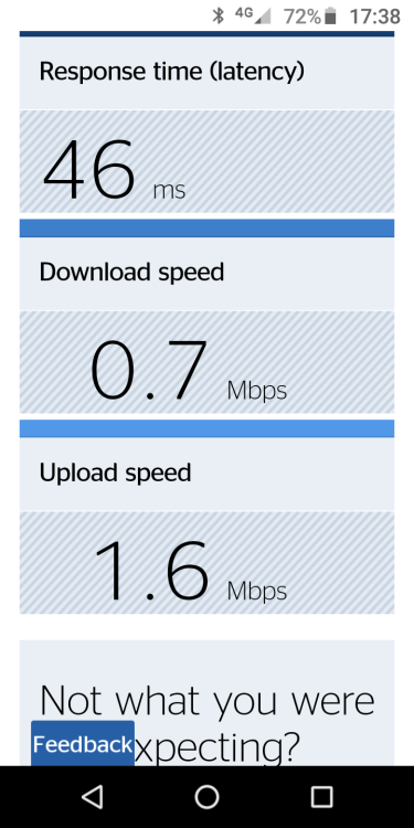

ProDave Posted August 13, 2022 Author Posted August 13, 2022 5 minutes ago, dpmiller said: what 4g options do you have? None, or at least nothing useful. 2G from O2 and Vodaphone and weak / slow 4G from EE but even if they gave a decent signal with decent speed there is no sensible unlimited data package from them.

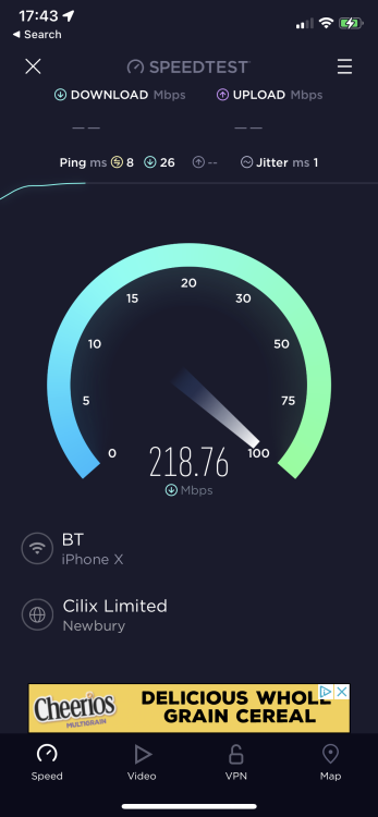

pilgrim Posted August 13, 2022 Posted August 13, 2022 Have a look at Onestream, https://onestream.co.uk/ (if they operate in your area) I switched to them and they organised an open reach engineer to upgrade the existing copper connection at the fibre box so we have almost fibre speeds at the house over the old copper wire. Average around 60Mbps I dont understand how this black magic works but BT insisted it couldn't be upgraded without paying them a lot of money yet Onestream sorted it all out at a cheap price!

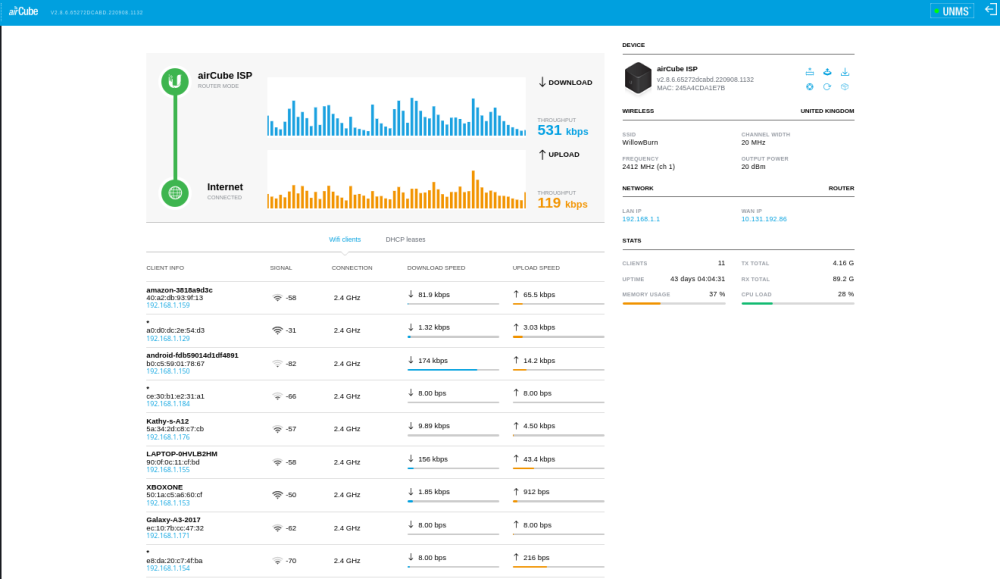

kommando Posted August 14, 2022 Posted August 14, 2022 12 hours ago, ProDave said: Thoughts please from anyone that has uses a non BT / OR private wireless broadband provider? I can only give my route to getting a good service, it may or may not work for you. 1. ADSL via string, 8mbs when dry, nothing when wet and always expecting issues. 2. Stage 1 upgrade, got a dual WAN Draytek 2925 (obsolete due to firewall speed limitation of 300mbs so who cares) for £70 off ebay. This allows you to connect to 2 services and load balance the 2. To a user you do not notice unless you are downloading a a single string file which is very rare today. The 2925 will also allow you to add a phone hotspot as a 3rd WAN. 3. Used the 2925 to line balance the ADSL with 3G hotspot giving some 25mbs. 3. Got a local wireless connection of 25mbs and line balanced it with the ADSL to give 33mbs. The local wireless provider was not really interested once they got you signed up, every time they added a new user the bands clashed so my 25mbs became 10mbs until I rang them. This became a fortnightly call so dropped them for solution 4. 4. To replace the Wifi I got a 4G router with directional antenna and line balanced it with the ADSL, total 60mbs. Signed up with Sipgate and tested the service with a new local number. Once the test showed it could work I then ported my old landline number to Sipgate and this automatically ceased the landline and ADSL. 5. Got a second 4G router with antenna pointed at a different mast and line balanced both 4G's for 120mbs. If one mast goes down the other takes the full load. 6. Fibre is due in next 3 to 4 months, one 4G contract lasts until Sept next year, so will drop one and keep the second as a backup to the fibre and then drop that leaving Fibre as sole link but can always use a phone hotspot if needed.
