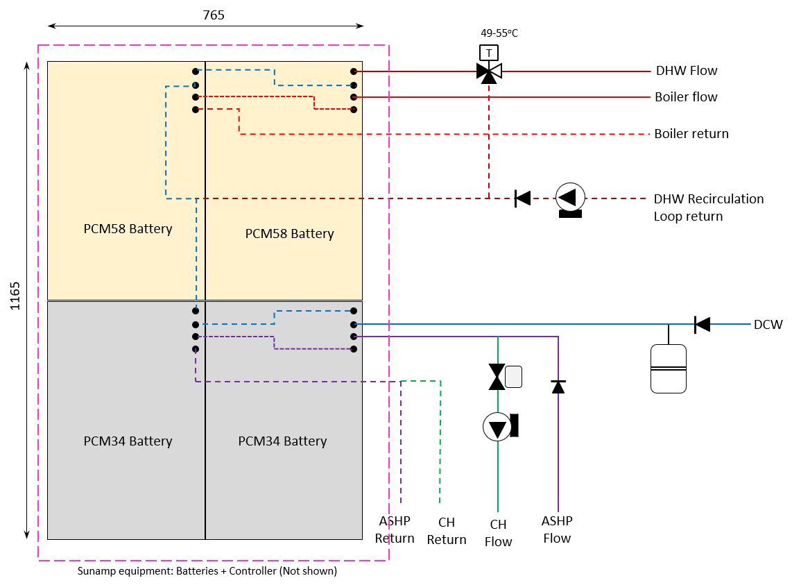

Nickfromwales Posted February 26, 2018 Share Posted February 26, 2018 18 hours ago, le-cerveau said: The PCM34 batteries will be charged by my ASHP at around 40oC and the PCM58 batteries will be charged by the boiler at around 65oC. The UFH will take a feed from the PCM 34 batteries (same input as the ASHP). DHW will be pre-heated by the PCM34 Batteries then the PCM58 batteries. Effectively the PCM34 batteries are doing the same as @JSHarris buffer and the PCM58 batteries as is SunAmp PV. plumbing diagram below: Ok. With so much storage at the higher cell range, do you really think you need the gas boiler? Already having the ASHP would have made me kick the gas into touch for sure. Do you have PV? Also valve 'T' ( 49-55oC ) is that a TMV? Ive designed two so far with a HR pump but ive decided to pulse heat into the hot loop ( via a stat on the hot manifold in those specific cases ) rather than run for any duration. Link to comment Share on other sites More sharing options...
le-cerveau Posted February 26, 2018 Share Posted February 26, 2018 The boiler is already in, temporarily used as a heat source, the ASHP not yet installed. I know it is belt and braces, and it will stay for now, but in the future I may re-evaluate it. I have 9.25kW of PV. Yes the 'T' for Thermostatic, is the outlet valve as the units I have don't have a TMV like the SunAmp PV's. The intention is to run an intelligent circulating pump such as the Grundfos Comfort. Link to comment Share on other sites More sharing options...

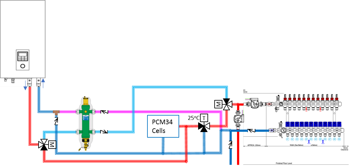

Nickfromwales Posted March 7, 2018 Share Posted March 7, 2018 One observation here would be the non return valve on the ASHP flow. I think that would need to be a 2-port motorised valve as I think theres a strong chance of the CH flow pump sucking water through the NRV and cycling heated water through the ASHP when its not in use. Or use a 3-port W-plan diverter valve to tee the two pipes together. then its one or the other with the same result as 2 x 2-port. Link to comment Share on other sites More sharing options...

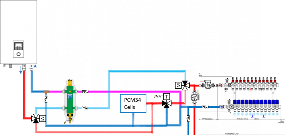

le-cerveau Posted March 7, 2018 Share Posted March 7, 2018 That is not the final setup, this is it: (heating only shown) The ASHP defaults to the Low Loss Header (unless supplying heat), motorised valve controlled by the ASHP. (cooling mode but no call) When drawing heat to the house the other motorised valve connects to the PCM34 cells (via a mixing valve) to draw heat, if the Cells are also calling for heat then the ASHP will also be supplying heat (Valve change over) so heat will come from the ASHP and some into recharging the Cells. When no call for heat (from house) the the motorised valve (controlled by thermostat) sets the flow to the LLH and water simply circulated round the system, may possibly bypass through the ASHP, but but not an issue as when the PCM34 cells call for heat but the house doesn't the ASHP valve isolated the LLH from the ASHP. If the house needs cooling then the ASHP provides cool water to the LLH and it flows on through the UFH pipes. That is the theory anyway!!! (hopefully) Link to comment Share on other sites More sharing options...
Dudda Posted March 7, 2018 Share Posted March 7, 2018 1 hour ago, le-cerveau said: That is not the final setup, this is it: (heating only shown) The ASHP defaults to the Low Loss Header (unless supplying heat), motorised valve controlled by the ASHP. (cooling mode but no call) When drawing heat to the house the other motorised valve connects to the PCM34 cells (via a mixing valve) to draw heat, if the Cells are also calling for heat then the ASHP will also be supplying heat (Valve change over) so heat will come from the ASHP and some into recharging the Cells. When no call for heat (from house) the the motorised valve (controlled by thermostat) sets the flow to the LLH and water simply circulated round the system, may possibly bypass through the ASHP, but but not an issue as when the PCM34 cells call for heat but the house doesn't the ASHP valve isolated the LLH from the ASHP. If the house needs cooling then the ASHP provides cool water to the LLH and it flows on through the UFH pipes. That is the theory anyway!!! (hopefully) Are you a plumber or mechanical engineer that wants this system or is it just me that thinks this seam overly complicated? ASHP, boiler, PV, Sunamps (x2 types), all the motorized valves, pumps and controls. With all this kit will you ever get payback? Link to comment Share on other sites More sharing options...
Nickfromwales Posted March 7, 2018 Share Posted March 7, 2018 ASHP : for cooling. Boiler : Existing ( but 100% completely unnecessary ). Low loss header : Probably way OTT. Sunamps : No brainer, and size / qty perfect IMO. Pv : The more the merrier. Id like to see a final design before this goes to print as you may well be leaking heat which would start to make things uneconomical to run when the PV isn't effective. The 2-port on the ASHP feed is a no-brainer. When the ASHP gets fitted Id completely redesign the installation to suit a no-gas solution ( with the gas boiler going on gumtree ). Utterly pointless having the gas boiler when the ASHP can be ramped up for emergency / boost to the PCM58's. Have a rethink @le-cerveau Link to comment Share on other sites More sharing options...
le-cerveau Posted March 7, 2018 Share Posted March 7, 2018 5 minutes ago, Nickfromwales said: The 2-port on the ASHP feed is a no-brainer. Not quite sure where you mean with this? 6 minutes ago, Nickfromwales said: Low loss header : Probably way OTT. Specified by ASHP manufacturer to approve instillation, so I incorporated it into the overall running design. Link to comment Share on other sites More sharing options...
Nickfromwales Posted March 7, 2018 Share Posted March 7, 2018 4 hours ago, le-cerveau said: Not quite sure where you mean with this? Specified by ASHP manufacturer to approve instillation, so I incorporated it into the overall running design. My mistake, was referring to the first schematic. Did they specify the LLH because of the gas boiler ? I fear your spending good money after bad by designing the system with the gas boiler included. Id ditch the gas boiler when fitting the sunamps and heat them with electricity only until your ASHP is commissioned. The ASHP can provide high grade heat for the PCM58's so I really think it's a bad / uneconomical decision to keep the gas boiler, even if it's there already. TBH, feeding the PCM58 units with grid electricity, rather than the ASHP, ( eg in times of no PV generation ), wouldn't be ridiculous, but a lot of the year the energy for the Sunamps will be PV based, so using the ASHP to bridge any gap that removing the boiler creates won't break the bank ( but will save £££'s on the capital installation costs and reduce complexity for controls ). Link to comment Share on other sites More sharing options...
Jeremy Harris Posted March 7, 2018 Share Posted March 7, 2018 Personally, I don't like the idea of a LLH working at a low differential temperature. I chose to use an adjustable pressure bypass to overcome the possible problem of the ASHP flow being momentarily shut off, and am convinced it's a lower loss solution. LLHs work very well with a relatively high differential temperature between flow and return, but they do cause mixing as the differential temperature decreases; it's inevitable given that they rely on temperature driven stratification within the small chamber in order to work. I've found that a carefully adjusted pressure bypass works very well with our ASHP. It took a bit of fiddling to get the pressure adjustment right, but since then it's been faultless. Link to comment Share on other sites More sharing options...
Nickfromwales Posted March 8, 2018 Share Posted March 8, 2018 5 hours ago, JSHarris said: Personally, I don't like the idea of a LLH working at a low differential temperature. I chose to use an adjustable pressure bypass to overcome the possible problem of the ASHP flow being momentarily shut off, and am convinced it's a lower loss solution. LLHs work very well with a relatively high differential temperature between flow and return, but they do cause mixing as the differential temperature decreases; it's inevitable given that they rely on temperature driven stratification within the small chamber in order to work. I've found that a carefully adjusted pressure bypass works very well with our ASHP. It took a bit of fiddling to get the pressure adjustment right, but since then it's been faultless. I agree. I think the ASHP manufacturers just specified them because it's a quick fix for hydraulically separating two pumped circuits, where each running at different potentials. None of the bypass adjustment / commissioning that you mention then so it's a 'guaranteed simple fix' from a manufacturers POV, regardless of its cost and inefficiency considerations. Link to comment Share on other sites More sharing options...
