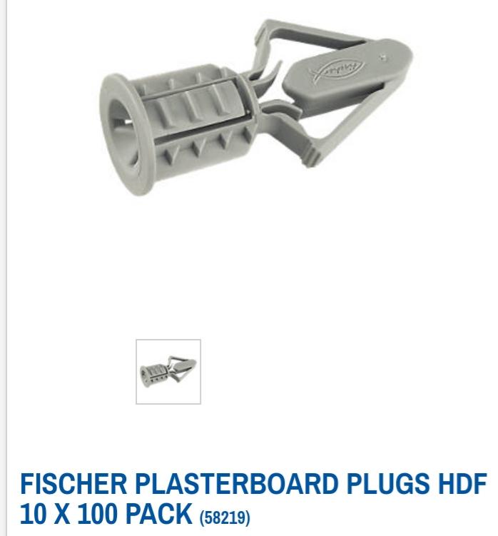

It'll be one of these screws:
But what "plugs" to use? 8 gauge screws in each case which I think equates to just over a 4mm screw.
I was thinking these but use the mirror screws above, instead. Says suits "4.5x35" screws.
Edited by Onoff
I've never been too keen on the screw-in fixings shown (although have used the metal ones which are at least a bit better than the plastic) and would tend to use Fischer UX plugs now for direct-to-plasterboard fixing on non-heavyweight items. They scrunch up behind/inside the plasterboard and provide quite a secure fixing without damage to the board.
Ta both. I use the metal self drill ones a lot I should have perhaps said. Was only thinking plastic as it won't ever rust and streak down the wall. Sometimes think too you ideally need to use the screw that comes with them?

Thinking maybe these, if they don't work I can change to the metal curly wurlies.
The metal screw in ones are aluminium so no fear of rusting and staining.

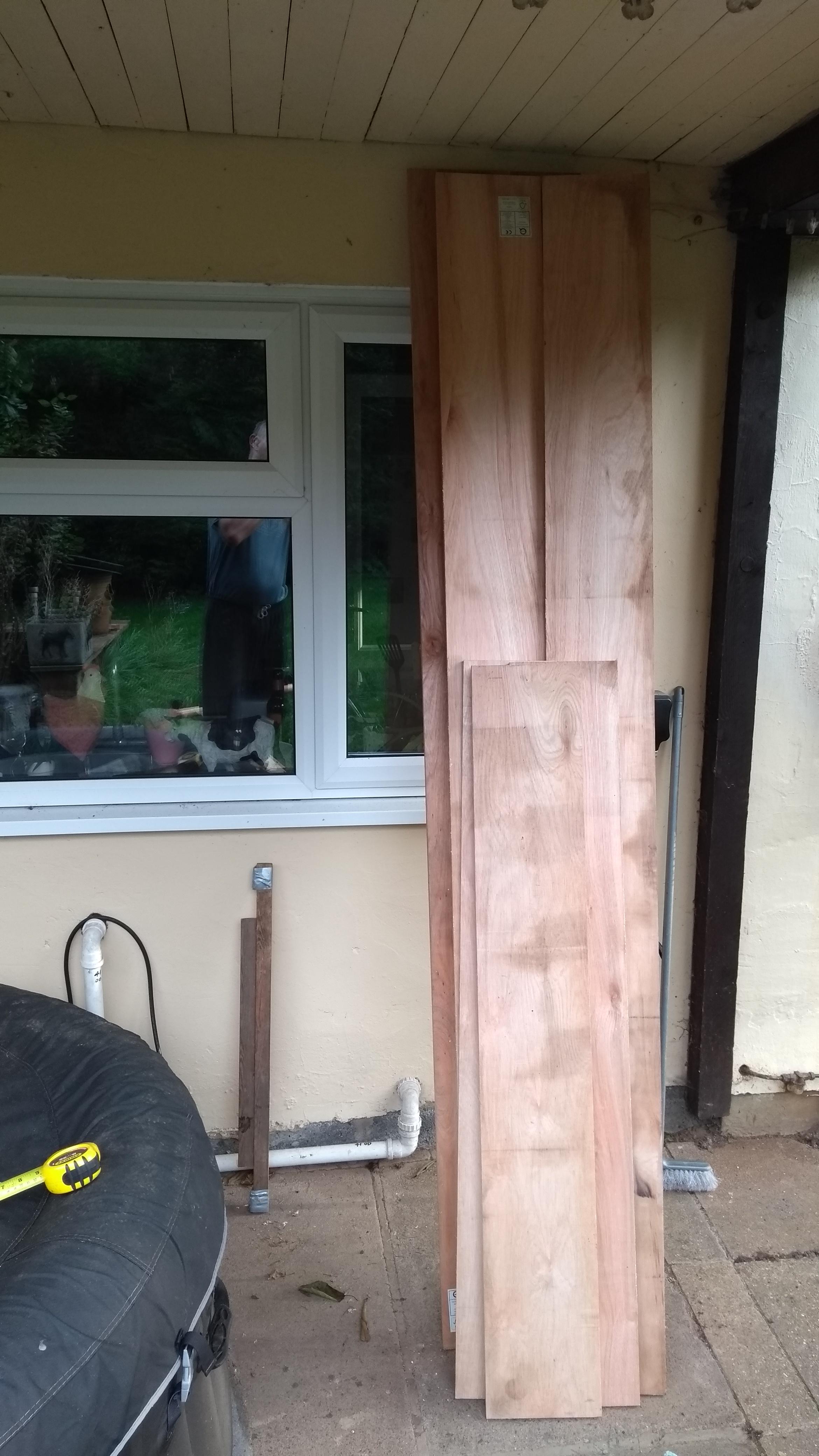

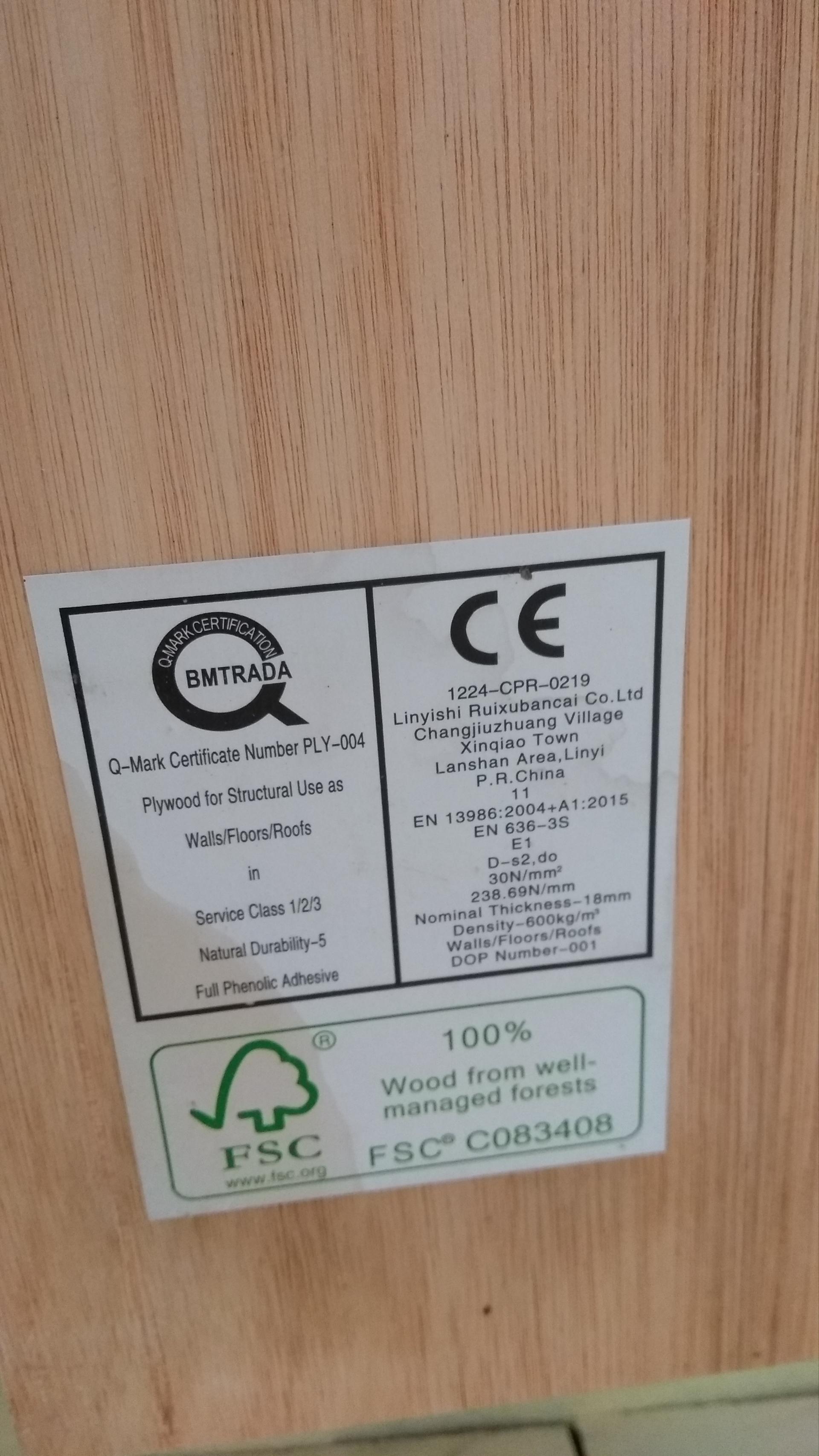

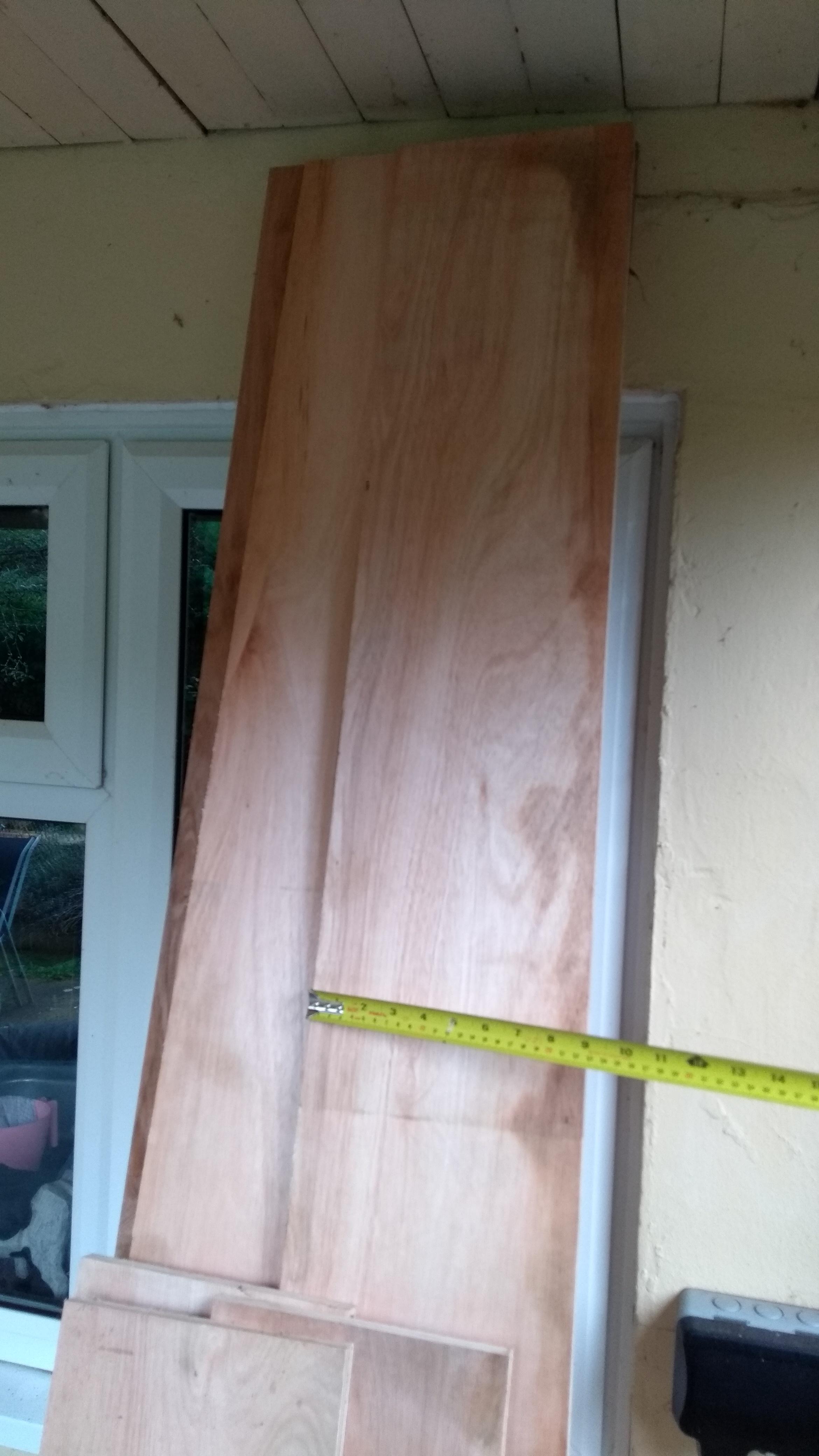

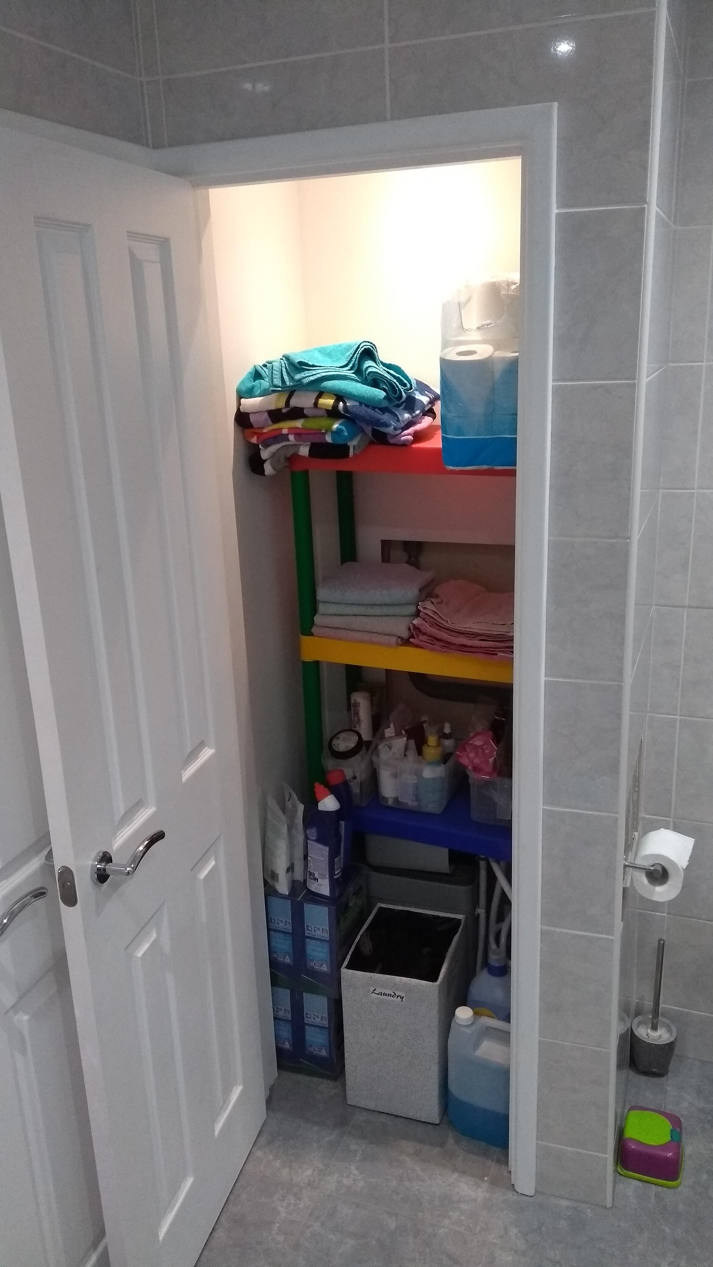

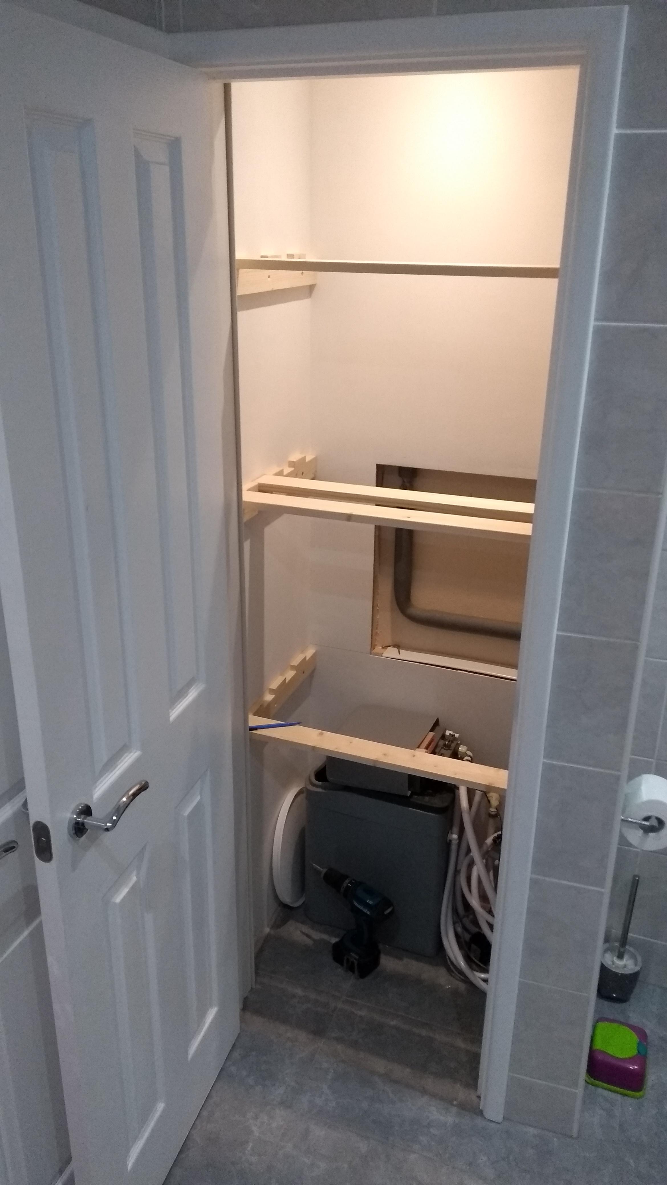

SWMBO is still blathering on about some sort of dedicated storage in the bathroom cupboard! I want it on wheels so it can roll out allowing access to pipes etc. As it stands, looks much more organised with the door shut!
I've just acquired some offcut ply strips, nom. 220mm wide. Been a bit damp but drying out fine other than done staining:
It's nicely close grained and no holes on the edges. It's this:
Mulling over whether I could use two of the long strips either side as "sides", maybe spaced with a gap in between. To gain shelf depth and aid air flow for when towels etc are on it. The shelf battens would join the uprights together.
Then have a couple of solid shelves at the bottom with slats up above, all made out of the ply.
Not sure whether this ply is thick enough to be used as battens similarly as slats.
As to finish...maybe a blue woodstain?
Off down the rabbit hole we go!
As SWMBO is an alumni of the Pat Coombs School of We Don't Like Excitement, I've gone traditional:

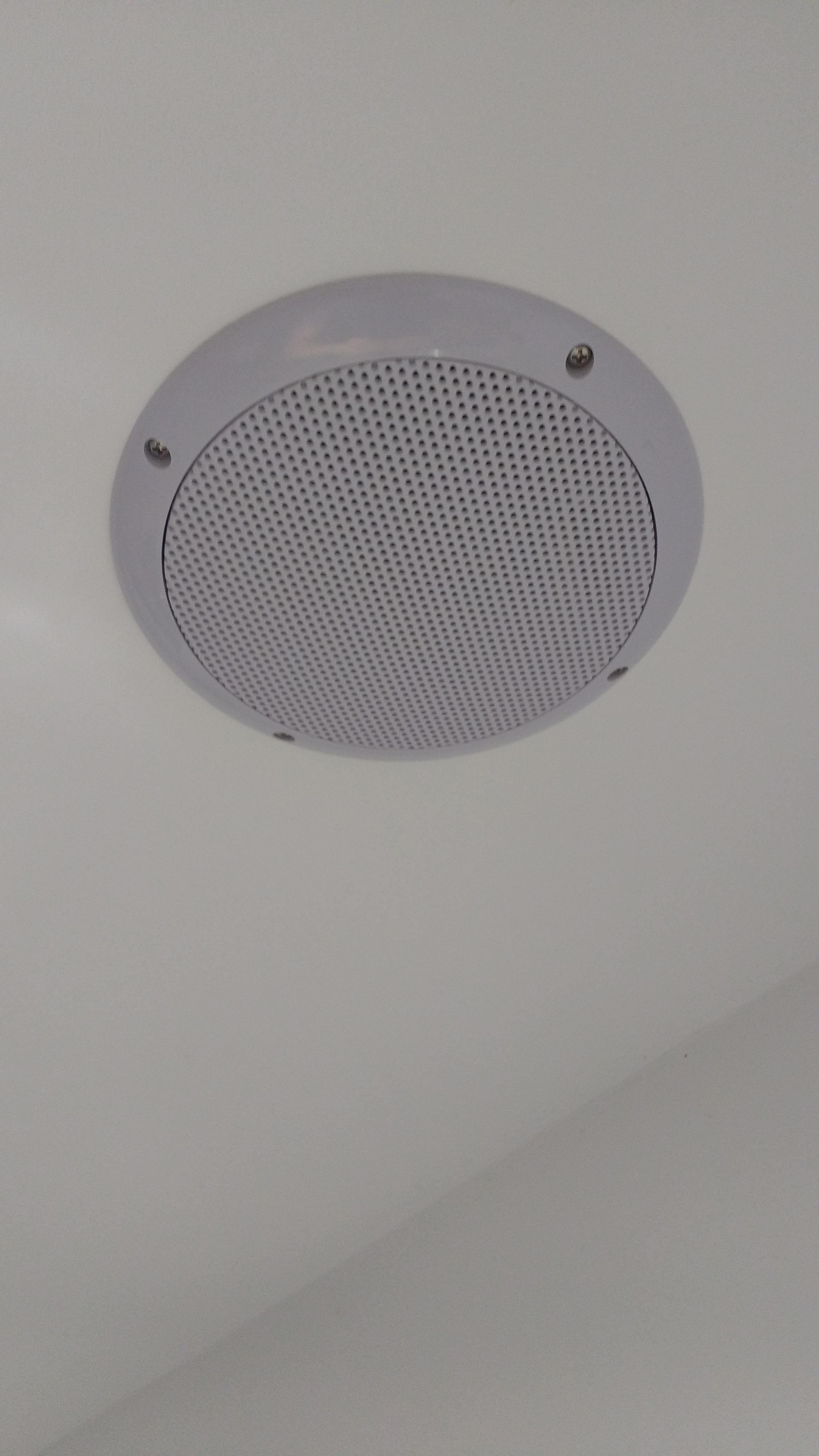

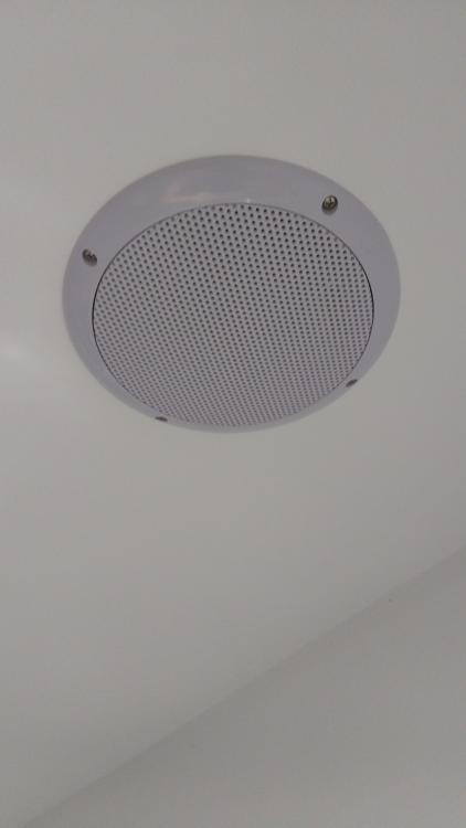

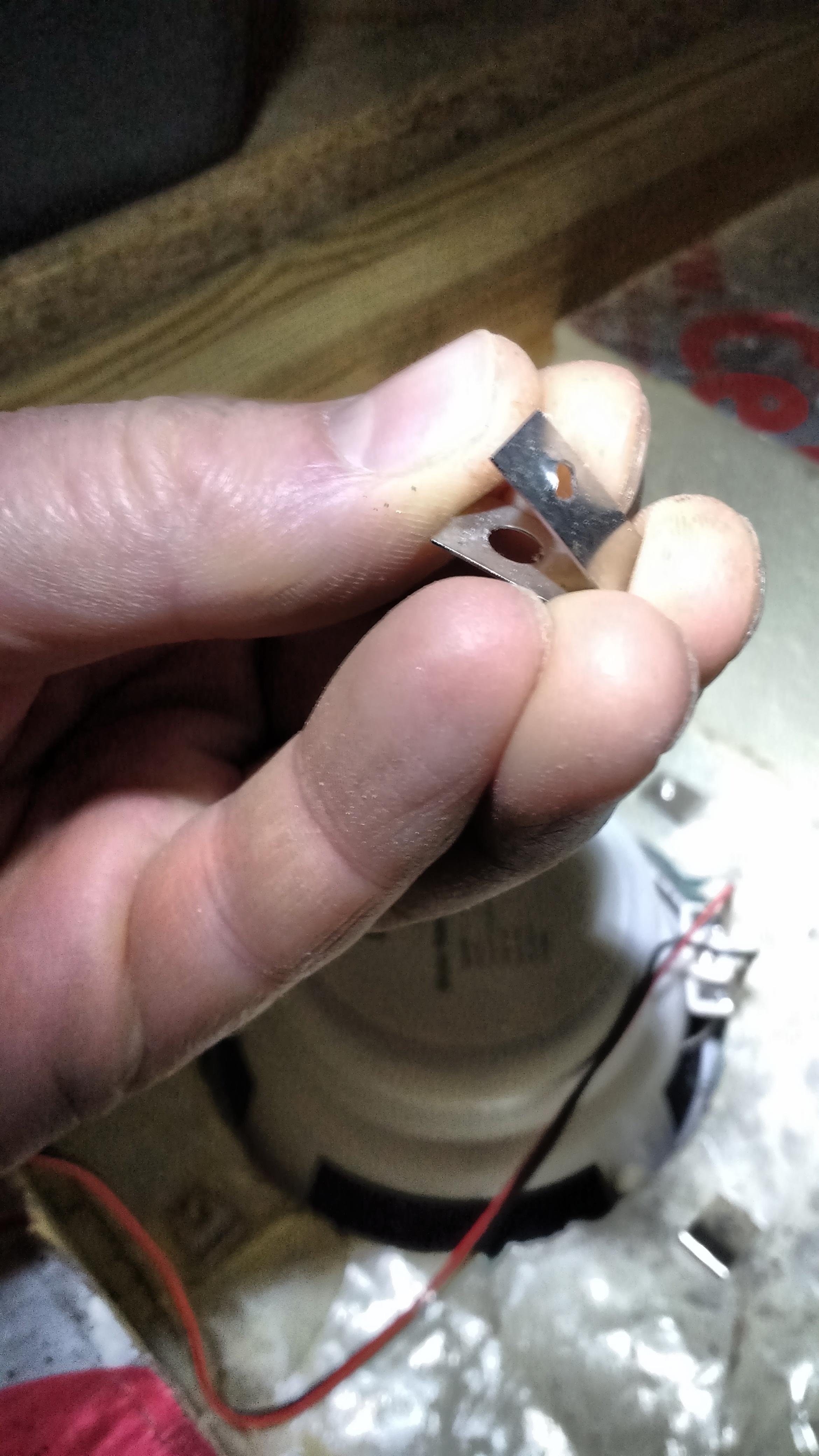

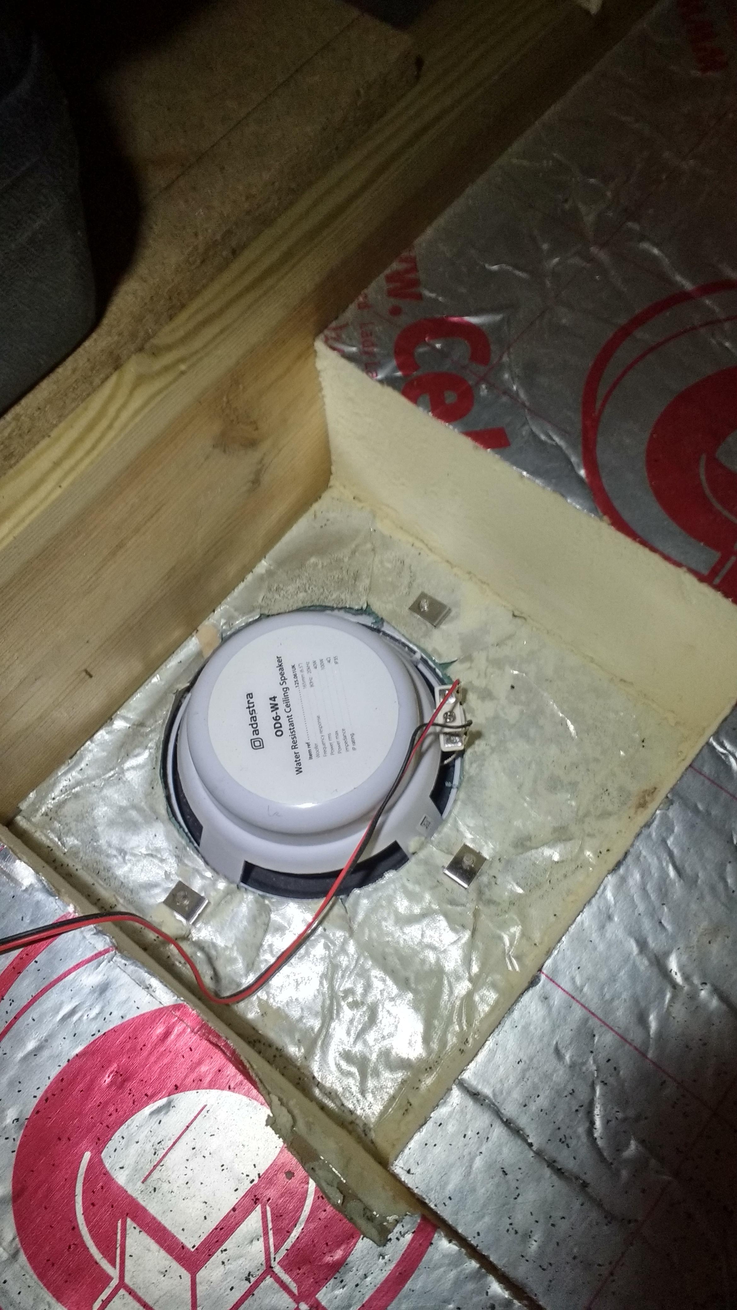

My ceiling speakers...
They fit in from the ceiling side but the screws go into silly little clips above the pb. In this pic three clips used, with the 4th screw into the adjacent noggin.

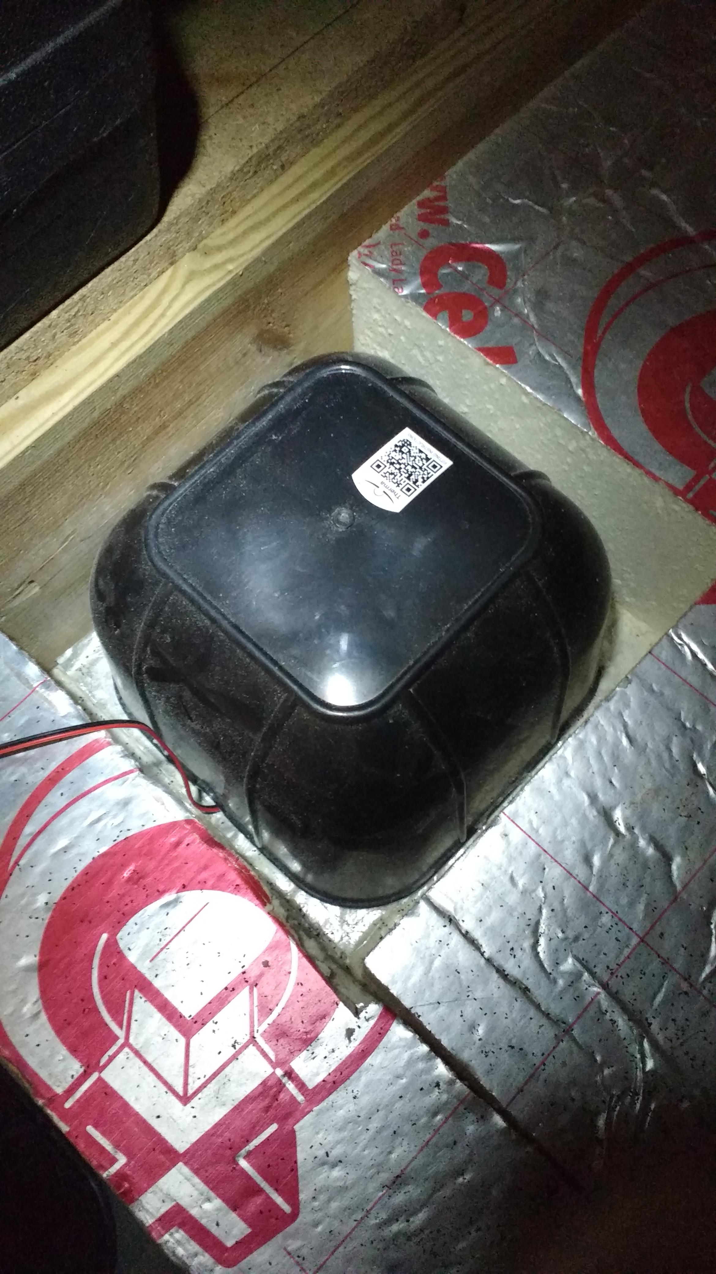

Long term the plan is a fire hood like this:
It'll be pushed down onto a bead of intumescent sealant. The gap between pir and hood will then be gun foamed. The speaker cable will come up through a conduit and sealed with Wiska gel. It'll be as good as I can get getting back to airtight as I cut a bfo in the vcl. 2nd pic above you can just see the green vcl through where the foil is split on the edge of the hole.

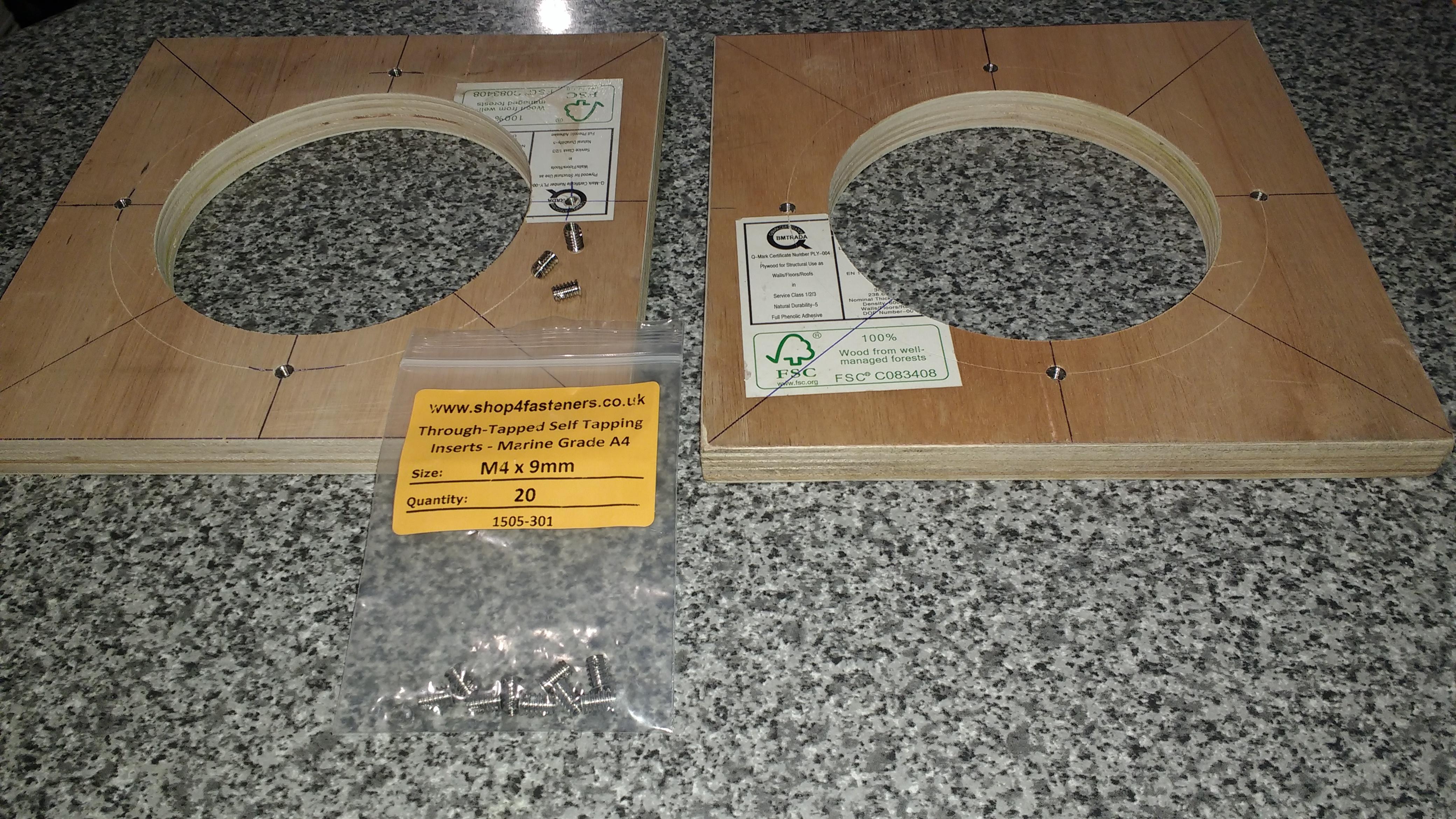

What I need are "permanent" clips top side that I won't ever have to access again. Maybe a ply square with some threaded inserts? A steel plate with some tapped holes? I could stick either down to the pb topside.
  • 2 weeks later...
I need to order some M4, A4 stainless, cheese head screws:
