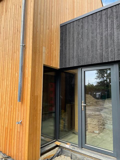

BartW Posted July 19, 2022 Share Posted July 19, 2022 Hi all, We are installing open rain screen vertical cladding on our TF build, but my worry is that we will be able to see battens through the 10mm gaps. How do people normally go about it? - paint battens? crazy time consuming - throw another layer of cheap breather? perhaps even geotextile? expensive given the m2 - not do anything? 1 Link to comment Share on other sites More sharing options...

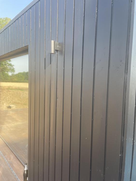

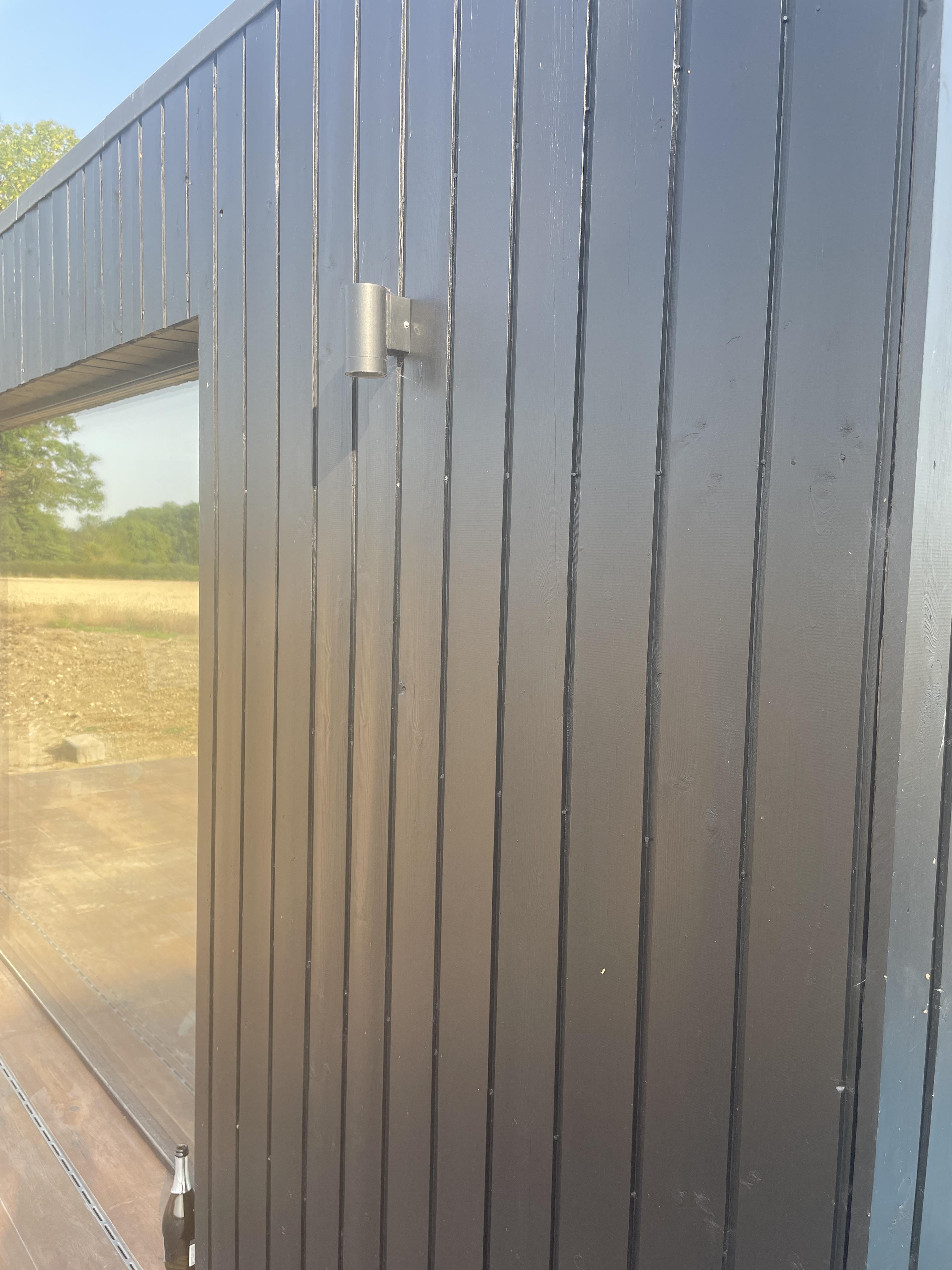

markocosic Posted July 20, 2022 Share Posted July 20, 2022 Subject close to my heart! What you have won't work. UV will kill it. I'll dig out some local samples from the Baltic coast... Insects will too in time IMO though this is debatated and depends on location and appetite of insects etc. If you wanted to have open rainscreen cladding then you're going to need something insect and UV proof under it IMO. You can't throw a non breathable membrane (e.g. EPDM) over the top of what you have without there being a ventilated rainscreen behind that non breathable membrane. When we looked at the UV proof and breathable membranes these cost a lot of limbs. They were the only option that let you "just throw a layer on" without materially changing the design though. I'd also consider: Shadow gap - though in pure black I don't think this is as effective as in lighter colours at creating shadows. Board on board - create deeper shadow gaps by putting your boards on top of.some other boards such that the gaps are full depth (e.g. decking board type deep) but there's still closure behind them. Board on tin - Use black wriggly tin / corrugated steel on top of your battens and fix through this into the battens. There world still be a ventilation gap behind this to let the house breathe...and it would look like there's nothing stuck immediately behind the boards...and it'd be black unlike your battens...and prevent insects uv and rain getting to your membrane. Gunned nails or self drilling wood screws will go through tin. We ended up using board on board and shadow gap to get the look that she wanted: 2 Link to comment Share on other sites More sharing options...

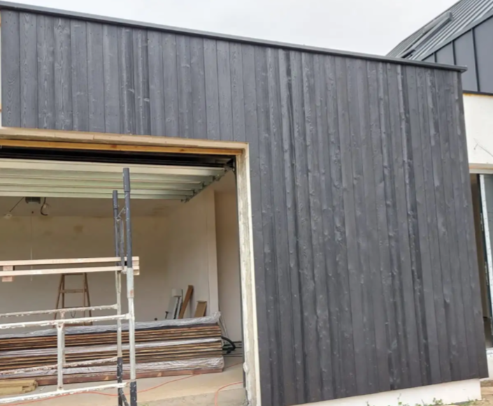

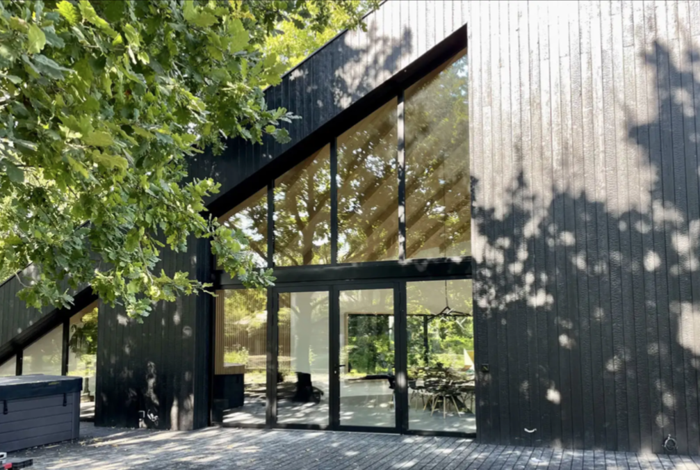

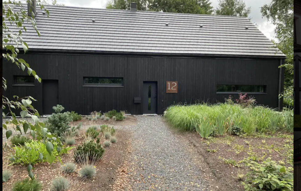

markocosic Posted July 20, 2022 Share Posted July 20, 2022 Local example of lighter but still dark shadow gap - I think shadows are stronger if you're using greys Link to comment Share on other sites More sharing options...
BartW Posted July 20, 2022 Author Share Posted July 20, 2022 Thanks chaps, I will do a full read at home, but the following look is what I am after. What if I lay butting up? Link to comment Share on other sites More sharing options...
Thorfun Posted July 20, 2022 Share Posted July 20, 2022 22 minutes ago, BartW said: What if I lay butting up? afaik you need to have some kind of expansion gap so butting boards together probably isn't a good idea (although I'm no expert!). we had the same dilemma about painting battens and in the end chose the shadow gap route on both our charred and standard larch. looks similar to those pictures you posted so I'm pretty sure they're not butted up but are a shadow gap profile. if you've already got boards on-site then I think board on board might be your best option. unless you can take them to a timber yard and get them planned to a shadow gap profile? Link to comment Share on other sites More sharing options...
markocosic Posted July 20, 2022 Share Posted July 20, 2022 Those examples you show are almost certainly shadow gapped boards @BartW Butted up soaking wet boards (in winter) will probably be 5mm mm gaps (uneven ones at that) in summer. Butted up in this weather will buckle and be a right state come winter. You need overlap and the option for the wood to move. That black against plain larch looks sharp @Thorfun 1 Link to comment Share on other sites More sharing options...
