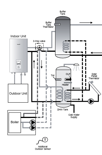

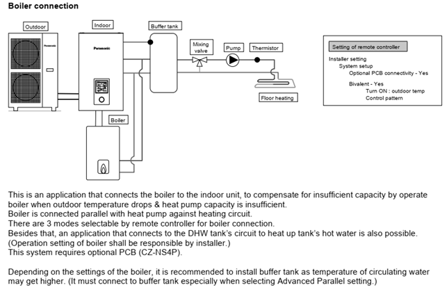

And can I use a gas boiler for heat and an ASHP for cooling on the same UFH system do you know?
@TFnovice, just a side note on overheating for well insulated houses. The best mitigant for this is not active ASHP cooling, openable windows, or even shutters but by good house design.
Depending on the constraints on your site it may be possible to orient your house, and especially the glazing, and and add shading overhangs and other features that reduce summer overheating dramatically. For example, in the case of Ben Adam Smith of the House Planning Help podcast, his forecast rate of summer overheating by these design measures for his own house was zero percent. In reality, of course, its impossible to fully avoid overheating. However, if your house is also modelled using PHPP then you can see the effect of design changes. Personally, when I chose my architect, was careful to choose one that was familiar with both PHPP and these concepts.
Many people who aspire to a (near-ish) passive house don't realise that, with a highly insulated house, space heating becomes easy and it is overheating that becomes the more major concern. Unfortunately, often they discover this only after they take-up occupation.
