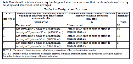

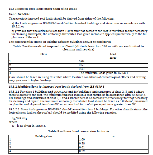

@saveasteading raises some serious safety issues here. I would love to see how your SE is justifying this. It may be that your milk parlour was over engineered in the first place and you are certain of the steel grade / quality, bolt strength and assessed any corrosion that has taken place over the years.
You have an old milk palour probably build before the argicultural codes of design were developed. But to give it the benefit of the doubt lets say that it was designed to an old class 4 agricultural standard. BS502 part 22- 2003. For a class 4 building the design life is 2 years. The latest update of the code has dispensed with the old class 4 as there were too many farm building collapses occuring!
Copied below are some extracts from BS 5502 part 22 2003.. this code is now superceeded.
To put this into context a house roof designed for the normal 50 year life span (equivalent to class 1) should be able to carry a load of 0.6 kN/msq about 60kg/m sq. Lenders expect that a house structure should have at least a fifty year life span, 60 years is sometimes mentioned by insurers and lenders.
The agricutural code class 4 lets you away with half that access load. Part of the reason is that the design life is a lot less, part is to do with deflections and the roof not leaking. They (farmers) did not mind if it bent, swayed a lot under snow and wind load, you will if you are living in it. Also it could invalidate a lot of your cladding / roof covering / window warranties if you exceed the manufactures allowances for movement.. horizontal and vertical deflections.. advise you check their specifications.
The other main point is the snow loading. For a class 4 building it is only 22% of the design snow load of a house. Hopefully you can now start to see where the safety issue requires closer examination and why I and others? are curious. Also there are restrictions on how close a low class building can be from a highway, this is to ensure that if it does collapse it reduces the risk to the public.
To explain a bit. Pretty much all structures are designed on the basis of probablility of collapse and consequence. A flood prevention scheme for farmers fields may be deisgned on a two year probablility of a flood event occuring (only live stock get killed), a house on 50 years (a few people get killed), a dam above a town / city 200- 500-1000 years (lots of people killed) and so on.
Now the access load on a farm building is reduced from 0.6kN/m^2 to 0.3kN/m^2 using the same principle.
