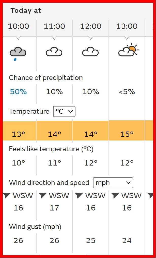

Today is an excellent case in point. Fully loaded yesterday evening : then 1 bath, and 1 shower - at a guess 10kWh's worth of PV self-consumption . So, there's a bit left in the tank  (13.7 - 1 [heat loss o/n] - 10 = say 2kWh)
Have I got enough left in the tank to have a shower this morning using PV alone?
Depends on how much PV is generated between dawn and .... when I get back. Doesn't look too good does it?
Off to the gym now, so I'll tell ya wot happened when I get back......
