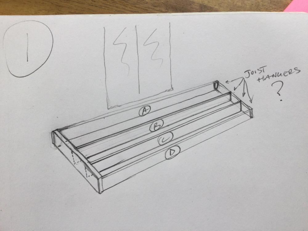

Onoff Posted June 8, 2022 Posted June 8, 2022 Beam A, the one to the house... Your extension construction is timber frame isn't it? As in timber stud uprights and "hollows". You can't resin fix to that.

zoothorn Posted June 9, 2022 Author Posted June 9, 2022 11 hours ago, joe90 said: , and the bars must be 99mm apart. Sorry mate I didn’t write the regs 😇 11 hours ago, Onoff said: Beam A, the one to the house... Your extension construction is timber frame isn't it? As in timber stud uprights and "hollows". You can't resin fix to that. It is but frame is the inner wall though. I have a block outer wall. zh 1

zoothorn Posted June 9, 2022 Author Posted June 9, 2022 15 hours ago, joe90 said: I would do it this way, 6 x 2 around the edges but the short ones could be 4 x 2 on joist hangers @ 600 mm max Hi Joe90. Thanks for this. So step 1 is back beam fix to wall with rod & epoxy.. then how would you attatch the other 3 timbers (assuming these would be step 2) if they're unsupported? A naiive question most probably. Zh
