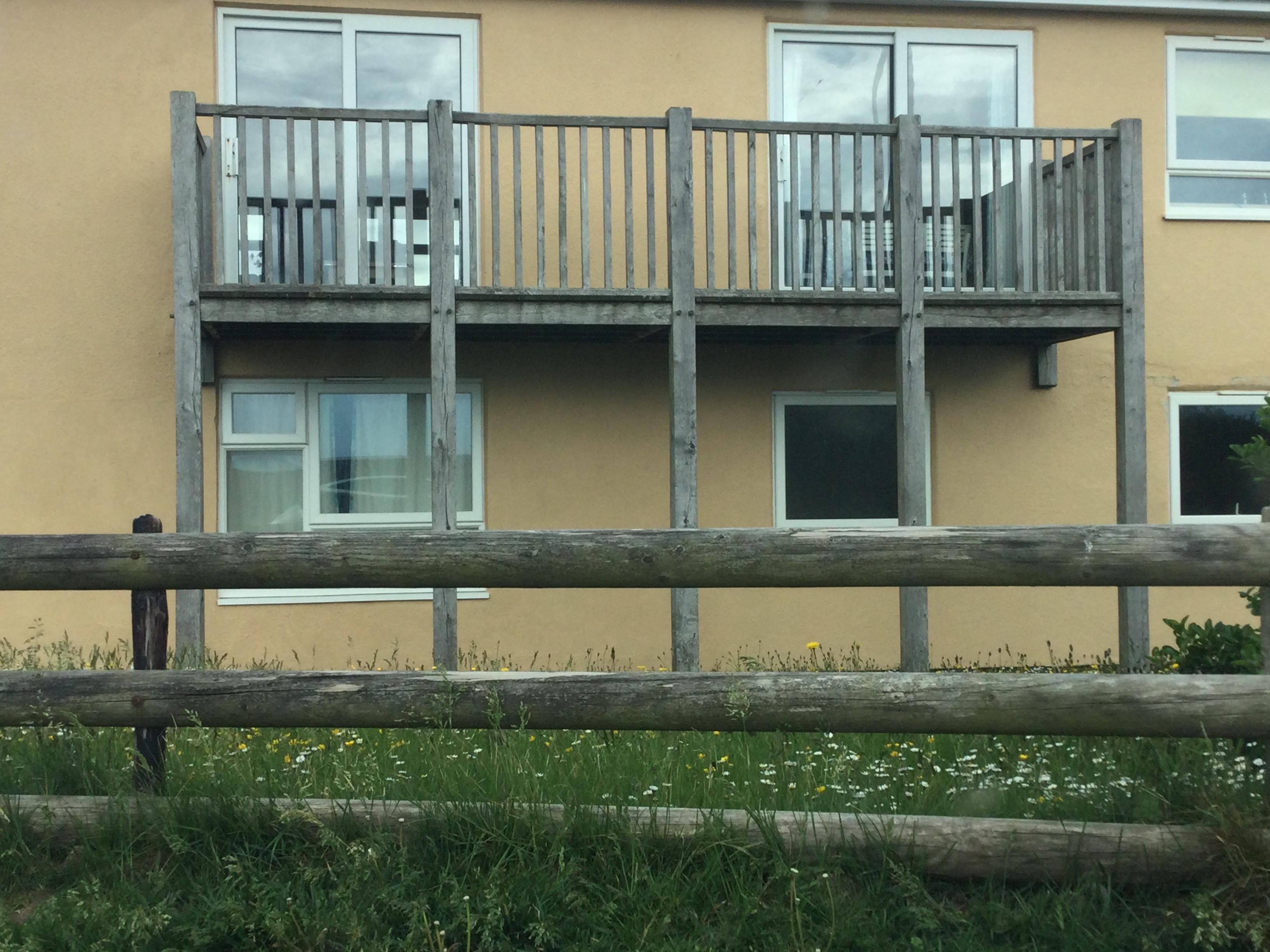

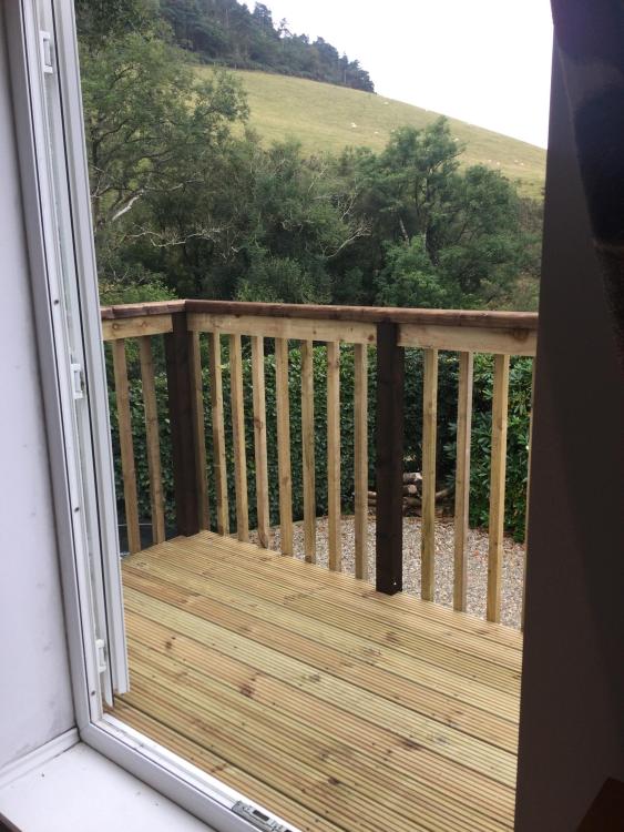

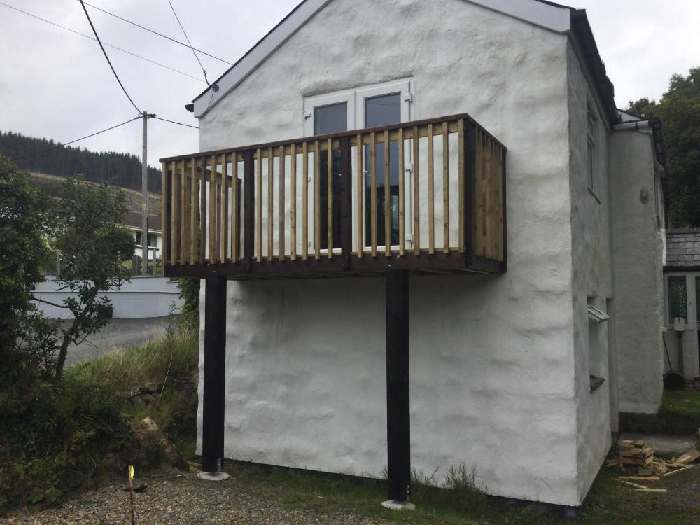

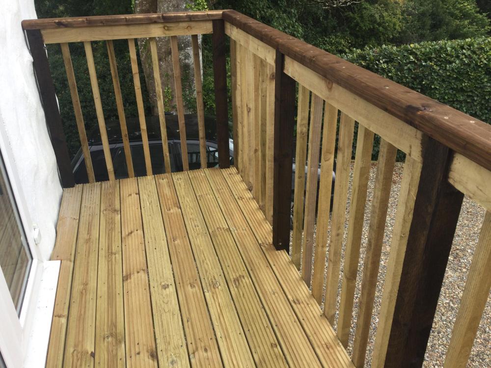

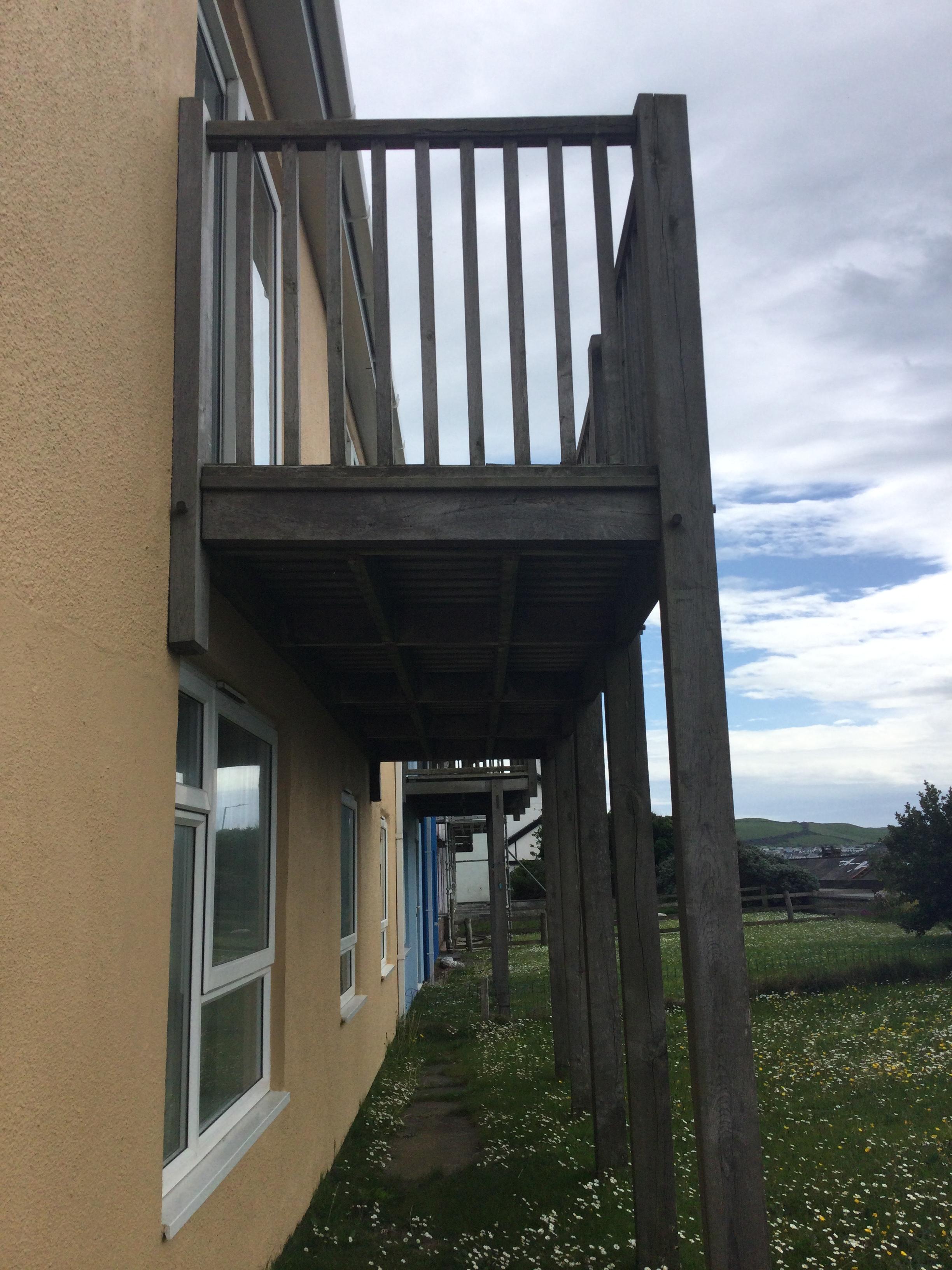

zoothorn Posted June 6, 2022 Share Posted June 6, 2022 Hi chaps, I've Planning Permission for a wood balcony, on my 2019 extention. I need to start the job. In retrospect my french windows (doors) would've opened IN & I just add a quick juliet balcony. D'oh! So, I have to continue with the timber balcony idea. I did a 'prep' design ideas thread, a year ago. Now I need to crack on. I'd really appreciate your help; I'm more adept with timber, & my cabin basework a good prior job giving me confidence. And I hope you too. My original design (I have PP for) included outside steps up. This idea shelved/ no steps now. I need to check with BCO that I can do this lesser plan, but assuming logic says I can:- Job to be based on this local eg: I think, unless anyone disagrees, useful to use this to copy as far as possible. It closely resembles my plan. Less width main difference. And mine in softwood, local one hardwood (?). Main reference pic here. Thanks for reading, Zoothorn. Link to comment Share on other sites More sharing options...

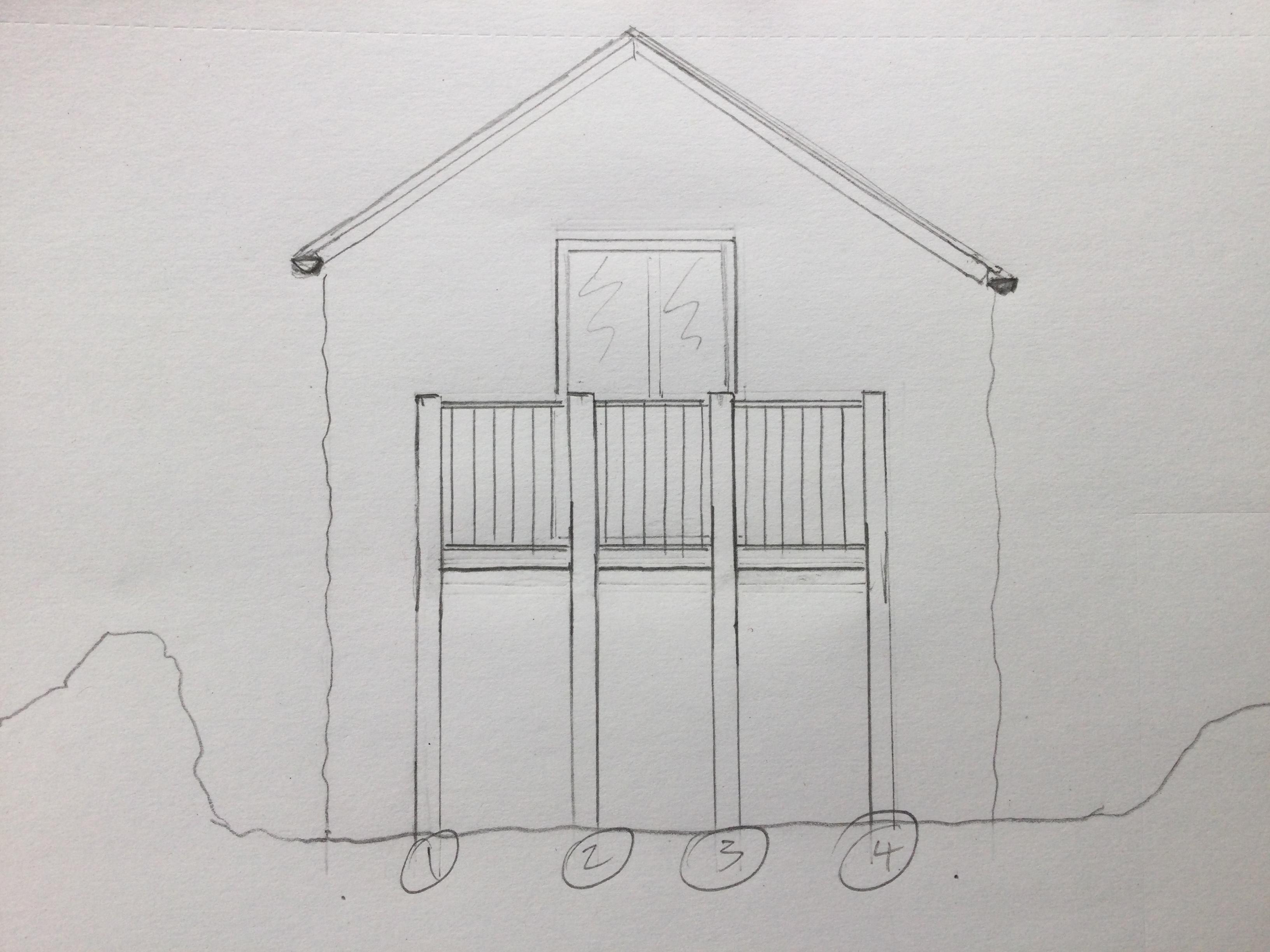

zoothorn Posted June 8, 2022 Author Share Posted June 8, 2022 Ok balcony to be 1 pillar less than the photo eg. This eg I thought (stepped it out) was 1400mm Depth. Is that an average UK balcony D would anyone know? Thanks zoot. Link to comment Share on other sites More sharing options...

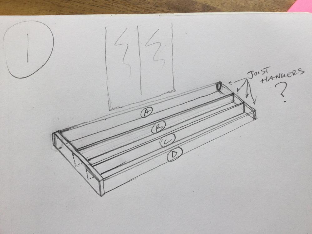

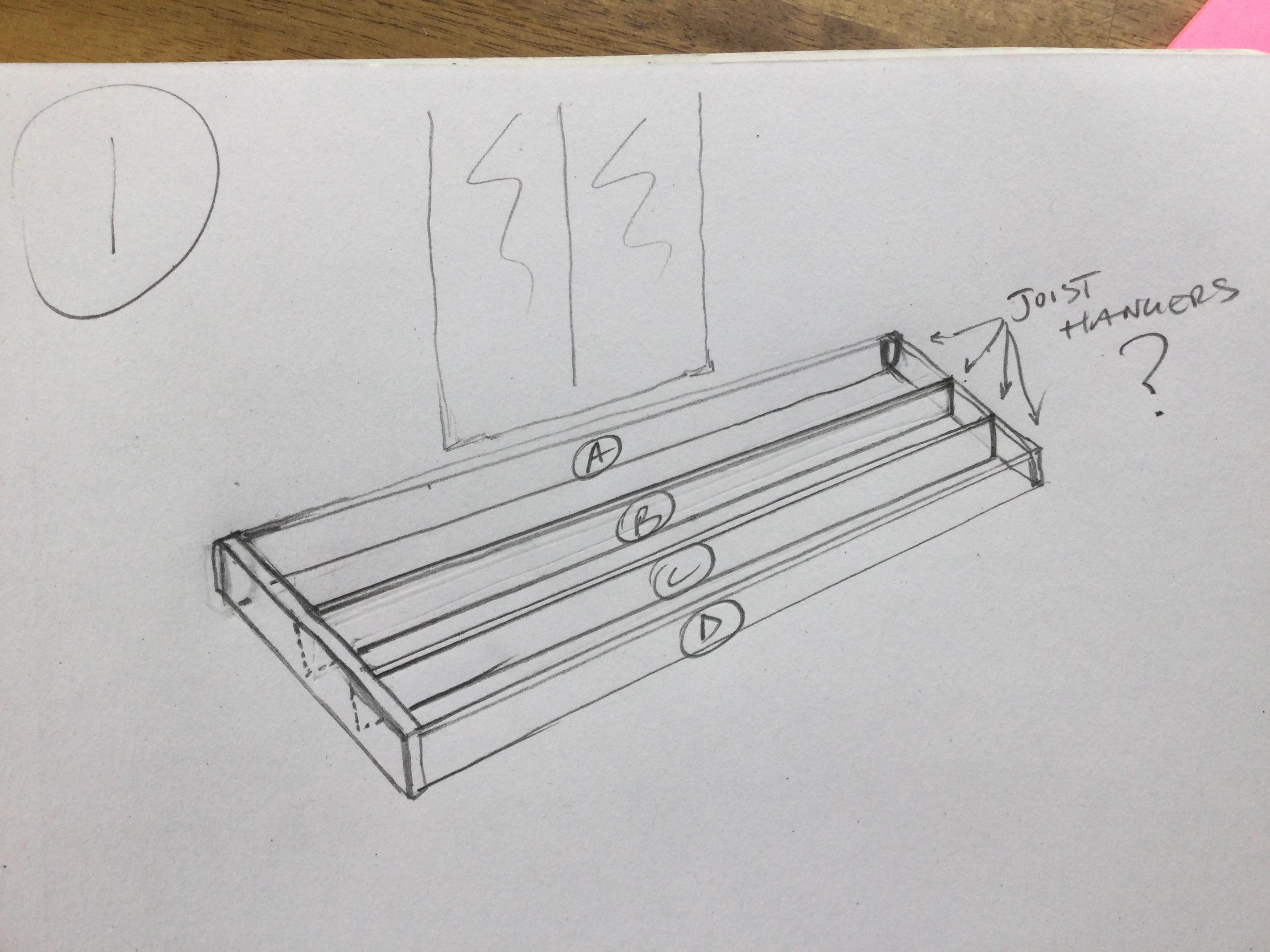

zoothorn Posted June 8, 2022 Author Share Posted June 8, 2022 I have Joe90's idea of beam A here. And some form of a frame here A,B,C,D.. but this doesn't follow the photo eg. Tbh Im stuck at the first fence! As how could this frame be supported, so it needs 2 pillars before B, C, D.. maybe. Link to comment Share on other sites More sharing options...

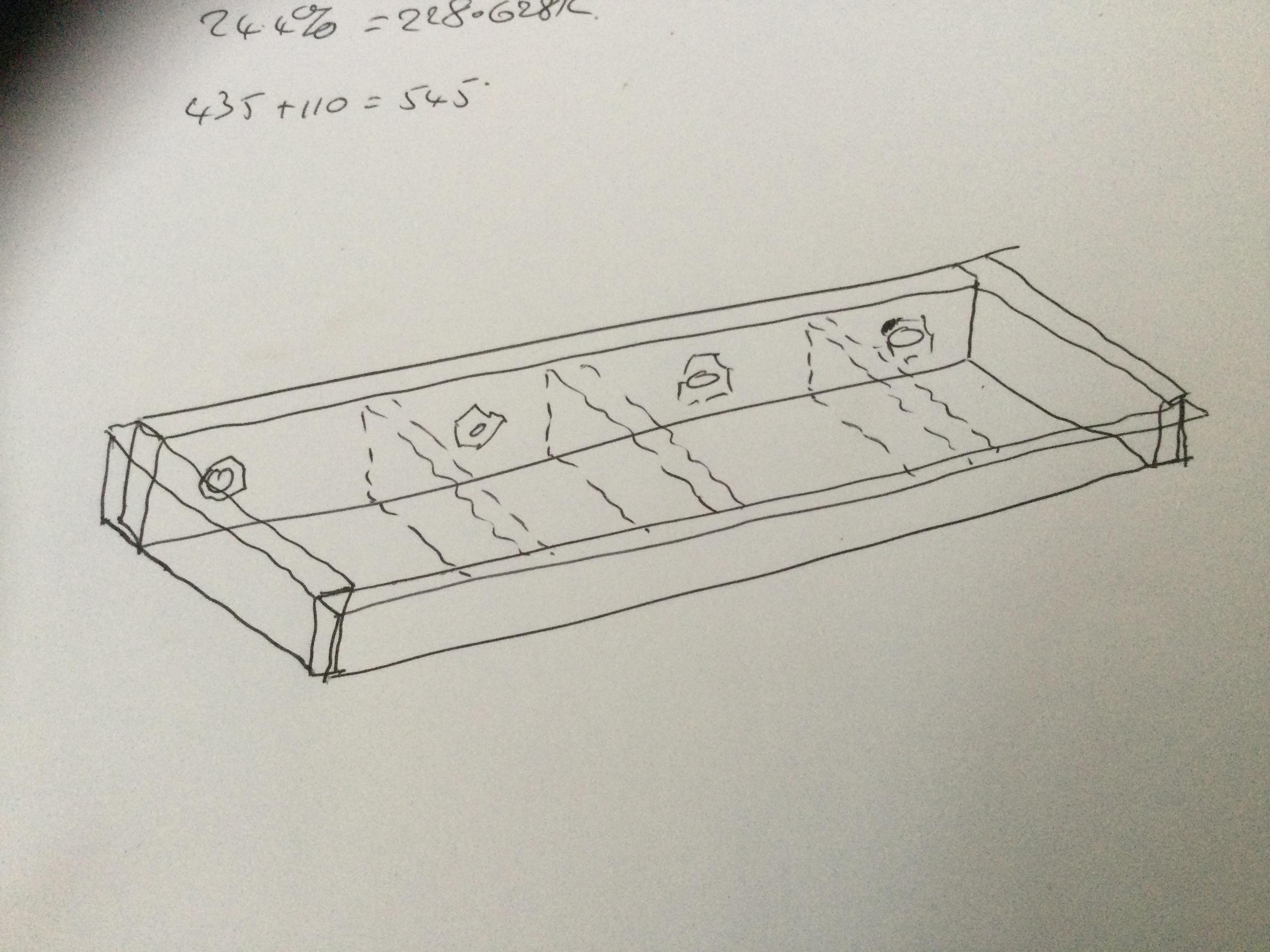

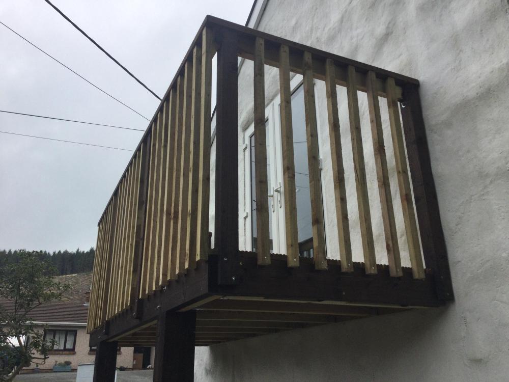

zoothorn Posted June 8, 2022 Author Share Posted June 8, 2022 I have this underside photo eg, giving me idea of the longwise beams A to D. But it seems to have no beam A.. but instead 2 side vertical struts fixed to the wall, up @ balcony level. Link to comment Share on other sites More sharing options...
joe90 Posted June 8, 2022 Share Posted June 8, 2022 1400m. Depth 👍, what length? Link to comment Share on other sites More sharing options...

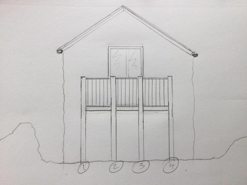

zoothorn Posted June 8, 2022 Author Share Posted June 8, 2022 4 minutes ago, joe90 said: 1400m. Depth 👍, what length? Well on my PP drawings it had the steps up, so I am guessing a bit right now @ L 3200mm. Link to comment Share on other sites More sharing options...
joe90 Posted June 8, 2022 Share Posted June 8, 2022 I would do it this way, 6 x 2 around the edges but the short ones could be 4 x 2 on joist hangers @ 600 mm max Link to comment Share on other sites More sharing options...
Onoff Posted June 8, 2022 Share Posted June 8, 2022 How did you get so close to take those photos of the local property? 😉 What length is 1 to 4? Link to comment Share on other sites More sharing options...

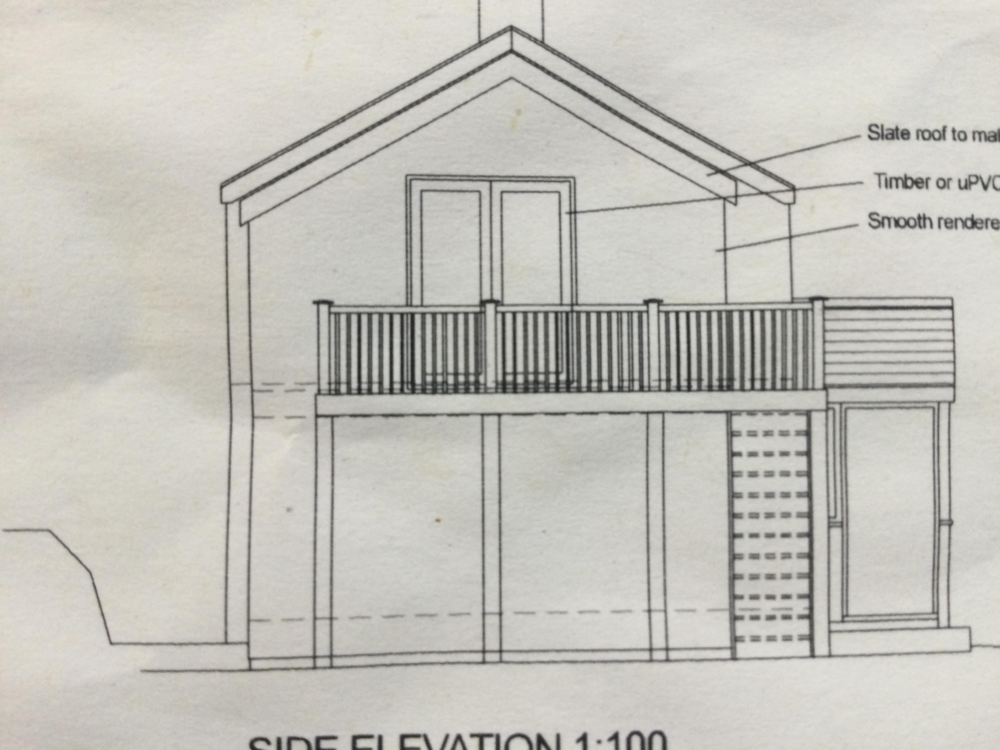

zoothorn Posted June 8, 2022 Author Share Posted June 8, 2022 43 minutes ago, Onoff said: How did you get so close to take those photos of the local property? 😉 What length is 1 to 4? No I didn't trespass.. taken from a very convenient close side road. Anyhow SO obviously a holiday house. I did snooping only yr honour. @joe90 Dims (firm) are: L 3320mm x W 1250mm These are what I have PP for; well, what I have PP for is more/ steps too/ like this.. Link to comment Share on other sites More sharing options...
Modernista Posted June 8, 2022 Share Posted June 8, 2022 (edited) I'm sure you've thought of it but won't it affect the view when you are sitting or in bed in that upstairs room? Especially if you have vertical balusters like that? the balustrade height in the drawing you posted just now looks low in proportion to the doors (and compared to the one you have been eyeing up). Edited June 8, 2022 by Modernista Link to comment Share on other sites More sharing options...
