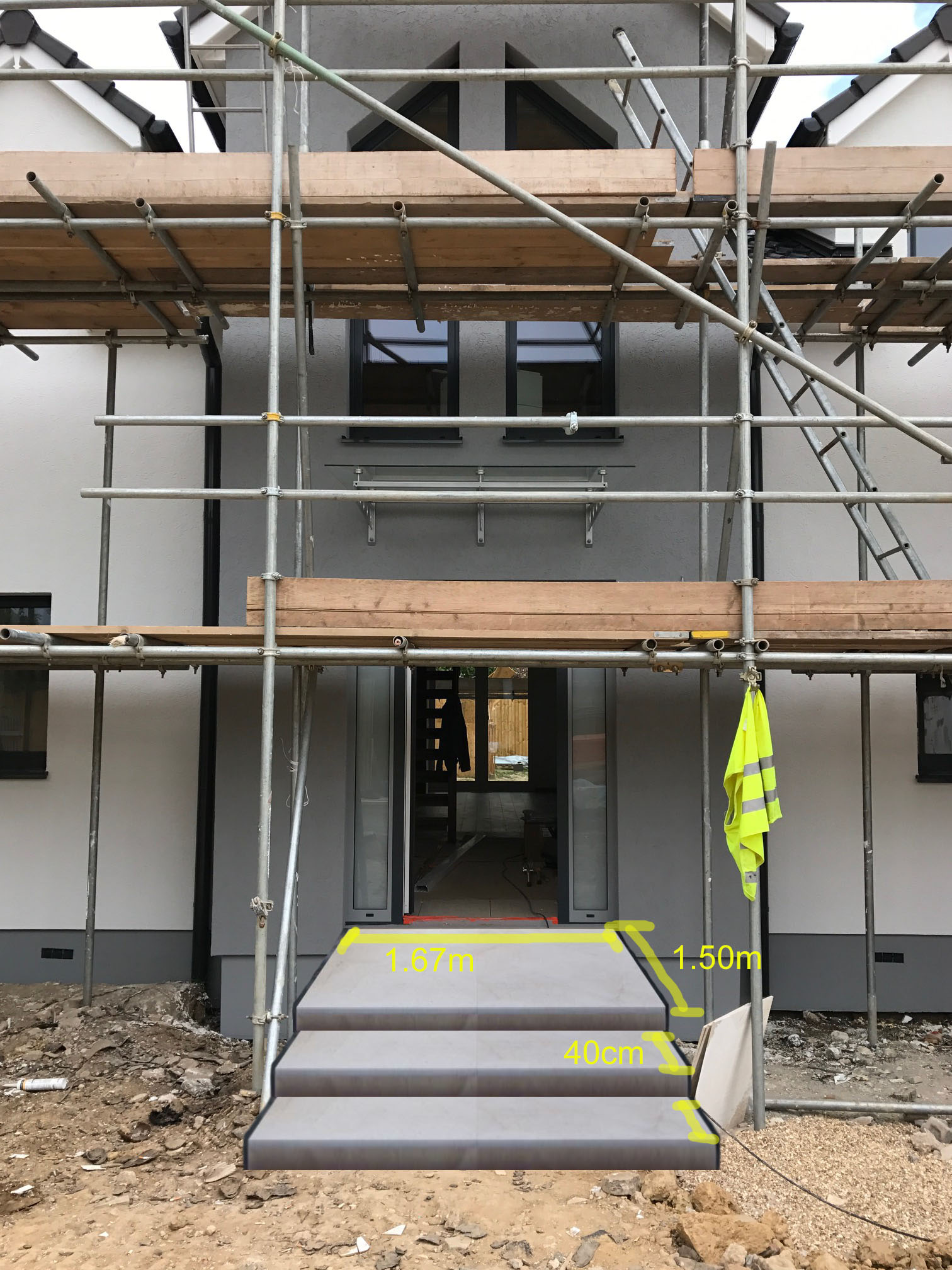

hmpmarketing Posted May 18, 2017 Posted May 18, 2017 Hey guys, I am about to complete build, Building Regs came over and inspected, all is fine, except there is one requirement relating to ramp approach for wheelchair access. I have proposed to build the entrance as per attached picture, but building control has said: The proposed stepped approach would not meet the minimum requirement of Approved Document M1, for wheelchair access on a flat site. Ramp approach should be provided in accordance with your Planning approval and Building Regulations approval. Trying the simplest way to overcome this as I dont want a permanent ramp built, any ideas? Thanks again
bassanclan Posted May 18, 2017 Posted May 18, 2017 Make your level access to a sisde or back door? Build the ramp ot the front door from type1 and slabs laid on sand, get it approved by BC then rip it out and build your preferred steps? 2
Jeremy Harris Posted May 18, 2017 Posted May 18, 2017 I did as suggested above, and built a gentle ramp up from the drive, around the side of the house to the back door. As there was then a 90 degree turn to get into the back door, I also had to add a flat wheelchair turning space right outside the door. The door also had to be Part M compliant, and the internal access route from it to the entrance level WC also had to comply with Part M. Doing this allowed me to have stone steps up to the front door from the drive, which look a lot better than a ramp. An alternative (not one I'd do, as I have a friend who's a wheelchair user) is to do as a friend in Yorkshire did with his self-build. He had York stone steps up to the main entrance, that were not Part M compliant. To get around this he covered them with polythene and then made a weak concrete mix ramp over the top. It looked pretty grim, but complied with building regs. As soon as the house had a completion certificate he just broke up the concrete ramp, revealing his unmarked stone steps................... 2
jack Posted May 18, 2017 Posted May 18, 2017 I can't help, but am interested in how you get on. My plan is to just build a temporary ramp (possibly even just out of wood), on the basis that building regs don't specify how they're constructed. The private building control guy is unlikely to care much, but there's always a risk that he'll think I'm taking the mickey. 1
Jeremy Harris Posted May 18, 2017 Posted May 18, 2017 Just now, jack said: I can't help, but am interested in how you get on. My plan is to just build a temporary ramp (possibly even just out of wood), on the basis that building regs don't specify how they've constructed. The private building control guy is unlikely to care much, but there's always a risk that he'll think I'm taking the mickey. They won't usually pass a ramp that is portable or temporary in appearance, according to the friend mentioned above who made a weak concrete ramp. He was going to just fabricate a steel ramp (he ran a steel fabrication company at the time) but his building inspector refused to accept it, hence the use of concrete. 1
hmpmarketing Posted May 18, 2017 Author Posted May 18, 2017 (edited) Thanks for the feedback guys. I had a conversation with one of the inspectors (I have a private BC) on a previous visit, and he had suggested a "temporary" structure as @JSHarris mentioned, something like timber and a a concrete mix coat to make it look "real". I could then rip it apart after completion cert. I have just asked if a wheelchair ramp with grip surface in metal would satisfy the requirements and he said that would be ok too, however they are not cheap! 18 minutes ago, jack said: My plan is to just build a temporary ramp (possibly even just out of wood), on the basis that building regs don't specify how they're constructed. The private building control guy is unlikel Maybe I will just use some of the polystyrene laying around and build a ramp with it and cover it up with rapid setting cement ! Edited May 18, 2017 by hmpmarketing

TerryE Posted May 18, 2017 Posted May 18, 2017 I can't recall where but IIRC, elsewhere in the regs there's a guideline that the FFL should be a minimum 150mm above ground-level and that's what we've got, so whatever you do you will normally have 150mm step from GL to FFL. The maximum "level" gradient is 1:20 and that means a 3m ramp. You see lots of those on new estate developments, don't you?

Temp Posted May 19, 2017 Posted May 19, 2017 Our bco said it would be ok to have a level access from the car parking space to the front door so we created a parking space on the same level and have a flight of about 4 steps down to the rest of the garden. In effect we drive up our disabled access ramp.
Ferdinand Posted May 20, 2017 Posted May 20, 2017 (edited) @hmpmarketing, One neat, and adjustable later should you wish, idea is to use what I call "Patio Feet" made by a company called Wallbarn - as below. They call them "Adjustable Support Pads". They are intended for supporting decks and paving on roofing, or raised off the ground, and cost from about a £2 for fixed low ones to about £5-10 each (depending on the height), and support up to hundreds of kg. IIRC mine were about £4-5 each, and I used them at corner joints between pavers. There are shims available (or we can make our own) which are designed to correct angles, but could be used to create angles for your ramp. For steeper angles one side of the support pad (which is a separate unit to the screw) could be cut off using a saw appropriate to tough plastic. Given appropriate pavers (I used 3x2 pressed council slabs for my patio), a ramp could be created that can be turned into generous steps by adjusting a few supports, or vice-versa should you want steps now and a wheelchair or run-down-the-world buggy later. The one proviso is that these require, or require you to create, a firm base .. though that could be made from a timber framework or MOT Type I (is that the one that turns into a compacted pan?). I guess that those eggcrate-full-of-gravel low impact foundations may potentially be a suitable base. Or breezeblocks bedded 25-50mm into the ground. There is a tradeoff between the size and strength of slab vs qty of patio feet. Not suitable for mosaic pavements. I like that I can raise my patio should I ever need to get underneath for maintenance. Ferdinand Edited May 20, 2017 by Ferdinand
