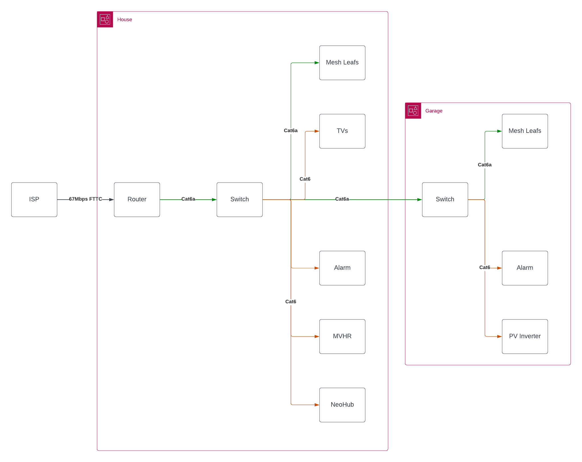

jayc89 Posted August 19, 2023 Share Posted August 19, 2023 We've just changed from BT to NowTV for our internet. I had no idea how good the BT HomeHub WiFi signal was. It reached every corner of our, solid wall construction, house. The NowTV in comparison is pants and doesn't reach more than 4m through our thick walls. I'll get around it by putting a WiFi mesh in, but I am somewhat relieved all our TVs etc are hardwired, so they haven't been affected. My house's network looks, or will look, something like this; I'm only using Cat6a for the backhaul; between routers, switches and Mesh Leafs, which means anything within our boundary could, theoretically, communicate at speeds up to 10Gbps, but in reality, nothing we have has the physical capability to do so; the mesh leafs have AX3000 chips, so support up to 3Gbps over 5Ghz, but all our consumable devices have BASE-1000-T ports at best, even the latest iPhone "only" supports up to 1.2Gbps over 5Ghz. (I suspect wifi technology will outpace physical cables for domestic and SMB use over time) Our internet supply is 67Mbps FTTC, even if/when we get FTTP, we're not going to exceed 1Gbps for a very long time, I can't imagine typical TV streaming ever will, at least in my lifetime, so running Cat6 elsewhere is a risk I'm willing to take. None of us are console gamers, so a single run to each bedroom has worked fine, if we really needed more, a 5 port switch would hide neatly behind the TVs. The only place I'll run more than 1 cable is to the living room, where we plan to have a media wall, and even then I don't know what I'd do with the additional ones yet, but they'd be there if needed. Link to comment Share on other sites More sharing options...
