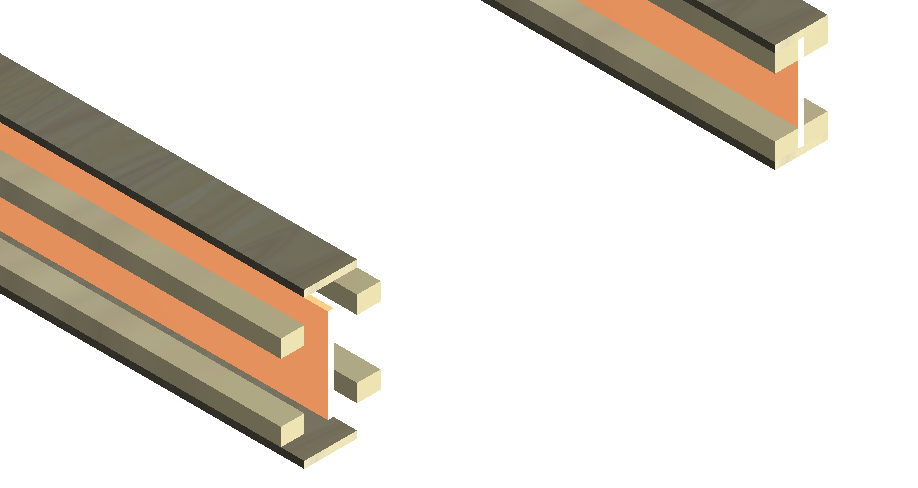

saveasteading Posted April 30, 2022 Share Posted April 30, 2022 5 hours ago, Cpd said: am going with building timber frames on the inside, We are the same. With the price of timber likely to keep rising I have an idea.....but it might be silly....so here goes. Someone on the forum showed a type of timber frame, named after the inventor, made of small timbers connected by ply plates, a bit like a fabricated joist. If we were to make our own, probably in a former, then we could use this for the inner liner. It would use less timber, we could buy the cheapest £/m3 which is CLS etc, and also break the cold bridge through the timbers themselves. Also replaces timber with more insulation in the void. More labour of course, so perhaps only for a diy job. Also for very large quantities the price can get much better. I once bought a whole bundle of 2 x 2. (6m3). As it was straight from the docks and no handling at the depot, the price plummeted. We can call it the Buildhub Stud Method. Comments? Link to comment Share on other sites More sharing options...
ProDave Posted April 30, 2022 Share Posted April 30, 2022 I think you are looking at a Larsen Truss. Typically two frames made of 4 by 2 joined bit strips of ply or OSB. The main reason being to avoid cold bridging apart from the joining plates. 1 Link to comment Share on other sites More sharing options...
saveasteading Posted April 30, 2022 Share Posted April 30, 2022 1 minute ago, ProDave said: a Larsen Truss That is the one. we have 140mm x 50 mm timber stud in the current plan. so using 50 x 50 twice is only going to save 1/3 of the timber, now I think about it, with a lot of work. But CLS is lots cheaper / m3 than the bigger stuff.. Another thought...the stud assembly will be enclosed in vapour and moisture barrier, so no risk of rot or worm, and untreated timber should be ok. Link to comment Share on other sites More sharing options...
Simplysimon Posted April 30, 2022 Share Posted April 30, 2022 1 hour ago, saveasteading said: That is the one. we have 140mm x 50 mm timber stud in the current plan. so using 50 x 50 twice is only going to save 1/3 of the timber, now I think about it, with a lot of work. But CLS is lots cheaper / m3 than the bigger stuff.. Another thought...the stud assembly will be enclosed in vapour and moisture barrier, so no risk of rot or worm, and untreated timber should be ok. but 50x50 is a lot cheaper than reg 145x45 Link to comment Share on other sites More sharing options...
saveasteading Posted April 30, 2022 Share Posted April 30, 2022 3 hours ago, Simplysimon said: 50x50 is a lot cheaper than reg 145x45 I'm not so sure. the CLS and 2 x 2 used to come ready prepared from Russia so that won't be happening. A local Highland sawmill told me they couldn't compete with these prices so they only did bigger timbers and specials. From a quick look at Wickes (because the prices are real time) I calculate that 2 x 2 is £1,400/m3 inc vat , and CLS 38 x 63 is £828/m3...a huge difference, and the CLS principle stands. Another local sawmill is quoting everything in C16 as £430 +VAT, but I suspect the website is behind the times. That is 2 x 2 up to 8 x 2. Link to comment Share on other sites More sharing options...
SteamyTea Posted May 1, 2022 Share Posted May 1, 2022 @saveasteading Could you make something like this. Probably need a simple jig to hold it all in place, then glue and screw/nail. Maybe @Gus Potter could have some input. 1 Link to comment Share on other sites More sharing options...
markc Posted May 1, 2022 Share Posted May 1, 2022 The built up section will (assuming the glue is good) always be stronger and stiffer than one piece solid timber ‘flanges’ on a Larsen truss or I joist. Bit more fiddly to make but incredibly strong. Link to comment Share on other sites More sharing options...
MikeSharp01 Posted May 1, 2022 Share Posted May 1, 2022 Filling in with solid insulation between Larsen Truss or I-Beams is a pain, Where we are not having blown in cellulose I made EPS 100 infills which effectively made our I-Beams flush than I could push in the 0.032 insulation batts without the folds around the step and any gaps. 1 Link to comment Share on other sites More sharing options...
saveasteading Posted May 2, 2022 Share Posted May 2, 2022 18 hours ago, SteamyTea said: Could you make something like this I was thinking of something more primitive but easier to build. Timber as the the 2 flanges, then rectangles of plywood on the sides , both sides but poss staggered. As it doesn't have to be terribly strong, it doesn't need to be I form. If I could do a drawing as well as SteamyTea then I would. Link to comment Share on other sites More sharing options...

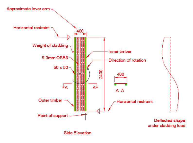

Gus Potter Posted May 4, 2022 Share Posted May 4, 2022 On 29/04/2022 at 19:50, Hill Runner said: Simplysimon is spot on, Wanlockhead Hello Hill Runner. Great place, high up so next stop is the moon. I'm down the road/ hill from you but have you bought a gold pan yet? If you have attended to all the gutters, down pipes etc and checked the ground levels are not bridging the DPC what about strapping the walls with 50 x 25 treated timber. Fix a bottom and top rail and verticals at 400 centres. Pack the straps off the wall say 5.0mm with a small cutting of DPC behind. How old is the house, does it have a bitumen DPC.. what is the construction of the external walls? On 30/04/2022 at 15:18, saveasteading said: That is the one. we have 140mm x 50 mm timber stud in the current plan. so using 50 x 50 twice is only going to save 1/3 of the timber Ah saveasteading, good point, made me think. To saw an 8 x 2 structural timber out of a 16 inch log after cleaning & stripping say requires four saw passes. But to plain saw a 2 x 2 requires another 3 passes of the saw? So more sawing to produce smaller timber out of the same size of log. But in real life the smaller logs are used for the smaller sizes. hey ho. The point is that you need more sawing? Also the surface area is greater relative to the cross section area of the smaller timber so you may need more preservative and a bit more handling? Maybe this goes some way to explaining why smallar timbers cost more than standard large ones per volume of timber? On 01/05/2022 at 07:06, SteamyTea said: Could you make something like this. On 30/04/2022 at 15:13, ProDave said: I think you are looking at a Larsen Truss. Typically two frames made of 4 by 2 joined bit strips of ply or OSB. The main reason being to avoid cold bridging apart from the joining plates. Thanks Dave for the Larsen truss, great spot and Steamy too and everyone else. On 01/05/2022 at 07:53, MikeSharp01 said: Filling in with solid insulation between Larsen Truss or I-Beams is a pain Lastly to Mike, but setting aside a real good practical point from Mike and for a bit of fun I have had a look at the Larsen truss, how it works to some extent in terms of creating a twin wall so you can create depth for insulation. I've tried to capture some of the main points but..! On 01/05/2022 at 07:17, markc said: The built up section will (assuming the glue is good) always be stronger and stiffer than one piece solid timber ‘flanges’ on a Larsen truss or I joist. Bit more fiddly to make but incredibly strong. Mark et al please chip in if you think I have missed something or made an error as no point in posting incorrect stuff. Here goes. I'll put some qualatative numbers to this. Work out the weight of the cladding, say another layer of OSB, battens and some timber shiplap. Shiplap thickness 14 mm. Timber density = 420 kg/m cube 0.014 *420 = 5.9 kg/ m sq Vertical 50 x 25 battens to create gap between board and OSB @ 400 centres. 0.05 * 0.025 * 420 / 0.4 = 1.3 kg / m sq OSB 9.0mm thick 5.5 kg / m sq. Sum of above = 5.9 + 1.3 + 5.5 = 12.7 kg per sq metre. Convert kg to kilo Newtons 12.7 * 9.81 * 0.001 = 0.12 kN add say 25% for "other stuff" like insulation and self weight give 0.15 kN per sq m.. not a lot as 0.15 kN is about 15 kg per sq metre. Over a 2.4m height this gives a load per metre run of wall of 0.15 * 2.4 = 0.36 kN ~ 37 kg. Now because the cladding is off centre from the point of support it causes a bending effect in the vertical section. The bending effect (the bending moment will be ~0.15 * 0.4(lever arm) = 0.06 kNm this is very small. For example if this was a domestic floor engineered I joist we design for the dead loads (self weight, flooring plaster board etc) and live loads, you and others. The live load is 1.5 kN/m^2 (~150kg) for a domestic floor so the bending moment is calculated for the uniformly loaded floor joist under live load space at 400mm centres as follows. Spacing * Load * length squared /8 =0.4 * 1.5 * 2.4/ 8 = 0.432 kNm which is more than the above bending force from the cladding weight. You can see that the bending effects from the cladding weight probably don't govern the design. Look now at how the cladding weight gets to the point of support. For every run metre run of wall we have about 0.36 kN..(36 kg) of cladding etc not a lot. There are battens at 400mm centres so each batten has to transfer via the nails 0.36 kN *0.4 = 0.14 kN over it's height. A very small amount. Now a 2.7mm diameter nail from 9.0mm OSB into a C16 grade timber has a shear capacity of some 0.05 to .08kN capacity. So the minimum number of nails will be 0.14 / 0.05 = 3 number. Again you can see that you don't need many nails to do the job to transfer the cladding load via the battens to the 50 x 50. We can set that aside for now. If using a cement board say we may need to revisit. But there is no free lunch! Firstly for it all to work the load from the cladding goes into the 50 x 50 but if you only have 3 nails up the height the 50 x 50 will bend like fury and it won't work. For it to work as a truss / I joist you are looking at nails at 100 - 150mm centres to connect the OSB to the 50 x 50. Then you are on the ball park. You may have a wind load acting on the cladding and this has to be resisted. Wind loads could be 1.0 to 1.5 kN/ sq metre so they have a big effect, much closer to a floor joist type live loading. This could often be the governing factor in the design. Lastly as @MikeSharp01 points out there are practical things that need consideration, how do you fit the insulation, what type and so on. Also, you want the 50 x 50 to be stiff, you don't want to be trying to fix cladding into a small timber that bounces all over the place. I think that although you can show that the forces can be accounted for structurally and you can "technically design" something lean you need to look at this in the round, particulary the buildability, labour cost and how easy it is to achieve a consistent quality of workmanship. I think this is the key to getting this to work.. is the practical buildability side. That said it's a great concept to consider if you want to achieve low heat losses. Link to comment Share on other sites More sharing options...
MikeSharp01 Posted May 4, 2022 Share Posted May 4, 2022 18 minutes ago, Gus Potter said: But there is no free lunch! Firstly for it all to work the load from the cladding goes into the 50 x 50 but if you only have 3 nails up the height the 50 x 50 will bend like fury and it won't work. For it to work as a truss / I joist you are looking at nails at 100 - 150mm centres to connect the OSB to the 50 x 50. Then you are on the ball park. You may have a wind load acting on the cladding and this has to be resisted. Other than thinking that a properly constructed Larsen truss is practical and therefore structurally OK I cannot comment further on them. On construction - our I-Joists are glued, so the flanges are grooved and the web (9mm OSB) is glued into the groove under pressure (in the factory) so no nails. Where we do have nails (and a lot of them into the flanges) is on the sheathing on the cross walls. 3.1mm dia nails at 50mm centers everywhere for racking strength. So I guess our SE must have thought that that racking issue was the biggie. Link to comment Share on other sites More sharing options...
joe90 Posted May 4, 2022 Share Posted May 4, 2022 As I like dealing with wood rather than concrete etc and I found @Gus Potters post above fascinating (even if I don’t understand the numbers 🤷♂️) however 44 minutes ago, Gus Potter said: Firstly for it all to work the load from the cladding goes into the 50 x 50 but if you only have 3 nails up the height the 50 x 50 will bend like fury and it won't work. But the cladding will be pushing against the edge of the OSB due to rotational forces and fixed to the 50 x50 so It won’t bend (well it might bend outwards if negative air pressure is great 🤔). But realistically anyone is going to nail at 150mm centres and may even glue as well so I think the Larsen truss is a great way of building a wall that will allow a lot of insulation (maybe I might do another build 🤔) (maybe not). also if the 50x50 is a bit bent (as a lot is) it can be straightened to meet the straight edge of the OSB prior to nailing. Link to comment Share on other sites More sharing options...
