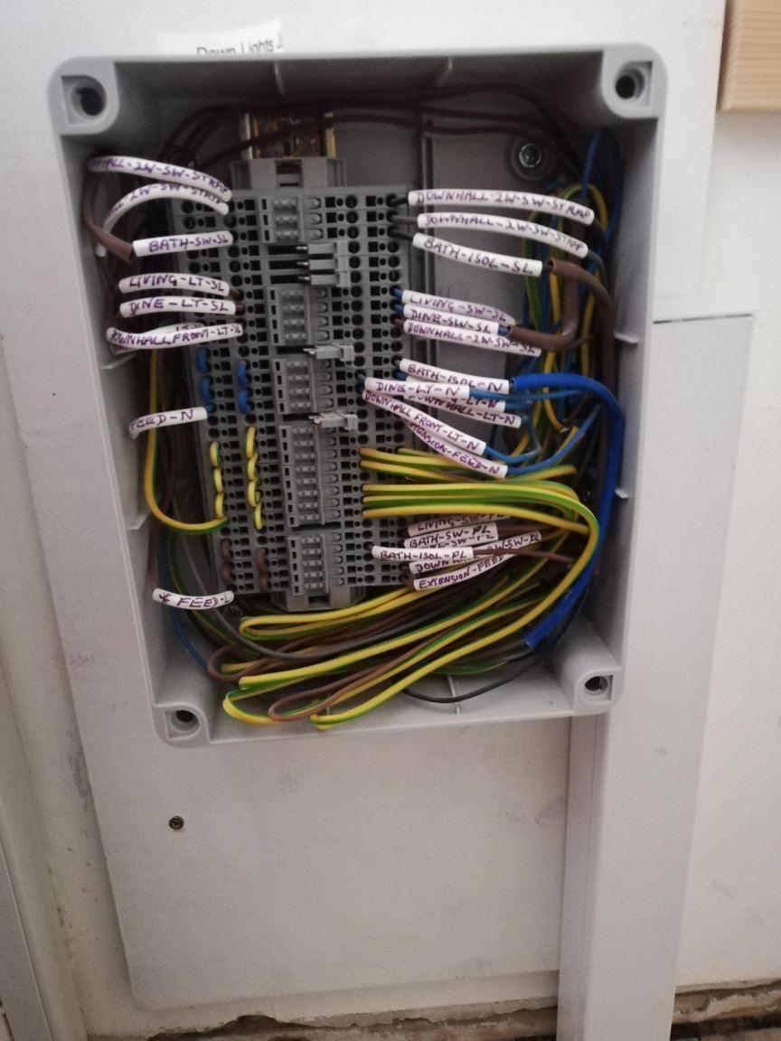

Roys Posted April 28, 2022 Share Posted April 28, 2022 (edited) I rewired my house a couple of years ago, and I ran individual t&e to every switch and light fitting to two central junction boxes, one mounted on a board in the loft for the upstairs lights and the other in the cupboard at the top of the stairs for the downstairs lights. Again easily assessable and mounted on a wooden board in the cupboard. Inside each JB the terminals are all DIN rail mounted and ident sleeves put onto each core to identify it. Did it that way so that I had the option to easily make it SMART or easily modifiable in the future. Just found a pic of the JB at the top of the stairs when it was about 3/4 done. Edited April 28, 2022 by Roys Add pic 2 Link to comment Share on other sites More sharing options...
FrankHouse Posted April 29, 2022 Author Share Posted April 29, 2022 That looks manageable. I'd be wiring everything to one location but I think I have space. When i was doing more searching last night I found some ethernet controlled shelly relays which would work with that kind of layout as well. I'm probably over thinking it and trying to get a perfect solution when I don't know what the technology will be when I finally get round to doing it. I have to build it first. Link to comment Share on other sites More sharing options...

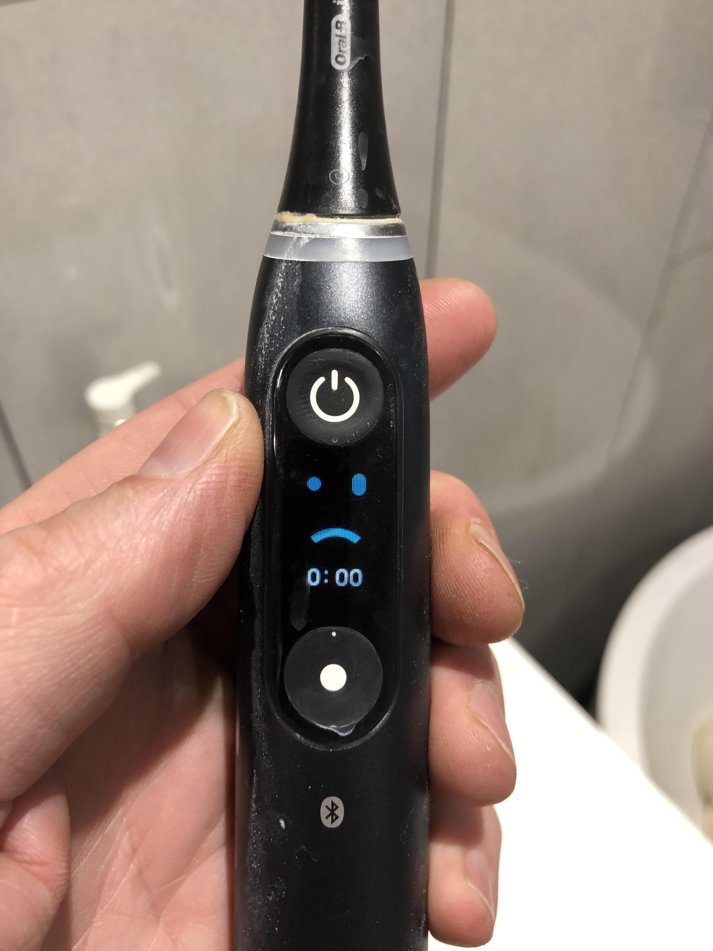

Pocster Posted April 29, 2022 Share Posted April 29, 2022 5 minutes ago, joth said: My electrician thought I was crazy pulling cat 6a to every bathroom. All our electric toothbrushes charged from PoE. Who's laughing now! Even my toothbrush doesnt charge from poe . But it does have Bluetooth to an app . It shows we how well I brushed my teeth . I got (expletive deleted)ed off with it . Now it just shows a sad face . Link to comment Share on other sites More sharing options...
