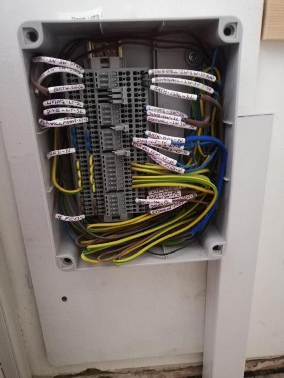

  • I rewired my house a couple of years ago, and I ran individual t&e to every switch and light fitting to two central junction boxes, one mounted on a board in the loft for the upstairs lights and t

Taking switches and lights back to a central point lets you add automation  in one location and if it fails, it’s easy to then join cabling together and bypass automation.
if I had the space I would do that.
3core and earth to switch so it has a feed, switch wire and neutral, and 3 core at lights for same reason.
OK thanks. However I think I will go with traditional wiring and distributed automation. It takes 2 min to put a relay behind a switch, and another 2 min to take it out and revert to trad if you want to. Can't see a problem with walking round the house to do this.
