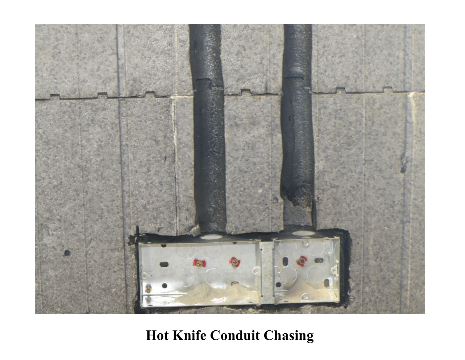

BotusBuild Posted May 22, 2022 Posted May 22, 2022 (edited) On 21/05/2022 at 14:06, SteamyTea said: Think @BotusBuild has used ICF, depends if he is about. I certainly am using ICF - Nudura, and received delivery of next floor kit before it went up 15%. Not sure exactly when it will be going in place. But I am happy and wiling to provide a film set when I want channels cutting in EPS for my low smoke cabling and water pipes 🙂 Edited May 22, 2022 by BotusBuild
FM2015 Posted May 22, 2022 Posted May 22, 2022 3 hours ago, BotusBuild said: I certainly am using ICF - Nudura, and received delivery of next floor kit before it went up 15%. Not sure exactly when it will be going in place. But I am happy and wiling to provide a film set when I want channels cutting in EPS for my low smoke cabling and water pipes 🙂 Is that low smoke cabling so as to avoid conduits? Come across a few jobs where this was the case only to fall foul of protection measures. Unless you put them deep enough, you'll still need protection. Cost of cable over normal will be in the same ball park as normal plus conduit. You can form a channel that is almost key hole shaped so the conduit 'clips' in.
SteamyTea Posted May 22, 2022 Posted May 22, 2022 15 minutes ago, FM2015 said: You can form a channel that is almost key hole shaped so the conduit 'clips' in. I like that idea. So all meet up @BotusBuild's for tea, cake and hotknifing.
BotusBuild Posted May 22, 2022 Posted May 22, 2022 32 minutes ago, FM2015 said: Is that low smoke cabling so as to avoid conduits? Been mentioned by my friendly local electrician, and so I will need to check whether putting standard in conduit is an option
BotusBuild Posted May 22, 2022 Posted May 22, 2022 18 minutes ago, SteamyTea said: So all meet up @BotusBuild's for tea, cake and hotknifing. As soon as SWMBO decides where the sockets are going, we can arrange something 😉. No holding of breath, please.
SteamyTea Posted May 22, 2022 Posted May 22, 2022 36 minutes ago, FM2015 said: Is that low smoke cabling so as to avoid conduits? Come across a few jobs where this was the case only to fall foul of protection measures Not a good idea to put cabling and polystyrene together.
SteamyTea Posted May 22, 2022 Posted May 22, 2022 Just now, BotusBuild said: As soon as SWMBO decides where the sockets are going 1 single in each room, 2 in the kitchen. 1
FM2015 Posted May 22, 2022 Posted May 22, 2022 1 minute ago, SteamyTea said: Not a good idea to put cabling and polystyrene together. That's why it needs protection, not just from someone hanging a picture. Just watch a north American YouTube video on hot knifing and electrics....suffice to say, I wouldn't do it like that 🤦🏼
SteamyTea Posted May 22, 2022 Posted May 22, 2022 Found this about wiring. 328081417_ElectricWiringforDomesticInstallations.pdf
Nick Laslett Posted May 23, 2022 Posted May 23, 2022 11 hours ago, FM2015 said: That's why it needs protection, not just from someone hanging a picture. Just watch a north American YouTube video on hot knifing and electrics....suffice to say, I wouldn't do it like that 🤦🏼 I’m very close to first fix with my ICF build. I have already procured a hot knife, KD-7H. Here is a picture from the Thermohouse manual. This is what I was going to copy. @FM2015 Any advice appreciated, my sparks has no prior ICF experience so we are on this journey together. 2
SteamyTea Posted May 23, 2022 Posted May 23, 2022 52 minutes ago, Nick Laslett said: Any advice appreciated As all the cables are in conduit, I think you can go for a Type 2 installation.
FM2015 Posted May 23, 2022 Posted May 23, 2022 15 hours ago, Nick Laslett said: I’m very close to first fix with my ICF build. I have already procured a hot knife, KD-7H. Here is a picture from the Thermohouse manual. This is what I was going to copy. @FM2015 Any advice appreciated, my sparks has no prior ICF experience so we are on this journey together. That's in the manual??!! I appreciate that all this is going to get hidden but still. Practice, get the heat right for the blade type, don't melt more than required, 47mm deep plasterboard boxes give a neat finish and sparks love the extra space.
