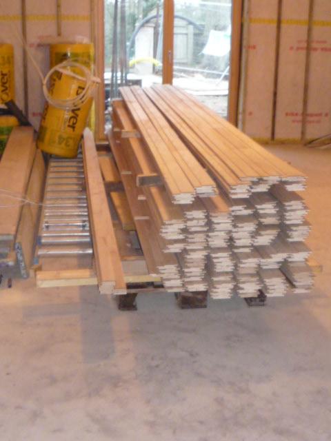

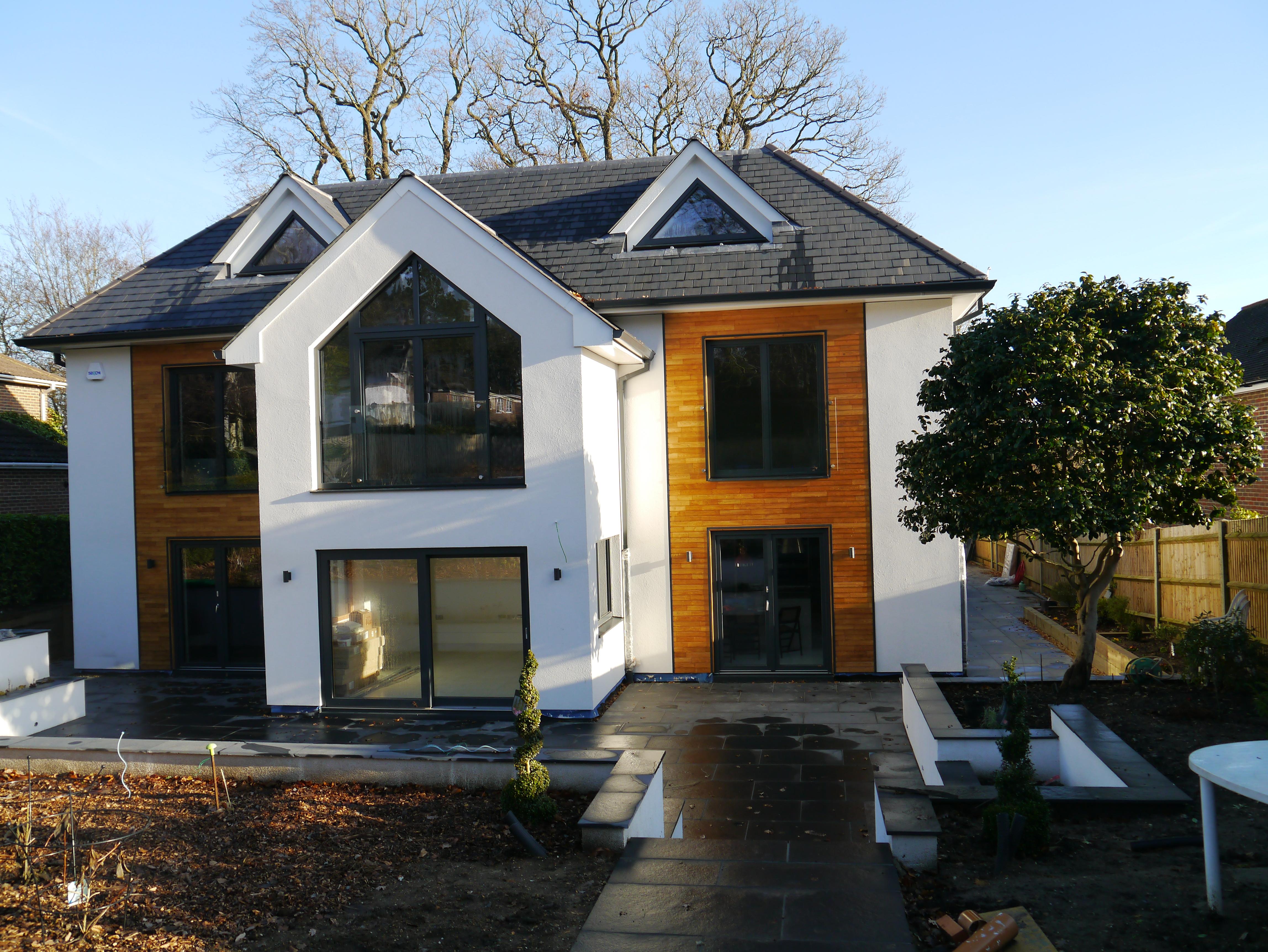

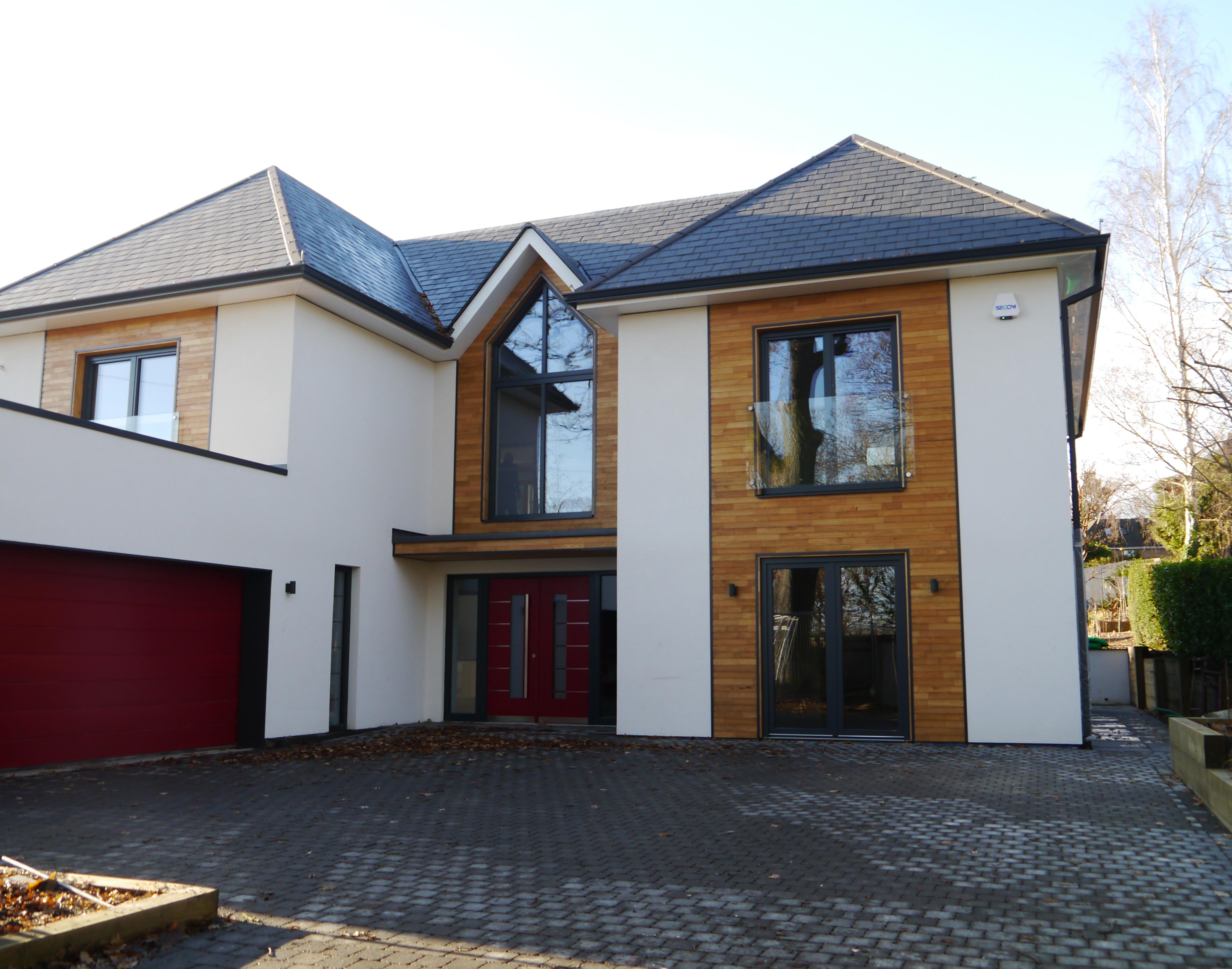

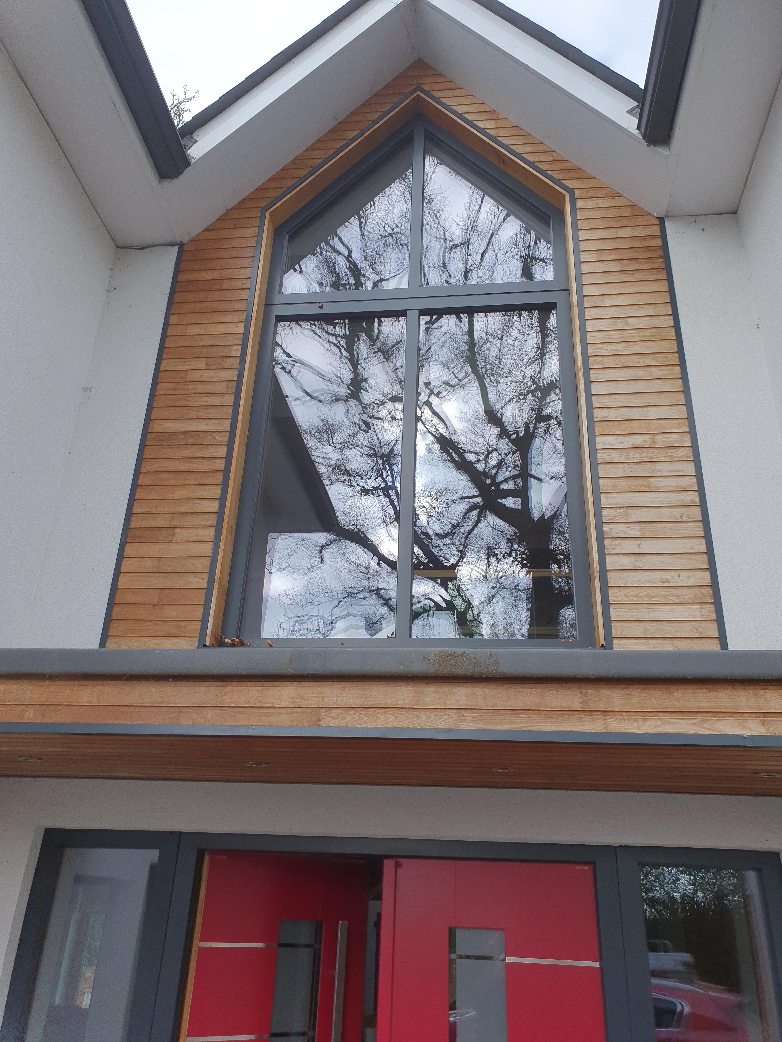

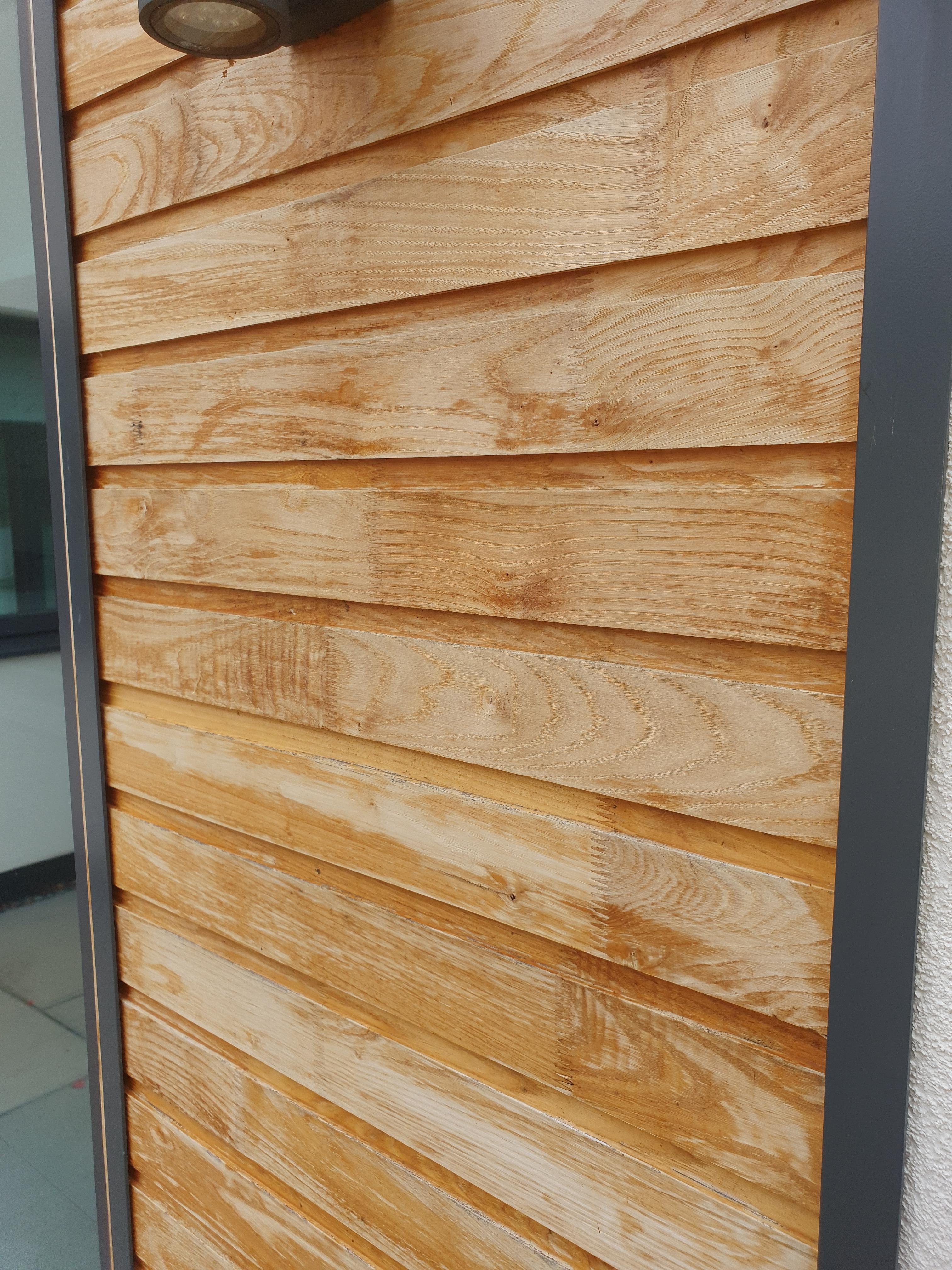

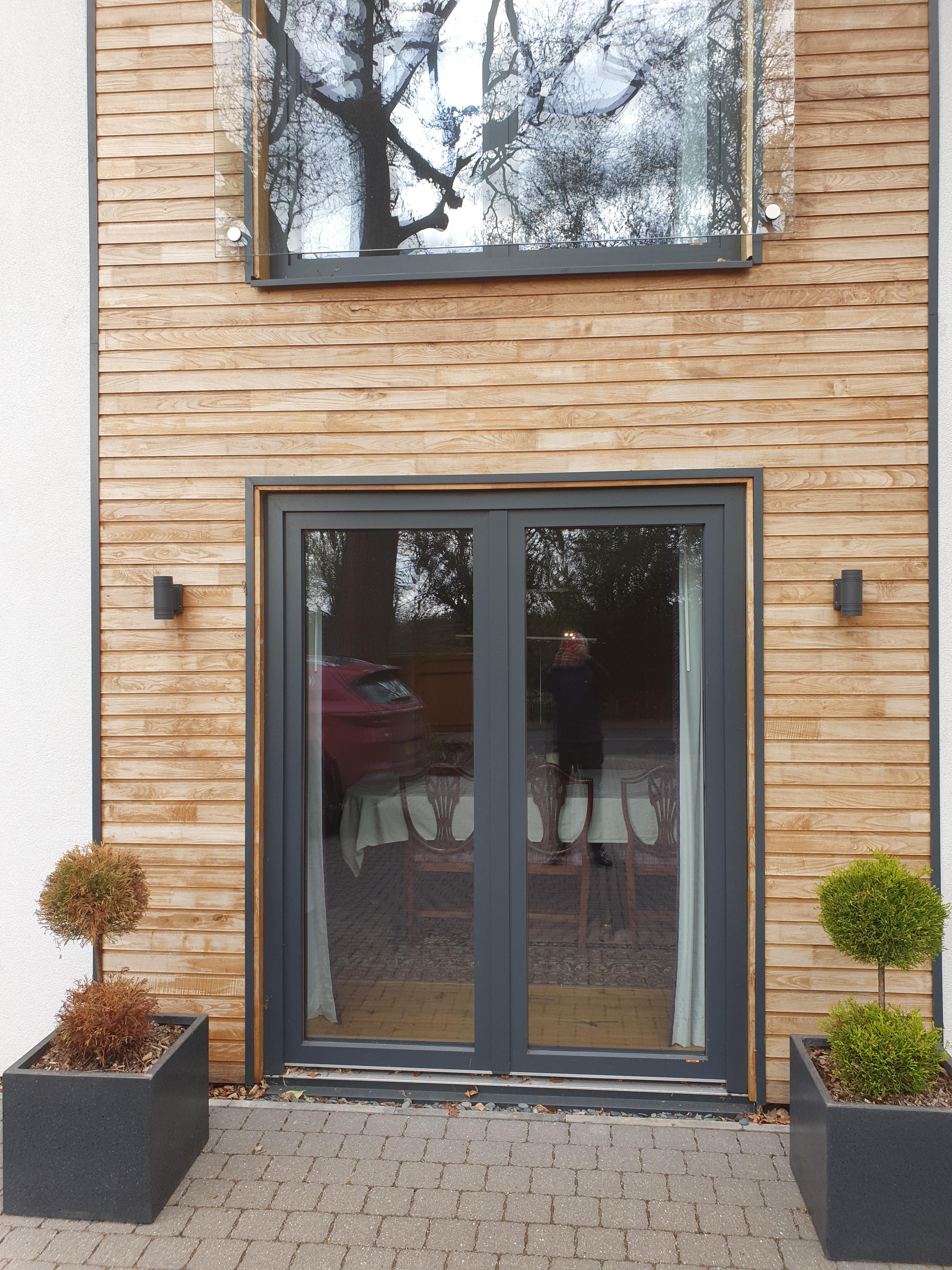

HerbJ Posted April 12, 2022 Share Posted April 12, 2022 (edited) Yes, we have sweet chestnut cladding that was treated with two coats of OSMO before installation, so it has not weathered too much in 5 years. It's performed OK and we are still pleased with the choice. The attached pictures are from December 2016, when it was completed. I will take some current and close-up pictures tomorrow. Edited April 12, 2022 by HerbJ Link to comment Share on other sites More sharing options...

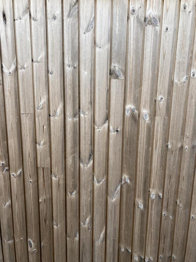

Modernista Posted April 12, 2022 Share Posted April 12, 2022 After going round in circles on wood cladding choices and getting very close to ordering Siberian Larch we've just settled on heat-treated radiata pine (Abodo). It's from NZ so can't beat home grown on wood-miles -and may be on the dark side colour-wise for some tastes but we've been worried about wetting and splashing in our house-with-no-gutters. We're having it stained a straw colour and it's to contrast with black-painted brickwork, so fingers crossed. Will post a pic when it's up. Link to comment Share on other sites More sharing options...

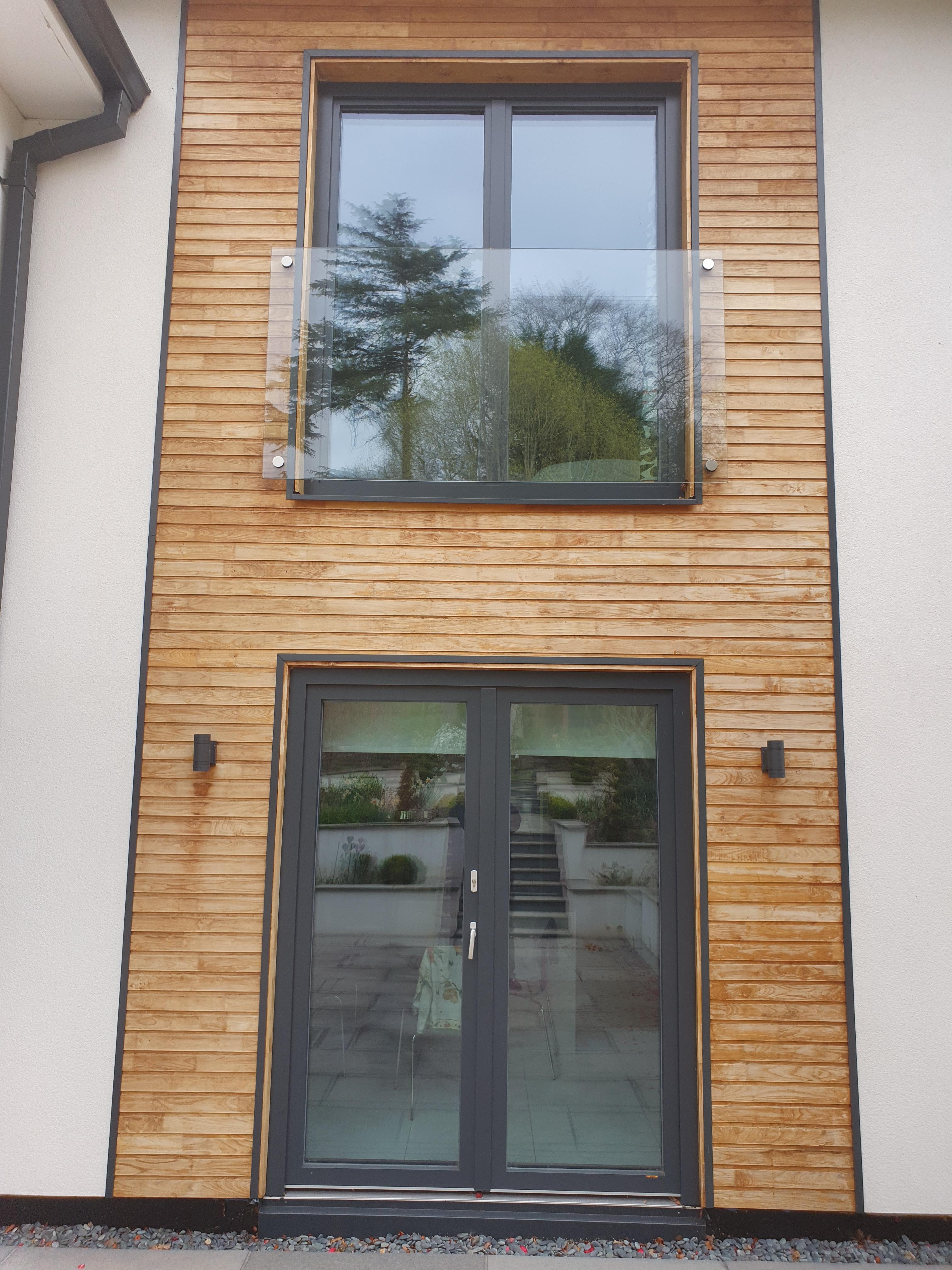

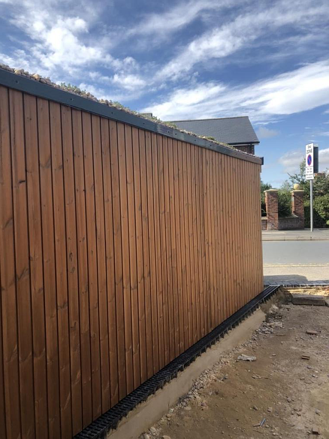

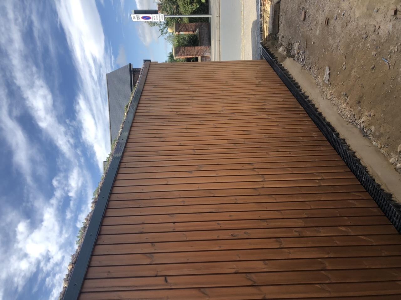

Rishard Posted April 12, 2022 Share Posted April 12, 2022 (edited) I’ve only really used Siberian larch and never Scottish. Mainly due to the supplier I use but they do produce good quality profiles. Duffields timber in North Yorkshire if you wanted to check them out. They might not come in the cheapest but always good to compare costs. I recently re-clad a clients gable with thermowood ( radiata pine) I’ve done plenty of jobs with it now. What I will say is it is super stable… I did some vertical shadow gap cladding for a shed 3 years ago with some square cut butt joints meeting on the counter batons and the stuff hasn’t moved 1mm. It works really well for contemporary looking finishes I would say. When I used it with a more traditional feather edge profile, I was a bit shocked at the grain or more the knot quality of the wood. It’s not particularly attractive when looking at such wide boards I don’t think. One good thing is it stays where you fix it. The initial colour is quite soft unlike fresh larch but un-treated they all end up that lovely silver colour. Not sure why I can’t turn these pictures the right way round. But this is 3 years apart. Thermowood. I have tons of pictures of western red cedar jobs, thermowood and larch if I can find a way to turn them the right way round on here? Edited April 12, 2022 by Rishard Link to comment Share on other sites More sharing options...

SteamyTea Posted April 13, 2022 Share Posted April 13, 2022 (edited) 45 minutes ago, Rishard said: Thanks @SteamyTea is there a feature somewhere to do that? Not on he forum. I use a small, portable, graphics program called Irfanview. Copy and paste the image into the program. Press L to rotate left, and R to rotate right. Then just select, copy and paste it back into the forum text box. Takes a few seconds. Edited April 13, 2022 by SteamyTea Link to comment Share on other sites More sharing options...
PeachyBeechy Posted April 14, 2022 Author Share Posted April 14, 2022 Thanks for that Rishard. Looks good in narrow boards. Herbj, thank you for your pictures. Looks very smart newly fitted. It would be good to see it aged if you can post a recent picture. But we are leaning towards the Chestnut. Thanks Miek for your experience of Larch and Ash. I didn't think about chestnut being used for shingles, of course it must be pretty durable. Link to comment Share on other sites More sharing options...
HerbJ Posted April 14, 2022 Share Posted April 14, 2022 As promised, photos from this morning. All the cladding was treated with OSMO UV Protection Oil before installation. Link to comment Share on other sites More sharing options...

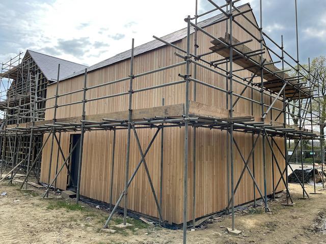

Thorfun Posted April 14, 2022 Share Posted April 14, 2022 probably doesn't help as you can't get hold of it but we were lucky and got our Siberian Larch just before the war kicked off. Chippies started putting it up this week and it looks fabulous. got an amazing price for it from Jewsons. saved thousands over Silva/Russwood etc. Link to comment Share on other sites More sharing options...

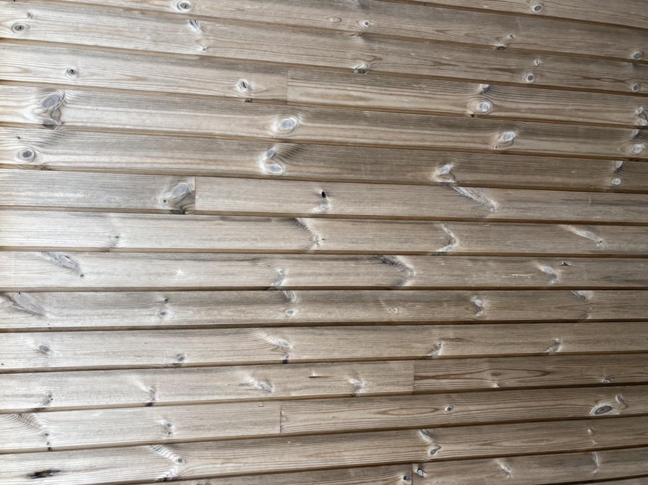

R2021 Posted March 10, 2023 Share Posted March 10, 2023 On 12/04/2022 at 22:49, Rishard said: I recently re-clad a clients gable with thermowood ( radiata pine) I’ve done plenty of jobs with it now. @RishardI've just bought 100m2 of Thermowood which I'm installing soon. Do you have any tips? It is T&G with shadow gap profile I read you butted up the boards tight against each other. Is that because there is no movement in Thermowood? I was a planning to leave a couple mm gap at the T&G and where two boards meet at a counter batten, but maybe I don't need to. Did you pre-drill the screw holes? I've heard Thermowood is brittle Did you use one or two screws side by side to secure each board to the counter batten? Did you put DPC between the board and the counter batten? Russwood's battening systems has this but I went to my local timber yard for the Thermowood and battens. Link to comment Share on other sites More sharing options...
Rishard Posted March 11, 2023 Share Posted March 11, 2023 My counter battoning is concrete screwed if going into blockwork. There is no need for dpc, I’ve never heard of dpc behind cladding as it is usually ventilated to some degree. Often there is a breathable membrane when applied over timber frame ect. I fix the cladding with stainless steel pins out of a nail gun. Either surface on wide boards or secret nailed on small profile boards. There is almost no movement across the cladding width or length so I wouldn’t worry about movement with thermowood. Link to comment Share on other sites More sharing options...
