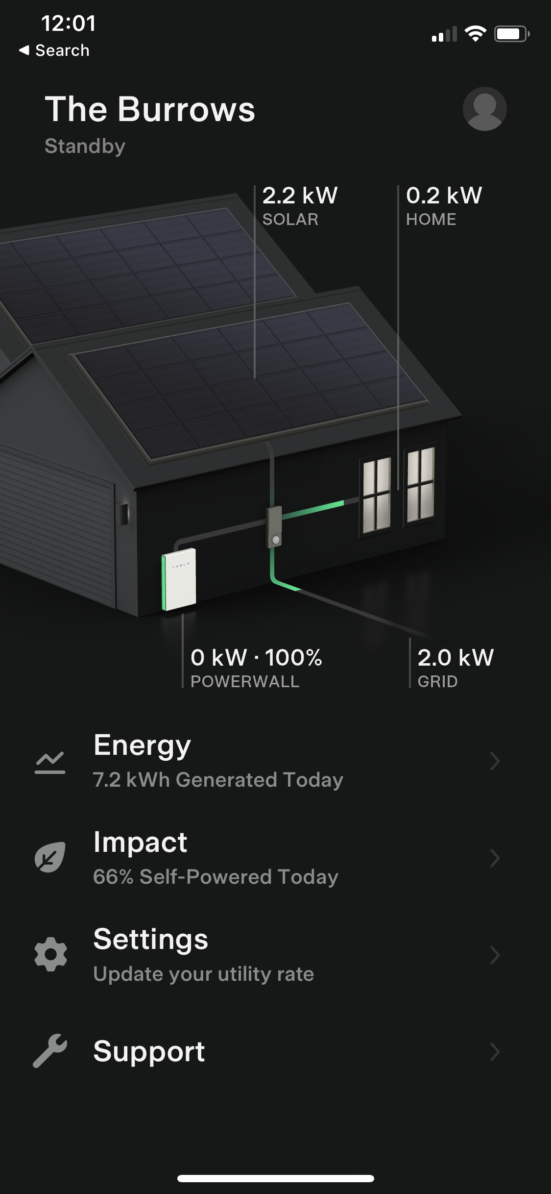

Pocster Posted March 26, 2022 Share Posted March 26, 2022 But you do get days like this ! EV 100% full so I have to export !! Link to comment Share on other sites More sharing options...
SteamyTea Posted March 26, 2022 Share Posted March 26, 2022 3 minutes ago, pocster said: But you do get days like this ! EV 100% full so I have to export Smug. But just think off all the poor people you are helping who have been waiting for nearly two decades for your local nuclear power station to get finished. Just charging up the battery in my mother's car as it has been sitting idle for 5 months. Sounds alright, in tickover, for a diesel. 1 Link to comment Share on other sites More sharing options...
Pocster Posted March 26, 2022 Share Posted March 26, 2022 1 minute ago, SteamyTea said: Smug. But just think off all the poor people you are helping who have been waiting for nearly two decades for your local nuclear power station to get finished. Just charging up the battery in my mother's car as it has been sitting idle for 5 months. Sounds alright, in tickover, for a diesel. Diesel ! . You and you alone are killing the planet ! . You’re in sunny Cornwall I should imagine even with a small pv array you could be filling your boots ! . Get her an EV and some pv ( it would be a good Mother’s Day present ) 😁 Link to comment Share on other sites More sharing options...

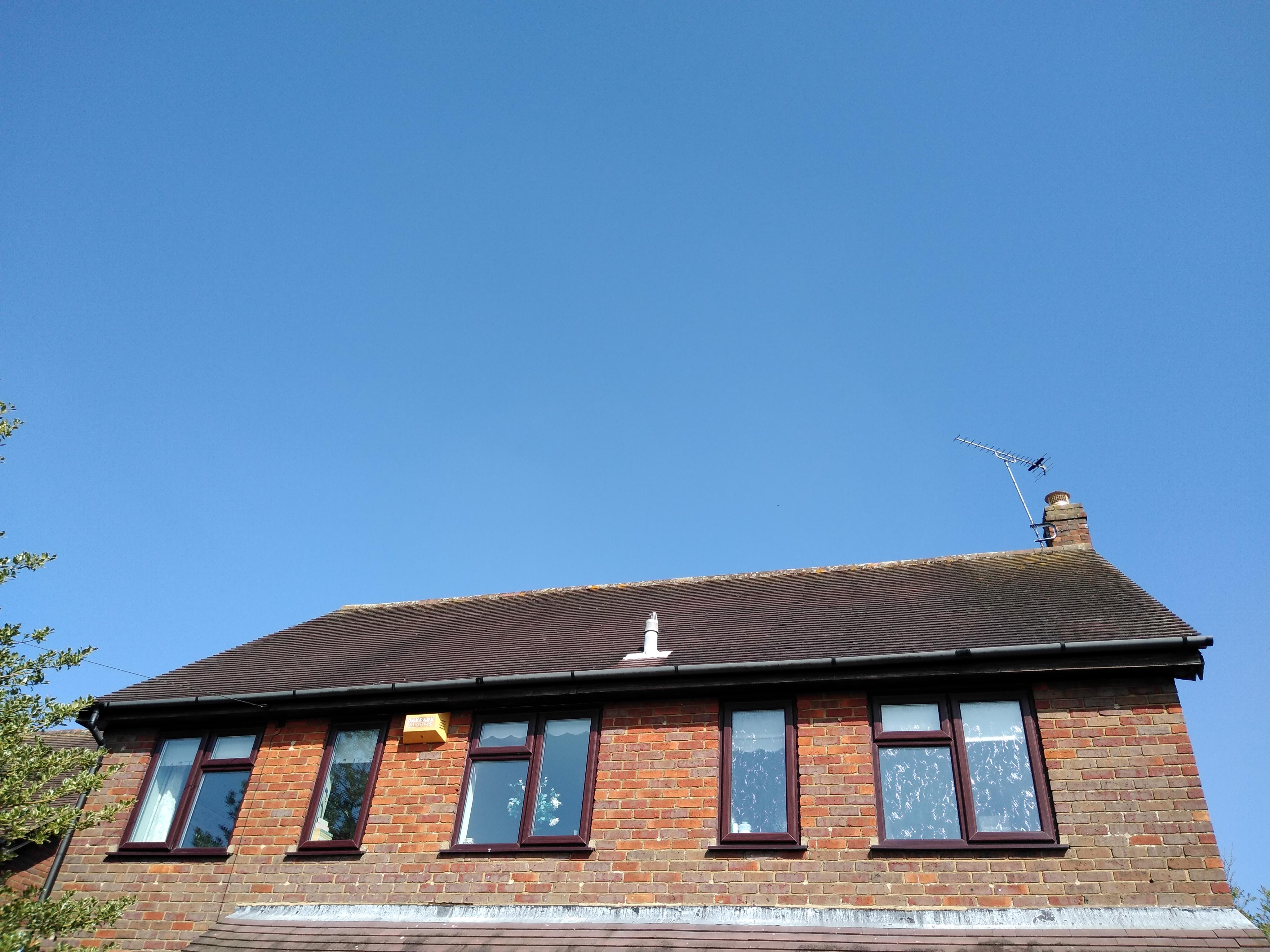

SteamyTea Posted March 26, 2022 Share Posted March 26, 2022 4 minutes ago, pocster said: Get her an EV and some pv ( it would be a good Mother’s Day present ) If I had known she would still be alive 5 months after her stroke, I would have got myself a hybrid for the weekly 600 mile journey. Recon I could get 8 kW on this roof. Lovely and sunny today. 2 Link to comment Share on other sites More sharing options...
Pocster Posted March 26, 2022 Share Posted March 26, 2022 3 minutes ago, SteamyTea said: If I had known she would still be alive 5 months after her stroke, I would have got myself a hybrid for the weekly 600 mile journey. Recon I could get 8 kW on this roof. Lovely and sunny today. Oh yes ! I’d pv that roof ! . Do that and get a battery ! Link to comment Share on other sites More sharing options...
