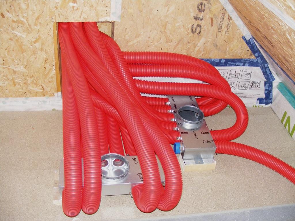

Rishard Posted March 13, 2022 Share Posted March 13, 2022 Ok great. Semi rigid looks straightforward enough. What’s the difference between radial and other designs? I’ve not read into this part much. Link to comment Share on other sites More sharing options...
TerryE Posted March 13, 2022 Share Posted March 13, 2022 19 minutes ago, ProDave said: The easiest for DIY is the semi rigid ducting and a radial system to a plenum box. Pretty much identical to mine except that I put the manifolds in a cupboard in the loft so the pipe go down into the floor rather than up into a wall Link to comment Share on other sites More sharing options...
TerryE Posted March 13, 2022 Share Posted March 13, 2022 9 minutes ago, Rishard said: What’s the difference between radial and other designs? IMO, they are easier to balance and a lot easier to run: no pipe Ts or joints; just a 1-1 from the central manifold to the individual vent, Link to comment Share on other sites More sharing options...

Rishard Posted March 13, 2022 Share Posted March 13, 2022 So from outside to inside it’s. Atmosphere-mvhr box- manifold- smaller ducting to plenums in each room. One manifold serving exhaust one manifold serving supply? In a 2 story building is the main unit better on ground or first floor. We plan to have vaulted ceilings so probably won’t have attic space. A small space could be created above a bedroom ceiling if this is a preferable location. Link to comment Share on other sites More sharing options...
ProDave Posted March 13, 2022 Share Posted March 13, 2022 39 minutes ago, TerryE said: Pretty much identical to mine except that I put the manifolds in a cupboard in the loft so the pipe go down into the floor rather than up into a wall Mine is on the first floor, so some go up into the loft for the upstairs rooms, and some go down into the floor void for the downstairs rooms. Every install is individual, there is no right or wrong. Link to comment Share on other sites More sharing options...

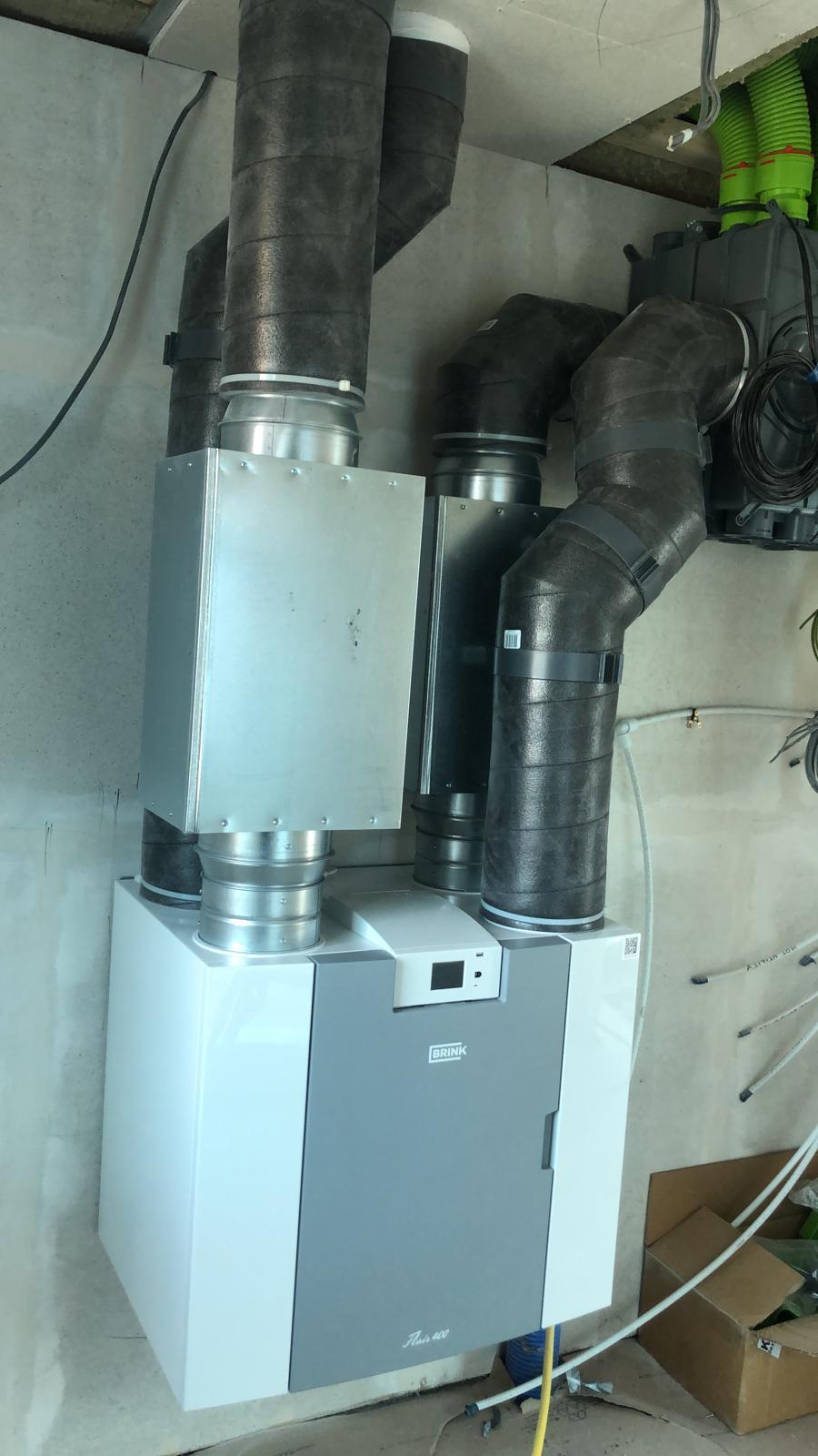

Nickfromwales Posted March 14, 2022 Share Posted March 14, 2022 8 hours ago, Rishard said: So from outside to inside it’s. Atmosphere-mvhr box- manifold- smaller ducting to plenums in each room. One manifold serving exhaust one manifold serving supply? In a 2 story building is the main unit better on ground or first floor. We plan to have vaulted ceilings so probably won’t have attic space. A small space could be created above a bedroom ceiling if this is a preferable location. Yes, a manifold for each. The only thing missing from your line up would be the attenuators. The silver boxes in the image. I never do an MVHR install for a client without them tbh, as my focus is always on having a system which is inaudible on trickle rate and that starts with a design where such things are considered and factored in early on in the build process ( eg so the required plant space can be realised, as that is often under-estimated ). One such current project has needed the plant space increased to almost twice the original size allowed by the architect!! Nearly half the utility room had to be sacrificed or we wouldn't have got everything in. It still surprises me that self-builders ( and their architects ) will apply an allowance that they deem is 'sufficient' for plant space, and not engage earlier with an M&E consultant to get this fully understood before finalising plans. Having a mechanical system which is running 24/7/365 says it should have your undivided attention from the get-go, even more so when it is a system with the second largest bore distribution ducting after the soil pipework and may require penetrations through steels etc. I've also now started installing the Brink Air Comfort units too, which are supplied with either warm or cold water from the ASHP to give active post heating / cooling. These take up quit a bit of space though, but are a great companion to the Brink MVHR units. They're basically an intelligent FCU where the fans speeds get matched ( the Air Comfort has aits own integral fan to alleviate any stress on the MVHR unit fan which balances itself to the correct pressure / flow rates ) Nice bits of kit tbh. Attenuators on that install also. These installs really do need some thought and planning, but the results, as @TerryE's calcs demonstrate, can be very well worth the capital investment of such a system, purely in the knock-on costs they may negate eg not needing heating on 1st & 2nd floors because of the heat recovery element factored into the MVHR design. I'd rather spend money on a system that will save me buying fuel for heating, plus gives me an option to integrate cooling ( where an ASHP is present ), plus any money saved can be deducted from the supply and fit costs of the MVHR. Add to that the constant fresh air supply to all the rooms, 24/7, plus the ability to go mad with airtightness to vastly minimise ventilation heat loss, the biggest issue any dwelling would have, ( more so than having great levels of insulation ), as also stated above is a complete no-brainer. Link to comment Share on other sites More sharing options...

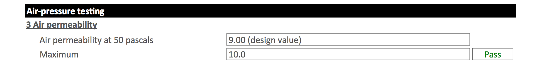

deuce22 Posted March 14, 2022 Author Share Posted March 14, 2022 14 hours ago, JohnMo said: Out of interest what airtightness figure was used to get an 88 from SAP? I haven't had an airtightness test done yet. 13 hours ago, Nickfromwales said: Brink Flair 400 would be suitable. Change of £2.5k. PH certified and very quiet / robust. I've had great feedback from clients we've fitted these for, and the guys at CVC Ltd have provided the units, associated materials and design support with excellent results every single time. Very quiet units, but we always fit silencers ( aka attenuators ) in every instance for near inaudible operation, often inaudible at trickle rate and only slightly notable during boost. I'll have a look into these today, thanks. 13 hours ago, Rishard said: Another learner venturing into mvhr systems. I’m also very early in our project, planning passed and working towards building control application stage/demolition of existing structure.. we are 200m2. Any other recommendations for supplier designs to quote for our system? I will be installing as I’ll be doing most of the build (builder) along with good plumbing/electrician friends. None with much mvhr experience on low energy housing, yet! I'm in a similar situation to you. A builder with some decent tradesmen friends to help out. Link to comment Share on other sites More sharing options...

dpmiller Posted March 14, 2022 Share Posted March 14, 2022 19 minutes ago, deuce22 said: 14 hours ago, JohnMo said: Out of interest what airtightness figure was used to get an 88 from SAP? I haven't had an airtightness test done yet. But there needs to be a number typed into your design SAP- what was it? Link to comment Share on other sites More sharing options...
deuce22 Posted March 14, 2022 Author Share Posted March 14, 2022 5 minutes ago, dpmiller said: But there needs to be a number typed into your design SAP- what was it? Is this it? Link to comment Share on other sites More sharing options...
