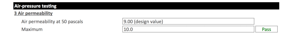

Based on that figure, the fans specified as intermittent are fine.
But with a polystyrene ICF build you may be a lot more air tight and could end up with mould, poor air quality etc.
As a minimum I would get dMEV installed, these fans will fit into the existing/planned holes in the wall, match the windows you may have already been installed/ordered, with trickle vents and give you the least hassle.  Best of all they are silent.  The way dMEV works, the fans run at a low speed continuously, extracting air from the wet rooms.  Air is drawn in through tickle vents in dry room windows.  The air cross flows through the house/under doors etc. and out through the wet room fans.  Think you are aiming for 0.3 ACH through the ventilation system.

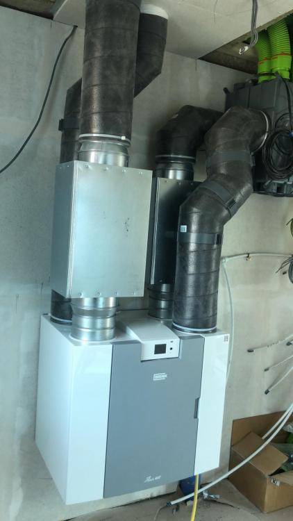

The MVHR system was one of the things that Jan and I did ourselves.  The sizing calcs are straightforward as is a star manifold installation, though to do need to properly calibrate and commission the system.  If done properly, the B Insp will accept a self-certified commissioning report.  It performs really well.

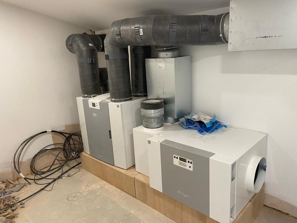

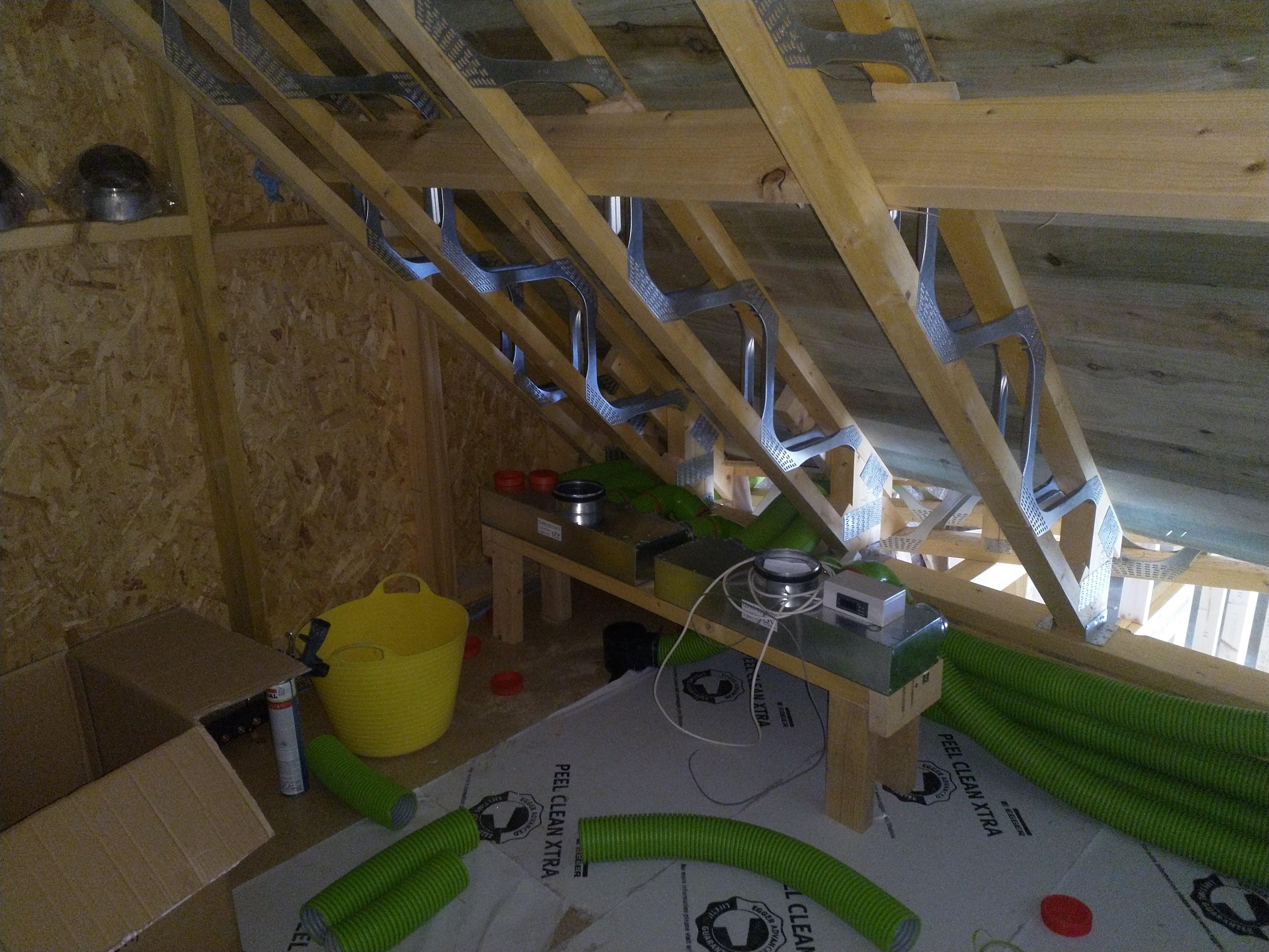

Designed plans for the MHVR unit have changed in reality with our ICF build. Initially we had the manifolds in the plant room on the ground floor but we have fitted them in the loft as there are way more ducts to the 1st floor than the ground. It's a warm roof. The unit is still within the plant room but moved slightly because of the manifold change. Luckily we have enough room in there to do this. There is a cupboard above the plant room which means we can hide all the pipework from the loft to the unit well and again allowed for variations in locations of the manifolds and unit.
Our original design came off our plans emailed to a company with no one visiting the build. As already alluded to it is advisable to have some degree of flexibility if possible to move things around.

The issue is those free services make a lot of assumptions. The good ones take this into account and also understand all your systems and services, the others sometimes forget to tell you that you need “x ducts of 75mm through the floor” which is something if you have beam and block you need to know about at design time not installation !
As @Nickfromwales and @Happy Valleypoint out - plant space is premium in a build and it is surprising how little gets planned in to start with. If you search MVHR installation on the forum you’ll find plenty of examples of people having to be creative in siting units to take into consideration space that hasn’t been planned at design time.

Read building regs related to ventilation that will tell you exactly what is needed, for flow rates in each room, but base any discussion on an airtightness of less than 5.
