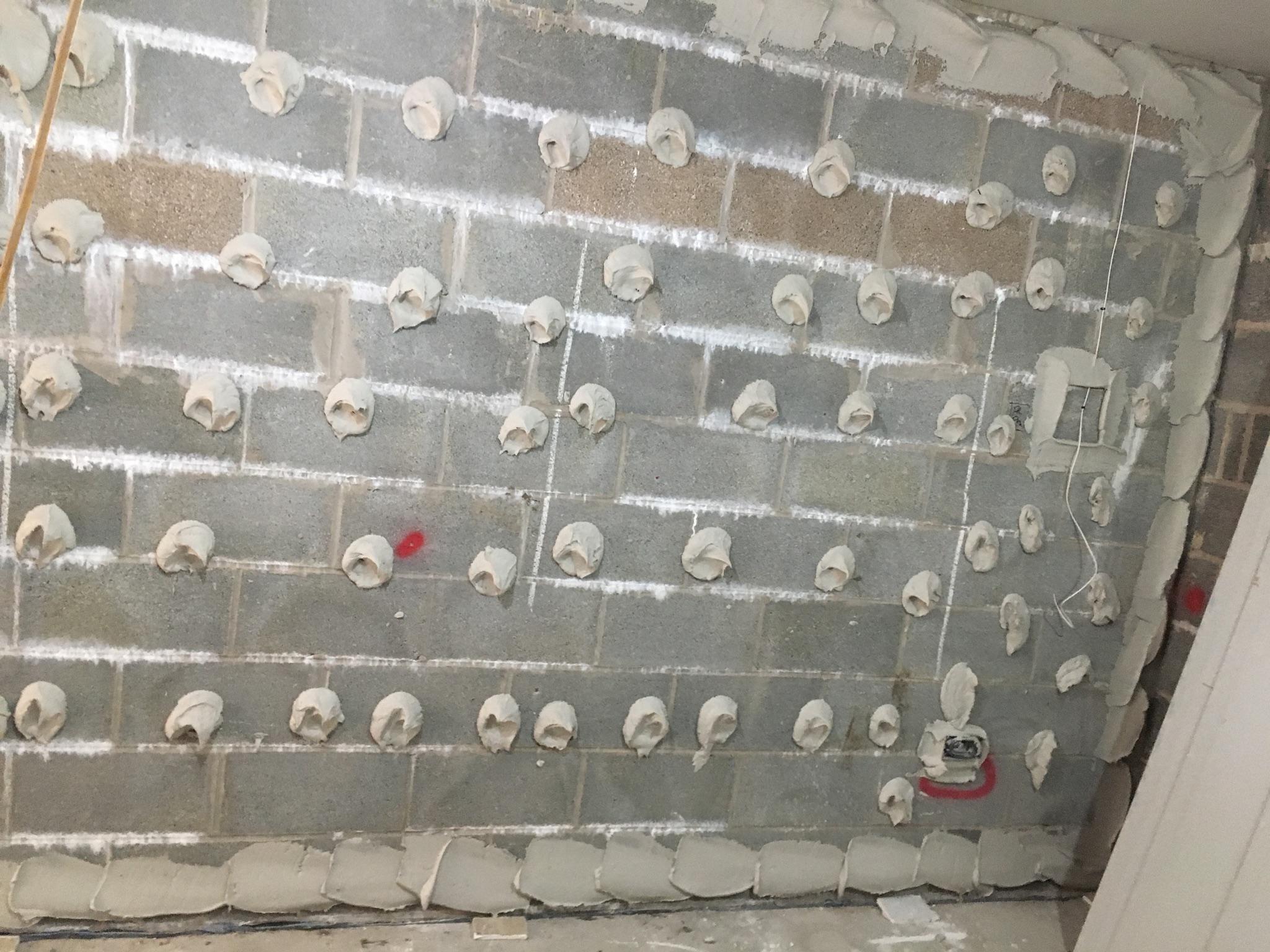

nod Posted March 9, 2022 Share Posted March 9, 2022 As above You can achieve perfect airtightness with Dot and dab No need Parge It’s. not worth the money But you do need good attention to detail Junctions sockets etc 1 Link to comment Share on other sites More sharing options...

nod Posted March 9, 2022 Share Posted March 9, 2022 48 minutes ago, Chanmenie said: @nod I’d be really interested to learn how to get perfect airtightness with dot and dab A continuous line of adhesive around the perimeter of each wall Also the same with switches and socket Acoustic sealant needs to be used around All edges of plasterboard walls an ceilings Where they meet external block Link to comment Share on other sites More sharing options...
Onoff Posted March 9, 2022 Share Posted March 9, 2022 26 minutes ago, nod said: A continuous line of adhesive around the perimeter of each wall Also the same with switches and socket Acoustic sealant needs to be used around All edges of plasterboard walls an ceilings Where they meet external block How are the block joints made airtight? 1 Link to comment Share on other sites More sharing options...

Nickfromwales Posted March 9, 2022 Share Posted March 9, 2022 12 hours ago, richo106 said: 2. 5/6mm parge coat then dot and dab - this what plasterer recommends (best of both worlds) For anyone not well versed in this, and for pretty much guaranteed results, this is a good option. Fast, good airtightness, and walls can be made arrow straight. Fortify this with tapes / membranes and you'll achieve great results. 1 Link to comment Share on other sites More sharing options...
