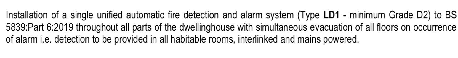

Adsibob Posted March 6, 2022 Share Posted March 6, 2022 I have a very open plan layout at ground floor which caused our BCO to insist we get a fire engineering report. The report requires us to get a sprinkler system and also to do this: I have found a BS 5839 part 6 Grade D2 mains powered interlinked fire alarm which I like because it is quite small and unobtrusive, but it is a heat alarm not a smoke alarm. I think these go in the kitchen normally, but any reason why all the alarms in my house can’t be of this heat detection type, rather than smoke? Link to comment Share on other sites More sharing options...

Adsibob Posted March 6, 2022 Author Share Posted March 6, 2022 I guess I’m just wondering what the legal requirement is. The report says “fire detection and alarm system”, so I’m just wondering whether compliance would be satisfied with a heat alarm system. We have a large open plan area off the kitchen, and given the toaster in the kitchen and the wood burning stove at the other end of the open plan space, the potential for false alarms is fairly high. I was therefore thinking of installing the majority of the alarms on the ground floor as heat alarms. Happy to have smoke alarms on the upper floors. Link to comment Share on other sites More sharing options...
JohnMo Posted March 6, 2022 Share Posted March 6, 2022 Not sure where you live. But in Scotland, you have to have a heat alarm in a kitchen area, you cannot install a smoke alarm. Every home must have: one smoke alarm in the living room or the room you use most one smoke alarm in every hallway and landing one heat alarm in the kitchen All smoke and heat alarms should be mounted on the ceiling and be interlinked. If you have a carbon-fuelled appliance – like a boiler, fire, heater or flue – in any room, you must also have a carbon monoxide detector in that room, but this does not need to be linked to the fire alarms. If an area is open plan, one alarm can cover the whole room provided it can be located where it is no more than 7.5 metres from any point in the room. If your space includes a kitchen area it should be a heat alarm rather than a smoke alarm Link to comment Share on other sites More sharing options...
Adsibob Posted March 6, 2022 Author Share Posted March 6, 2022 4 minutes ago, JohnMo said: Not sure where you live. But in Scotland, you have to have a heat alarm in a kitchen area, you cannot install a smoke alarm. Every home must have: one smoke alarm in the living room or the room you use most one smoke alarm in every hallway and landing one heat alarm in the kitchen All smoke and heat alarms should be mounted on the ceiling and be interlinked. If you have a carbon-fuelled appliance – like a boiler, fire, heater or flue – in any room, you must also have a carbon monoxide detector in that room, but this does not need to be linked to the fire alarms. If an area is open plan, one alarm can cover the whole room provided it can be located where it is no more than 7.5 metres from any point in the room. If your space includes a kitchen area it should be a heat alarm rather than a smoke alarm I live in England. I will call the fire engineer that charged us an arm and a leg for a cut and paste job and see if I can get some more information. Link to comment Share on other sites More sharing options...
ProDave Posted March 6, 2022 Share Posted March 6, 2022 1 hour ago, Adsibob said: I guess I’m just wondering what the legal requirement is. The report says “fire detection and alarm system”, so I’m just wondering whether compliance would be satisfied with a heat alarm system. We have a large open plan area off the kitchen, and given the toaster in the kitchen and the wood burning stove at the other end of the open plan space, the potential for false alarms is fairly high. I was therefore thinking of installing the majority of the alarms on the ground floor as heat alarms. Happy to have smoke alarms on the upper floors. We have a heat alarm in the kitchen and a smoke alarm in the adjacent hall, and the smoke alarm has never triggered even when cooking with the doors open. Link to comment Share on other sites More sharing options...

TonyT Posted March 6, 2022 Share Posted March 6, 2022 (edited) Ask your local authority what they want, are you using mains cabling type, battery or fire alarm based system? who is designing the M&E system? did the ‘Architect’ come up with a fire strategy? Edited March 6, 2022 by TonyT Link to comment Share on other sites More sharing options...
ProDave Posted March 6, 2022 Share Posted March 6, 2022 8 hours ago, Adsibob said: I have a very open plan layout at ground floor which caused our BCO to insist we get a fire engineering report. The report requires us to get a sprinkler system and also to do this: Can you tackle this another way? Find out what you would need to do to make it less "open plan" so BC would accept conventional domestic smoke alarms and see if you can find a compromise. Remember you are not obliged to actually shut a door so would a partition with a pair of sliding pocket doors satisfy BC yet still leave it open plan enough for you with both doors slid into their pockets? Link to comment Share on other sites More sharing options...

ToughButterCup Posted March 6, 2022 Share Posted March 6, 2022 (edited) 11 hours ago, Adsibob said: ...but any reason why all the alarms in my house can’t be of this heat detection type, rather than smoke? Yes. The answer to your problem is really simple: the types of fire detection are a matter for a competent designer . How those detectors look isn't (because they in turn will have been designed by competent designers). i.e. there are a range of sensor designs from which to choose commission the fire engineering report send the fire engineer your architects plans in relation to fire suppression send a copy of the fire engineers report to the BCO for approval - and wait for the response from his office meanwhile: send a copy of the report to two or three fire systems suppliers and ask them for a price to supply and fit (VAT NOT CHARGED ON SUPPLY AND FIT) Read the BCO's response to the design. If it varies from the design that you have commissioned , send the BCOs response to the fire company. Do not pay them anything until the BCO and the company have come to some form of agreement. Do NOT just fit what the fire equipment company says : the BCO can (and in our case did) reject the company's design and require additional protection. After it had been fitted. Cue noises from one AnnoyedButToughButtercup After doing Due Diligence, ask the suppliers to fit equipment which you want (that may well mean leg-work looking for unobtrusive equipment of the right type for your fire design) Yes, what am saying is, that a nominally Competent Designer (as defined in CDM2015 as amended) official design can be challenged by a BCO ( he / she won't sign your house off). And that has happened to us. And, a year later, I'm still trying to unpick the problems caused. Can't take a joke? Don't self-build. Edited March 6, 2022 by ToughButterCup Link to comment Share on other sites More sharing options...

Adsibob Posted March 6, 2022 Author Share Posted March 6, 2022 26 minutes ago, Nickfromwales said: Does this requirement actually not read "automatic fire suppression system"? I've pasted directly from the report in the OP. Here it is again:, this is separate to the requirement to have a sprinkler system (which is a separate part of the report and which I've already installed). Link to comment Share on other sites More sharing options...
TonyT Posted March 6, 2022 Share Posted March 6, 2022 (edited) https://www.aico.co.uk/wp-content/uploads/2021/06/Ei3024-Ei3016-Ei3014-Instructions-1-1.pdf for some good reading heat in kitchen smokes in hallways/landing. and or follow JohnMo previous post. In adding to living room etc if in doubt run 3core and earth to points and leave an unbroken loop behind the plasterboard for future use Edited March 6, 2022 by TonyT Link to comment Share on other sites More sharing options...
