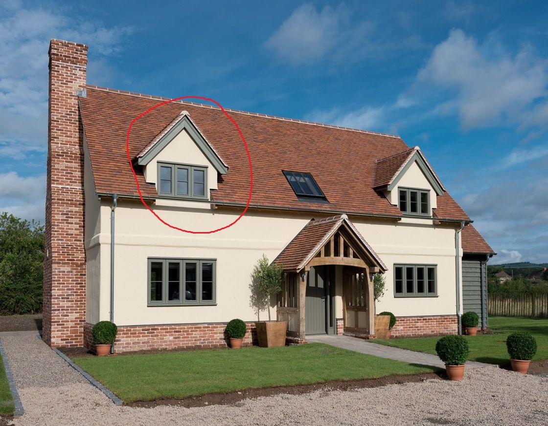

CharlieKLP Posted April 3, 2022 Share Posted April 3, 2022 this is a little like design by committee lol, it’s looking a bit of a camel. How are you supporting the dormers, if they are flush with the main walls, then they will be unsupported brickwork. I don’t know if your architect is terribly experienced? Link to comment Share on other sites More sharing options...

CharlieKLP Posted April 3, 2022 Share Posted April 3, 2022 (edited) That’s a lightweight clad building, ie it’s a timber frame with a skin of plaster board and render on the outside. I think it’s Border Oak? You can no longer build that way, unfortunately. Timber frame requires a layer of block on the outside or you can’t get a building warranty. also, note the terrible gutter situation on that house, ick. I think you should demand someone decent steps in, if you’re paying for it you shouldn’t get the office junior. I think you should get a divorce 😋, the porch is not helping your house. Edited April 3, 2022 by CharlieKLP Link to comment Share on other sites More sharing options...

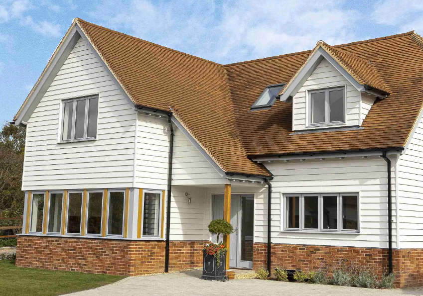

Gus Potter Posted April 3, 2022 Share Posted April 3, 2022 On 02/04/2022 at 13:32, Selfbuildnewbie said: Hi everyone, We have an updated set of floor plans back from our architect. Front elevation has been changed to more in line with what @CharlieKLP and @ETC suggested and the store room has been replaced by a study. We couldn't find a way to change the large gable on the rear without over-compromising on the floor plan though. We'd appreciate any suggestions on the following: Finding somewhere for a fairly large coat/shoe cupboard in the vicinity of the front door. Our architect hasn't currently found anywhere suitable aside from a small cupboard under the stairs and it's a bit too far from the front door. The only solution I can think of is to push the stairs back by, say, half a metre, make the kitchen 4.8m deep rather than 5.4m and then fit the coat cupboard in on the right hand side at bottom of the stairs, with a pocket door. We'd put kitchen units or cupboards under the half-landing of the stairs (if that is structurally possible?) so, in effect, retaining a 5.4m deep kitchen. I've mocked that idea up, see below - I would appreciate any thoughts on whether that could work. Any other ideas on how we could fit the cupboard in? Access from kitchen/diner to living room - the architect has suggested inserting two 1.1m pocket doors between the kitchen/diner and living room (one at each end) which can be left open most of the time. That fits our brief for a "broken plan" feel but we're not sure it completely works as drawn at the moment. Presumably it would be better if the dining table was turned 90 degrees? And the pocket door at the bottom is too central on the living room wall and currently opens onto the back of a sofa. Any suggestions for how it could be made better? Any other comments on the floor plans also very welcome. Bit of SE input here just to complicate matters! When the wind blows it endevours to collapse your house like a pack of cards. To provide a bit of context. Even in benign parts of the UK you are designing for a magnitude of 200 -250 kg of force for every square meter of upwind elevation exposed to the wind. You can quickly see that the sideways load is quite a lot, given that say a family car may weigh some 800kg? Also the roof.. it is quite a big house and the roof acts like a sail on a boat.. more force. Some of this sideways load is resisted by the outside walls but when you put big openings in them they don't work so well. Thus to offset this you want a good few walls internal walls on the ground floor in both front to rear and gable to gable directions. Ideally you want walls that are longer than they are tall both internally and externally. This is a good way of grasping what will be an economic structural concept. At first glance your ground floor layout looks like you will need to spend a bit more on the structure, possibly more than you want. The pocket doors are shown within the thickness of a standard wall.. tricky. If you look at how much wall you have left that is available to turn into a structural wall then you don't have much to play with particularly in the gable to gable direction. You can still have pocket doors but often you need to thicken the wall so that one part of it still remains a structural wall that can carry both vertical loads from the floors above and resist the wind loads. You have some pretty big spans there on the ground floor and a fair number of things above to hold up so bearing this in mind.. I would ditch the pocket doors from an SE point of view. Also in service.. having pocket doors from say living room to a music / tv room does not stack up due to sound transmission. It's great the open plan idea but they can be noisy. It's time to put some gridlines on these drawings at the concept stage so you can see how things line up properly. You could easily loose thousands here by needing extra structural works that are not required! Link to comment Share on other sites More sharing options...
Selfbuildnewbie Posted April 3, 2022 Author Share Posted April 3, 2022 @CharlieKLP and @Gus Potter - thank you, some really useful advice. Much appreciated. Just going back to the porch, if you take this house, stretch it a bit wider, and move the dormer left a bit, you get something akin to the shape of our house. Please could I get the committee's views on whether a porch like in the picture below might look okay on our house? 1 Link to comment Share on other sites More sharing options...

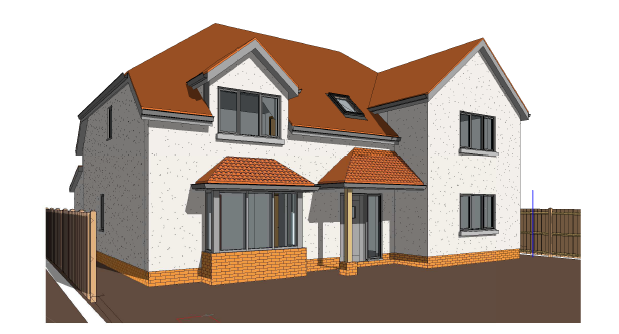

Selfbuildnewbie Posted April 8, 2022 Author Share Posted April 8, 2022 Hi folks, our architect has provided some basic 3D visuals of the exterior, with an updated porch which does look a bit better than the previous attempts. Appreciate the design is not everyone's cup of tea, but we're always keen to hear suggestions or tweaks that people would make, including choice of materials and colours. Render colour and windows will probably be more of a cream and agate grey combo, something like in the border oak image above. Still discussing those dormers with the architect given the previous discussions on this thread. Link to comment Share on other sites More sharing options...
Buzz Posted April 8, 2022 Share Posted April 8, 2022 37 minutes ago, Selfbuildnewbie said: Appreciate the design is not everyone's cup of tea, but we're always keen to hear suggestions or tweaks that people would make, including choice of materials and colours. This is the best thing about designing and building your own home , its all about what you want , like and need . As for materials and colours I would have black roof tiles and definitely go for clay whatever colour you choose as concrete ones age and start to look tired a lot quicker than you think. Link to comment Share on other sites More sharing options...

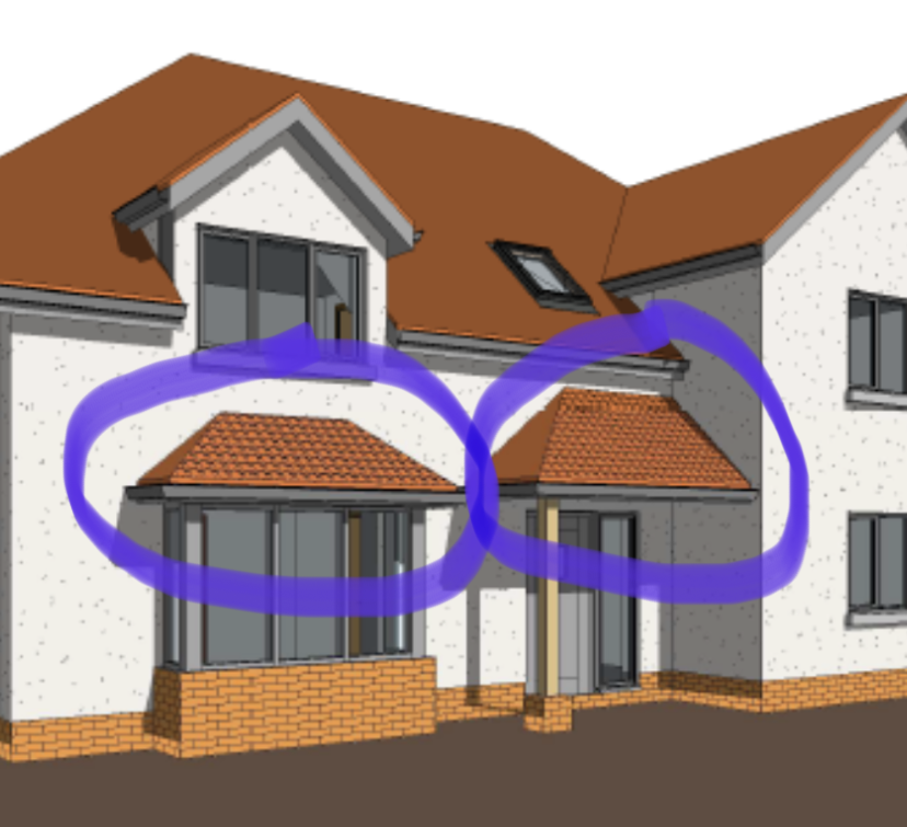

Adsibob Posted April 8, 2022 Share Posted April 8, 2022 Can you make both these roof structures look the same height and pitch, so as to give a bit more balance and symmetry to the front: Link to comment Share on other sites More sharing options...
Adsibob Posted April 8, 2022 Share Posted April 8, 2022 57 minutes ago, Selfbuildnewbie said: On the top picture, the right hand side windows look a bit small. Link to comment Share on other sites More sharing options...
Simplysimon Posted April 9, 2022 Share Posted April 9, 2022 as with @Adsibob would it not be possible to run one roof along the front, porch and bay, as with the back? Link to comment Share on other sites More sharing options...
Adsibob Posted April 9, 2022 Share Posted April 9, 2022 1 hour ago, Simplysimon said: as with @Adsibob would it not be possible to run one roof along the front, porch and bay, as with the back? that’s an even better idea. 1 Link to comment Share on other sites More sharing options...

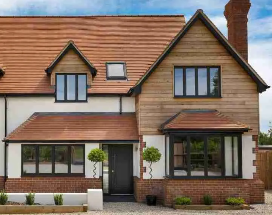

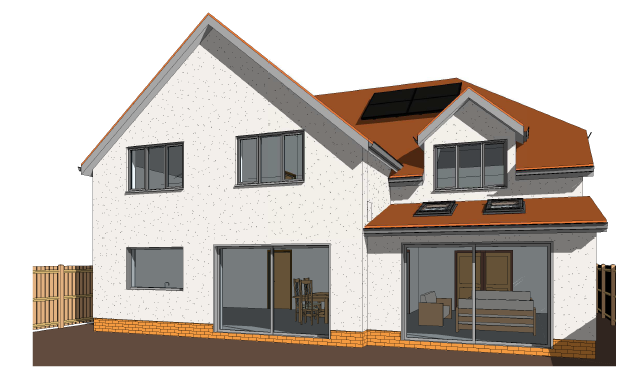

CharlieKLP Posted April 9, 2022 Share Posted April 9, 2022 (edited) I think it would look better to make the main roof into the porch. Just continue the roof down. Like ETC said. do it at the rear too, there’s no reason the conservatory area needs a different roof. I like the bay separate though. It’s nice that it is it’s own thing. Edited April 9, 2022 by CharlieKLP Link to comment Share on other sites More sharing options...
