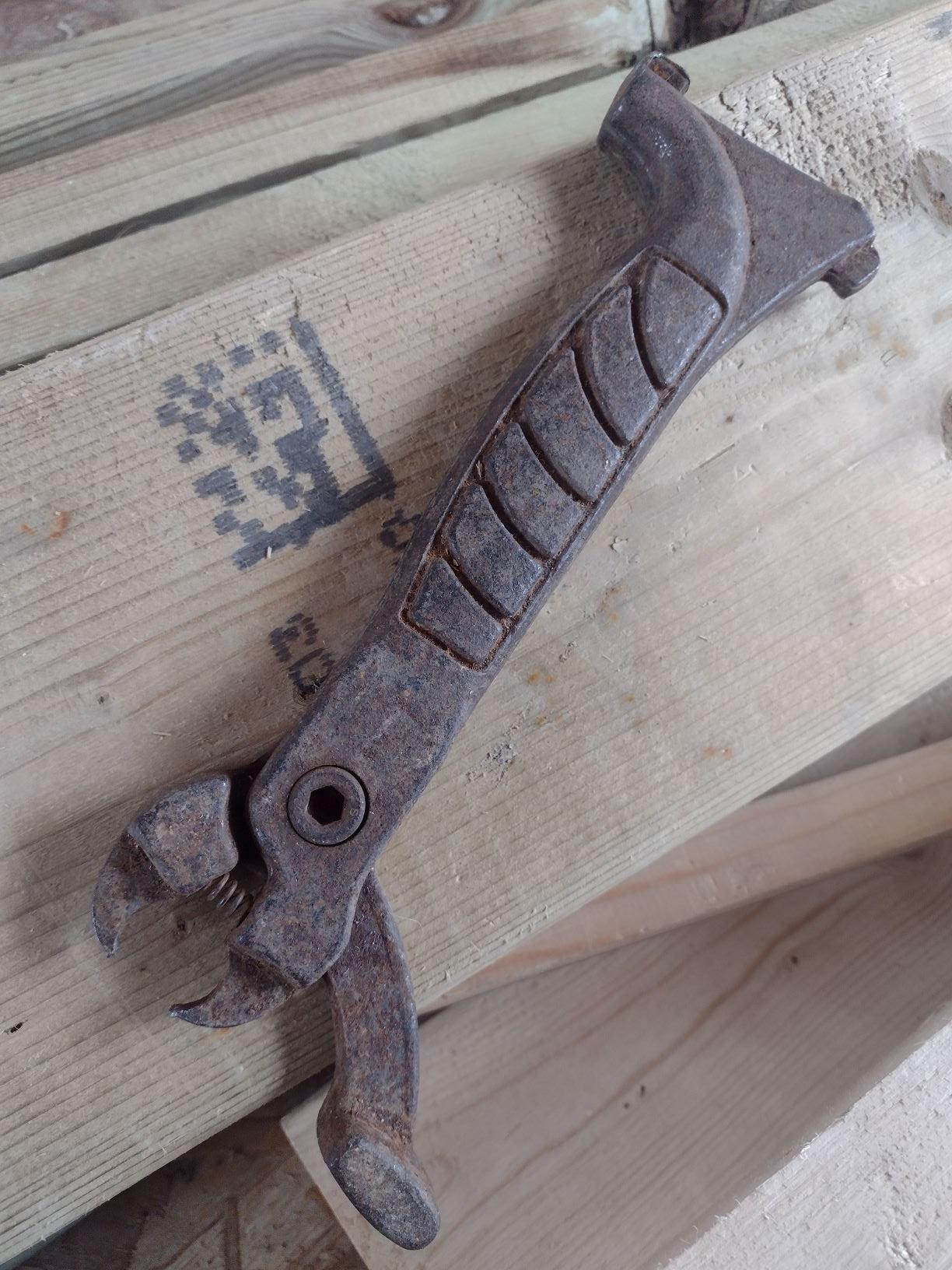

SimonD Posted February 5, 2022 Posted February 5, 2022 12 hours ago, saveasteading said: Old fashioned, lever the tails up, knock them through and claw hammer/nail bar? With the twist on them, does the levering/mole grips work? I once had to take apart a significant proportion of the roof on an 1840s workers cottage in situe and salvage the timbers for reuse. Two tools I came to love for this are 1, a japanese nail puller, 2, A nail puller similar to this Hultafors version I bought years ago in Sweden https://www.hultafors.com/products/hammers/H0208-nail-puller-atle/79452 - I've rescued a good number of floor joists from metal hangers with this tool too. Both will put out square twists as once they're dislodged, they pull out realy easily. If you go for cutting, then a circular saw with suitable blade for chomping nails work well, providing you can support the truss to avoid pinch. 1

saveasteading Posted February 6, 2022 Author Posted February 6, 2022 13 hours ago, Russell griffiths said: throw the small bit and metal work on a bonfire The 'small bit' is 1m long as the ties are quite high (hence the walls displacing in the first place). It might be the solution though, if we cut the ties off close to the rafters, losing 2 x 300mm, then try to get the stubs off on the ground, salvaging most of the wood. This tool looks 'the business'. 12 hours ago, SimonD said: A nail puller similar to this Hultafors version I bought
SteamyTea Posted February 6, 2022 Posted February 6, 2022 5 hours ago, saveasteading said: The 'small bit' is 1m long as the ties are quite high (hence the walls displacing in the first place). It might be the solution though, if we cut the ties off close to the rafters, losing 2 x 300mm, then try to get the stubs off on the ground, salvaging most of the wood. This tool looks 'the business'. Will it actually pull out a twisted nail?
Hobbiniho Posted February 8, 2022 Posted February 8, 2022 yeh those type of nail pullers will pull out twist nails easily, if they are hammered through and bent over i would first cut off the bent over bit with a grinder with a slitting disk, and then give the nail a good smashing from the back, this will break the "seal" that the nail has, always funny trying to explain to people the best way to remove an old nail is to hammer it in first ??
SimonD Posted February 9, 2022 Posted February 9, 2022 On 06/02/2022 at 01:22, saveasteading said: This tool looks 'the business'. On 06/02/2022 at 07:02, SteamyTea said: Will it actually pull out a twisted nail? Just came across mine - battered and well used. Works well with square twist nails and with the one I've got, you can smack the handle even with a lump hammer to get those stubborn nails out. 1
