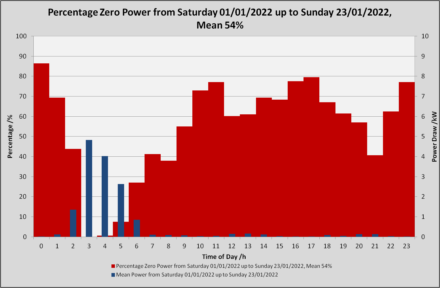

SteamyTea Posted January 26, 2022 Share Posted January 26, 2022 5 minutes ago, Dudda said: But do fridges, freezers, TV's on standby, the little clock on the microwave, internet router, network switch and all the other bits not draw a constant small amount of power. I'd have thought it's impractical to have a house that draws no power at all for several hours. Fridge only draws occasionally. My phone is my router. I have purposely tried to reduce all the parasitic loads I can. And it has worked. We too often swap convenience for ludicrously high environmental damage. Just don't ask about the 600 miles extra I am driving every week at the moment, in an old diesel as well. Link to comment Share on other sites More sharing options...
SteamyTea Posted January 26, 2022 Share Posted January 26, 2022 1 hour ago, Dudda said: I'd have thought it's impractical to have a house that draws no power at all for several hours. Should have said that it is not a continuous no draw. Link to comment Share on other sites More sharing options...
Pocster Posted January 26, 2022 Share Posted January 26, 2022 1 hour ago, SteamyTea said: Fridge only draws occasionally. My phone is my router. I have purposely tried to reduce all the parasitic loads I can. And it has worked. We too often swap convenience for ludicrously high environmental damage. Just don't ask about the 600 miles extra I am driving every week at the moment, in an old diesel as well. What about your life support machine ? Surely you can dial that down … ? Link to comment Share on other sites More sharing options...

dpmiller Posted January 27, 2022 Share Posted January 27, 2022 14 hours ago, SteamyTea said: Fridge only draws occasionally. My phone is my router. I have purposely tried to reduce all the parasitic loads I can. And it has worked. We too often swap convenience for ludicrously high environmental damage. Just don't ask about the 600 miles extra I am driving every week at the moment, in an old diesel as well. Modern fridges do indeed have a "standby" consumption. Compressor control isn't just a capillary stat any more... Link to comment Share on other sites More sharing options...
SteamyTea Posted January 27, 2022 Share Posted January 27, 2022 (edited) 16 minutes ago, dpmiller said: Compressor control isn't just a capillary stat any more Is on my 100 quid from Currys. I suppose I should be a bit more precise. Chart shows the percentage of time that draw was under 1 Wh. The point is though, you can banish most parasitic losses if you want to. It also shows that for my lifestyle, PV would not be that brilliant, except I could shift the E7 loads to the day (about 14 kWh over 5 hours). Edited January 27, 2022 by SteamyTea Link to comment Share on other sites More sharing options...
MJNewton Posted January 27, 2022 Share Posted January 27, 2022 (edited) 1 hour ago, SteamyTea said: I could shift the E7 loads to the day (about 14 kWh over 5 hours). I might be misunderstanding but that sounds like quite a lot? Our average daily electrical consumption is a very consistent 10kWh and I've always assumed this to be quite high. That's with daily dishwasher, washing machine, TVs and lights left on my the wife and daughter, computers running 24/7 etc... The complete opposite to your approach by the sounds of it? Ah, but we do have gas central heating so if you're all electric that could explain the difference! No EV here too. Edited January 27, 2022 by MJNewton Link to comment Share on other sites More sharing options...
markc Posted January 27, 2022 Share Posted January 27, 2022 6 minutes ago, MJNewton said: I might be misunderstanding but that sounds like quite a lot? Our average total daily energy consumptions is a very consistent 10kWh and I've always assumed this to be quite high. That's with daily dishwasher, washing machine, TVs and lights left on my the wife and daughter, computers running 24/7 etc... The complete opposite to your approach by the sounds of it? Ah, but we do have gas central heating so if you're all electric that could explain the difference! Just for reference of electricity consumption. I live alone, have gas heating but I do like to tinker in the garage and make stuff. my electricity usage from 30th November to 30th December was 573 kWh ? Link to comment Share on other sites More sharing options...
SteamyTea Posted January 27, 2022 Share Posted January 27, 2022 20 minutes ago, MJNewton said: but we do have gas central heating so if you're all electric that could explain the difference That is the difference. Outside the night period, my mean usage is 0.1 kW, or 1.7 kWh.day-1. 17 minutes ago, markc said: I live alone, have gas heating but I do like to tinker in the garage and make stuff. my electricity usage from 30th November to 30th December was 573 kWh When I was decorating and using the wall paper stripper for several hours, my usage shot up. Hated it. 2 Link to comment Share on other sites More sharing options...
