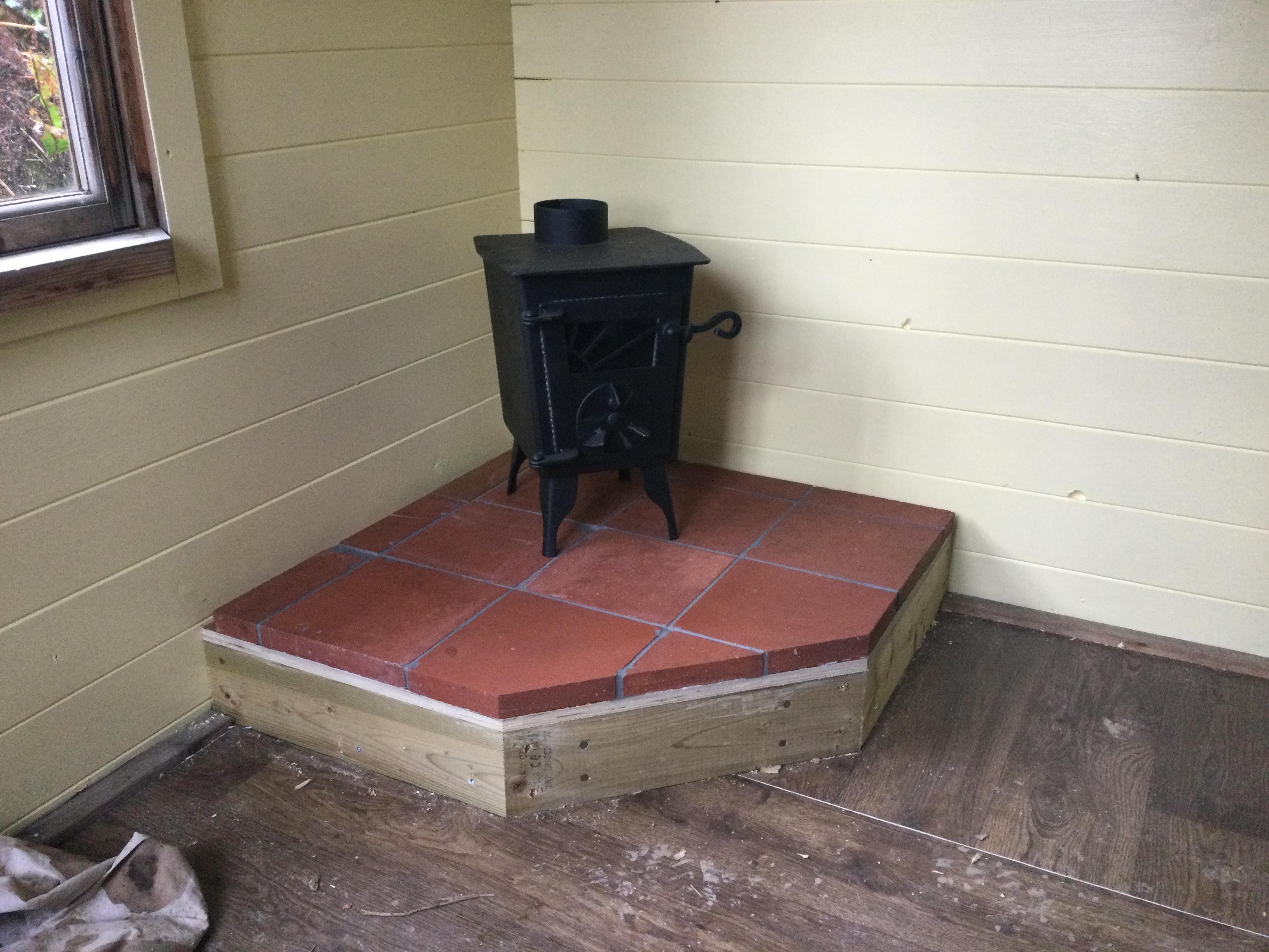

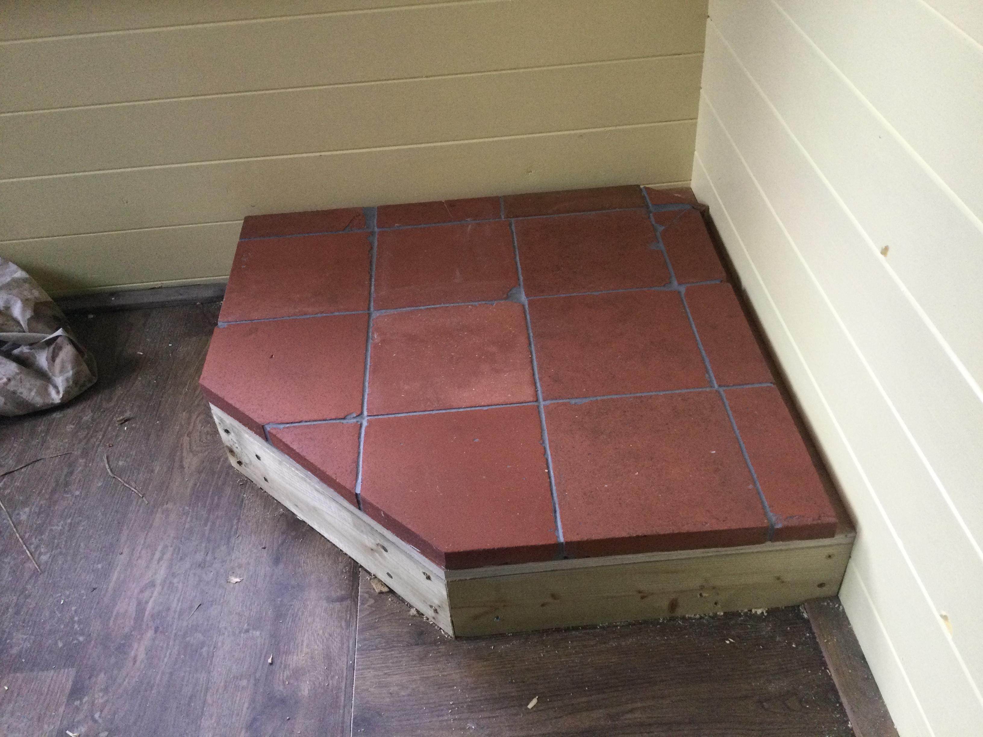

PeterW Posted February 9, 2022 Share Posted February 9, 2022 11 minutes ago, zoothorn said: Its called "151 hard as nails". Not "no nails". Its got crap reviews ' wont stick anything ' etc. Peter Im reading up that quarry tiles are better laid on mortar, building site info etc. 3:1 with a tiddle of antifrost plasticiser-? it will - and it’s fine. Quarry’s on mortar are for outside Link to comment Share on other sites More sharing options...
zoothorn Posted February 9, 2022 Author Share Posted February 9, 2022 Ah ok. Happy togo with your recommendation. But was reading this you see.. https://www.diyhowto.co.uk/projects/quarry-tiles.htm thx zh Link to comment Share on other sites More sharing options...
zoothorn Posted February 10, 2022 Author Share Posted February 10, 2022 18 hours ago, PeterW said: it will - and it’s fine. Quarry’s on mortar are for outside Peter, sorry Im just a bit stuck seemingly. Cold weather, frost possible tonight etc. Will this now suit my better using either mortar, or the Tube/ nails grab glue? thanks, zoot. Link to comment Share on other sites More sharing options...
zoothorn Posted February 10, 2022 Author Share Posted February 10, 2022 Peter was right of course. My tube of nails stuff seems to have stuck my tiles down fine/ done. Grout, paint the plinth as per walls last. So now to consider the flue. @ProDave the cheaper way, Im fairly sure, would be single econo 4" flue up to ceiling.. then here obviously the double standoff-to-roof whatnot section. I'd have thought Id benefit from added heat dispersion this way. Yes I may need to line behind, but possibly not, & not difficult to & only 0.75m or so. But you have said to go double all the way up, through ceiling. Main reason you suggest this? Thanks, Zoot. Link to comment Share on other sites More sharing options...
zoothorn Posted February 15, 2022 Author Share Posted February 15, 2022 Right, this went well.. what I have now, is a 1" gap around my two back ( 800mm ) edges. Plinth to paint yellow/ do last. So the 2 heat barrier 'panels' to consider next. Might they standoff to the walls say 1/2" ? If so they could sit down in these two gaps.. then fill gap up last: so just a 1/2" gap to fill with grout or mortar. 3 Link to comment Share on other sites More sharing options...

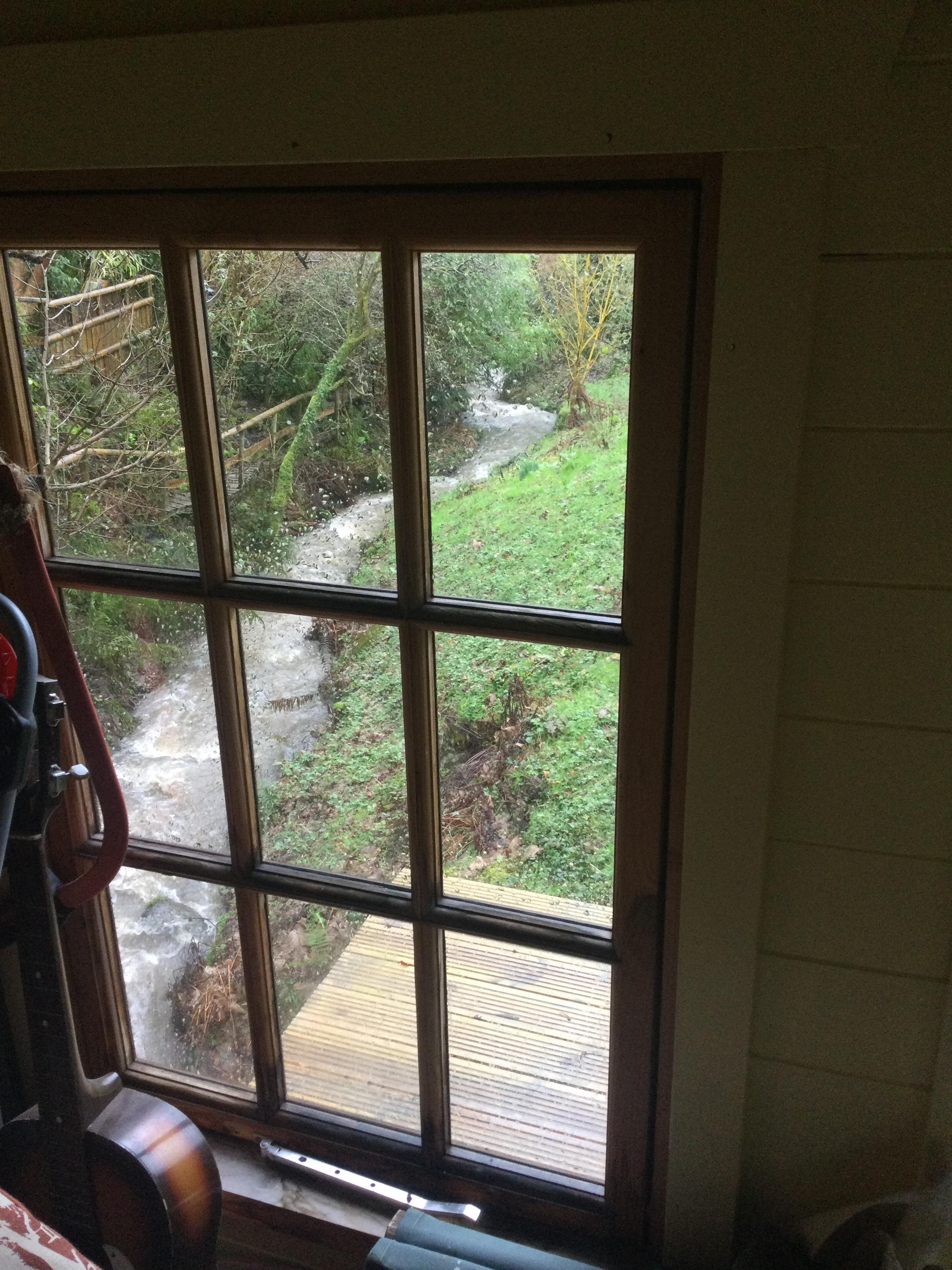

zoothorn Posted February 15, 2022 Author Share Posted February 15, 2022 @Onoff one for you sir: stream after alot of overnight rain.. it can swell up more, but rarely. Makes quite a racket even like this! 1 Link to comment Share on other sites More sharing options...
ProDave Posted February 15, 2022 Share Posted February 15, 2022 That looks very much like our burn that can come up in spate very quickly. As long as it doesn't come over the top. So you now need to look for some metal sheet to make the heat shields. If you go single wall flue to the top the heat shields will need to go all the way up. If you swap to twin wall just above the stove, the heat shields won't need to go much above the stove. You need to look at availability of sheet metal and the cost vs the cost of twin wall flue and work out the best compromise. Link to comment Share on other sites More sharing options...

Onoff Posted February 15, 2022 Share Posted February 15, 2022 For his metal sheet how about the sides from a suitable white goods appliance like an old abandoned washing machine etc? Tidy the edges with a slitting disc in a grinder, rough up the paint and refinish in a heat resistant black. Link to comment Share on other sites More sharing options...
joe90 Posted February 15, 2022 Share Posted February 15, 2022 (edited) Wow that looks really good mate, well done you. As an alternative to metal sheet what about tiling, cheap tiles, end of line?, being ceramic they would be heat proof surely! Brick slips! ? Edited February 15, 2022 by joe90 Link to comment Share on other sites More sharing options...
Onoff Posted February 15, 2022 Share Posted February 15, 2022 A couple of sheets of 1200 X 900 Aquapanel but that's circa £16 to 18 a sheet. 6 or 12.5mm thick. Grey too. Link to comment Share on other sites More sharing options...

ProDave Posted February 15, 2022 Share Posted February 15, 2022 Here are the HETAS details of the heat shield requirements https://www.hetas.co.uk/wp-content/mediauploads/installationsWithShieldingOfCombustibleWall90degree45degree.pdf Link to comment Share on other sites More sharing options...
zoothorn Posted February 15, 2022 Author Share Posted February 15, 2022 2 hours ago, ProDave said: Here are the HETAS details of the heat shield requirements https://www.hetas.co.uk/wp-content/mediauploads/installationsWithShieldingOfCombustibleWall90degree45degree.pdf Useful this Dave thanks. In fact I can go closer to these sheets with my stove than I thought then. But best pull it out 2 " more as it's a wood cabin. So my inch gap around back is ideal/ sheet can tuck down into & butt up to my tiles, just the sheet stuff to source. And if I should go like the hetas diagram, std flue up to 425mm from ceiling... then double flue from there up. Link to comment Share on other sites More sharing options...
