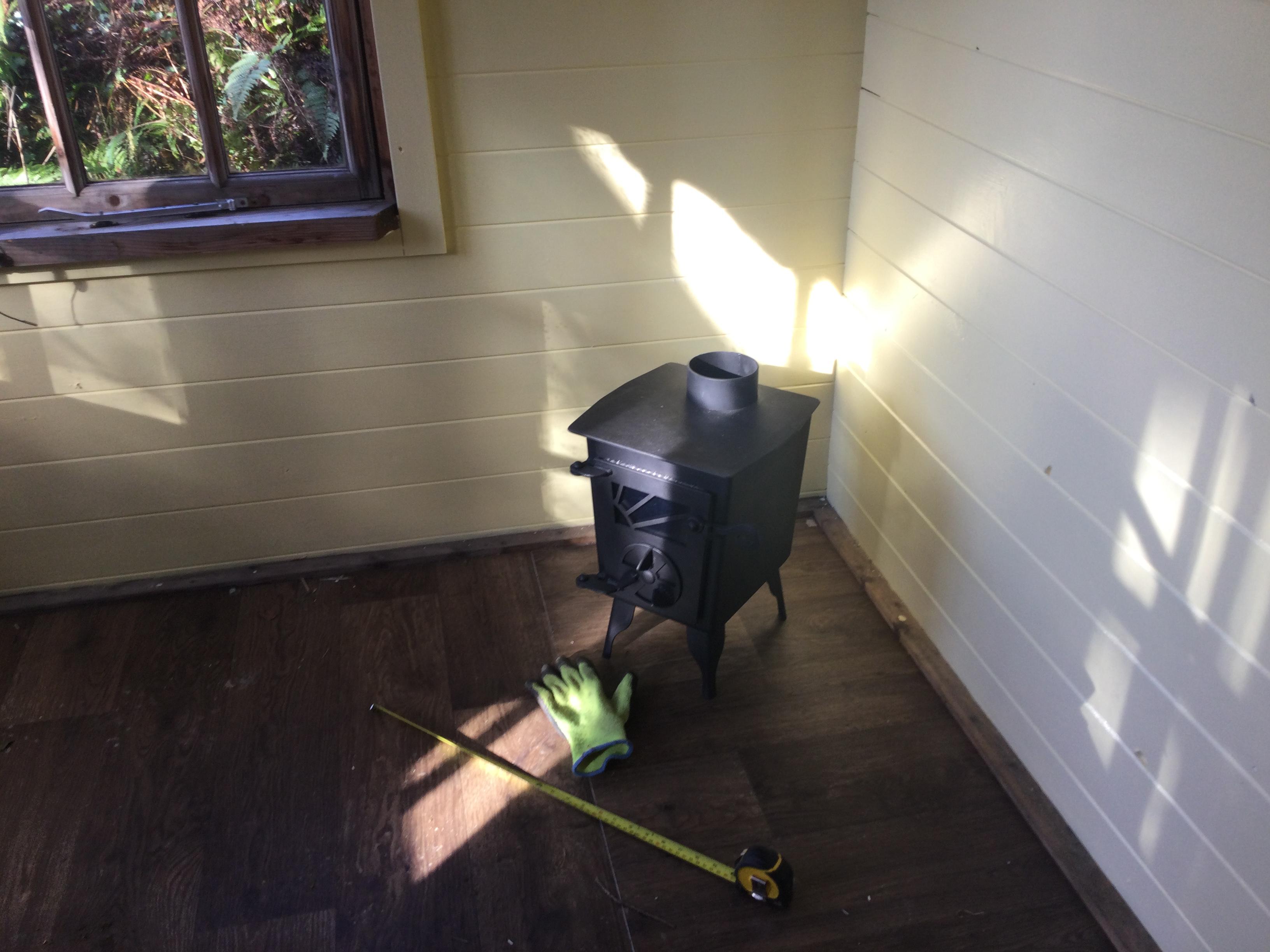

zoothorn Posted January 22, 2022 Posted January 22, 2022 Hi chaps, happy new'ish year to all on BH. I have a diddy 2.5kw stove, to install in my 3x3 log cabin, now the inside painted ( was badly water-stained before): quite a job, took many layers. As stove is so small/ low, I 1st want to put it up onto a hearth area. I've seen this timber idea ( usa ) which could perhaps be scaled down. Then a hearth layer of some sort on top. Is this the right sort of approach I wonder? Like this its to go into a corner. Opinions would be great, thanks Zoot. '
ProDave Posted January 22, 2022 Posted January 22, 2022 The important thing is what does the stove manufacturer say? There are two important things, the first is what hearth does it need. If it is small as you say and sits right on the floor with no storage space underneath, then it will require a constructional hearth, which is basically a big thick slab of cast concrete. But if it has a storage space or other void at the bottom and the manufacturer certifies the bottom will never exceed 100 degrees then it only needs a 12mm hearth which may be a slab of stone, glass or even tiles if thick enough. The second thing is what the manufacturer says is the minimum "distance to combustible materials" from the sides and back of the stove. That dictates where it stands how far from the walls.

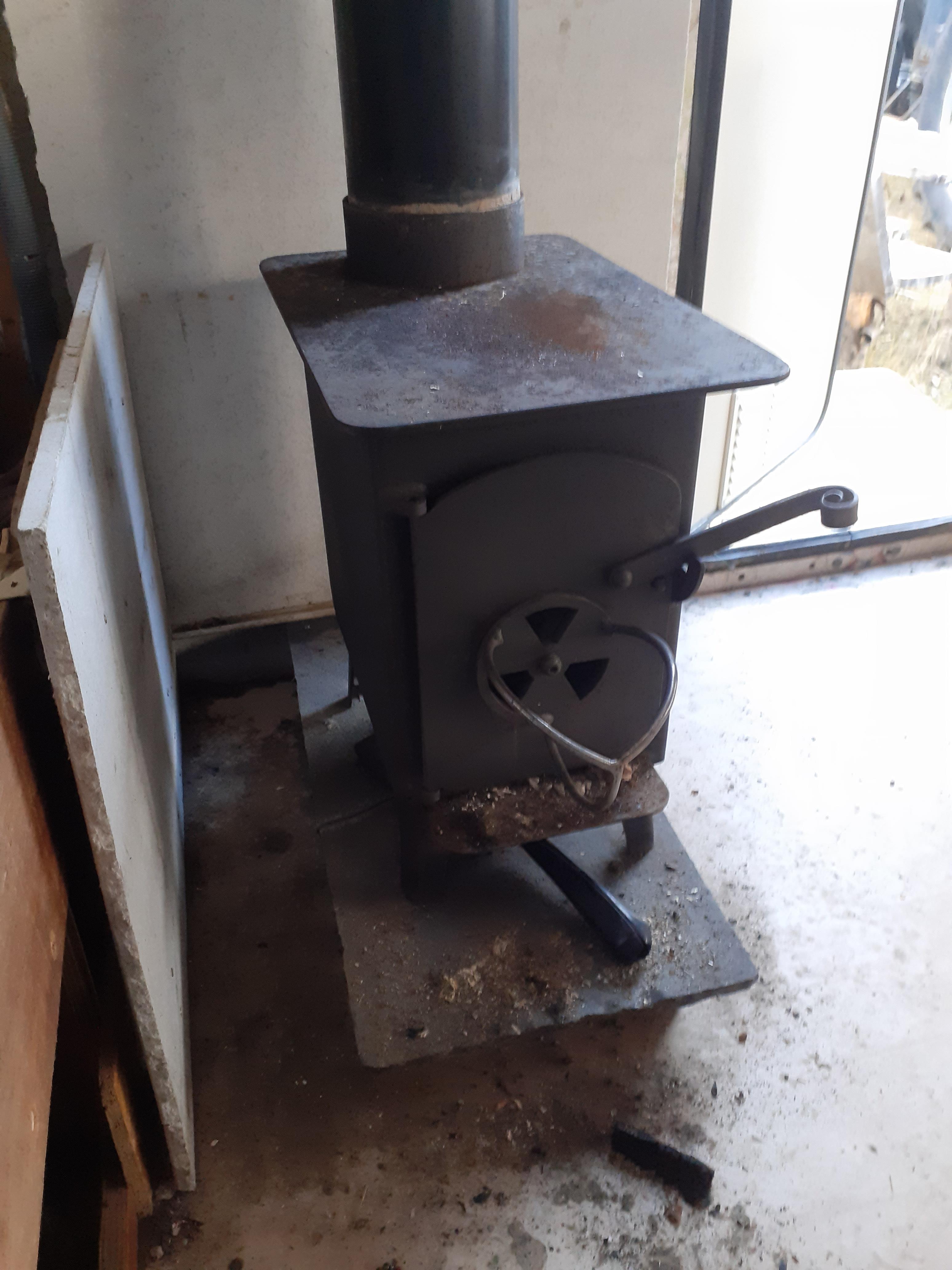

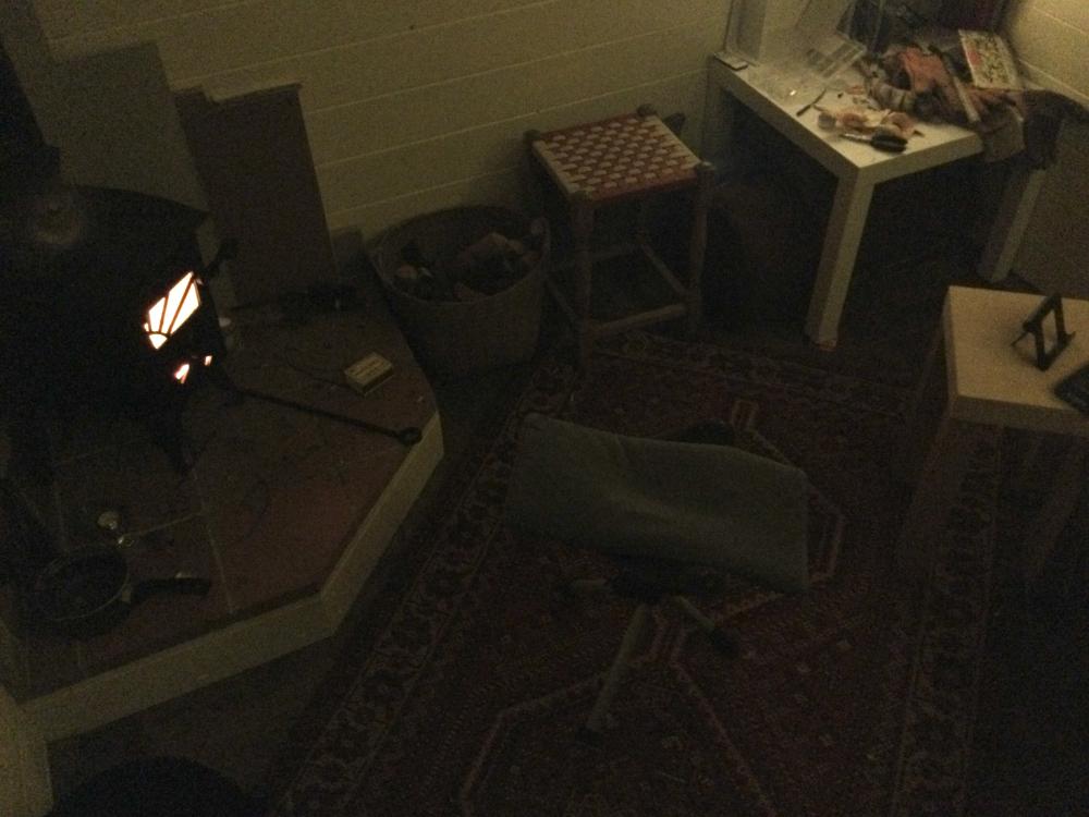

ProDave Posted January 23, 2022 Posted January 23, 2022 This is the one I fitted in our static caravan It does NOT comply with building regs, it was just something I did the best I could. The hearth does not extend far enough in front of the stove for a start. We used to keep a cheap tough mat in front of it to protect the carpet. The stone sides and back are to protect the timber cupboard and plywood wall covering, and there is an air gap behind both bits of stone, not easy to see in the photos. These were some offcuts of stone worktop I got from freecycle years ago in the principle they might come in handy some day. This was a very cheap stove from the internet, not one I would use in a proper house, but it served us well and we managed not to set fire to the caravan.

zoothorn Posted January 23, 2022 Author Posted January 23, 2022 20 minutes ago, ProDave said: This is the one I fitted in our static caravan It does NOT comply with building regs, it was just something I did the best I could. The hearth does not extend far enough in front of the stove for a start. We used to keep a cheap tough mat in front of it to protect the carpet. The stone sides and back are to protect the timber cupboard and plywood wall covering, and there is an air gap behind both bits of stone, not easy to see in the photos. These were some offcuts of stone worktop I got from freecycle years ago in the principle they might come in handy some day. This was a very cheap stove from the internet, not one I would use in a proper house, but it served us well and we managed not to set fire to the caravan. This is great info/ I recall you put this pic up before on my cabin build thread. Ideal eg to go onwards from thanks. So approximately this size hearth, the width can be a bit more as its to go in a corner, & say a few inches more fwd. But if I could get it similarly compactly into the adjacent walls, pulled a little further out perhaps.. but as in a corner helping matters.. that should be fine. So I just need to design the timber raised bit, & choose a cost effective but decent enough looking hearth. Slate.. way too expensive. Weight might need consideration: the floor is only a timber t&g affair so can't deal with a huge ammount.. but then if I can stand in the corner then I guess that is weight tested enough. Thanks, zoot
ProDave Posted January 23, 2022 Posted January 23, 2022 I would suggest something like paving slabs on top of your frame as the hearth. Cheap and some are quite good looking. Line the 2 walls into the corner with some cement type tile board stood off slightly on spacers and tile them with ordinary wall tiles. Get an IR thermometer and on first burn see how hot the adjacent wall surfaces get and add more protection if anything looks to be getting a little too warm. I forget the exact measurements but the hearth is supposed to extend about 400mm in front of the stove.

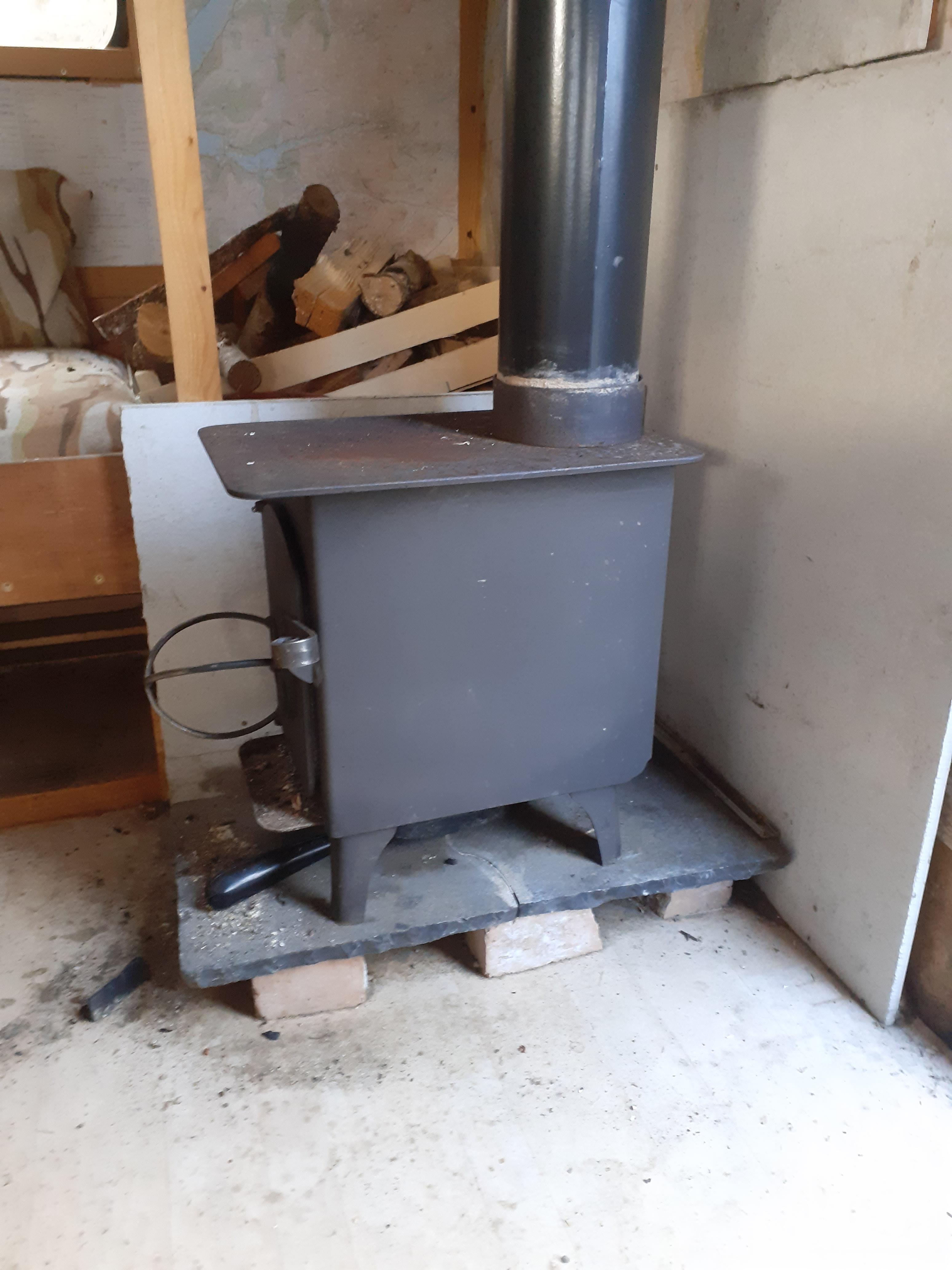

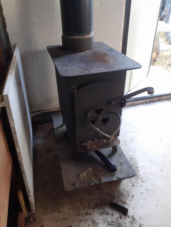

jamieled Posted January 23, 2022 Posted January 23, 2022 @zoothorn couple of photos for you. It seems I actually used bricks for bearers, but timber would work just as well as the bearers don't heat up. Its a small windy smithy stove. None of this meets any regs. It was in a small touring caravan so not a huge amount of space. Think the bit of slate cost about 8 quid. It's about 30cm by 60cm.

zoothorn Posted January 24, 2022 Author Posted January 24, 2022 @jamieled great pics thanks Jamie. Small windy smithy stove! I likes the sound of that. Actually lookslike my stove is based on this design. Just a diddy window added. A tad smaller maybe, yours looks to be a 5" flue at a guess? So your idea here, ie far from building regs/ ideal safety parmeters etc, is morelike my thinking tbh. Although taking on board some very good points from Peter & ProDave. So I might go halfway between, pull stove out a bit more. Spurs me on though! Cheers, zH
jamieled Posted January 25, 2022 Posted January 25, 2022 @zoothorn think it is a 5 inch flue. It converts to twinwall just out of shot where it goes through the caravan roof. The cement board protects the caravan from the stove and the single wall flue.
ProDave Posted January 25, 2022 Posted January 25, 2022 Is it this one? That is using a stone hearth, and metal sheets spaced off the wall for heat protection of the wall. That is something like you need to do. And twin wall flue all the way from the stove through the rood.
zoothorn Posted January 27, 2022 Author Posted January 27, 2022 On 25/01/2022 at 20:23, ProDave said: Is it this one? That is using a stone hearth, and metal sheets spaced off the wall for heat protection of the wall. That is something like you need to do. And twin wall flue all the way from the stove through the rood. Hi ProDave, yes bingo! That is exactly my stove.. or the next one up/ but this is an ideal pic to work from. Even the hearth shape: every inch of it matters as will take away from ' living space' already at a minimum. So just like this but raised up I dunno 8" or so. I'll make the timber 'plinth' roughly from my clip example in #1, top it with ply then come back.. a nice but if slate like so though a premium. Looks great though. More likely 'fake slate' pave slabs, tho the contoured top will inevitably mean a wobbly stove to sort out. Fantastic find that... was it somewhere in the facebook ' website' ? ( like you I refuse to jump onboard with social media). Thanks, zoot.

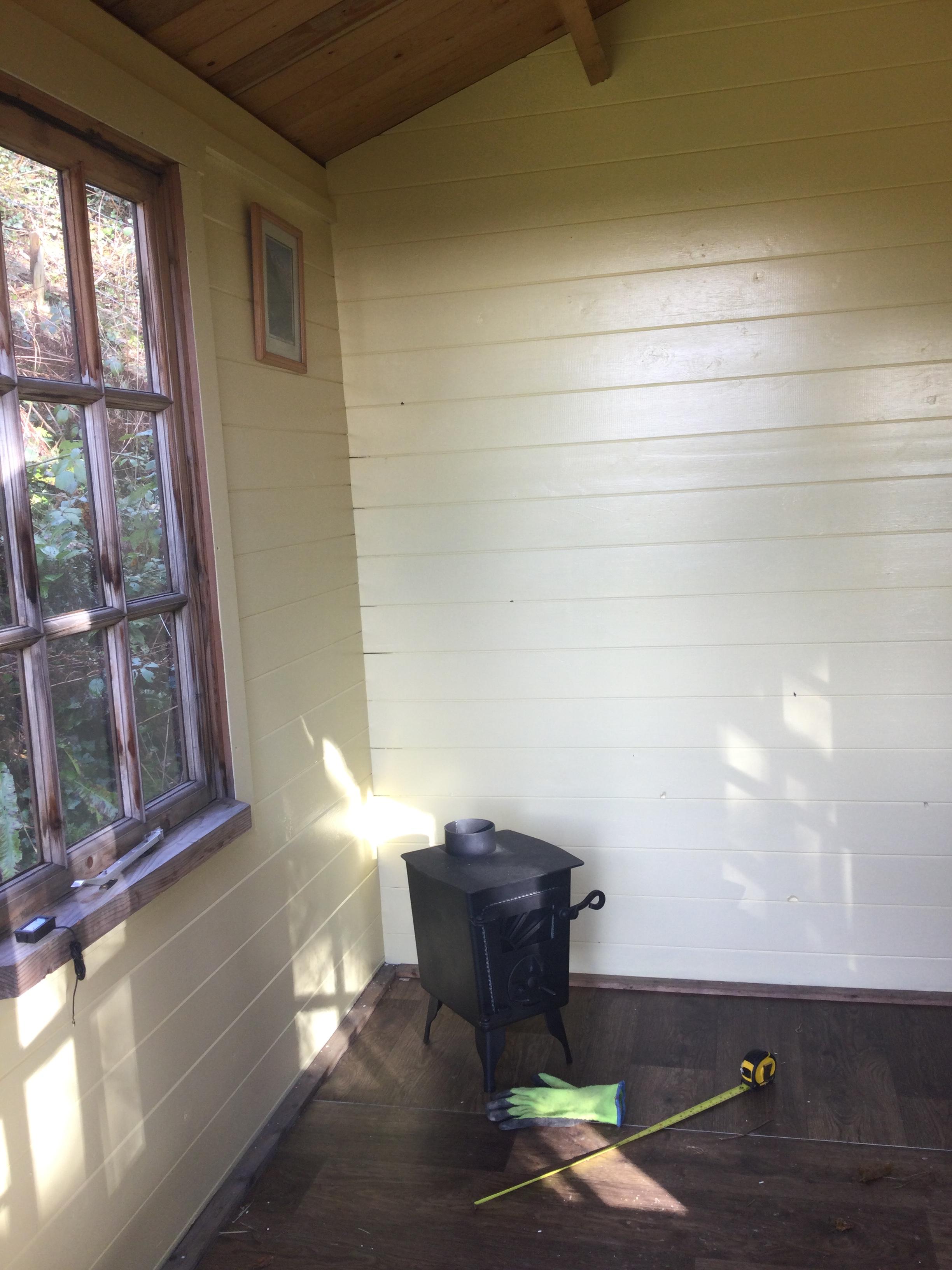

zoothorn Posted January 27, 2022 Author Posted January 27, 2022 Here's my set up.. so Im thinking a 7" or so plinth/ hearth. You can see how low it is like so! Then its 1450mm to ceiling from stove top.
