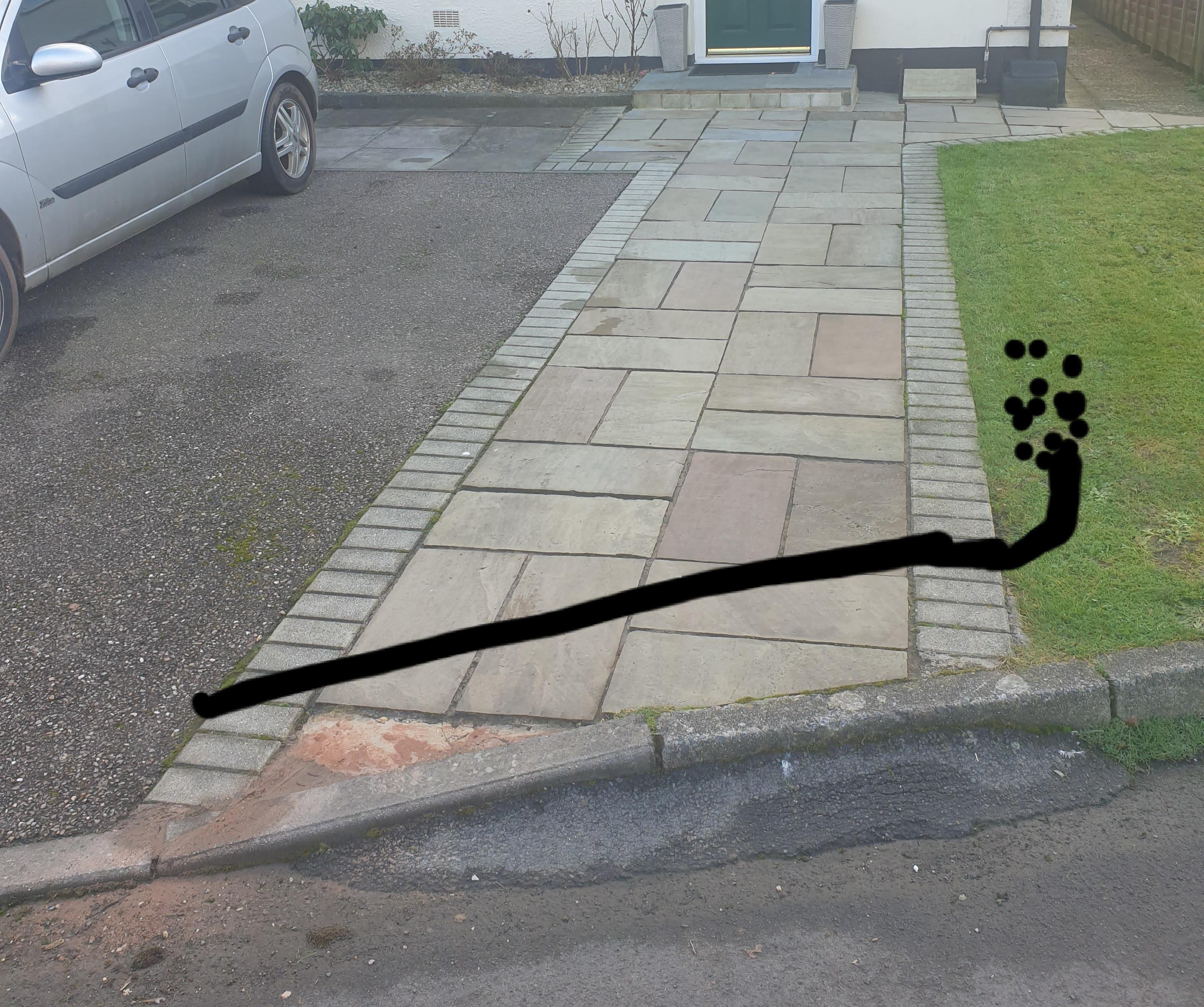

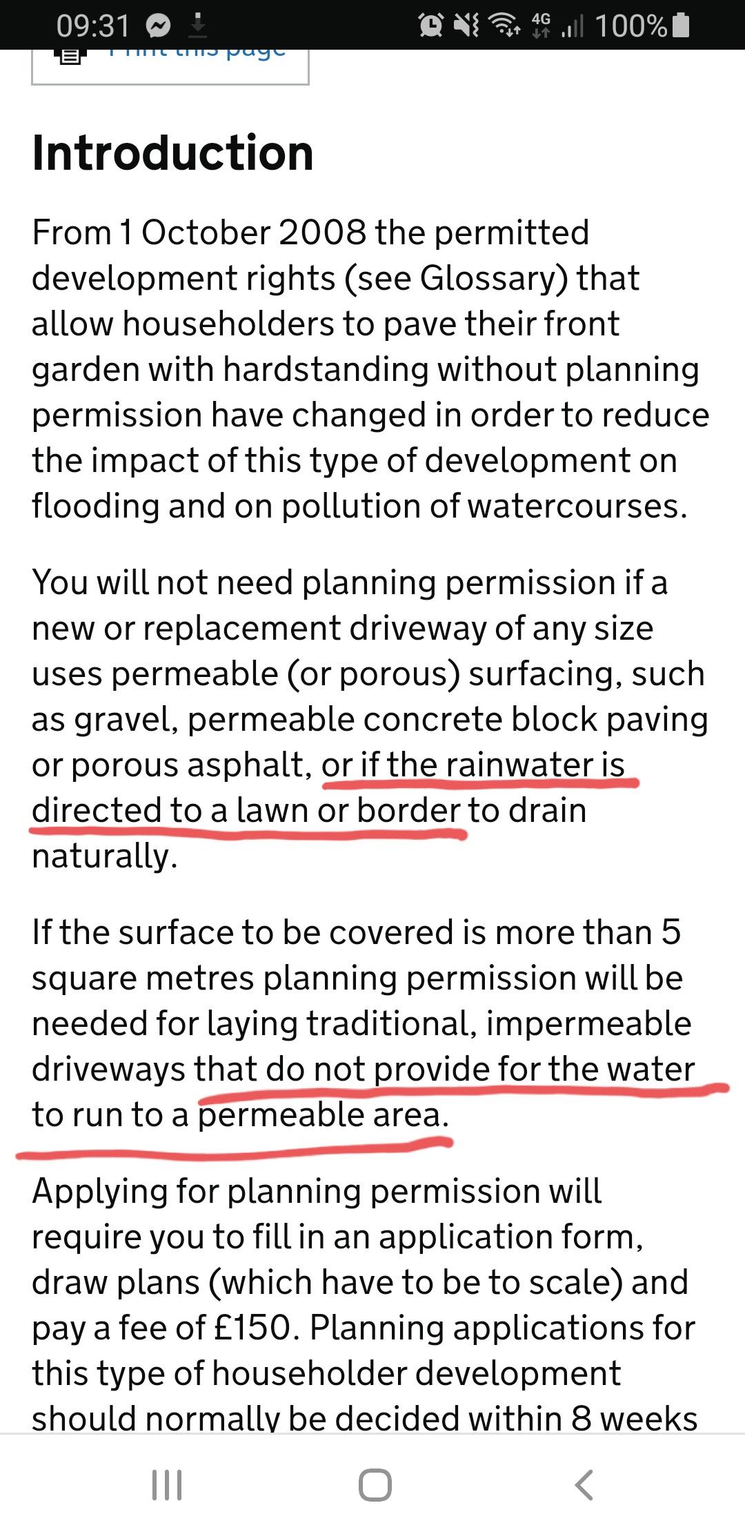

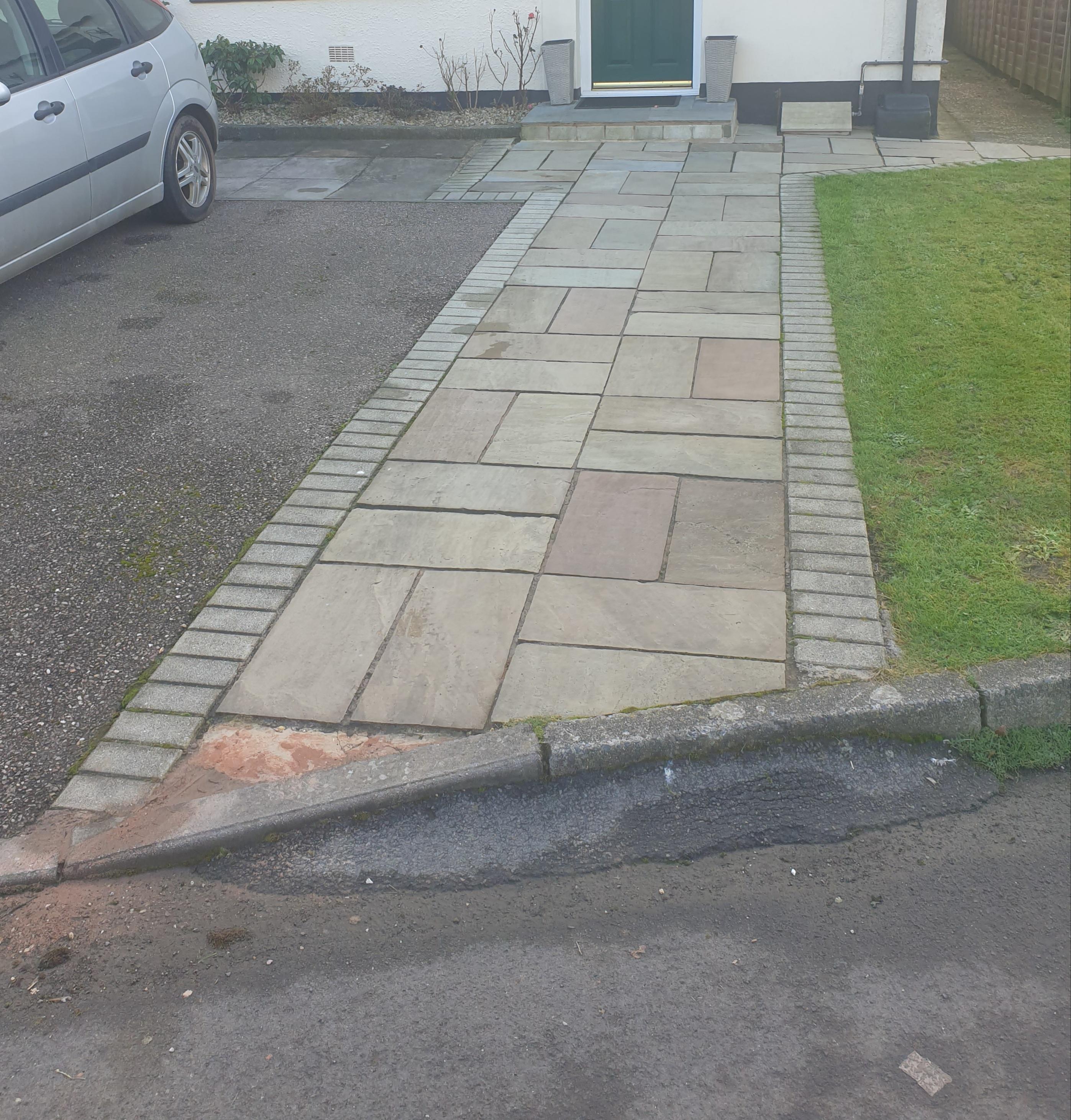

Build2022 Posted January 21, 2022 Share Posted January 21, 2022 I'm in the process of selling and have come across a stumbling point re potential planning permission issue with a path I built in 2017. I looked into this when my solicitor asked me, amongst other questions, to confirm that no hardstanding had been laid at the front. The path is 7m long x 1.6m wide, non permeable. Parking space been there for 40+ years. 3/4 of my path leans slightly toward the garden for drainage. The last 1/4 towards the road, which I've now discovered is a no-no. From what I can gather I'll need to put in a drain channel and that will need to be directed to a soakaway. Can anyone give any advice about the soakaway part please? Will large gravel/stone suffice for a path? I'm going to cut in a drain channel across the path as per photo this weekend, just need to know what else to do before potentially asking the council to confirm it won't need planning (I hope!) Link to comment Share on other sites More sharing options...

tonyshouse Posted January 22, 2022 Share Posted January 22, 2022 I would do it half way up the first full slabs and square with a slot box, soakaway in theory 1m3 but a big ish fence post hole filled with rubble beside the path would work , dows it ever rain on the lawn? Link to comment Share on other sites More sharing options...

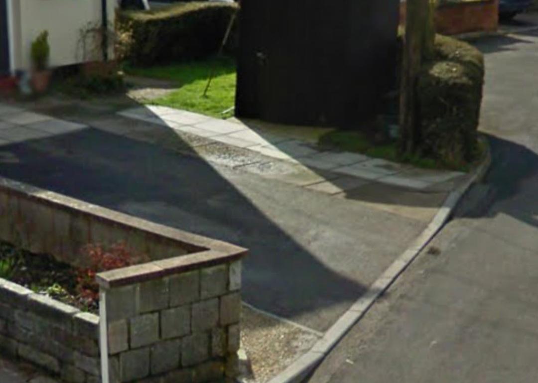

Build2022 Posted January 22, 2022 Author Share Posted January 22, 2022 This was it before, half solid slab and half pavers on mud. If it was ever looked into, google maps shows the work has been done since 2008 Link to comment Share on other sites More sharing options...
Build2022 Posted January 22, 2022 Author Share Posted January 22, 2022 (edited) Hopefully, providing a drain channel, directed towards the garden, will satisfy this and I can tell my solicitor that its all above board... Edited January 22, 2022 by Build2022 Link to comment Share on other sites More sharing options...
Roundtuit Posted January 22, 2022 Share Posted January 22, 2022 It's a pretty easy job to concrete a drain channel in. No one's going to check where it drains to... ?. What's going on with the dropped kerb and tarmac 'ramp'? Was it previously used as an additional parking place? Link to comment Share on other sites More sharing options...
Build2022 Posted January 22, 2022 Author Share Posted January 22, 2022 31 minutes ago, Roundtuit said: It's a pretty easy job to concrete a drain channel in. No one's going to check where it drains to... ?. What's going on with the dropped kerb and tarmac 'ramp'? Was it previously used as an additional parking place? That tarmac ramp was there when I bought the place. The dropped kerb is where my actual parking space is. We do use the path to park on as it's been built to withstand it, but noone needs to know that ? Link to comment Share on other sites More sharing options...
