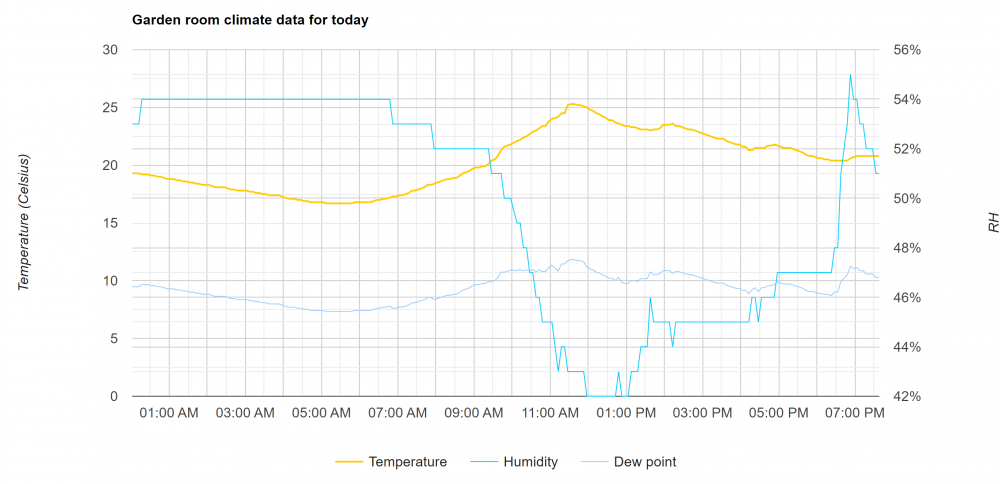

Radian Posted January 12, 2022 Share Posted January 12, 2022 10 Tado's is going to give you loads of info ? I waste spend ages going over my daily logs from the little Chinese thermo/hygros. One of the more useful plots I have produced is the continuous display of dew-point which is a handy heads-up for potential condensation issues: First sunny day in a while and it got quite toasty mid morning. No particular condensation risk throughout day or night. But I keep an eye on things in this room as it has three totally glass walls made from sliding patio doors in aluminium frames. They have thermal breaks but the very bottom edges have developed condensation when below zero outside, except for when we have the UFH on. With the dewpoint plot I know when to put it on - next step is to automate this with node-red so I don't have to do a thing. Link to comment Share on other sites More sharing options...
