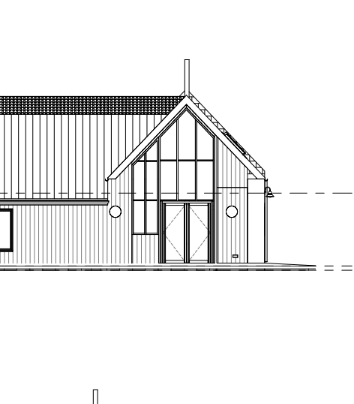

saveasteading Posted January 7, 2022 Posted January 7, 2022 Looking ahead somewhat to window and door supplier, in case we need to allow any detailing at the repairing walls stage. I have been trawling through the local suppliers by web search. Every one does uPVC, some do timber but none seem to do aluminium. Apart from £50/m2 differential is there a local reason for this? We are favouring aluminium to get a slate grey colour, and because there is a large feature panel where I don't think pvc will cope. btw I have a strong dislike for 'wood effect' on plastic. Also, I was once persuaded to use coloured uPVC and liked the saving, but not how the grey windows became lilac over 2 years. Perhaps the colouring is better now.

saveasteading Posted January 7, 2022 Author Posted January 7, 2022 I have had a look at the Rationel website. I don't see any mention of them doing large feature panels (one is a full gable opening to roof). That doesn't mean they wouldn't do it. In such cases I provide an intermediate steel support to allow the glazing framing to be normal sections.
AliG Posted January 7, 2022 Posted January 7, 2022 We have triangular gable windows from Rationel but they are made up of multiple elements. The largest fixed window they can do I think is around 6sq metres, with a limit of 2998mm in each direction. They are, however, more limited than some in the size of sliders that they can do, which has discounted them from parents' build. The max height is only 2388 I think.

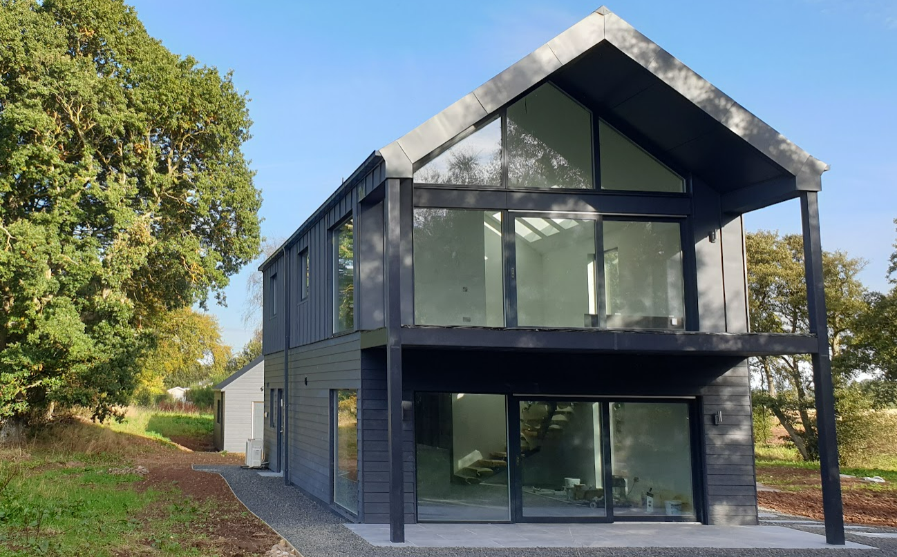

Ralph Posted January 7, 2022 Posted January 7, 2022 The only thing that bugs me about our Rationel windows is the way that a slider is made up from a two pane door and a fixed window. it means that the frames across the sliders don't match up. Those in the picture are 4812 x 2088 . The middle triangular pain is 1603 x 2013 to the point 5
saveasteading Posted January 7, 2022 Author Posted January 7, 2022 This would look very odd and clunky made of several units, but is simple enough made of sections. Hence needs to be a company used to this, and not one mass-producing normal windows.

CalvinHobbes Posted January 7, 2022 Posted January 7, 2022 32 minutes ago, Ralph said: The only thing that bugs me about our Rationel windows is the way that a slider is made up from a two pane door and a fixed window. it means that the frames across the sliders don't match up. Those in the picture are 4812 x 2088 . The middle triangular pain is 1603 x 2013 to the point Hi Ralph, lovely house. What have you clad the sides with, top and bottom?
Gone West Posted January 7, 2022 Posted January 7, 2022 40 minutes ago, Ralph said: The only thing that bugs me about our Rationel windows is the way that a slider is made up from a two pane door and a fixed window. it means that the frames across the sliders don't match up. Those in the picture are 4812 x 2088 . The middle triangular pain is 1603 x 2013 to the point Nice looking house. I wanted to call our last house Shaidzagray but was overruled.
Ralph Posted January 7, 2022 Posted January 7, 2022 9 minutes ago, CalvinHobbes said: Hi Ralph, lovely house. What have you clad the sides with, top and bottom? Thanks, it's cedral on ground floor and standing seam steel on first floor and roof. 1
