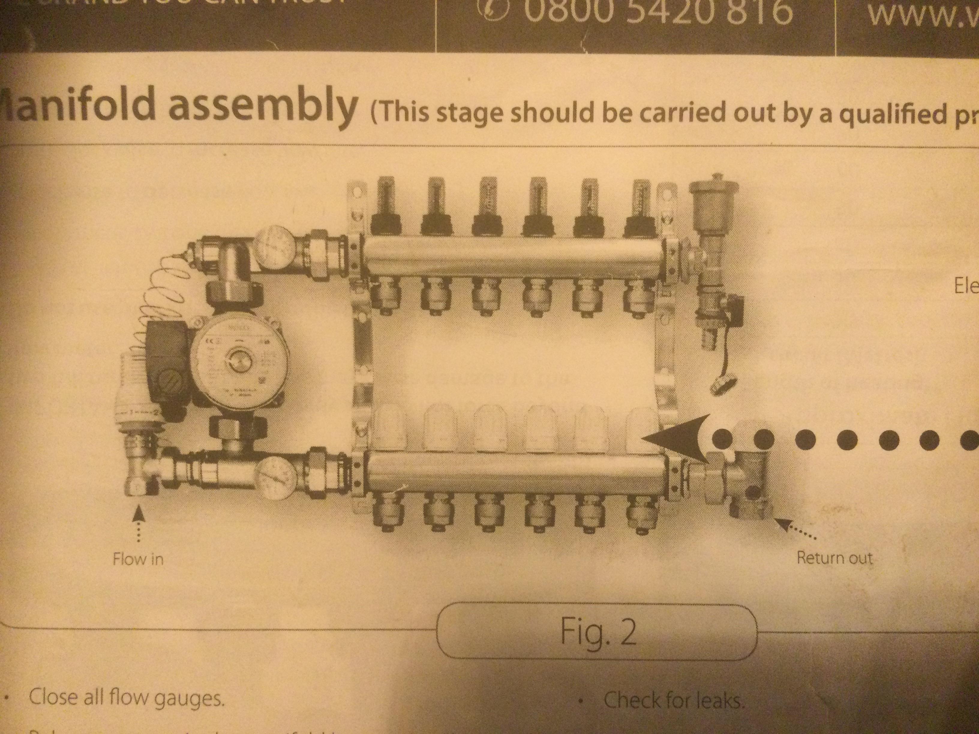

It looks to operate in a similar way as a radiator.  But with a pump in the middle.
So water comes from source to TRV.
TRV fully open - hot water goes into pump, through UFH loops and out of the right hand manual valve.
At a part open position for TRV, some hot water will flow to pump, the rest of the water will be taken from the return water from the UFH heating loops.
So if the loops are not getting hot water, the TRV must be closed more than it should be.
Loops like the TRV has a capillary tube, so would suspect either the top rail or TRV end is broken and needs to be replaced.  I think the TRV comes as a complete unit, for about £20 to £30.
Thanks for the reply but the TRV is fully open as temp both sides of it are the same, I wonder how the pump can pull hot water from the source  (through the TRV) rather than from the return rail as it’s closer, I wish I had a stop cock between the pump and return rail to limit this ? and see if the temp went up!!!
I think it relies on the hot feed to the manifold being driven by a circulating pump of it's own, so the hot water arrives under slight pressure and the return is relatively under slight vacuum.
The position of the manifold circulating pump means it is pulling water into the bottom of the pump so it will be a blend of fresh hot and recirculated cold going through the manifold pump.
Assuming it was working but has stopped, I would suspect either the manifold pump, or the main circulating pump has failed with my bet being the manifold pump has failed.  If it's not on it's full speed setting already, try increasing it?

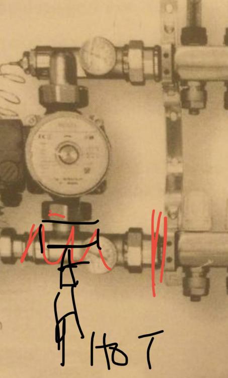

This how your manifold works.
Can only really be TRV issue.  Gone wunda a call, may be covered by warranty.

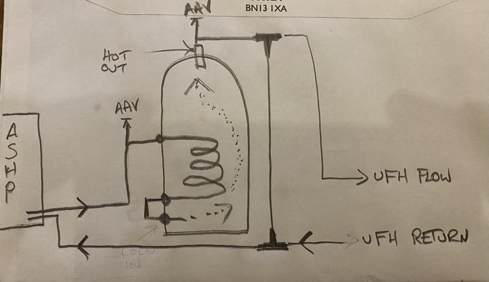

Probably, my Initial plan was a buffer tank at 35’ and blended down to 25’ at the manifold, however it’s been suggested a water temp of 30’ is needed to get a floor temp near 25’.
13 minutes ago, Bramco said:
Would this be advisable for anyone starting an installation, or is the problem you're seeing only due to the length of the pipes to the buffer tank?
I don’t think the problem is length of pipe,(10m) more the lack of pump from buffer tank to manifold. Later today I am going to remove the  blending valve and block it some way, I have already removed the TRV head. I can then control the temp of the UFH water with the stat on the buffer tank. ? @Nickfromwales you got any advise on this?

Wouldn't it be possible to have the buffer tank working like a heat bank (albeit small).  So while the slab is soaking up the heat, the ASHP will stay on.  As soon as the 35' threshold is reached it would turn off the ASHP.  Then, when a lower limit is reached, it would turn on again.

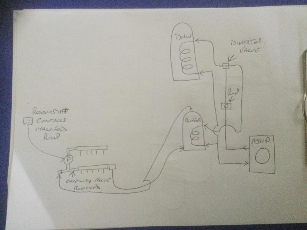

That is how I planned it but the manifold won’t give a decent temp to the top UFH rail and I must assume this is because of no pump pressure into the TRV.

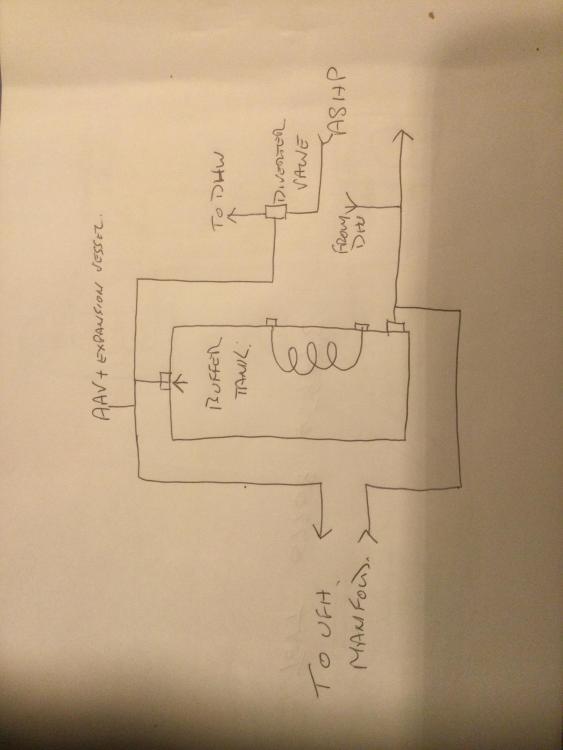

I have a different make of manifold that uses a three port TRV. I originally  questioned the need for a store to manifold pump. Supplier said one was needed because they couldn't guarantee the manifold loop pump would draw water from the store when the TRV was half open. I was surprised as obviously the resistance in the floor loops should be a lot higher than in the short 22mm run from store to manifold.
PS My concern about fitting a pump was that it would stir the store when the TRV were recirculating. To make matters worse my electrician wired this pump on permanantly! I've two manifolds and ended up making an OR gate from relay so that it was only turned on when one was calling for heat.
PPS May need a bypass as well. In case rooms call for heat turning on the pump but both TRV are shut/recycling.

I wonder if adding a restrictor (disc with hole in) at the joint between return rail and the bottom pump manifold might upset the flows enough to force more return out and back to the buffer?
Exactly what I was thinking this morning, shame it’s not a piece of pipe there as I could insert a stop tap so I could adjust it. Going to drain it and take apart tomorrow, will report back ?
Yes I think the manifolds with a 3 port mixer are better at "drawing" the hot water in.

Result ???, I made a rubber diaphragm from a bike inner tube and blocked the non return valve and temp immediately shot up ?. I am going to try running it like this to see if it works relying on the buffer stat to control the temp. If as @Nickfromwales says it overshoots I will consider a small hole in the diaphragm and restore the TRV. Thanks guys. @ProDave what temp did you say you run your UFH water at?
