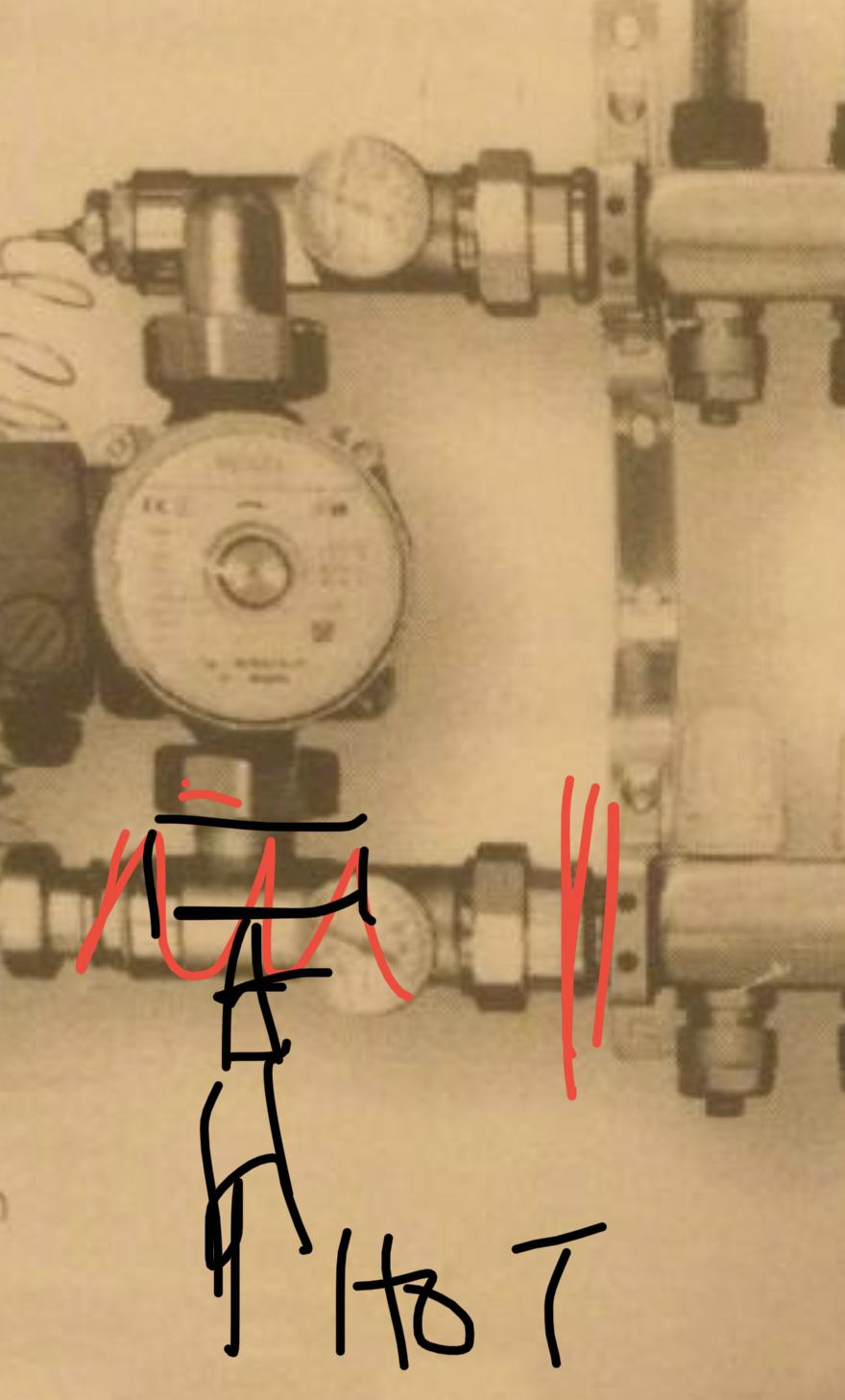

I heard back from Wunda very quickly…..
“What I think is happening here is the thermostatic assembly is mixing the temp down whereas with the preregulated flow temp from the heat pump we don’t actually want it to do anything.
Our advice would be to remove the assembly completely and mount the pump in line with the flow (top bar). Then, when the water returns to the manifold it is sent back to the heatpump for reheating.
This would require the left hand side of the return (bottom) bar to be capped off.
I would expect this to completely solve any issues that are occurring.
Kind Regards,”

I have no floor limitation probes, just a room stat. ? so they sold me the wrong stuff?  If the bypass was adjustable I could solve this.! What to do next?
You could use a pipe stat, close to the pump.  Set at say 45 degrees and wire the pump live through the normally closed connects.  If the flow temp goes above where it is likely to cause an issue the pump gets switched off.
Ok  so they think their mixer isn’t up to it. And I don’t like those so I would do something really simple here.
Remove the heads, and then mount the pump direct to the manifold (think these are 1 1/2”) and then from the return line remove the other end, blanking off the manifold so the flow goes back to the buffer.
Then put one of these in the flow - to blend the correct temperature - and  use this to control the flow into the floor.

The threads etc are different so can’t mount the pump directly, however I could mount the new blending valve in the feed 22 mm pipework and use cool from the return pipework ???, means blanking off the existing valve (like I did before to prove a point) and leaving the TRV valve but removing the head so it stays permanently open.
Right. Leave the top connection as is, remove the bottom pump connection and the manifold connection and blank the manifold where the red lines are.
Then use a standard pump valve to connect the hot from your new valve to the pump, remove the other valve from the other end of the manifold (one with a white cap) and then return that to the buffer.
Hooray, it’s fixed. As I suspected the “bypass valve” built into the manifold is pants, it allowed way too much cold so the loops never got up to temp and it’s not adjustable. I have blocked the internal bypass and installed a separate blending valve and it all works. All I have to do now is play with the flows and temps. Many thanks chaps ?
