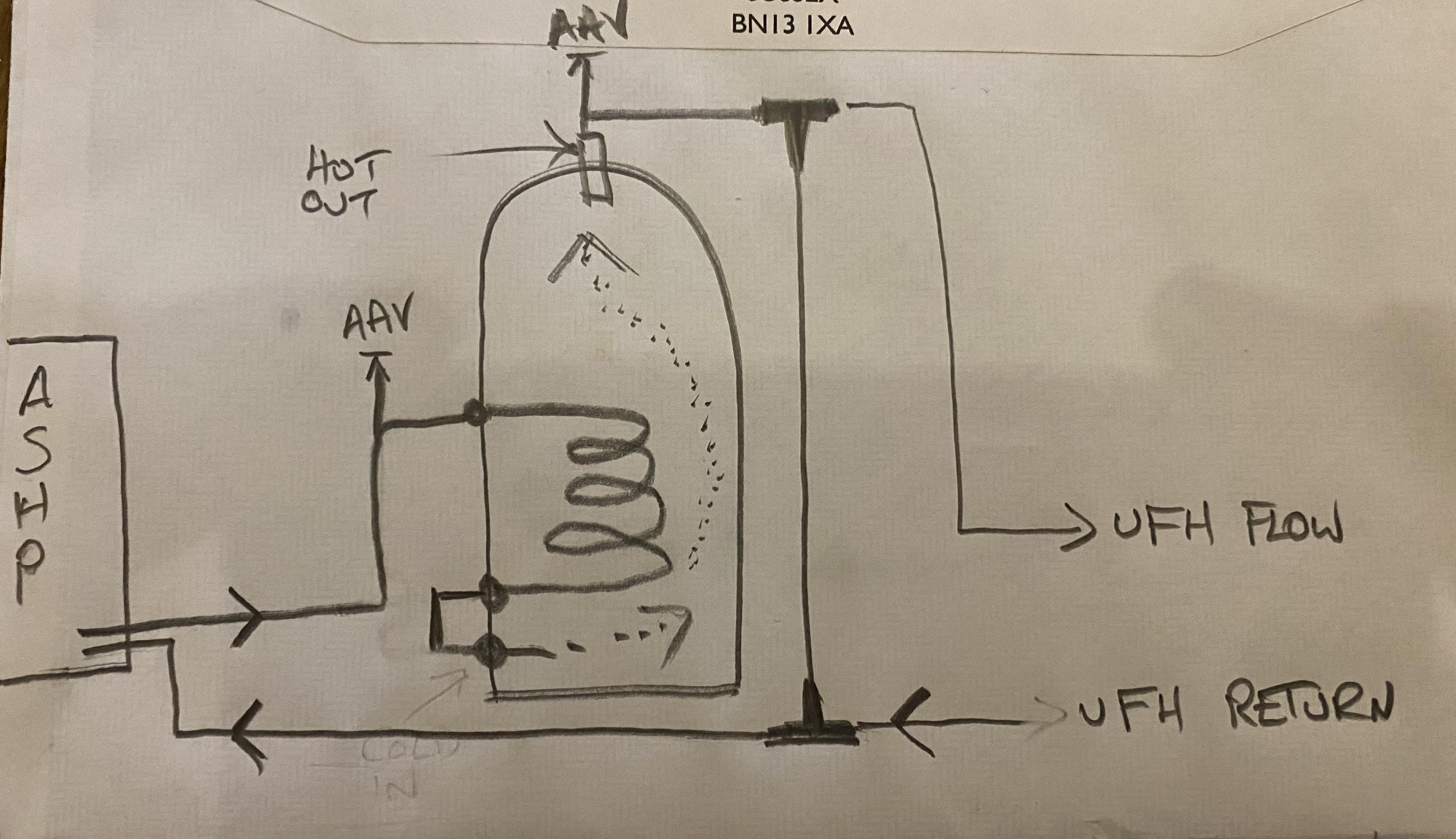

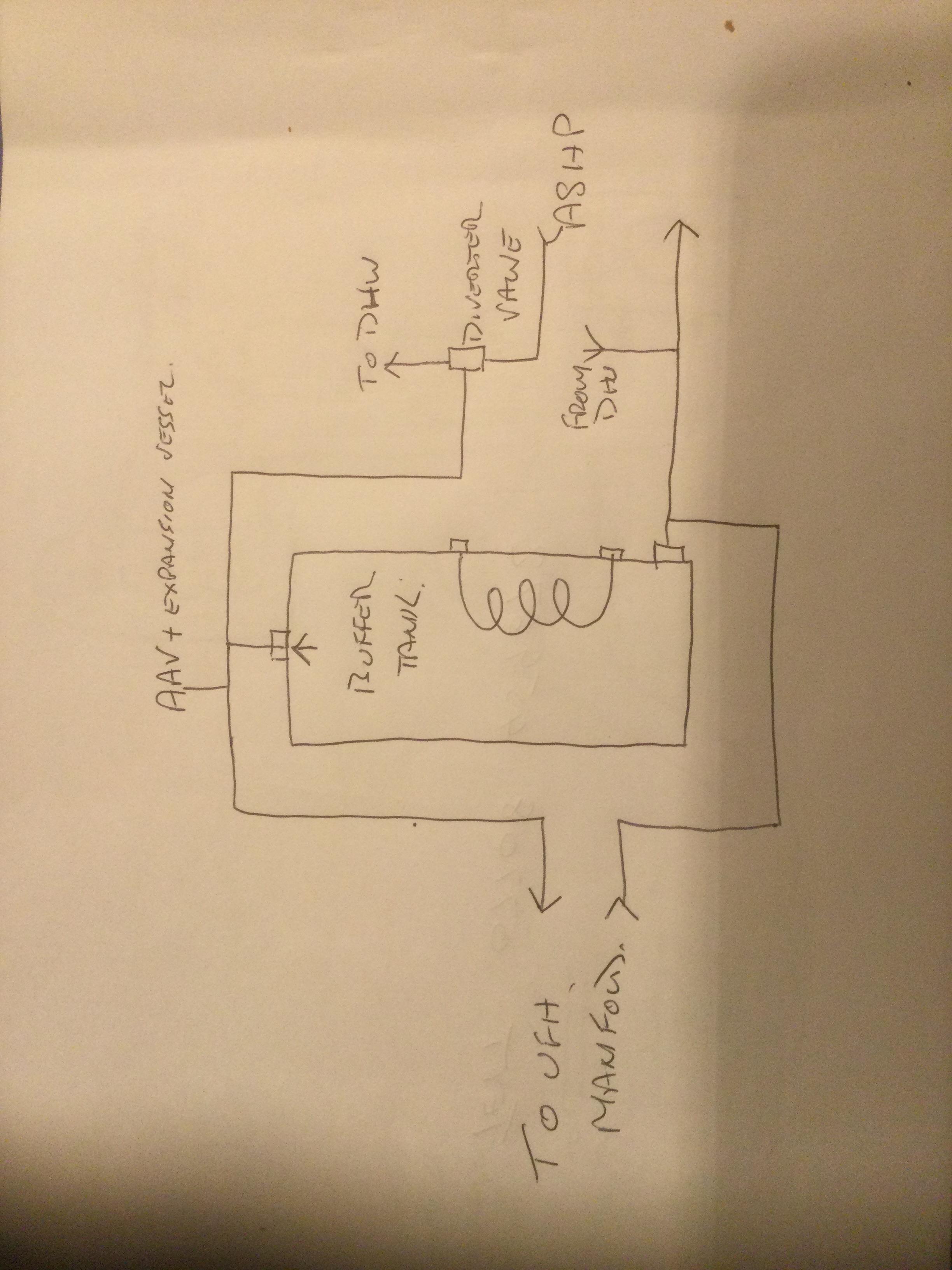

@joe90 are you heating the 'buffer tank' via the coil, or are you using the coil to extract heat? The whole idea of a buffer is to add volume to the primary side so going via a coil will not achieve that. In honesty, I do remember sorting the deal out on price, but I'm pretty sure I did not spec the cylinder you bought to use as a buffer..... IIRC you followed @PeterW's install that he was on at the time where he used the same UVC as a buffer? Been a while of course.
Agree that it's a simple fix to reconfigure, but with the caveat that the system volume will increase, thus, requiring an additional volume of antifreeze when you mix ( combine ) the 2 bodies of water. You have 2 filling loops atm? One for the ASHP primary and a second for the internal heating system? Internal UFH on inhibitor only and antifreeze in just the external primary's?
Run the ASHP flow through to the buffer coil inlet, and come out of the coil output and feed that into the bottom ( cold in ). Then take the flow from the 'hot out' back to the ASHP as the buffer return. You then need a tee immediately off the top connection of the buffer ( the 'hot out' ) where you will pick up the flow to the manifold, and then a tee  lower down the same pipe run to pick up a return for the manifold.
Edited by Nickfromwales
Doesn't the surrounding volume of water act as the additional volume? The ASHP isn't measuring any volumes, it just wants a manageable DeltaT to stop short-cycling...

If you feed the ASHP into a coil there is bugger all primary volume, and a far reduced medium for transferring heat energy from one ‘side’ to the other. This is being demonstrated here.
Buffers can he volumetric or energy devices, so can be plumbed in in 2 different ways to do 2 different things.

You already have it, it’s bought and paid for, so my advice would be to plumb it in as I show above and keep the ASHP as happy as possible.
No 2 instances are really the same, so this is general advice, but I’ll put money on it that removing it would be a bad choice. Measuring its success as is is not a fair representation of how it ‘could’ perform, so as it’s there anyway, plumb it as above and see how you get on.
Around £150 of antifreeze will need introducing to keep the concentration levels as required.

@joe90 I’d start by replumbing the buffer and leaving everything else as is. The buffer - either plumbed how @Nickfromwales or I said will then just become part of the system  and you’ll have a lot more system content to be flowing around but first off it will either prove or disprove you have an issue.
Thanks mate, I am giving it some thought before I dive in but I like your idea (might be easier for my plumbing). My only issue is letting the room stat call for heat from the ASHP rather than just starting the manifold pump as I have no direct wiring (hence my new thread about remote switching. ) I am ploughing through my old wiring diagram to get my head around what I did ?.
i was wondering if I did this below, my worry is when heating is required if I have to heat the buffer tank before the manifold gets the heat then heating is delayed, the diagram below allows the buffer to add the volume and act as a bypass and the heat from the ASHP will get to the manifold quicker. Am I mad (don’t answer that).
If it’s a stainless coil then fine, but copper coils should never be left open to atmosphere as the insides get condensation and corrode badly over time, hence my seemingly unnecessary inclusion of it in my drawing. Fwiw, I would still include the coil in the pathway, even if it’s just teed in one side ( highest connection ) and capped off at the lower so it stays ‘wet’.
The way it’s drawn by you @joe90 is an energy buffer arrangement, and will do as you suggest eg allow heat to the path of least resistance, so when hearing from ‘cold’ the lions share of heat energy will go almost directly to the UFH ( with any residual head diverting / bypassing through the buffer and back to the HP ). Only pitfall is heat has to creep all the way down the buffer to the very bottom to escape as return to the HP.

Yes, I re read this a couple of times before dipping my toe here. ;)  The transfer rate of heated water from the coil ( note : 5kw ASHP ) to the surrounding body of water in the vessel is insufficient in linear ( attempts to be linear ) output. Therefore we are advising here that the buffer ( a small UVC in this instance ) becomes part of the whole single system.
In my pic there will be both hydraulic separation, initially, and then energy buffering second eg when the house comes up to temp.
