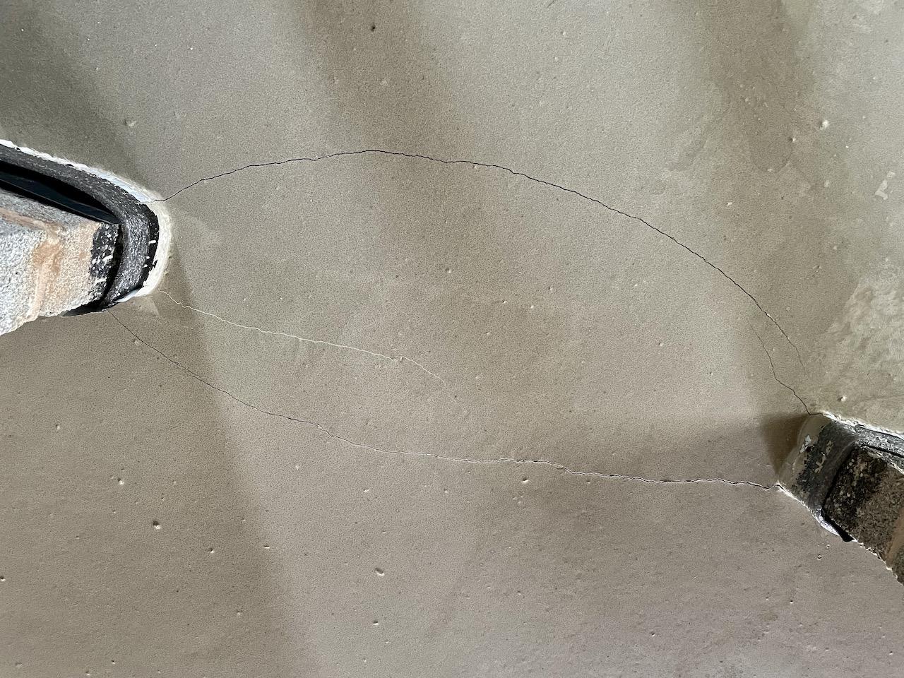

BobS Posted December 19, 2021 Posted December 19, 2021 Our Cemfloor screed was poured on Friday over UFH (75mm screed, UFH, 100mm PIR, concrete slab). Went to check it today and there are a number of large cracks, about 1.5mm wide. The main ones of concern are around the doorways as they are ovals that look like the threshold of the door is now separated from either side. Would this be considered normal shrinkage cracking?

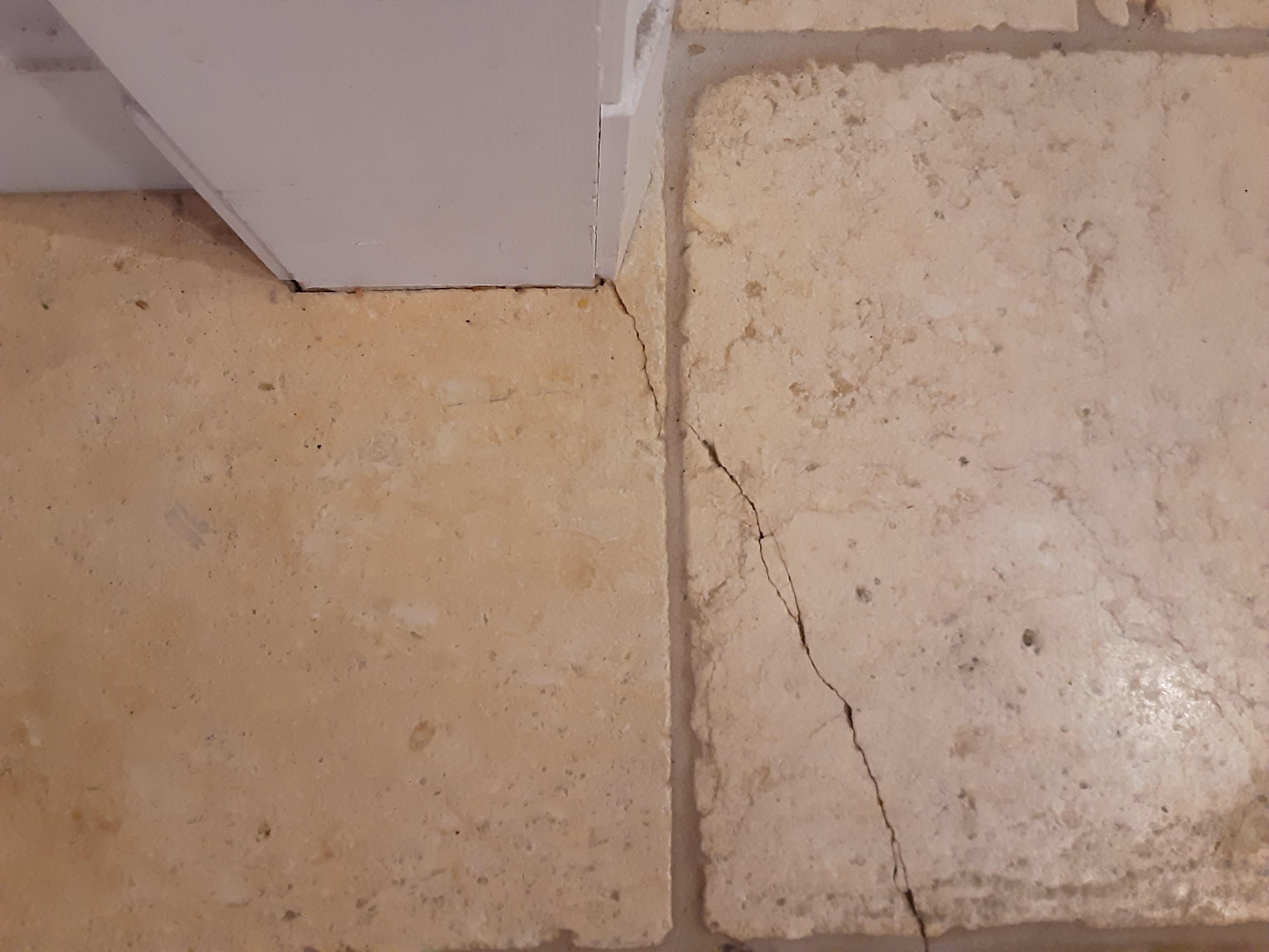

Temp Posted December 19, 2021 Posted December 19, 2021 We had exactly same issue except the cracks propagated through the stone floor on top. I've posted on here a few times about it and recommend an expansion gap (aka deliberate straight crack) at doorways. 16 minutes ago, SteamyTea said: I am interested in what causes this cracking. As @nod said its just regular shrinkage. Pretty small percentage if you think about it. Just 1mm over the span of a room. Near impossible to avoid.

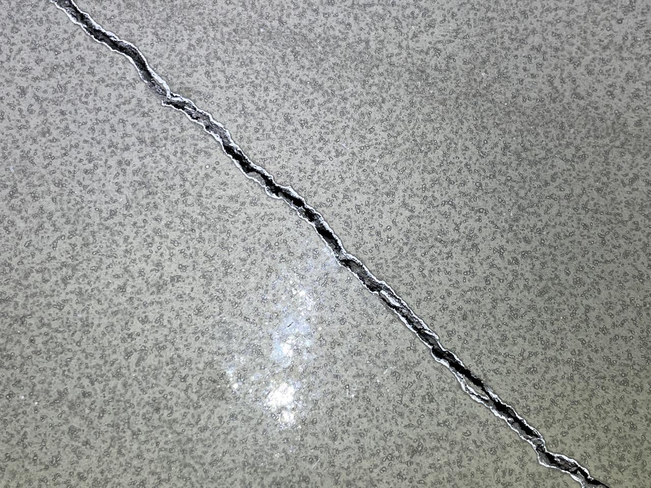

Temp Posted December 19, 2021 Posted December 19, 2021 The issue is there are two areas of screed that meet with a narrow strip at the doorway. Bit like a figure 8. The two areas shrink towards their own centres which puts stress where they meet. If the whole floor had been screeded as one before the internal walls were built it probably wouldn't be an issue but that's rarely possible. Here is what ours looked like. The doorway runs top to bottom with no actual door fitted.

BobS Posted December 20, 2021 Author Posted December 20, 2021 Thanks all for the replies. Controlled cracking sounds like it would have been a good idea. I am wondering if there is an issue with both sides of the door cracking and creating a small island in the centre that could become loose over time. Or are they only surface cracks?
