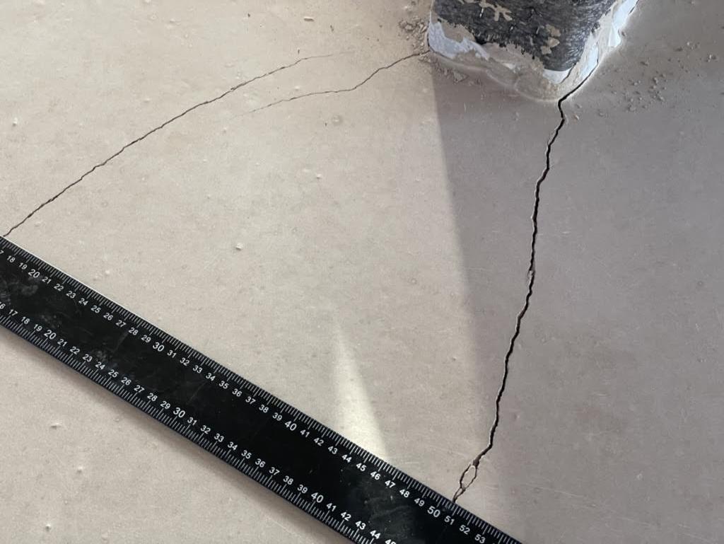

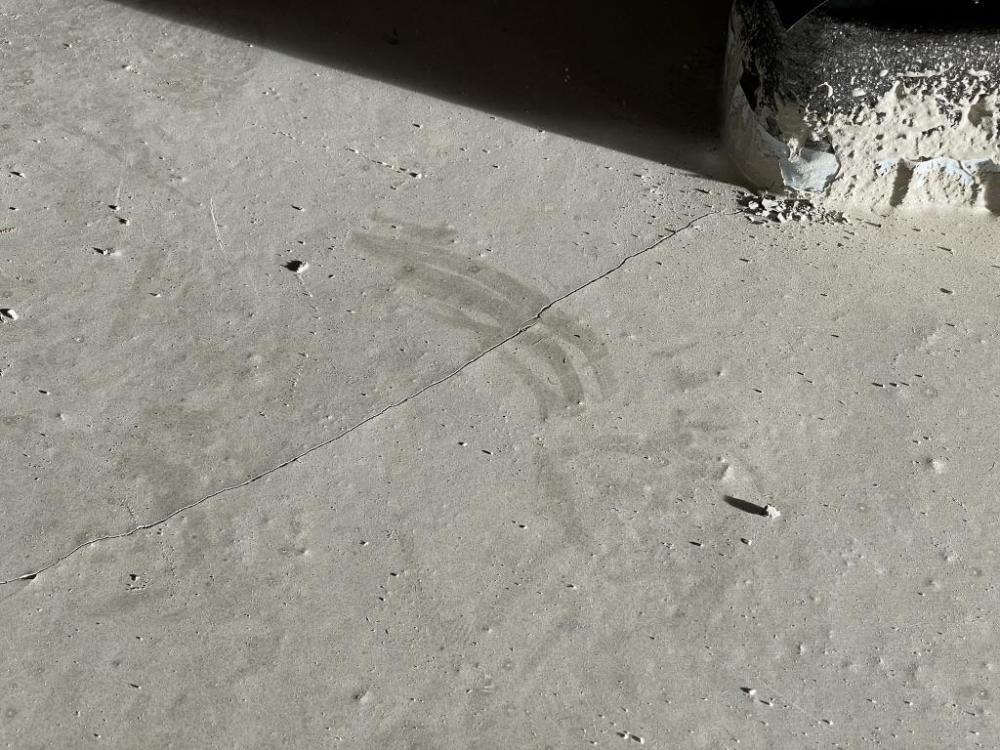

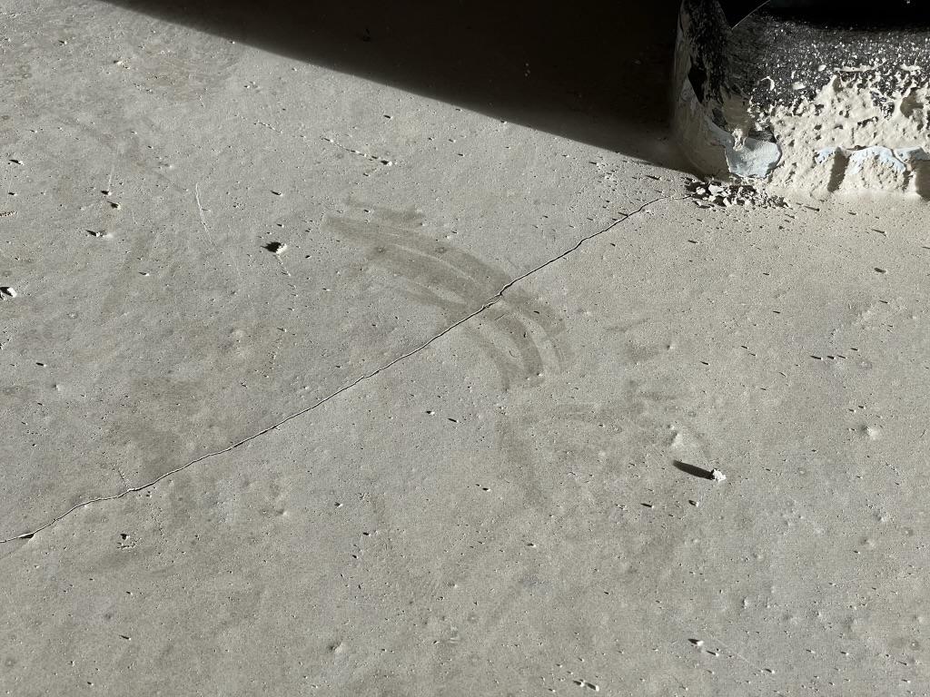

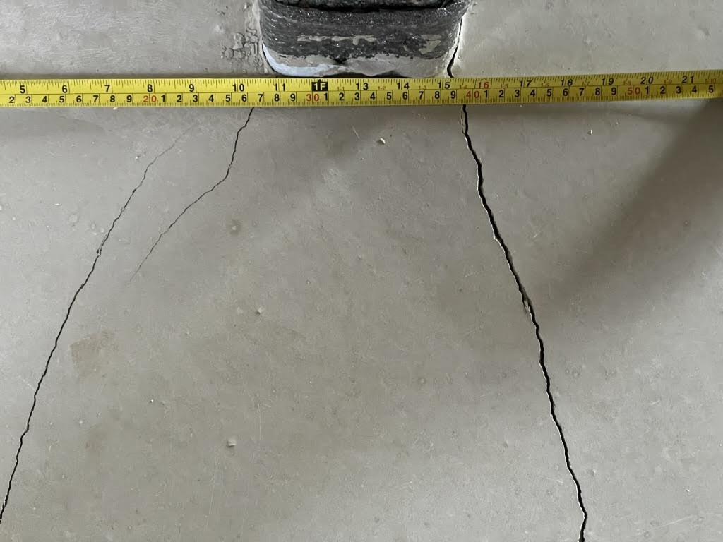

  1. Yes, more concerned these cracks will grow in the future, especially once we put the heating on. It seems like the oval part in the centre of the doorway is now fully seperated from the rest but probably held in place by the UFH for now. We are planning to put Karndean down so thinking the tiles could start to seperate and lift over time.
  2. Longfloor has an integral curing agent to stop cracking rather than one which is sprayed on later. As far as I can tell it is relatively new on the market so unsure how tried and tested it is. The fact Cemfloor said the cracks indicate a problem with the installation or material when they thought it was their own product makes it difficult to accept this as an equivelent. The UFH had not been turned on at this point. We have a temporary willis heater connected up which is warming it very slowly but yet to reach 20 degrees. As @saveasteading says, crack inducers would seem to be the key. It makes no sense to me that they didn't use them.
  3. After my original post I contacted Cemfloor directly with photos. They told me these cracks are not normal for their product and indicate either a problem with the installation or material. However, they also asked some questions about the company who poured this and it eventually emerged that it was not Cemfloor Therm, as we were sold, but a different product called Longfloor. At no point was this product discussed and we were repeatedly told this was Cemfloor up until the point Cemfloor themselves confirmed they do not supply the company. The cracks have got worse since my original post and curled. We have not even used the UFH yet. Our builder is now claiming Longfloor is just a different brand name of the same product and these cracks are normal. Clearly it is not the same as it has cracked badly so I wanted to correct my post saying this is Cemfloor as it potentially damages their reputation unfairly.
  4. Thanks all for the replies. Controlled cracking sounds like it would have been a good idea. I am wondering if there is an issue with both sides of the door cracking and creating a small island in the centre that could become loose over time. Or are they only surface cracks?
  5. Our Cemfloor screed was poured on Friday over UFH (75mm screed, UFH, 100mm PIR, concrete slab). Went to check it today and there are a number of large cracks, about 1.5mm wide. The main ones of concern are around the doorways as they are ovals that look like the threshold of the door is now separated from either side. Would this be considered normal shrinkage cracking?
