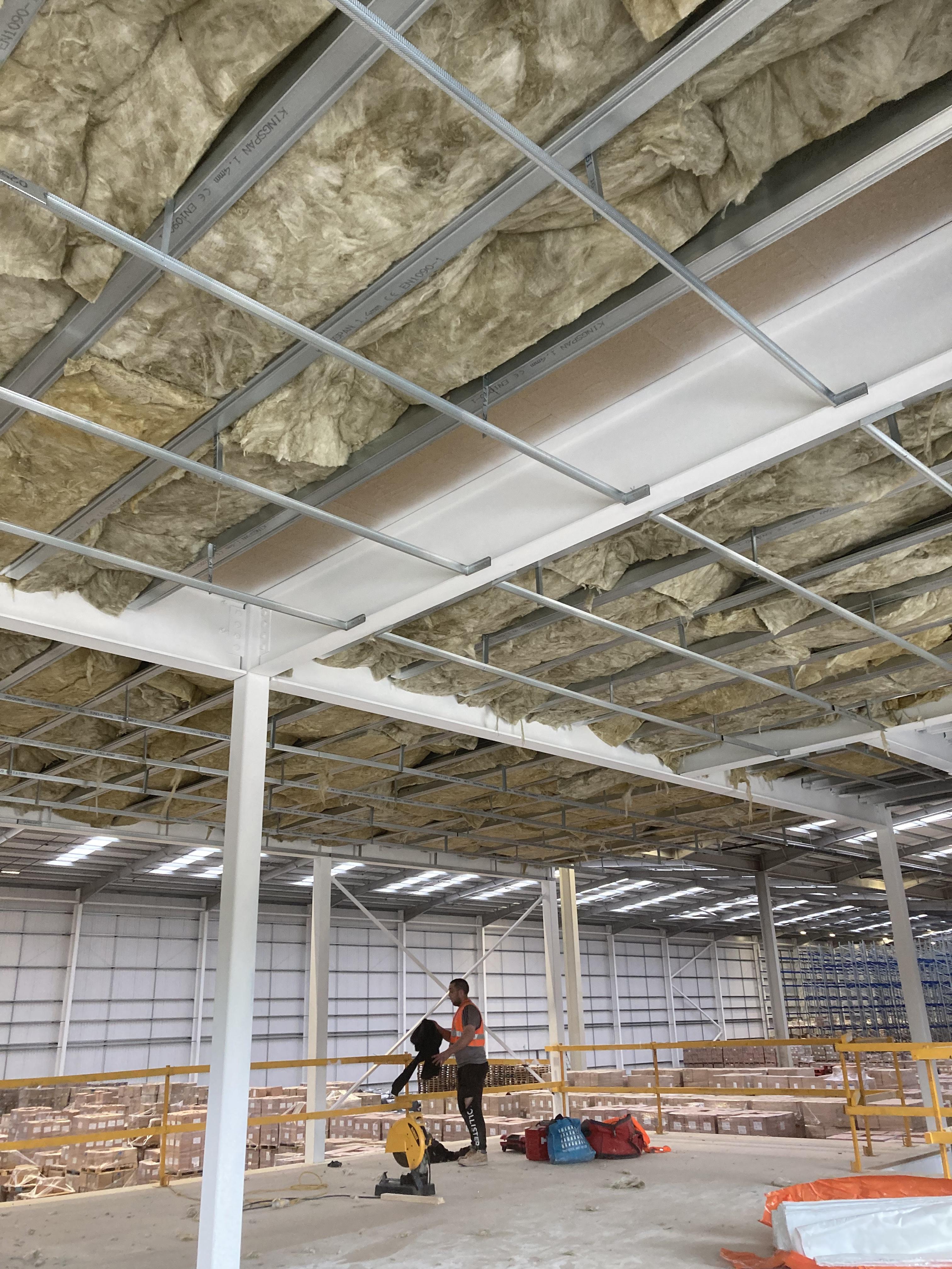

eandg Posted January 4, 2023 Share Posted January 4, 2023 On 10/12/2021 at 13:00, nod said: I normally use a gypliner system on click brackets Quick and easy to install Better than res bar Only loose 40 mil of ceiling height Or a standard Mf if your not to bothered over loosing 150 height Is this just installed like resilient bars? Link to comment Share on other sites More sharing options...

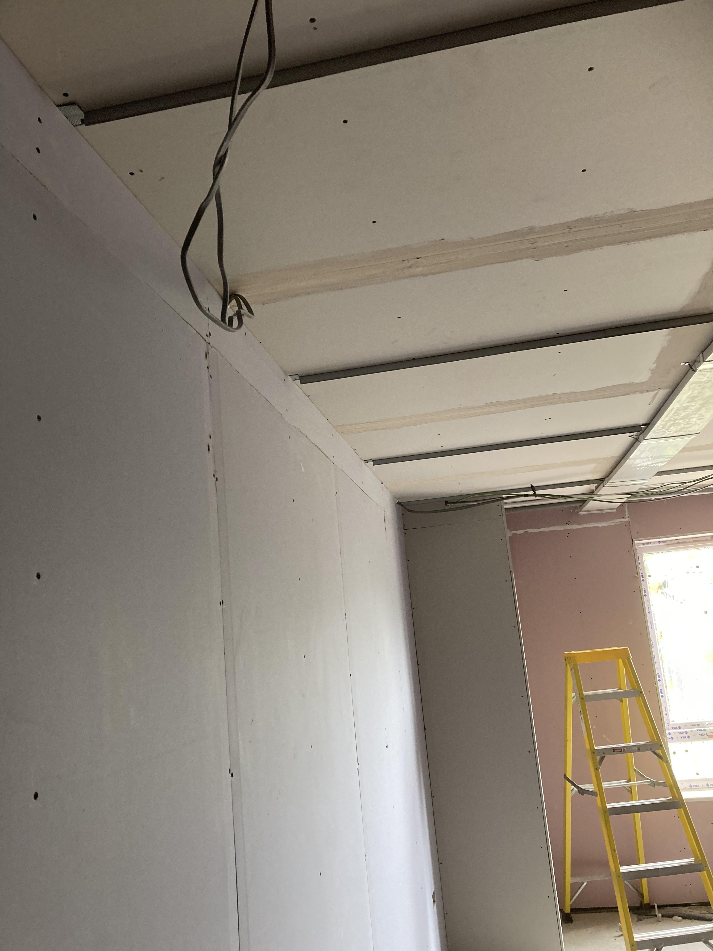

bob the builder 2 Posted January 4, 2023 Share Posted January 4, 2023 Hi All I am just about to spec ceilings on my Timber frame At this point i am planning the following build up Soundbloc plasterboard Resilient bar 100mm acoustic rockwool 22mm caber deck acoustic matting or underlay carpet. I would be really grateful for comments on how well you think this will perform In addition any tips on the acoustic underlay / matting would be appreciated thanks Bob Link to comment Share on other sites More sharing options...
Russdl Posted January 4, 2023 Share Posted January 4, 2023 @bob the builder 2 that build up is very similar to ours apart from the kitchen where the ceiling is fermacell (that stuff is a bitch for a non skilled DIY’er). The remainder of the ceilings are acoustic PB. No normal sounds make it through the ceilings, unloading the dishwasher, listening to music, watching TV etc. If the doors are closed I can have music on in the kitchen at a good volume and it can’t be heard in the bedroom above. Link to comment Share on other sites More sharing options...
saveasteading Posted January 4, 2023 Share Posted January 4, 2023 19 minutes ago, bob the builder 2 said: how well you think this will perform It will be good. Normal but quality carpet underlay might suffice rather than anything fancy, unless upstairs is a music room or dance studio. The fancy acoustic underlays are more important for separating flats, classrooms etc, where foot traffic in outdoor shoes may be a big problem. I would poss use 2 layers normal plasterboard rather than 1 of soundbloc. same sort of cost and probably better results due to overlapping joints. Link to comment Share on other sites More sharing options...
