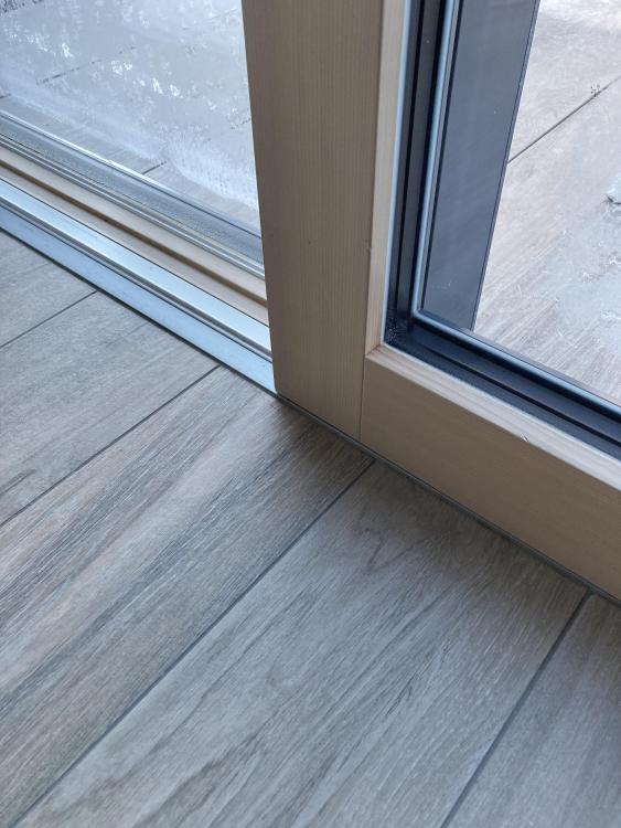

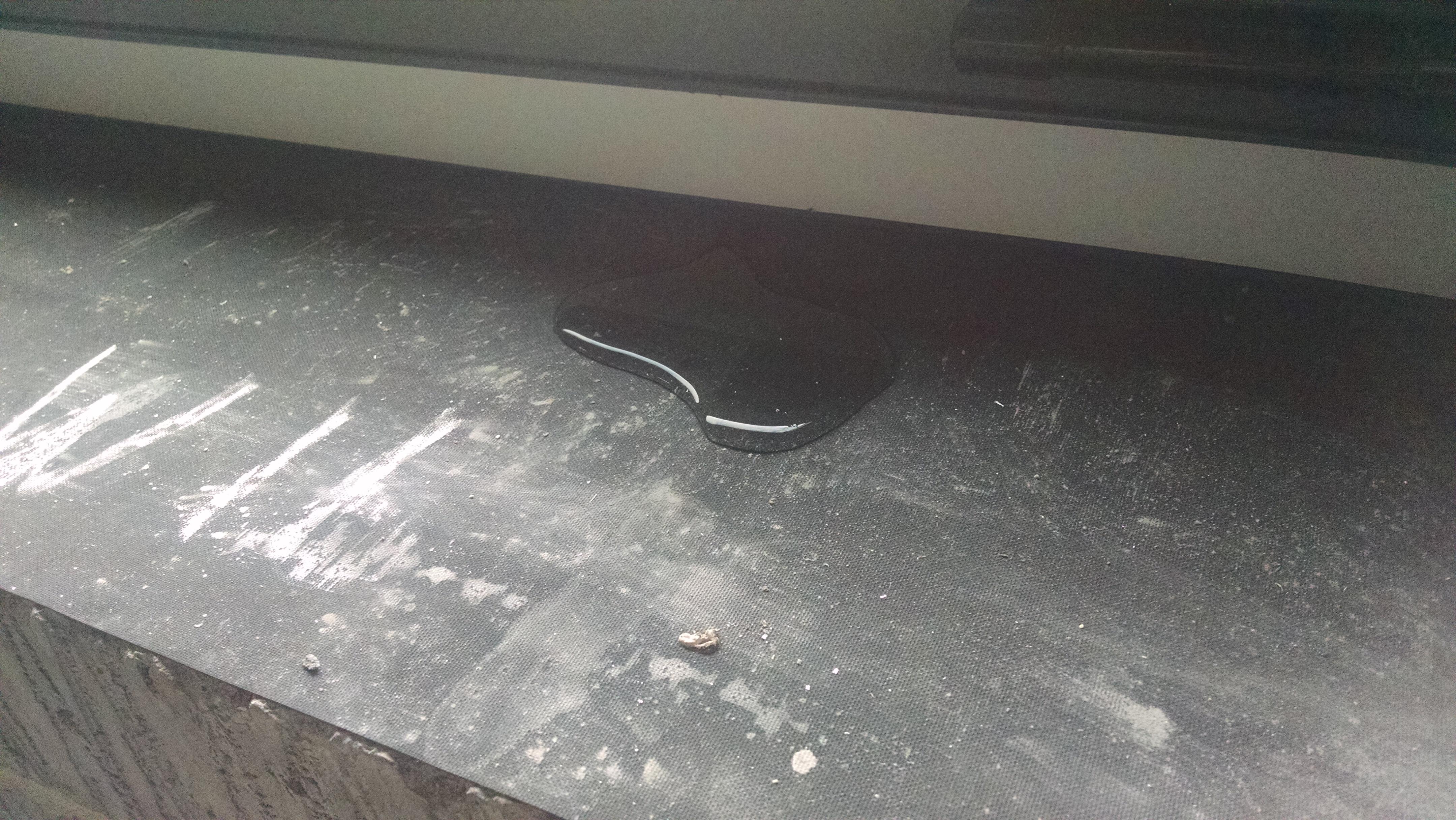

Peter M Posted February 4, 2022 Share Posted February 4, 2022 As this thread is entitled "Condensation and 3G Windows" and not being fully clear by what is meant as "3G" in the title I thought that I would chance my arm and post this reply here and add a picture of what we are experiencing with condensation, or at least that is what the window company is saying is the core contributor to the 'condensation' Our build is nowhere near completed as far as wet trades are concerned as we have not started the plastering yet, the floor has been poured but is now dry and the house has no form of heating yet so the temp outside is pretty much the same as inside and is pretty much sealed apart from the odd draught around the opening as they have not yet been fully sealed. We are really concerned that this is a much bigger issue than condensation being caused by the head or heads of the screws that is fixing the sill to the bottom frame, window company explanation not mine, the pooling of water is being experienced on about four windows at present, was about eight but it seems to alter depending the direction of the rain/wind, if you have any thoughts or ideas I'd be pleased to hear from you. All windows are double glazed in core insulated aluminium from a largish supposed expert company. Link to comment Share on other sites More sharing options...
IanR Posted February 4, 2022 Share Posted February 4, 2022 (edited) 3G = triple glazed Just to be clear, Is the white/silver section that is running close to horizontal the window frame? and the sill you mention, is it the external sill, not shown in the picture. I can't make out the black cylindrical object in the top right hand corner. Does this only happen when it rains? Do you ever see condensation on any surface. Or is it the absence of evidence of condensation that has lead the installer to say "it's forming on the screws" Condensation is more likely to form on the inside in your scenario, where the internal air is slightly warmer than external and saturated due to the drying out process, then coming into contact with a cooler surface of the frame or glass. Edited February 4, 2022 by IanR Link to comment Share on other sites More sharing options...
Peter M Posted February 4, 2022 Share Posted February 4, 2022 Hi Ian, the frames are anthracite grey so what you can see in white is the protective film, the black cylindrical object is the hinge on this particular window as it is a tilt inwards arrangement. Only have ever seen this a day or so after it rains, not immediately, or when I have hosed & washed the windows down after I had been doing some dusty work on the cementboard cladding. The house is dry no wet trades in progress and the floor has dried out, laid in June 2021, no evidence of condensation/water on any internal surface only from BELOW some of the frames. Link to comment Share on other sites More sharing options...
IanR Posted February 5, 2022 Share Posted February 5, 2022 19 hours ago, Peter M said: Only have ever seen this a day or so after it rains, not immediately, or when I have hosed & washed the windows down It's sounding more like a leak than condensation. Are the external finishes all on, you mentioned the sill being in place. Is it possible water is getting on to the rebates and trickling down to pool under the sill and find a way through what is probably expanded foam under the frame? Link to comment Share on other sites More sharing options...
Peter M Posted February 5, 2022 Share Posted February 5, 2022 The external finishes are not all in place yet, which will be just a strip of HardiPlank cladding to the inside of the opening, some have been done and some haven't but the water ingress is happening on finished and unfinished window openings, but what I did do was to go around all the openings that I could easily reach from the ground without erecting a tower, which will be erected later, and sealed with low modulus silicone sealant on top of the expanded foam that the window company had pumped in between the epdm barrier and the brick or block structural opening. The black sheet that you can see in the picture on the inside sill is the epdm the water sitting on top of is the epdm which in turn is stuck to and around the frame to 'seal' the whole window unit from any outside moisture and to improve the airtightness and then stuck by way of a further adhesive strip on the reverse side, 4 inches wide, if the water is forming on top of the epdm it can only be coming from within the frame units that have found their way into the bottom casement section and not drained out through the face drainage slots, water by it's very nature will always find the path of least resistance to drain down unless there is a watertight seal preventing such action. There is no foam between the framing and the epdm seal just the adhesive, approx 2 inches wide sticking the epdm to the frame. I'm loathed to carry on with the finishing detail around the windows until I am 100% sure that the water coming in is sorted and that the window does not have to be removed which will cause all sorts of damage in doing so. Link to comment Share on other sites More sharing options...
