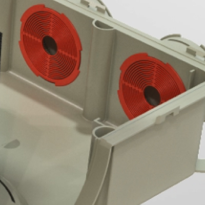

Russdl Posted January 11, 2022 Author Posted January 11, 2022 @Adsibob I installed them but overlooked the measuring of duct lengths that I’d installed. When it was finally all ready to be turned on (long after the ducts had been installed) I used a vacuumed cleaner to suck a bit of foam tied to a length of string down each duct (worked brilliantly) and then measured how much string zipped down each duct. They definitely all go where I think they go. 1
Adsibob Posted January 11, 2022 Posted January 11, 2022 39 minutes ago, Russdl said: @Adsibob I installed them but overlooked the measuring of duct lengths that I’d installed. When it was finally all ready to be turned on (long after the ducts had been installed) I used a vacuumed cleaner to suck a bit of foam tied to a length of string down each duct (worked brilliantly) and then measured how much string zipped down each duct. They definitely all go where I think they go. Well that's reassuring. I think that given your MVHR machine is just on factory settings, if you were to get a professional commission, it would probably fix things for you. Maybe they just need to install those variable terminals that allow you to have different flow rates in different rooms, and then they can play around with it to get a more optimal flow rate in the rooms in question. They could hopefully also check your machine is working properly.
Russdl Posted January 11, 2022 Author Posted January 11, 2022 9 minutes ago, Adsibob said: professional commission, it would probably fix things for you Yep, that’s on the cards but I’m a bit grumpy that I can’t work it out myself. 10 minutes ago, Adsibob said: variable terminals that allow you to have different flow rates in different rooms, Got those. All set to 0 at the moment which allows maximum airflow.

Roundtuit Posted January 11, 2022 Posted January 11, 2022 10 minutes ago, Russdl said: That restriction is done in the manifolds at the MVHR end of things with the red restrictor rings, popping out as many as the supplier dictated. Fair enough! apologies, only familiar with using room vents to control the flow. The mystery continues... (and I agree, the fabric of the house shouldn't still be drying out).

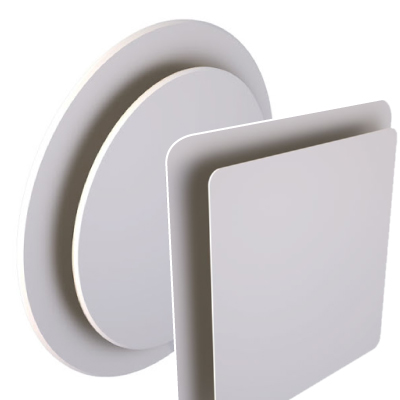

Russdl Posted January 11, 2022 Author Posted January 11, 2022 @dpmiller whilst it’s not been properly commissioned it supplies where it should supply and extracts where it should extract. What I don’t know is if it is supplying and extracting the amount of air it should be. 1
dpmiller Posted January 11, 2022 Posted January 11, 2022 no I mean can you prove there's flow at each grille? With your restrictor setup you're working on someone else's guess... Id be dangling a bit of tissue in front of each vent or using a smoke pencil to confirm it, personally. Airflow is a funny animal, I've spent too many years measuring and setting up fumecupboards and the like, all the calcs might say there will be flow but one extra tight bend in a duct and...
Mr Punter Posted January 11, 2022 Posted January 11, 2022 Do the offending windows have heavy curtains? I don't have MVHR and RH here is about 50%. No condensation on the windows.
Russdl Posted January 11, 2022 Author Posted January 11, 2022 29 minutes ago, dpmiller said: can you prove there's flow at each grille? All extracts will suck a bit of tissue against the valve and on all supplies you can feel the flow (when it’s on a high setting). 12 minutes ago, Mr Punter said: Do the offending windows have heavy curtains? As it happens the main offender does, an almost identical window in the room directly below doesn’t have thick or heavy curtains and on cold days it will also have condensation on it, so I don’t think curtains have any part to play in it.
