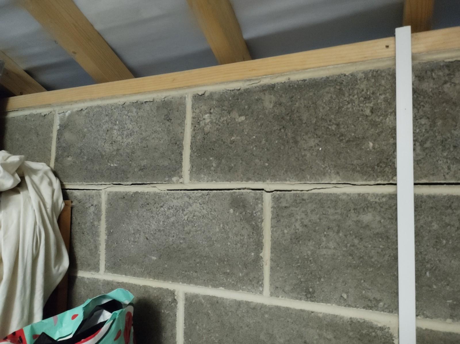

CrispDust Posted November 23, 2021 Share Posted November 23, 2021 Hello all, First post so I hope this i in the right section. We have a detached garage that was built about 7-8 years ago. We purchased the property recently, after renting for some time. The garage is about 12' wide by 20' length with a hipped roof. inner block leaf and an artificial "stone" outer. We have noticed over the past few months that the top 2 or 3 courses of the block work on all 4 walls, to a varying degree, have started to tilt/bow outwards. Most of the top course are at a noticable tilt and have seperated from the mortar. There is obvious bowing of the soffit on the external walls. I assume this has occurred due lateral thrust from the roof? The roof is hipped construction. There are no horizontal joists. On closer inspection I have noted the following issues which don't meet NHBC regs: The wall plate does not have half lapped joints at the corners. There is notable seperation of the joints on 3 or the 4 corners. There are no angle restraints/joists across the wallplate corners. My understanding is that the wall plate acts as a strain ring to resist the lateral thrust. There are only 2 vertical straps on each short wall, 3 on the longer wall. All at least 3 to 4m apart with 3 nails tapped into the mortar, not the blocks. Do vertical restraints add to the thrust resistance from the roof or are they solely just as anti lift restraints? The wall plate over the door simply sits on the metal lintel, no obvious fixings. As mentioned previously, there are no horizontal joists between the joists, although I undestand this is usual for a hipped roof design? There has been no loading on the roof from storage or hanging items tools etc. Any comments before I get the original builder and original roofer round? Anything else I should be looking out for? Thanks in advance. Link to comment Share on other sites More sharing options...

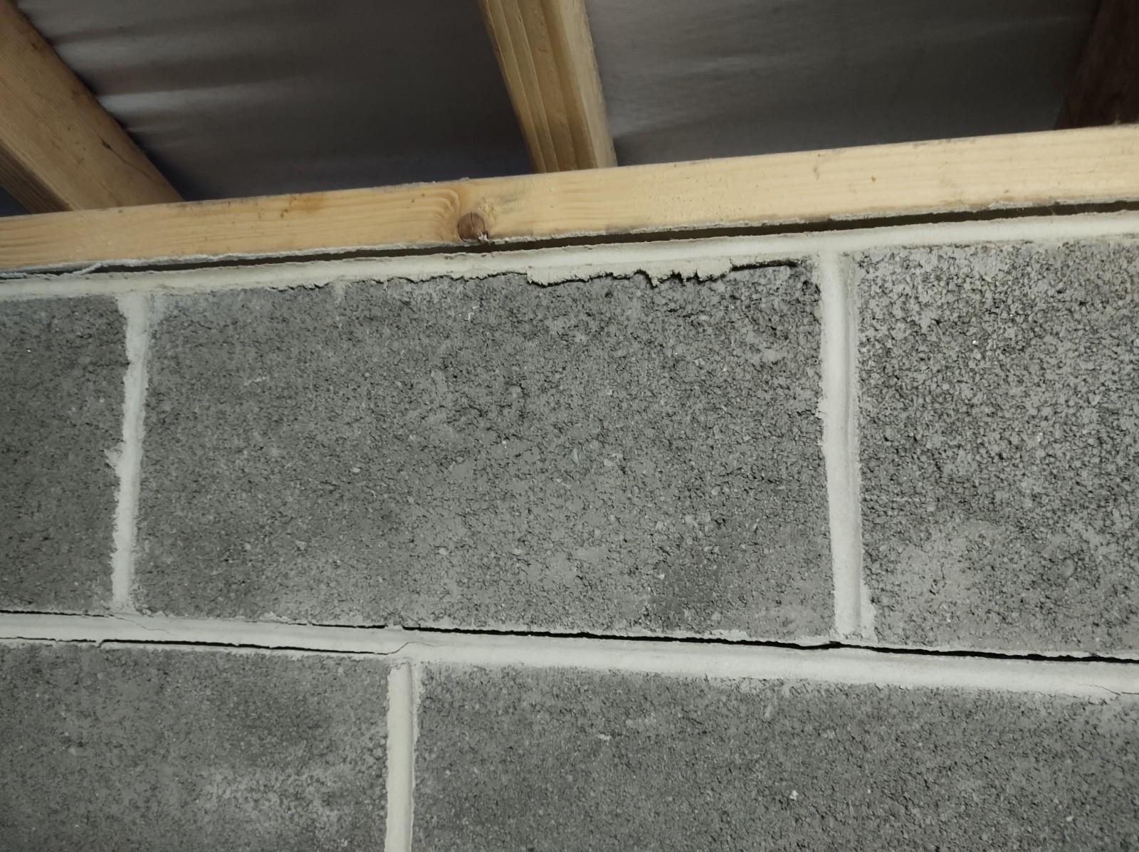

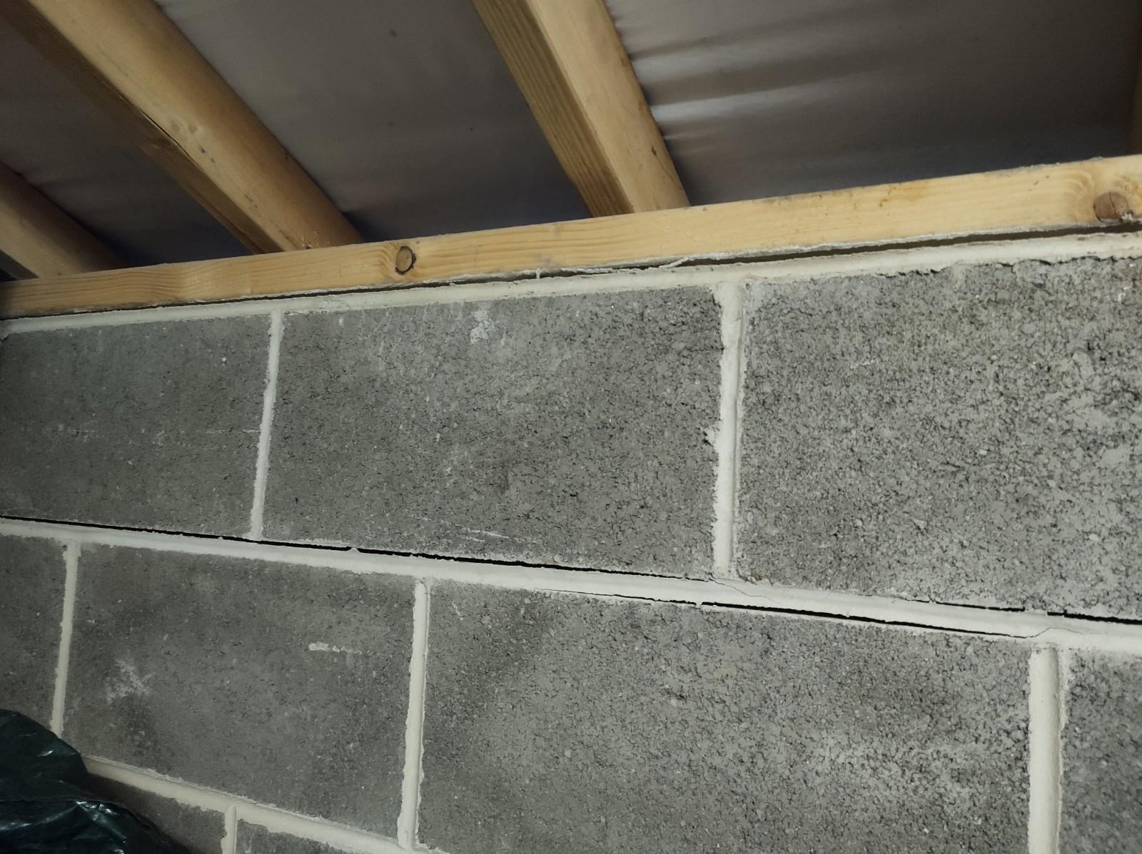

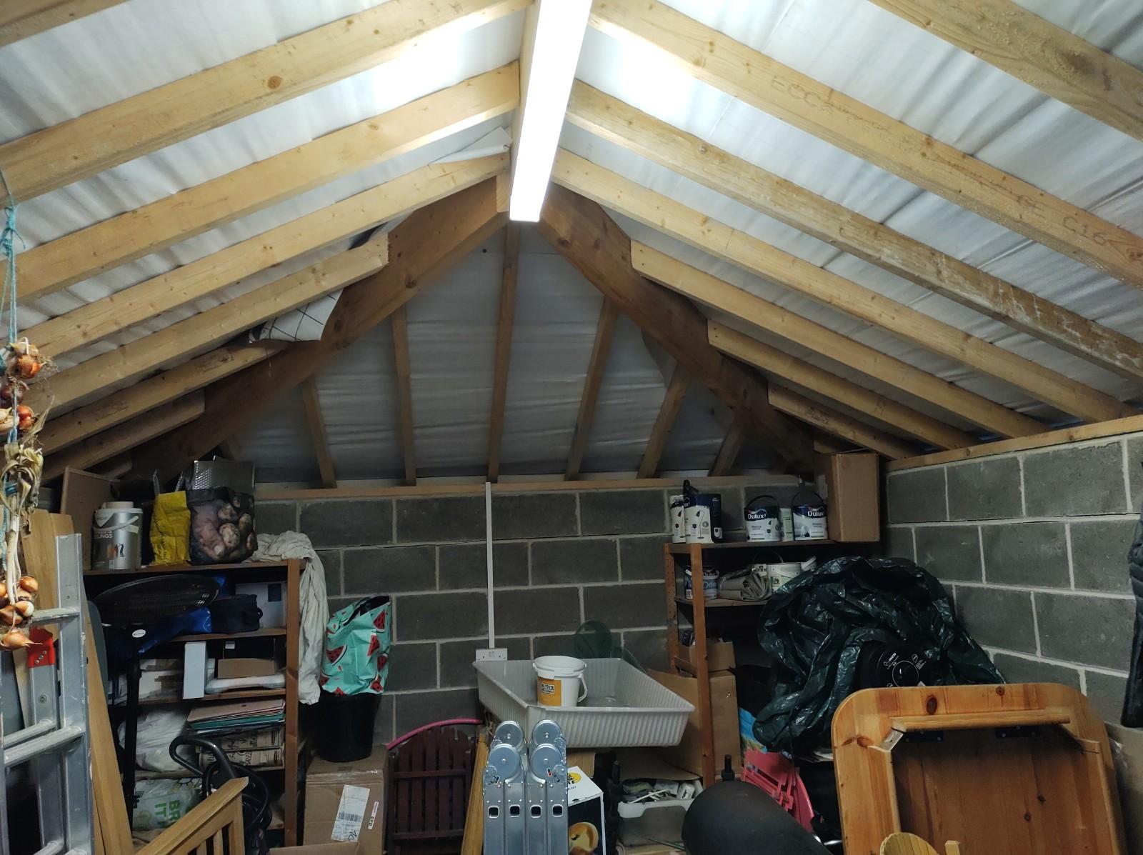

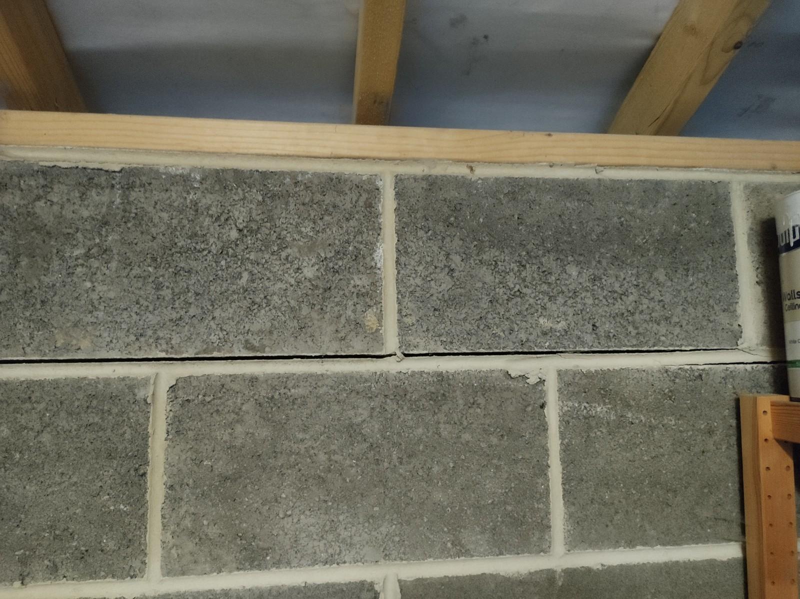

CrispDust Posted November 23, 2021 Author Share Posted November 23, 2021 Thanks for answers. My son is an architectural tech but for commercial not domestic builds. He says a hipped roof doesn't normally have horizontal joists. I was surprised at this. Here are some photos: Link to comment Share on other sites More sharing options...

ProDave Posted November 23, 2021 Share Posted November 23, 2021 It looks like that was built as a vaulted roof hung from that ridge beam but that does not really work with a hipped roof without steels to support it at the end. The solution is simple, a horizontal timber say 4 by 2 across the roof at wall plate height strapping each rafter to it's neighbour the other side, securely bolted at the junctions. this will stop the spread. You might want to set up something like a Spanish Winch to pull the sides back into place at each rafter before bolting the cross members. The purists will say roof off, re lay the cracked courses and rebuild the roof. Link to comment Share on other sites More sharing options...
joe90 Posted November 23, 2021 Share Posted November 23, 2021 5 minutes ago, CrispDust said: a hipped roof doesn't normally have horizontal joists. Ah, hips do give some structural support, but yours ain’t,, my house roof was designed as hips without ties but the BCO insisted on vertical steels to the ridge at both ends , it would have taken to long to argue so we just did it. If you had “ceiling joists”, this would not have happened (and I have built many garage roofs, converting them from leaky flat ones!). Link to comment Share on other sites More sharing options...
CrispDust Posted November 23, 2021 Author Share Posted November 23, 2021 Ill get some info on the tiles. The garage was built whilst we were renting. So the bottom line is, the roofer (who was not linked to the builder) should have put some horizontal joists across the rafters? Link to comment Share on other sites More sharing options...
joe90 Posted November 23, 2021 Share Posted November 23, 2021 Just now, CrispDust said: should have put some horizontal joists across the rafters? In my opinion, yes. (Whatever the tiles are). Link to comment Share on other sites More sharing options...
markc Posted November 23, 2021 Share Posted November 23, 2021 21 minutes ago, CrispDust said: Thanks for answers. My son is an architectural tech but for commercial not domestic builds. He says a hipped roof doesn't normally have horizontal joists. I was surprised at this. Here are some photos: Wether commercial or domestic, roof loads have to go somewhere, yes you can have hipped roofs without ties but then they need moment connections at the top. unfortunately you have a low pitch roof, simple hip to ridge connections, weak walls and very little to hold the eaves together…. they could have used trussed or tied rafters and there would have been no problem 1 Link to comment Share on other sites More sharing options...

joe90 Posted November 23, 2021 Share Posted November 23, 2021 (edited) 31 minutes ago, Adrian Walker said: You mentioned NHBC, Not worth the paper it’s written on ! Try the surveyor but don’t hold your breath, they have get out clauses you never heard of. I would want to pull the wall plates back in line then bolt timbers across the roof, I prefer half way up to the ridge or below that if you can, you can always point up the top row of blocks and wall plate. Oh and put more straps on screwed into the blocks. Edited November 23, 2021 by joe90 1 Link to comment Share on other sites More sharing options...
markc Posted November 23, 2021 Share Posted November 23, 2021 As an aside, I think my notion of a correctly constructed wall plate being a strain ring has some merit? I agree, that does mean taking the roof off to do it as a wall plate. you could jack up the ridge to correct height (plus a bit) and then add tension members (cables, flat bar etc) adjacent to the wall plate to hold the hips together. Link to comment Share on other sites More sharing options...

saveasteading Posted November 23, 2021 Share Posted November 23, 2021 Pulling together all the good advice above....we would expect that the walls are buckling out most at the middle of the walls as the roof is restrained at the corner by the hip, and the walls there are restrained by the corner of the blockwork. The cracks and movement being at the top suggest that it is only the roof and that the founds are ok. I agree with the suggestions. more photos first, then jack up with a couple of acrow props under the ridge. Buy second hand if it will be for more than a few weeks. Best put a timber bearer on the floor if it is the same builder. The NHBC warranty isn't often much help, the surveyor will have get-out clauses, the building inspector doesn't check everything, the builder probably doesn't have insurance worth anything to you. But try. But do tell your insurer promptly or they will also say you took too long. They may pick the claim up and chase these others. they will then allow you to get repairs done, and might even pay for an Engineer. Link to comment Share on other sites More sharing options...
