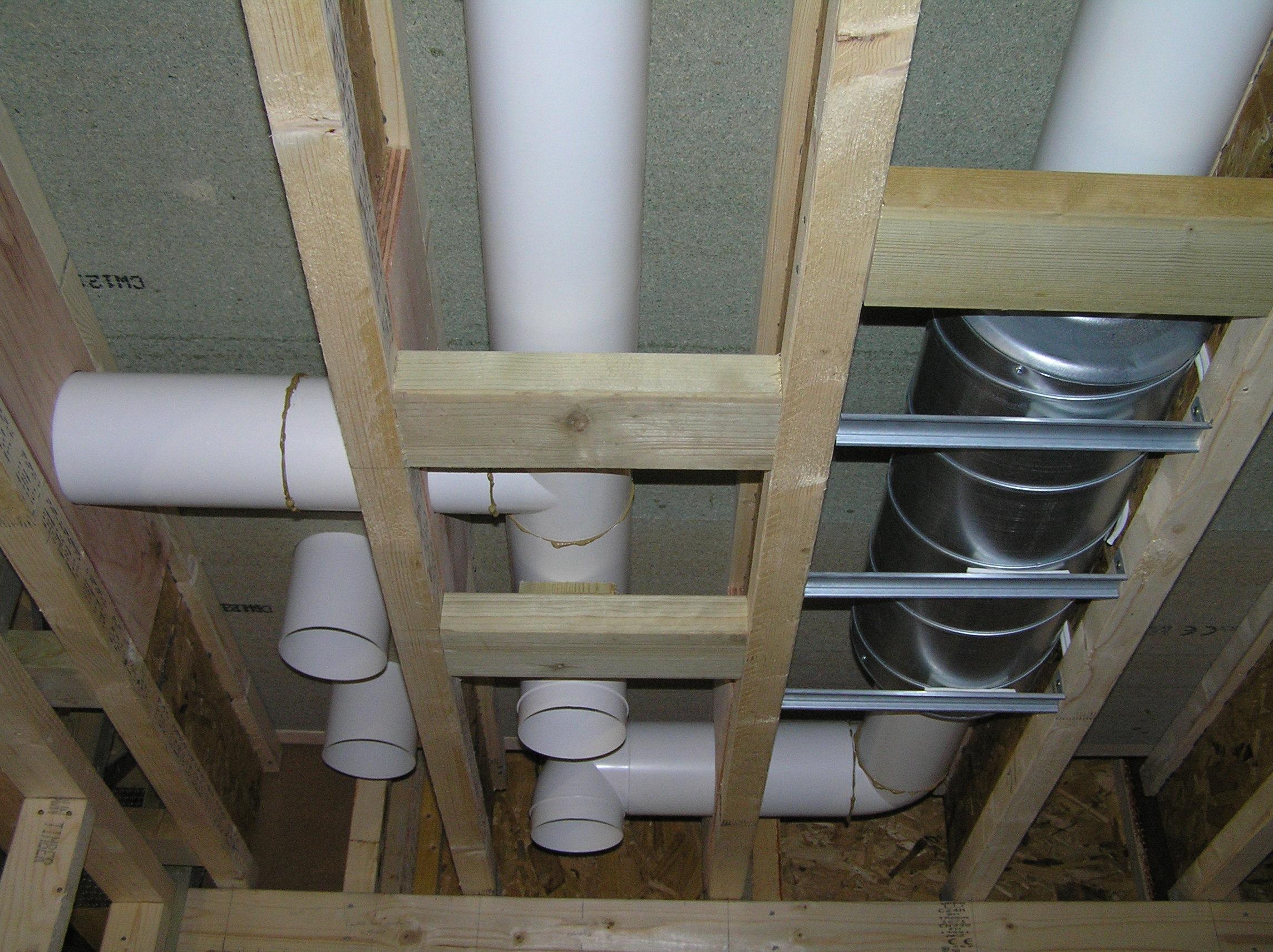

Cognis0 Posted November 15, 2021 Posted November 15, 2021 Such systems are available from "exotic" European manufacturers coming with galvanized ductwork, to perhaps more basic UK offerings, often with narrow flexible plastic ducting. No doubt there is a significant difference in pricing and, presumably, performance. One area which is very important is noise. My wife is extremely sensitive to electronic and vibration noise and finding something which effectively silent is just about top of the list of requirements. Your comments welcome...
JohnMo Posted November 15, 2021 Posted November 15, 2021 We have semi flexible 90mm via plenums, and we are the best part silent, that with Scottish building regs requirements of 0.5 ACH, compared to England which I believe is 0.3 ACH. We have two MVHR Units, to enable short runs and low pressure drops, this keeps fan speed down, even on boost we are only at about half max speed. Keeping velocity through ducts low, fan speed low all contribute to low sound levels.
Gone West Posted November 15, 2021 Posted November 15, 2021 The ducting can be bought separately from the MVHR unit and can be metal, rigid plastic or flexible plastic. The ducting design can also be serial or manifold. I designed my own system which was a serial, rigid plastic ducting design connected to an expensive Danish compact unit. You can choose what you want. 2
Dreadnaught Posted November 16, 2021 Posted November 16, 2021 I have just specified and bought my MVHR kit. But I have not installed it yet. I purchased it directly from the manufacturer of the unit I chose. Great service from them, by the way, even including a site visit, when he was in the area visiting someone else (!) Like you I was keen on whisper quiet. First, I chose a PH-certified MVHR unit and bought the ducting from he same manufacturer. Choosing a quite unit I think is key to having a quiet system. And I slightly over-specified the unit too. There was a smaller model available that would have been sufficient but the price difference was small. To tackle the risk of noise, it wasn't required by the MVHR designer who did the calcs for me, but I chose to pay a little extra and double-up almost all the duct runs (other than very very short ones). I also chose to have 1m-flexible-silencers on both the supply and extract from the dwelling. And I have bought a supply manifold which has extra baffling inside too. The ducting is semi-flexible and radial, so no cross talk and I used the wider (90mm external diamater) ducts rather than the smaller ones (75mm external diameter). The expert who sold me the system said that my system should indeed by whisper quiet and the marginal increase in cost will be modest. 3
Marvin Posted November 16, 2021 Posted November 16, 2021 Installed my own MVHR with rigid ducting. No machine sounds / wind blowing down a pipe sounds on normal flow. A low amount of air noise at boost level. Noise transfer from room to room will be sorted with baffles . Very happy with system. 100m2 floor. Presently running on a meter test plug at 7.2 Watts/h average over 10 days. MVHR box in loft above main bedroom but you wouldn't know! Purchased a 250m2 unit so running at a low speed...
tonyshouse Posted November 16, 2021 Posted November 16, 2021 Sound attenuators, ridged metal spiral ducts for me. Oversize and run on low speed
Iceverge Posted November 16, 2021 Posted November 16, 2021 I built my own silencer. worked very well. Next time i would combine and build my own manifold/silencer like @joe90 did. I would consider building a soundproof cupboard for the MVHR UNIT too. You can hear it when the door to the utility is open. 2

Dreadnaught Posted November 17, 2021 Posted November 17, 2021 (edited) On 17/11/2021 at 01:06, hendriQ said: What’s the benefit of this? Expand The two main sources of noise are (i) the unit itself and (ii) the high speed air in the ducts. And for (ii) especially the turbulence caused when the velocity of that air changes at, for example, the point where a duct joins a larger valve, such as at the point where air is supplied in to a room. (i) is addressed by buying a better quality Passive-House certified unit and fitting silencers. (ii) is addressed by slowing the speed of air flow in the ducts by increasing their cross-sectional area by doubling them up. The rule-of-thumb for noise in ducts is to keep the speed of the air below 2.5 metres per second on boost level. I went even lower. Edited November 17, 2021 by Dreadnaught 2
Dreadnaught Posted November 17, 2021 Posted November 17, 2021 Oh, and I positioned the MVHR unit as far away from the bedrooms as I could, even taking the precaution of placing it on the far wall of the plant room. In a well-insulated house, which is airtight and triple-glazed, and which therefore tend to be whisper quiet inside, even small sounds become noticeable, sounds that would normally blend into the background of a normal house. 2
joe90 Posted November 17, 2021 Posted November 17, 2021 On 17/11/2021 at 07:27, Dreadnaught said: and I positioned the MVHR unit as far away from the bedrooms as I could Expand Mine is in the loft but hung from the roof trusses, on rubber mounts so no noise is transmitted through the bedroom ceilings. Very quiet. 1

Gone West Posted November 17, 2021 Posted November 17, 2021 One of the mistakes I made fitting the ducting on my system was to fit an attenuator on the supply circuit and not on the extract circuit. I didn't think it would matter as the extract vents were only in the bathrooms, kitchen and utility. The rooms with supply vents were silent but the bathrooms etc had a slight background hum only audible in the room itself. If I ever design another system for myself I would use two attenuators. https://www.ductstore.co.uk/acatalog/Attenuators.html 2
