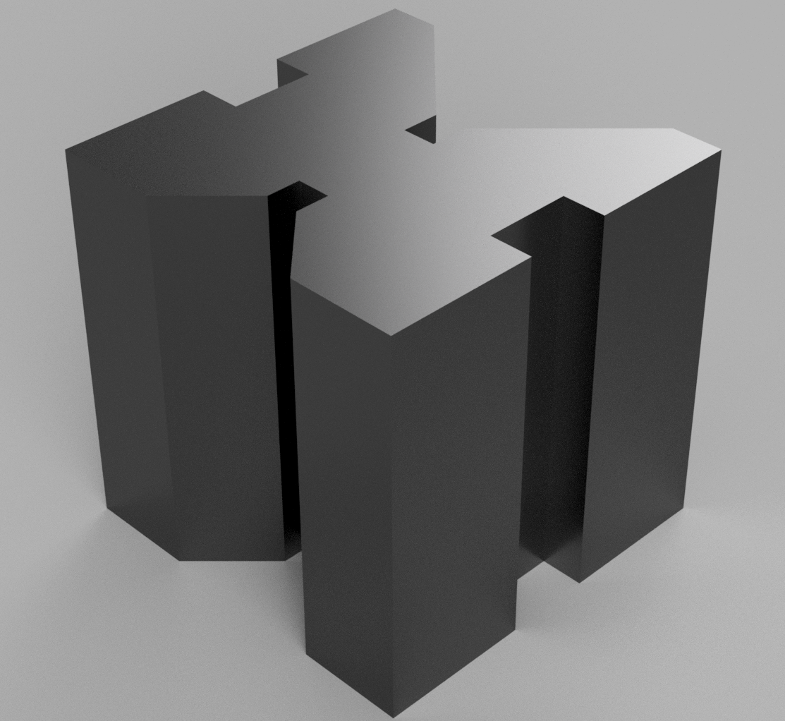

Onoff Posted November 3, 2021 Posted November 3, 2021 Dug out my old EITB drawings from when I was an apprentice. I made a centre finder and V blocks back then amongst many other things. Gave the drawings to No.1 son and he re-did them on Fusion. Now printing the centre finder for my mate John. 1

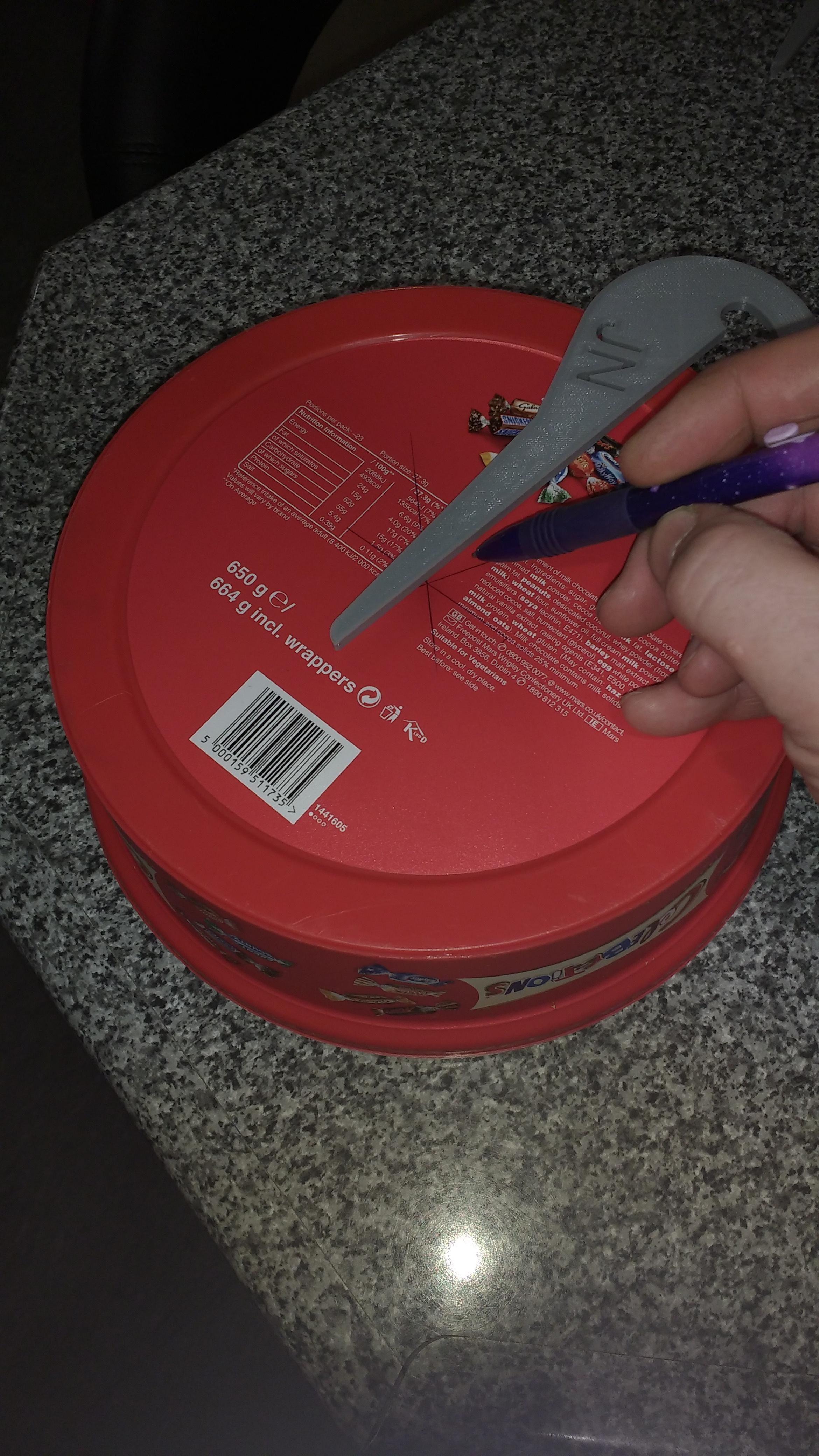

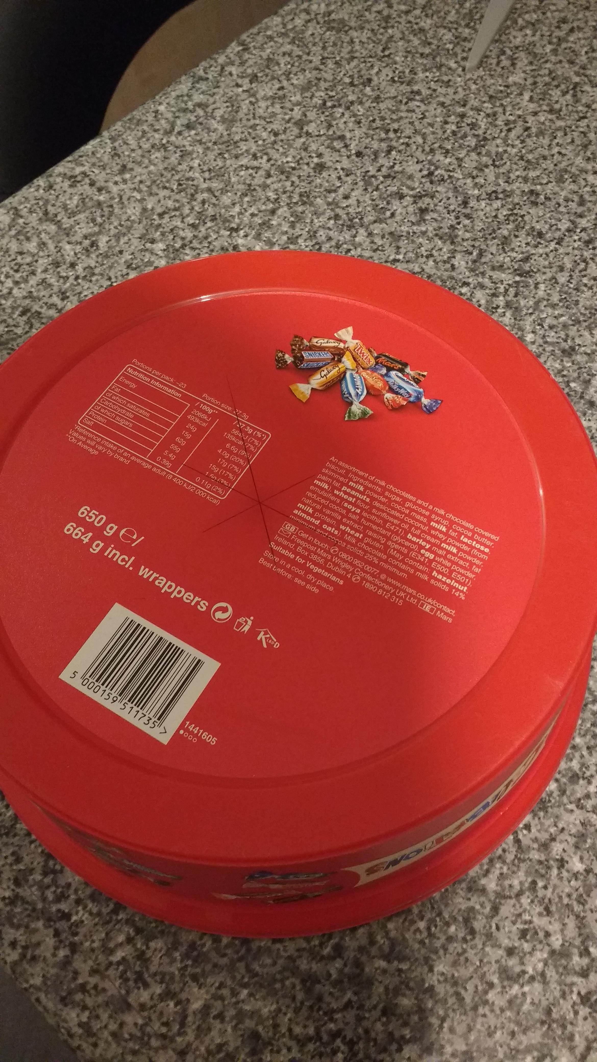

Onoff Posted November 5, 2021 Author Posted November 5, 2021 The centre finder works a treat. Hold tight against the perimeter and scribe a line. Move around the perimeter and scribe another. Do a third. Where the lines intersect is your centre: 1

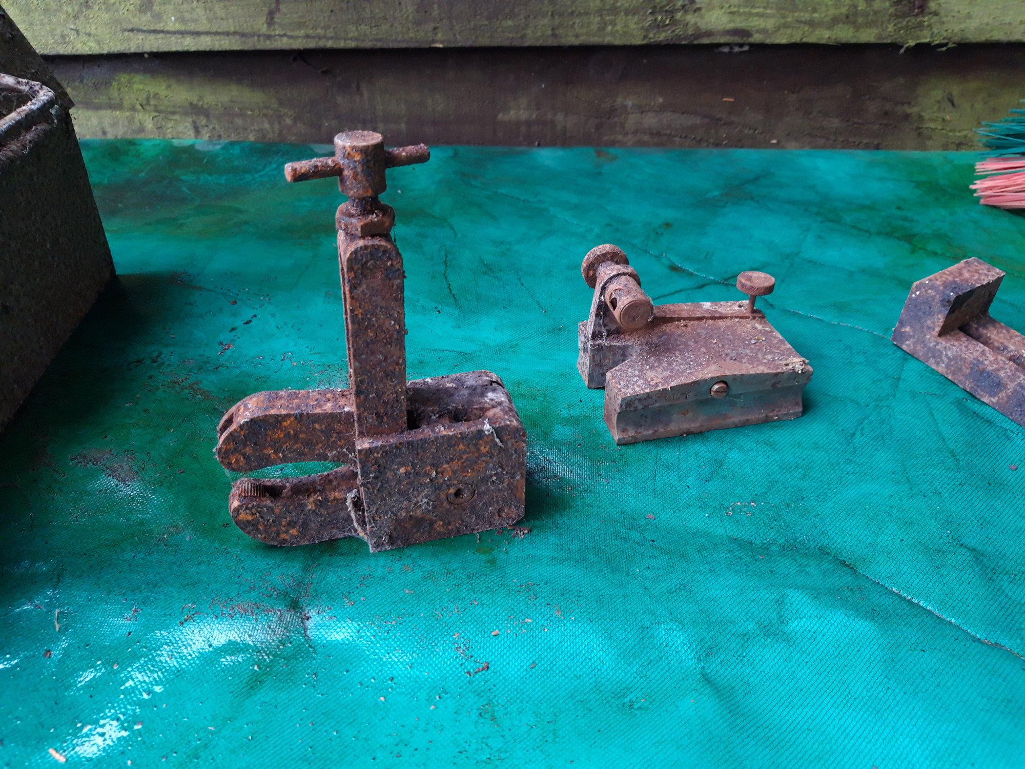

Onoff Posted November 5, 2021 Author Posted November 5, 2021 1 hour ago, markc said: When apprenticeships taught skills. I just gave the toolbox I made at 16 a quick dunk in a citric acid bath and then etch primed it. Has more than a few pin holes but it had been neglected. The knurling tool and drill clamp I made are likely recoverable, not do sure about the surface gauge. A bit gutted I let them get in this state but in the intervening 40 years, "life" happened. Amazing to think I made all the nuts and bolts! 2

Roys Posted November 5, 2021 Posted November 5, 2021 @Onoff what’s the item next to the toolmaker clamp that looks like a rectangular branding iron?
Onoff Posted November 5, 2021 Author Posted November 5, 2021 40 minutes ago, Roys said: @Onoff what’s the item next to the toolmaker clamp that looks like a rectangular branding iron? A leather punch I believe. Found a number of those and shoemaker's lasts buried at the back of my old stable. It was rusty so I chucked it in the citric bath too. That Sarah bird would have kittens what with me ruining the patina!

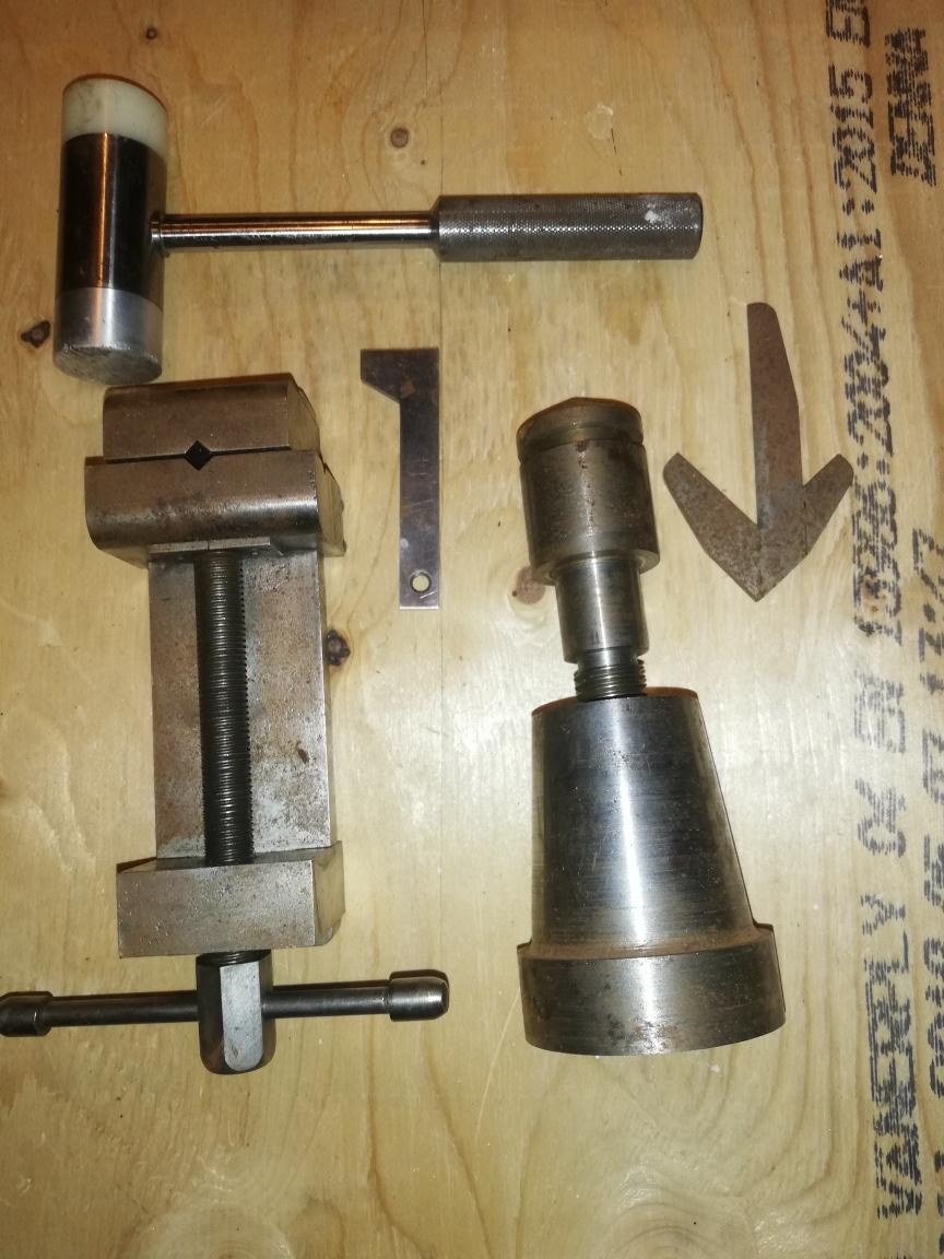

ProDave Posted November 5, 2021 Posted November 5, 2021 The centre finder I made is the same as @Roys one. I haven't seen my knurling tool for a long time, that might be lost. Watchmakers screwdriver set, including a case for them machined from Tuffnel. Printed circuit board holder, I can't remember if that was engineering at school or apprenticeship.
