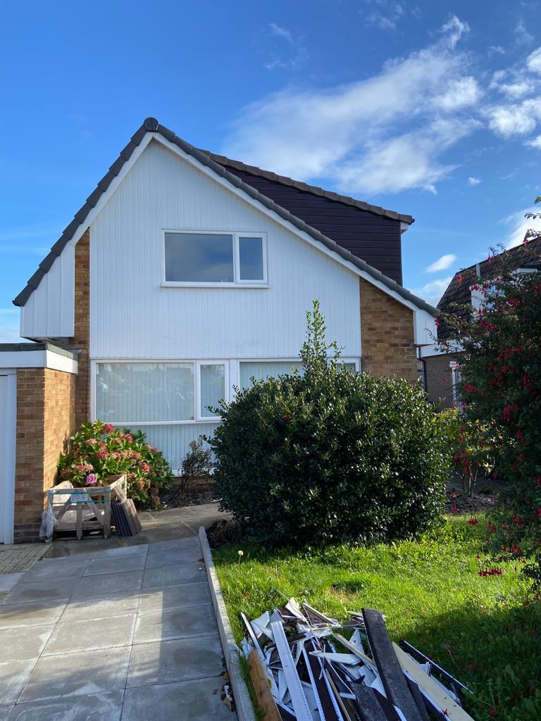

Susan61 Posted November 3, 2021 Share Posted November 3, 2021 (edited) Hi - apologies for the long post but has anyone any advice on this issue - we have erected a side dormer on a detached house under Permitted Development. A planning compliance officer unexpectedly visited our property at the stage when only the timber framework was up. Assuming a neighbour had reported this. The planning officer asked the builder to see the plans as we weren’t present. She asked what the dormer would be faced with which he replied white cladding. Compliance officer then ring to say it had to be tiled. We pointed out that a recently completed almost identical dormer near us was cladded to which she replied ‘we don’t go looking for work’ . We told her the builder was unable to source the tiles and she said leeway had been granted during Covid due to materials shortage but she believed this was now resolved. She also emailed the next day to say windows had to be obscure and non opening below 1.7m. She went on holiday but said to email the compliance team with any problems or issues and they would pick it up. We tried multiple suppliers but could not source the tiles. We emailed the compliance team to ask if we could use brown cladding as PD criteria was the material didn’t have to be the same only visually similar to the existing roof and also sent a screenshot to evidence supply issues. We waited a month but got no response. We tried to ring but no option for planning on the menu. The builder couldn’t wait any longer and the scaffolding needed to go so we went with the brown cladding. Two days after installation the compliance officer visited the site and we received the notice of intention to go to enforcement with no further communication as we had ignored advice and used brown cladding and that the windows weren’t opaque. We emailed again saying we hadn’t had a response from them after a month and the builder couldn’t wait any longer but would not have used the brown cladding if they had said no. We also told her the windows are opaque. Still no response two weeks later. We understood that government guidelines state there should be negotiation before enforcement but they have gone straight to enforcement. At the time they advised us about materials there had been no breach. We feel we haven’t been given any chance to negotiate. We did manage to speak to another officer on the team when we eventually found a number to ring and their view was matching materials is very subjective but he could see the enforcement notice was being prepared . So far we have been unable to speak to the relevant officer as she is out of the office most of the time. We are not sure what our chances would be if we appealed so would prefer to be given the chance to sort this out prior to enforcement but are hitting a brick wall. We are not sure whether to now let it go to appeal but would have to employ a planning consultant and we aren’t sure what the chances of success are. We would appreciate any views on this. Many thanks. Edited November 3, 2021 by jack Added paragraph breaks Link to comment Share on other sites More sharing options...
ProDave Posted November 3, 2021 Share Posted November 3, 2021 Look up and contact head of planning for your area and raise a complaint. 1 Link to comment Share on other sites More sharing options...
Temp Posted November 3, 2021 Share Posted November 3, 2021 I suspect they have only issued another "notice of intention to begin enforcement". You have multiple options... 1) Wait for formal enforcement and appeal on the grounds it's permitted development. 2) Apply for a CLD on the grounds that it's permitted development. If refused Appeal. 3) Make a planning application. If refused Appeal. 4) Ignore them and hope they never actually issue enforcement. If someone complains planners feel obliged to investigate to avoid a more serious complaint. They might approve a retrospective planning application for what you have built because it solves all their issues. Eg it makes it all legal and kills off any complaint from neighbours. Which you choose depends on how compliant with PDR you think your work is. 1 Link to comment Share on other sites More sharing options...
Dave Jones Posted November 3, 2021 Share Posted November 3, 2021 get your local counciller on the case. even if they issue a notice you can appeal it. 1 Link to comment Share on other sites More sharing options...
cowsgomoo Posted November 3, 2021 Share Posted November 3, 2021 I'm not sure if I would raise a complaint as I'd hedge my bet that it wouldnt resolve your issue. I would consider retrospective planning application. What are the details of the tiles you were advised to use and what did you actually use? 1 1 Link to comment Share on other sites More sharing options...
Susan61 Posted November 3, 2021 Author Share Posted November 3, 2021 (edited) Thanks for your replies. We originally applied for planning permission but this was refused in the grounds of the impact on the streetscene. They then suggested we go down the route of Permitted Development. The compliance officer said we should use plain tiles for the cheeks and face of the dormer to match the roof. The roof is brown Double Roman tiles. The flat tiles don’t match the profile of the roof tiles either. We couldn’t source the roof tiles due to Covid supply problems but used brown cladding rather than the white cladding we thought would be ok as the front of the house is already clad in white. Condition B2 of Permitted Development criteria states materials should match the existing roof but not necessarily the same material. Edited November 3, 2021 by Susan61 Add photo and edit typo Link to comment Share on other sites More sharing options...
Declan52 Posted November 3, 2021 Share Posted November 3, 2021 Paint the cladding white. Get the job passed and signed off and then go back to brown if you really want to. 1 Link to comment Share on other sites More sharing options...

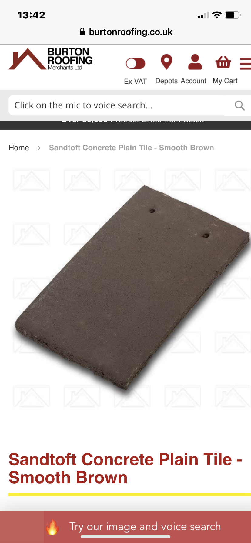

Susan61 Posted November 3, 2021 Author Share Posted November 3, 2021 This is the tile they want us to use on the dormer Link to comment Share on other sites More sharing options...

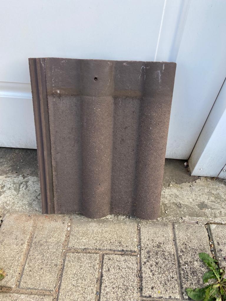

Susan61 Posted November 3, 2021 Author Share Posted November 3, 2021 To match the existing roof tile above Link to comment Share on other sites More sharing options...
Temp Posted November 3, 2021 Share Posted November 3, 2021 Are there other dormers in your area clad in brown? If so I think I would submit a retrospective application together with a set of photos of similar dormers. 1 Link to comment Share on other sites More sharing options...
Roundtuit Posted November 3, 2021 Share Posted November 3, 2021 It looks fine I reckon. I'd try and escalate it within the council, and call their bluff. They'll be hard-pushed to justify any enforcement action given their lack of engagement and error regarding the windows. 1 Link to comment Share on other sites More sharing options...
Susan61 Posted November 3, 2021 Author Share Posted November 3, 2021 Thank you for all your replies. We have already been turned down for planning permission and advised to go down the Permitted Development route by the Council. There are other dormers in our area but these have probably been constructed some time ago if that makes any difference. Link to comment Share on other sites More sharing options...

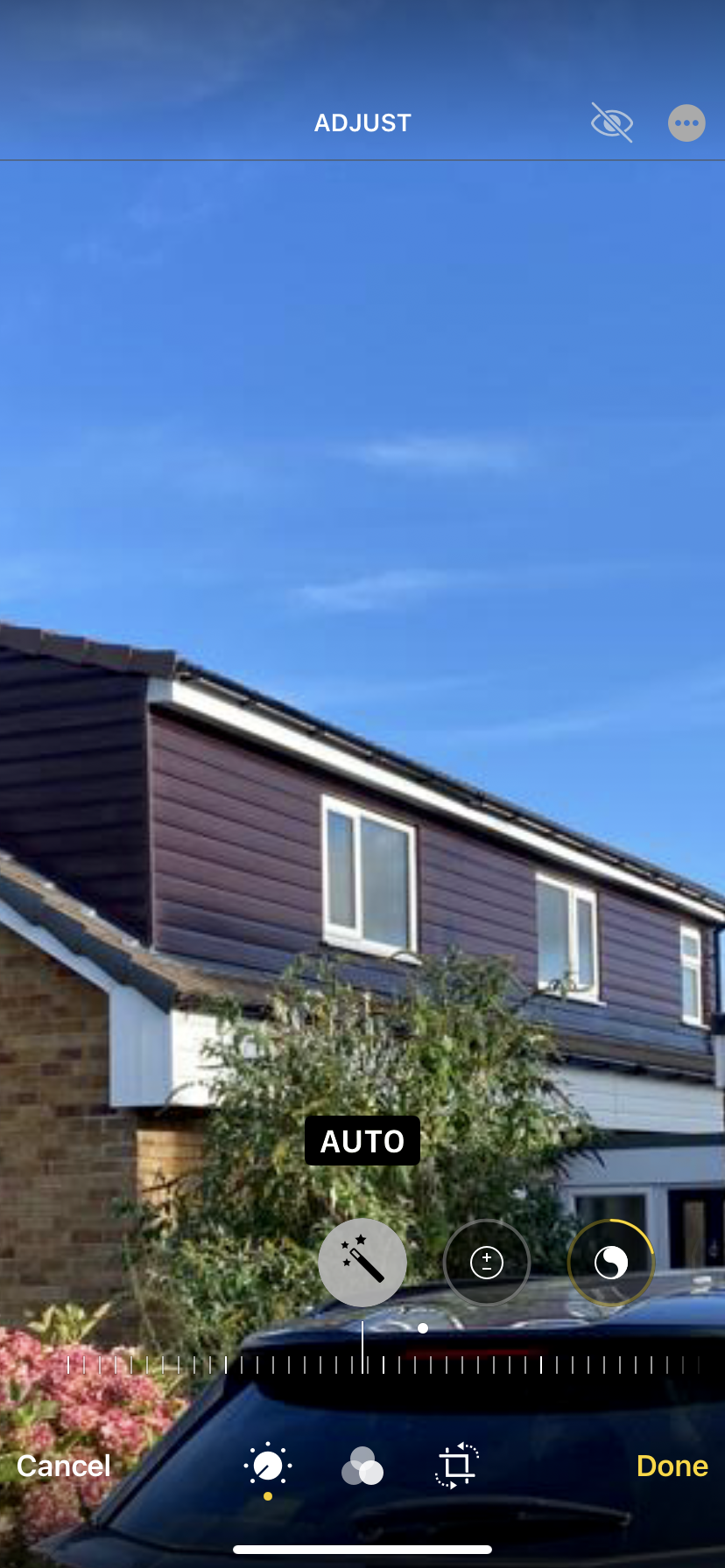

Stones Posted November 4, 2021 Share Posted November 4, 2021 @Susan61 Is the dormer cladding on the house adjacent white - appears so from the photo? I would suggest this would be something to use in any discussion with the planning authority. 1 Link to comment Share on other sites More sharing options...
Susan61 Posted November 4, 2021 Author Share Posted November 4, 2021 They do have a white cladded dormer on both sides of their roof but they are much smaller dormers than ours. There are several cladded dormers on our estate of a similar size to ours in various colours. Link to comment Share on other sites More sharing options...
