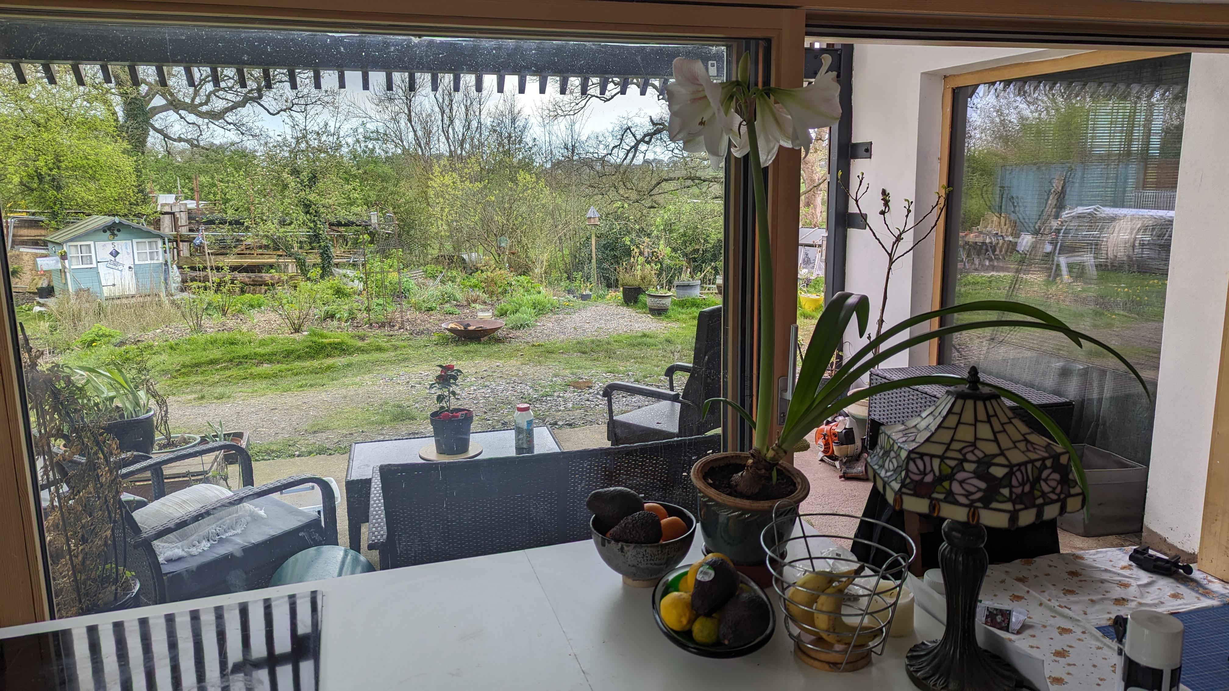

ToughButterCup Posted April 16, 2024 Posted April 16, 2024 On 14/04/2024 at 16:58, mjc55 said: You do seem to be very similar in ideas to the way we work Mr ButterCup, noticed this in other threads that we have partaken in! I suppose though that having it installed but not using it to it's fullest capabilities doesn't have many downsides other than cost? Our plan is to have large opening windows and I would fully expect these to be open for as much time as possible. We are planning on pretty big overhangs over the rear elevation so even in rainy weather there would be the opportunity to sit on our "Veranda". I thought these photos might interest you ..... the first one taken a few minutes ago The slider in the kitchen has been open all morning - right hand side of the image is to the North, and thus the Winter Garden is in wind shadow (wind NW) , but in full sun (it was raining when I took the photo) There is a 2.5 meter overhang for a 'veranda' shown here earlier in the build. We call it a Winter Garden - yet to have anything in it , but won't be long now. SWMBO intends to fill it with - knowing her - a jungle or as close to that as she can get. There's one episode of Grand Designs where Kevin WotHisFace showed a similar design, but he calls the area a Breeze Corridor. The look of triumph on Debbie's face was a picture. First time she'd ever been 'on trend' she remarked. 5
mjc55 Posted April 16, 2024 Posted April 16, 2024 4 hours ago, ToughButterCup said: I thought these photos might interest you ..... the first one taken a few minutes ago The slider in the kitchen has been open all morning - right hand side of the image is to the North, and thus the Winter Garden is in wind shadow (wind NW) , but in full sun (it was raining when I took the photo) There is a 2.5 meter overhang for a 'veranda' shown here earlier in the build. We call it a Winter Garden - yet to have anything in it , but won't be long now. SWMBO intends to fill it with - knowing her - a jungle or as close to that as she can get. There's one episode of Grand Designs where Kevin WotHisFace showed a similar design, but he calls the area a Breeze Corridor. The look of triumph on Debbie's face was a picture. First time she'd ever been 'on trend' she remarked. Looks fab Mr ButterCup 😁 1
