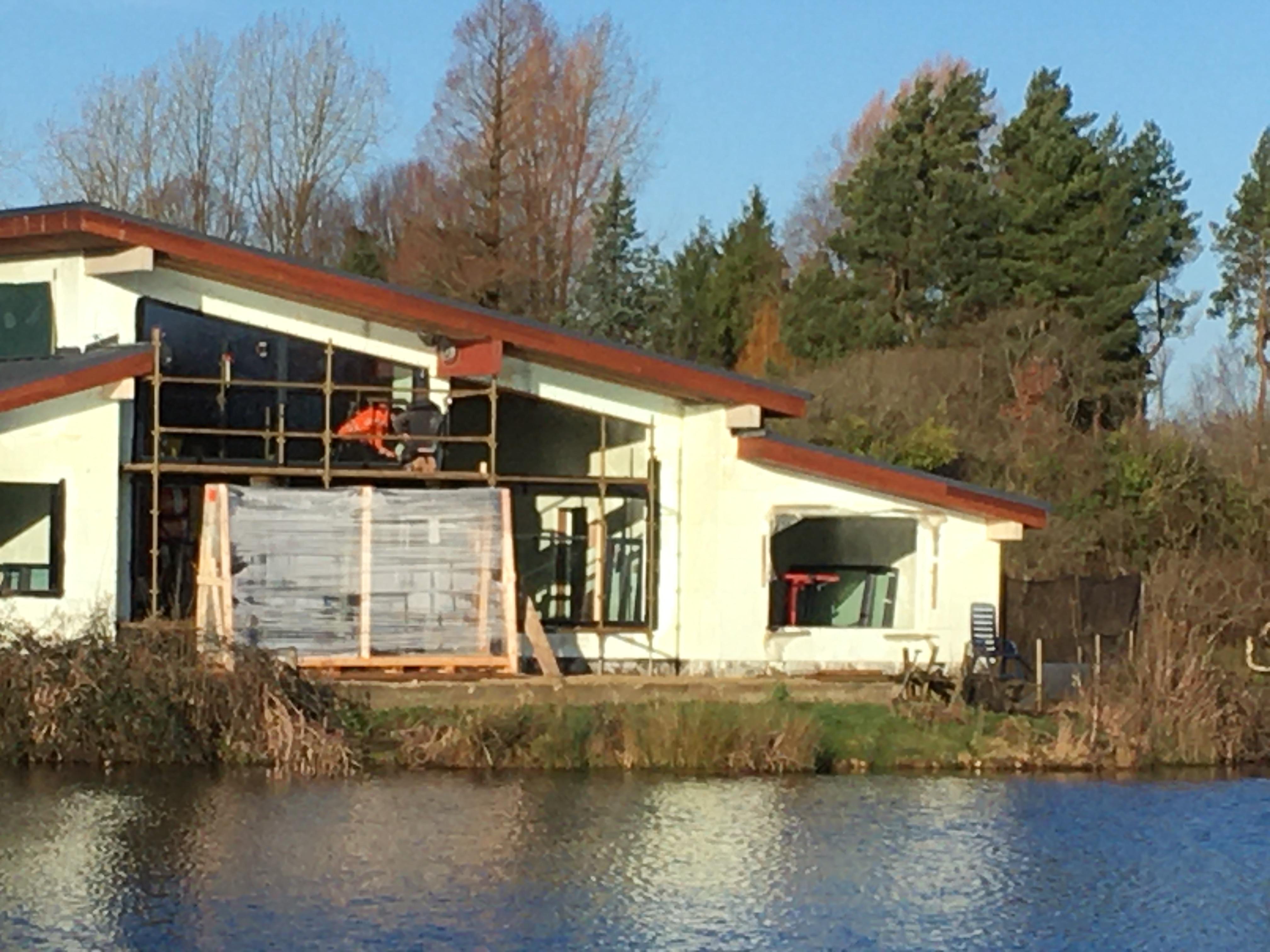

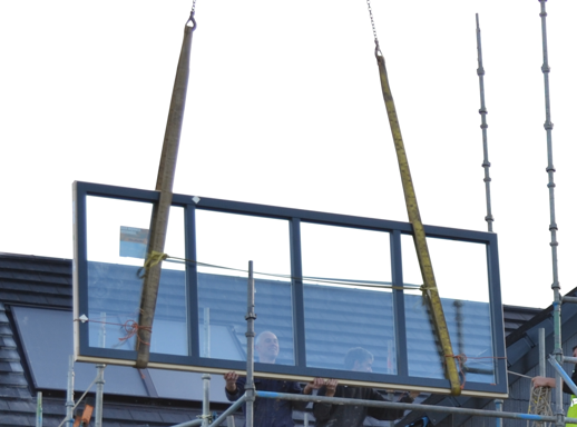

AliG Posted June 8, 2022 Share Posted June 8, 2022 Resurrecting this thread. My windows are mostly in and looking good. But the builder is struggling with the largest window. The windows are from Russell We have a 3G slider that is 3.7x2.5m and weighs 467kg. Original plan was to move it through the house into position on rollers. builder is concerned re safety of this and the amount of labour needed. Current plan is to use a large crane to lift it over the house and lower it down into position. The crane company are uncertain if they have window lifters for the width of the quite deep frame. Apparently the fitters normally deal with Velfac and would dismantle such a large window and then put it back together in place. Russell have told them that they cannot dismantle the window although I have not had this conversation with Russell. It would seem that if we could take the slider out and reduce the weight to <250kg then things would be a lot easier. Very difficult to move the window round to the back of the house due to scaffolding and lack of flat ground. Does anyone have any suggestions? Link to comment Share on other sites More sharing options...

Miek Posted June 9, 2022 Share Posted June 9, 2022 8 hours ago, AliG said: Resurrecting this thread. My windows are mostly in and looking good. But the builder is struggling with the largest window. The windows are from Russell We have a 3G slider that is 3.7x2.5m and weighs 467kg. Original plan was to move it through the house into position on rollers. builder is concerned re safety of this and the amount of labour needed. Current plan is to use a large crane to lift it over the house and lower it down into position. The crane company are uncertain if they have window lifters for the width of the quite deep frame. Apparently the fitters normally deal with Velfac and would dismantle such a large window and then put it back together in place. Russell have told them that they cannot dismantle the window although I have not had this conversation with Russell. It would seem that if we could take the slider out and reduce the weight to <250kg then things would be a lot easier. Very difficult to move the window round to the back of the house due to scaffolding and lack of flat ground. Does anyone have any suggestions? Rolling a half ton huge panel could be somewhat dangerous. I'd say you want plenty of rollers to avoid a point load occurring on the bottom of the unit. They may not want it dismantled due to warranties perhaps, but if its done with care this would ( and will be ) my favoured route. Let us know how you get on as I have an almost identical unit coming in the autumn . Link to comment Share on other sites More sharing options...
SimonD Posted June 9, 2022 Share Posted June 9, 2022 11 hours ago, AliG said: Does anyone have any suggestions? I would give the window lifting department at Hird a call. They were very good and helpful for me. Several options of vacuum lifters and potentially glazing robots. https://hird.co.uk/products/glass-vacuum-lifters/ https://hird.co.uk/products/glazing-robots/ Link to comment Share on other sites More sharing options...
craig Posted June 9, 2022 Share Posted June 9, 2022 You should be able to take the sliding sash off, reducing the weight by 50%, we normally use a one wheel bogey too transport through the house. Alternative option is using an Oscar 600 off road but you can only use the fixed pane for lifting. A telehandler with fork attachment and vacuum sucker is your best bet if you can navigate around the outside of the house. Link to comment Share on other sites More sharing options...
AliG Posted June 9, 2022 Share Posted June 9, 2022 Thanks Craig. Just spoke to the builder. He says the plan is to attach suckers to the fixed pane and open the moving pane enough to get a strap around the frame. I did ask the question as to whether the top of the frame can take the weight which he did agree he would have to check. Link to comment Share on other sites More sharing options...
craig Posted June 9, 2022 Share Posted June 9, 2022 (edited) 51 minutes ago, AliG said: open the moving pane enough to get a strap around the frame. If you're using straps, you need to lift from the bottom and you don't need to open the door to do this. However, I do presume he means a lifting strap around the bottom for 2 men to assist with the lift. Edited June 9, 2022 by craig Link to comment Share on other sites More sharing options...
AliG Posted June 9, 2022 Share Posted June 9, 2022 No, that was the question. He was thinking of opening the door enough to put a strap through under the top of the frame. I pointed out that the top of the frame was probably not designed to take any weight. I assume from what you say that you agree. Link to comment Share on other sites More sharing options...
craig Posted June 10, 2022 Share Posted June 10, 2022 On 09/06/2022 at 12:27, AliG said: I assume from what you say that you agree. Correct 😉 Link to comment Share on other sites More sharing options...
markc Posted June 10, 2022 Share Posted June 10, 2022 On 09/06/2022 at 11:22, craig said: If you're using straps, you need to lift from the bottom and you don't need to open the door to do this. However, I do presume he means a lifting strap around the bottom for 2 men to assist with the lift. That’s a good bit of slinging! Ties to stop the strops moving in or out if the load was tipped towards one strop Link to comment Share on other sites More sharing options...
craig Posted June 11, 2022 Share Posted June 11, 2022 8 hours ago, markc said: That’s a good bit of slinging! Ties to stop the strops moving in or out if the load was tipped towards one strop To be fair, that’s experience and knowledge but it wasn’t me or our team. That was a supply only project to the Orkneys 😉 Link to comment Share on other sites More sharing options...
