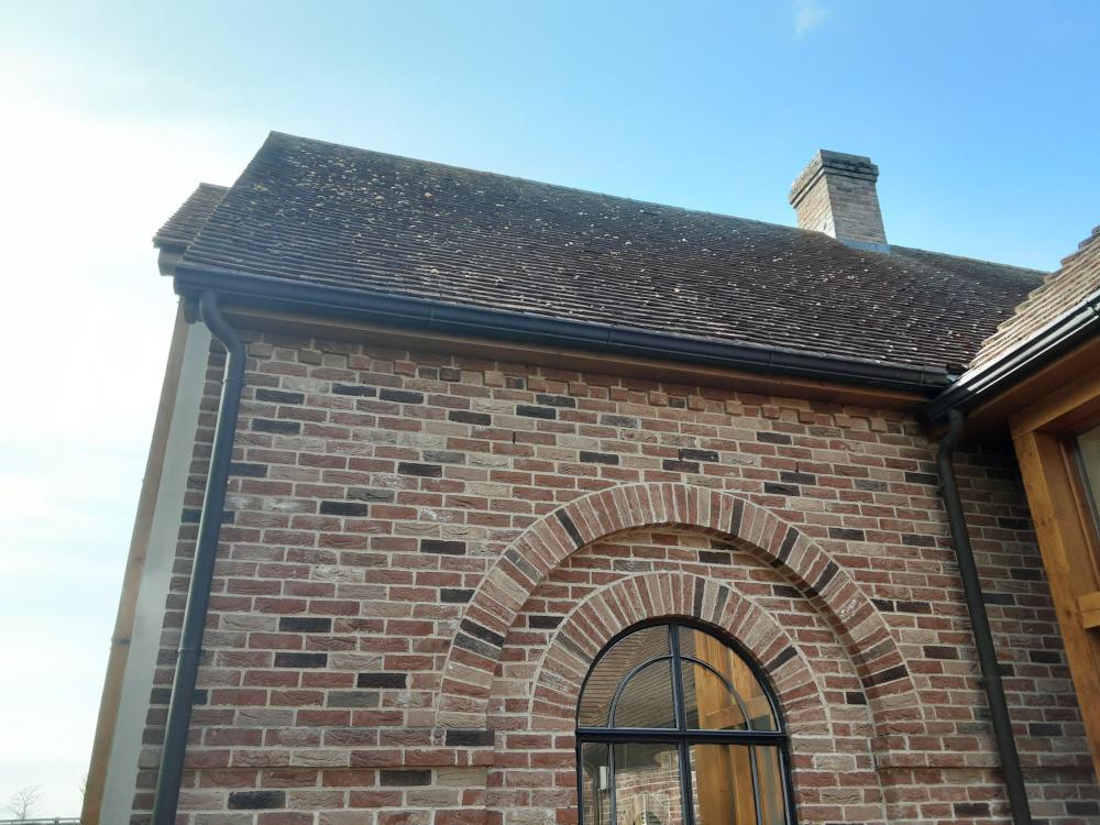

epsilonGreedy Posted September 18, 2021 Share Posted September 18, 2021 2 hours ago, BadgerBadger said: Our key driver is aesthetics - we're sat near some historic buildings, and our general approach is to go for high-quality materials that give us a "traditional" appearance without pretending our house is old. So our thinking is if lime (alongside handmade bricks) could give us a softer more natural finish than cement based mortar, but weighing up if it's worthwhile for any potential costs and other disadvantages. You can achieve a lot with "bagged" pointing, white cement and a mixed granular sized sand that colours the white mortar and produces a rough granular finish when rubbed. I only learned about mixed granular sand after my walls were up even so I am pleased with the finish using bagged pointing, white cement and a sand with a rich yellow colour. There are other details where you can spend money to age a property: Roof drainage gutter hoppers. External soil pipes. Cast aluminium gutters. Trad chimney pots. A couple of courses of grey bricks in a chimney flare. Low rise window cills rather than 150mm commodity modern estate cills or even white painted concrete cills cast onsite. No window recess or full brick window reveal rather than mainstream half brick reveals. Fat walls up to knee height. Brick corbels at gutter height. Contrasting brick colour two or tree courses above ground level. Fan light above the front door. Wisteria growing up the front wall. Link to comment Share on other sites More sharing options...

Bonner Posted September 18, 2021 Share Posted September 18, 2021 +1 for white cement. My new build brick house was specified with lime mortar by the architect. Brickies made a sample with white cement, looks just like lime mortar I have used before on a period property. Link to comment Share on other sites More sharing options...
Faz Posted September 18, 2021 Share Posted September 18, 2021 White cement on mine and the spec ones - looks great with red or buff bricks. Link to comment Share on other sites More sharing options...
