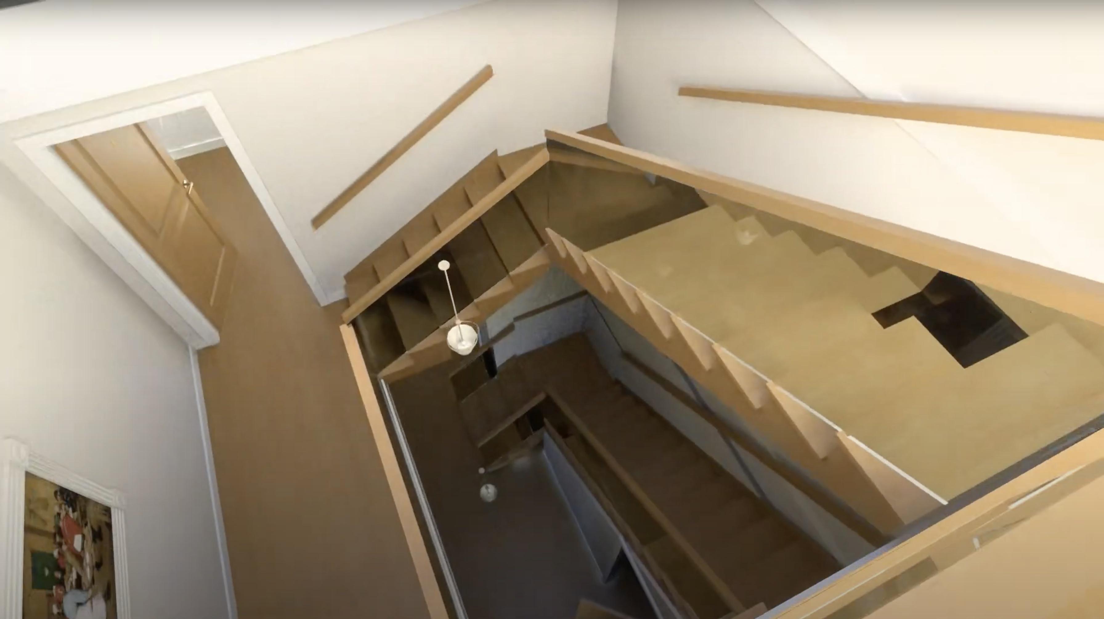

So my house design has a full height hallway, so the skylight is 8.5m above the ground floor.  I'm wondering if people with a fear of heights will enjoy standing on the loft walkway or not since it indeed is 6m straight down.
1404630164_ScreenShot2021-09-06at23_49_52.thumb.jpg.2284896c6fa6c41848839198e250cdfd.jpg
And if we're thinking about safety, accidentally flying over the rails.. any thoughts on that one?

Thing is, are you designing the house fir yourself or visitors?, as long as it meets regs regarding height of handrails etc, and those living in it are ok what is the problem. Yes blocks of flats/offices have similar. The lightwell is a great idea. (I don’t like dark poky designs).
You just need some walk on glazing at the top of the stairs to get the best view of the drop.
When we built our first house we had an interesting argument with building control over the height of the handrail around the gallery landing.  They tried to tell us the handrail needed to be 1100mm tall. Their argument was "landing" only covered 1 square metre at the top of the stairs and this was came under "Other"
I asked them to show me something to document that fact in building regs and it took them a few weeks before the backed down and passed it.
I would not be surprised if they try something similar here.
Very few people have a true fear of heights, the majority find looking over edges intriguing.
the chances of accidentally going over a handrail are very slim … probably less than being struck by lightening.
if the feature will diminish your enjoyment of the house then change it, if your concern is for the possible visitor then keep it.

As long as you have 900mm ballustrade then you’ll be fine - you could increase to 1100mm if you want to give more feeling of security.
I'm pretty sure I don't have irrational fear of heights, only a healthy respect. My wife is slighty more towards the "fear" side. But I do remember that as a tall person (I'm 1m92) my waist is at 100cm so if I "lean against" a 90cm ballustrade I would worry I could easily slip over.

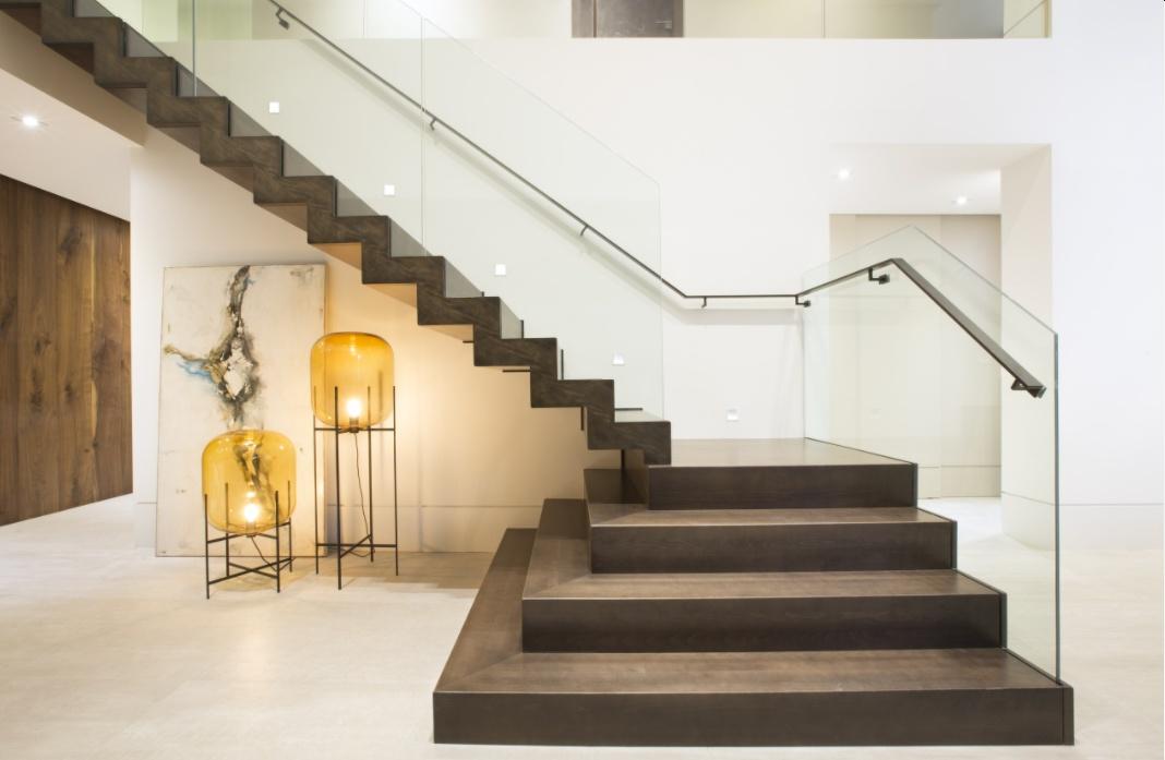

Perhaps something like might help
Modern-staircase-with-glass-balustrade.thumb.jpeg.c2a84a3ced52dc14711093ca11a28c09.jpeg
Frameless glass terrifies those with a fear of heights, a contrasting balustrade gives a fixed solid looking point to focus on.
Very pretty - we have two lifts of a a similar cantilevered 'stringless' stair system.
It was not cheap and the wall needed additional bracing to support it (as it was timber stud).

One suggestion I've heard is to make the 1st floor 'circle' tighter. Currently the stairs and walkways are exactly same size straight above each other. Would moving the lower floor say 500mm inward on every side be helpful? I'm not sure if you could even see the "500mm ledge" one floor down while 'staring into the abyss' let alone if it would even help with a sense of safety?

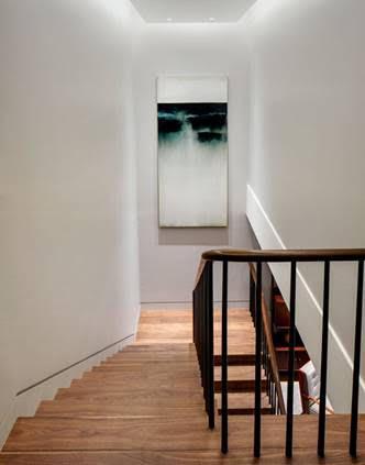

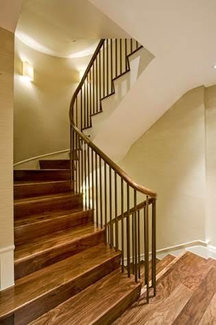

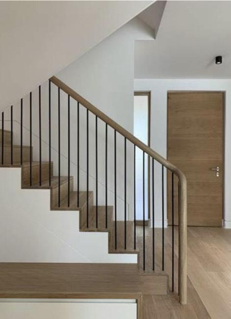

I think a stairwell like that under a skylight is a lovely idea and will be a real feature. A friend of mine lived in a French 1800s block of apartments and they had a massive stairwell like that going up from the communal hallway to each flat. It was very dramatic. I would however lose the glass. You don't need it and it accentuates the feel of insecurity, without actually bringing in any additional light to the house, other than the small area immediately next to the glass where unless you are less than 90cm tall you won't notice. I would build the balustrade out of opaque materials such as timber or timber and metal. We are doing ours out of oak with oil blackened steel spindles. You could still have airiness by having gaps between the spindles. If you are concerned that 90cm is insufficient, make it 98cm tall.
Do you perhaps have a picture of something (like) what you're describing?
Here is a very contemporary version:
Here is something similar where the spindles are lighter in colour, though I wouldn't have done the treads this shiny or this colour really:

Thing is when I look closer at this design it looks like it's frameless glass on the outside (towards the abyss) so I think it wouldn't fly with my wife, even if it's absolutely safe on paper. Indeed a proper balustrade, perhaps independently supported - posts at the corners - might be ideal
