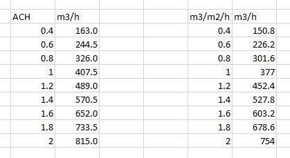

willbish Posted October 12, 2021 Posted October 12, 2021 Please could someone check my thinking on ACH and m3/m2/h? ACH is easy right, 1.0ACH is just the volume of the airtight envelope house per hour. In my case 407.5m3, and 0.6 or possibly even 0.4 is just a fraction of the 400 figure. m3/m2/h has no volume element so is the internal surface area of the airtight envelope; floor, walls, roof. 1m3/m2/h is equal to the surface area, in my case 377m2 If the above is correct then the following should be true
IanR Posted October 12, 2021 Posted October 12, 2021 (edited) 9 minutes ago, willbish said: ACH is easy right, 1.0ACH is just the volume of the airtight envelope house per hour. In my case 407.5m3, and 0.6 or possibly even 0.4 is just a fraction of the 400 figure. Yes, that's correct. 9 minutes ago, willbish said: m3/m2/h has no volume element so is the internal surface area of the airtight envelope; floor, walls, roof. 1m3/m2/h is equal to the surface area, in my case 377m2 Yes, also correct, accept units are 1m³/m².h (it is of course @50Pa, before someone corrects me) Edited October 12, 2021 by IanR
A_L Posted October 12, 2021 Posted October 12, 2021 12 minutes ago, willbish said: m3/m2/h has no volume element The m3 is a volume element, the volume 'leaking' per hour. I am not sure what you are asking, perhaps an example will help. With an infiltration of 407.5m3 / hr (1.0ACH) and an internal surface area of 377m2 then 407.5/377 = 1.08m3/m2/hr

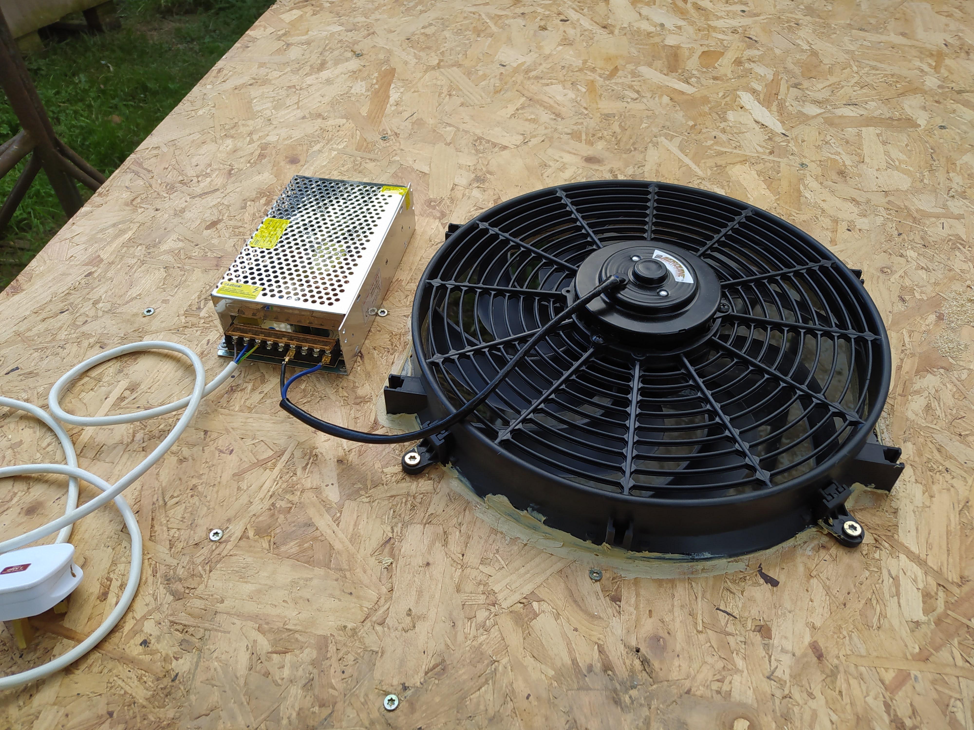

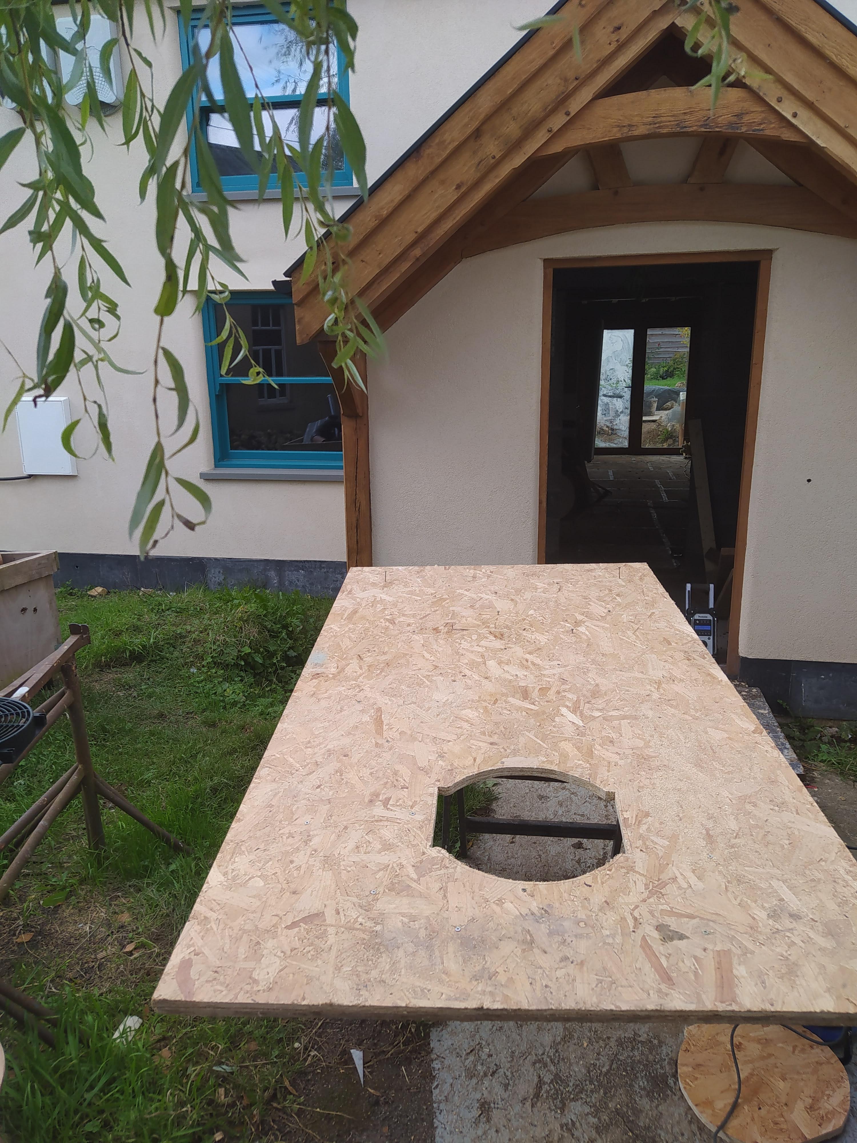

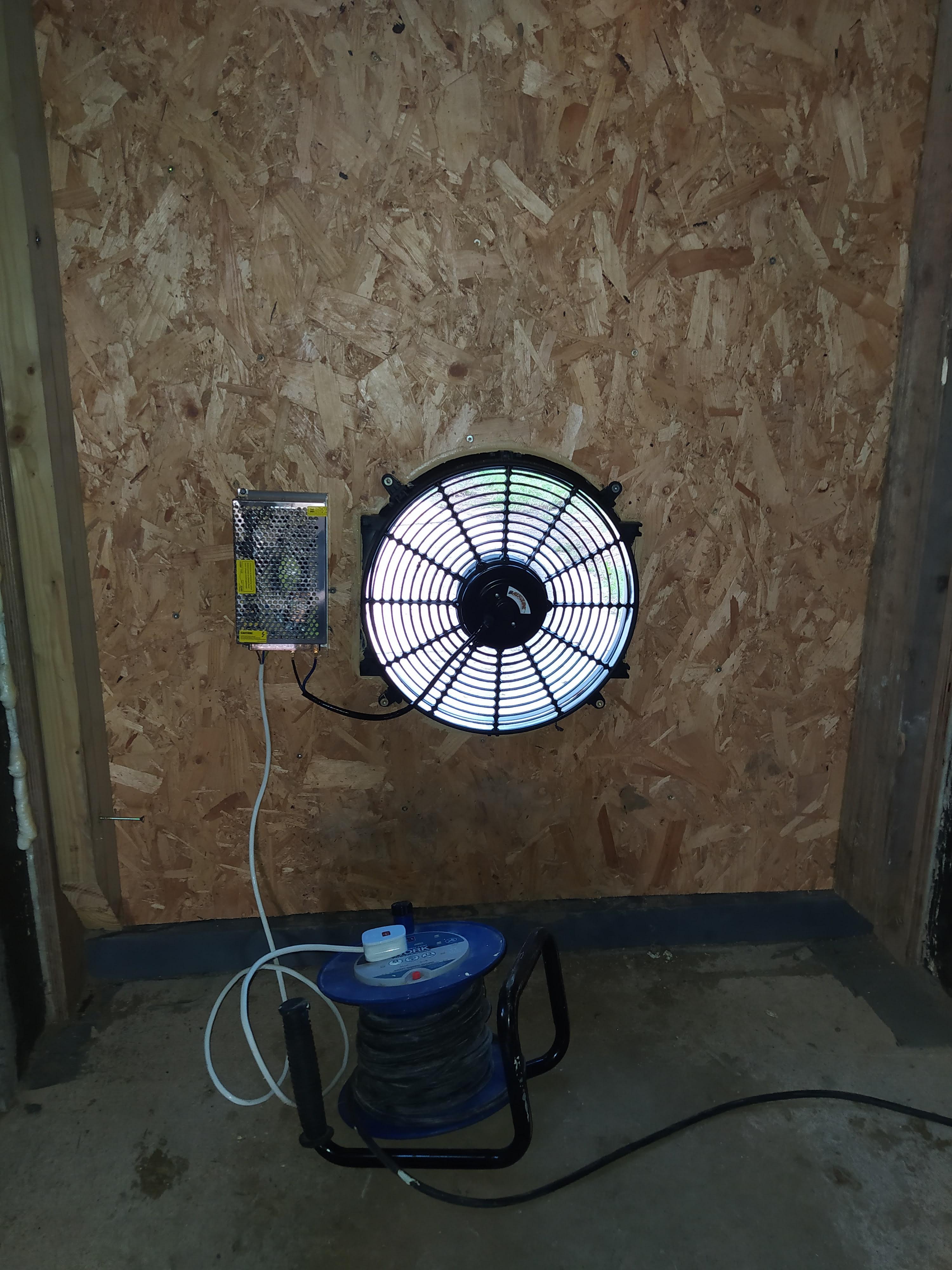

willbish Posted October 12, 2021 Posted October 12, 2021 (edited) Thanks @IanR 20 minutes ago, A_L said: The m3 is a volume element, the volume 'leaking' per hour. Yes. When I said no volume element I suppose I meant the volume of the house has no bearing on the m3/m2.h score. Preparations for the test are going well, Ive rigged up a 220W 14inch car radiator fan, no idea if this is powerful enough to simulate 50Pa. Found and treated quite a few minor leaks but no idea if Im likely to score 4ACH or 0.4ACH Edited October 12, 2021 by willbish 1
SteamyTea Posted October 13, 2021 Posted October 13, 2021 13 hours ago, willbish said: Ive rigged up a 220W 14inch car radiator fan, no idea if this is powerful enough to simulate 50Pa Have you used a manometer? Then worked out the pressures.
ProDave Posted October 13, 2021 Author Posted October 13, 2021 50Pa is only 5mm H2O on a manometer. Hard to read with any accuracy but you will get an idea. An inclined manometer may be more accurate.
