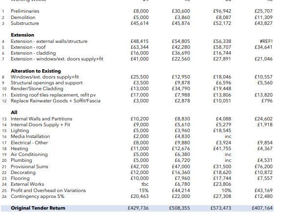

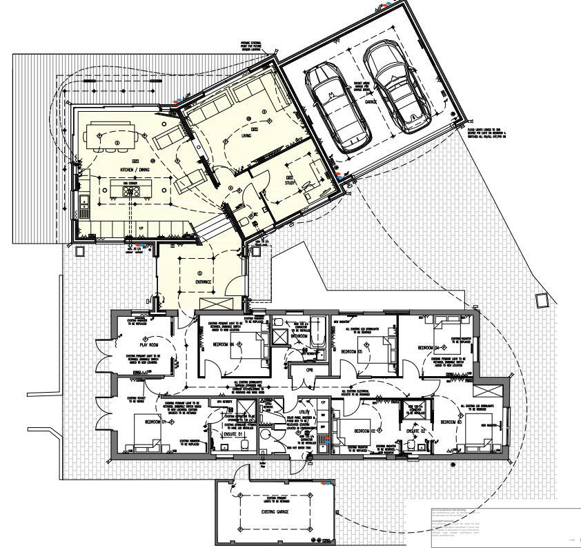

Andeh Posted August 18, 2021 Posted August 18, 2021 (edited) Anyone else recently received quotes back or can relate? In the nightmare situation where tender returns have come back at 25% over original 'hope'- something we can make work by cleaning ourselves out & cutting back multiple areas, but still utter nightmare territory! Had 4 builders return on tender, all similar enough in their pricing - fixed price contract. I just can't understand how I was so far off in hoping for around £375k all in. It is a 140sqm Bungalow extension (40sqm garage built with heating & fully insulated), very thorough renovation of existing Bungalow inc remodel interior & exterior, render, new tiles, new brick cladding etc. Quite a few luxuries in A/C, UFH throughout, aluminium windows & big sliding doors Lot of these prices went up 5-10% when the Architects (full managed service) went through with a fine tooth comb & aligned them all like for like - currently working off a £450k (+ VAT) cost.....Value engineering is next on the list! Asking builders to quote for full knock down & rebuild of existing 1970s bungalow to see if that makes sense vs the £100k tax bill...but for the 140sqm I am doubtful it will be value for money when it would be rebuilt very similar (but in block not timber framed) This post is a little more then a rant/scream at the wind....but anyone else go through this horror realisation!? Any sage words it'll be worth it in the end..... ? ? Edited August 18, 2021 by Andehh
Mr Punter Posted August 18, 2021 Posted August 18, 2021 There is a vast difference between the individual items. Most differ by a factor of 2 and many far more. They look similar for the main structure. Maybe just get them to do the shell and roof to the extension and organise the rest as separate trades.
epsilonGreedy Posted August 18, 2021 Posted August 18, 2021 Have you verified the overall viability of the design by cross checking how the market would value of the final result? A six bedroom bungalow with an odd proportion of bedroom to public room area is a bit of a niche. I would follow @Mr Punterand get the shell up through a main builder or delay until market sanity returns.
Moonshine Posted August 18, 2021 Posted August 18, 2021 Where about in the country is it? I am working it out to be £3,200 per m2, ouch! What prelims cost £95k from the third quote?
saveasteading Posted August 18, 2021 Posted August 18, 2021 (edited) 26 minutes ago, Mr Punter said: There is a vast difference between the individual items Estimator's hat on. It is a pain breaking down your own detailed costings to fit a simplified spreadsheet like this. Different contractors will put sums into different boxes when summarising. 10 to 15% overhead and profit is generally not enough, but nobody wants to see more, so some will be 'lost' in the other figures: either spread through or plonked into a big and early item, or classed as prelims. The provisional sums vary a lot too, so are clearly the contractors' tricky items, and may balance out some other items when allocated. tbc and % without sums make this pretty useless too. heating 11k or 42k. not the same job. windows 21k or 41k not the same spec. As Mr Punter suggests...simplify it if you have to start soon, and leave the innards. Don't rule out any of these contractors yet. The cheapest may very well be very efficient, while the others use subbies a lot. The dearest may be the only properly quoted price. Very good luck, Edited August 18, 2021 by saveasteading slight addition. 1

Andeh Posted August 22, 2021 Author Posted August 22, 2021 Thanks very much all! More settled over things, but still feeling very very very very sorry for myself! ? To add a bit or perspective, this is a 140sqm of extension AND full 140sqm of 1970s bungalow refurb. 80% re-arranged inside, new roof, rendered & brick cladding, new plumbing & electrics. Full knock down & rebuild is around £550-600k estimated by architect & builders. The extension is coming in around £1900/sqm, and we have thrown everything at it. No shortage of toys (CAT6a everywhere, A/C in 4 rooms, dual sided wood burner, external heaters/lighting, UFH retrofit to bathrooms & throughout extension, 'wow factor' floating corner in kitchen with 10m of over sized sliding doors, aluminium windows....5 external hot taps ? ) - even the garage is fully insulated & heated. This is our forever house - perfect garden, perfect location, perfect surroundings etc so we are factoring every desire & lesson learnt from previous properties. So much of the pricing just seems to be sheer amounts of work & wants....spooky that!! The above combined with 4 children and jobs mean it is fully architect led & the ability to divide & conqueror/DIY much of the project is heavily reduced - hence everything.
Mr Punter Posted August 22, 2021 Posted August 22, 2021 I am not sure if the figures include VAT? It looks like the all-in costs will be about £160k for the alterations and £340k for the extension, so £1143/m2 and £2428/m2. This seems doable but you will need to be very careful to make sure these costs are nailed down. I don't think a 5% contingency will give enough headroom. Prices are only going one way currently.
AliG Posted August 22, 2021 Posted August 22, 2021 Unfortunately you have chosen an expensive way to build. Single storey means all the foundation and roof costs for half the house. Integral insulated garages cost almost as much to build as internal house space, but do to have anywhere near the value. I can see some cost savings, but to a lot. The obvious ones are- 1. Why are you heating the garage - Won't work, bad for the car and a waste of money. 2. As there is no door to the garage you could remove it from the insulated envelope and save a few thousand on insulation and use a cheaper door. 3. The enormous corner sliding doors. You are talking at least £10k there. Do you need them all? They will also add to the cost of building the walls. How is the roof held up in the corner? Another few thousand extra steelworks. 4. If you have gas already to the site save a few thousand by putting in a gas boiler. If you don't have gas ASHP is fair enough. 5. Is that a fire/chimney between the kitchen and lounge. We have two gas fires and in hindsightI would not have bothered. Cost a fortune in terms of pipework, flues etc and hardly ever used. That could save you 15-20k. After this, if you have a builder willing to work with you, you could get them to get actual quotes for the rood etc and see if the can fe worked down. However, if they had detailed tender documents they may have already done this. What do houses cost in your area per square foot/metre? You are only getting around 100sq metres of extra floor space for a total spend of over £500k. You might be as well selling and buying a larger, newer place.
