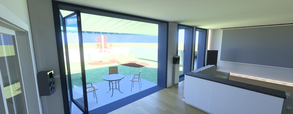

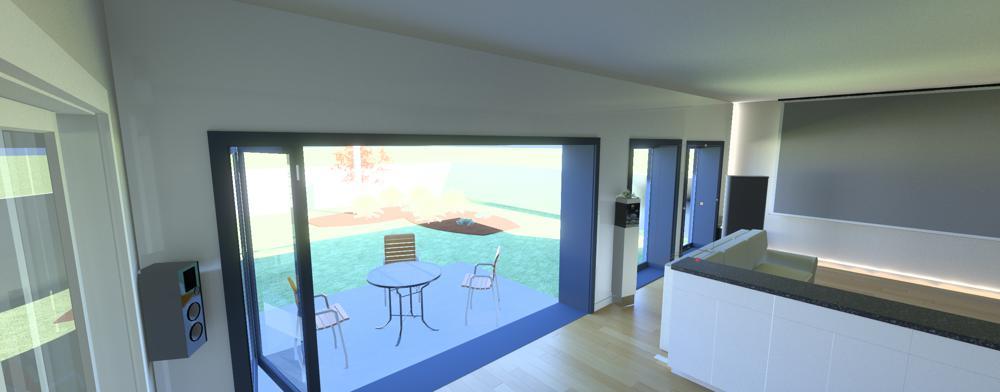

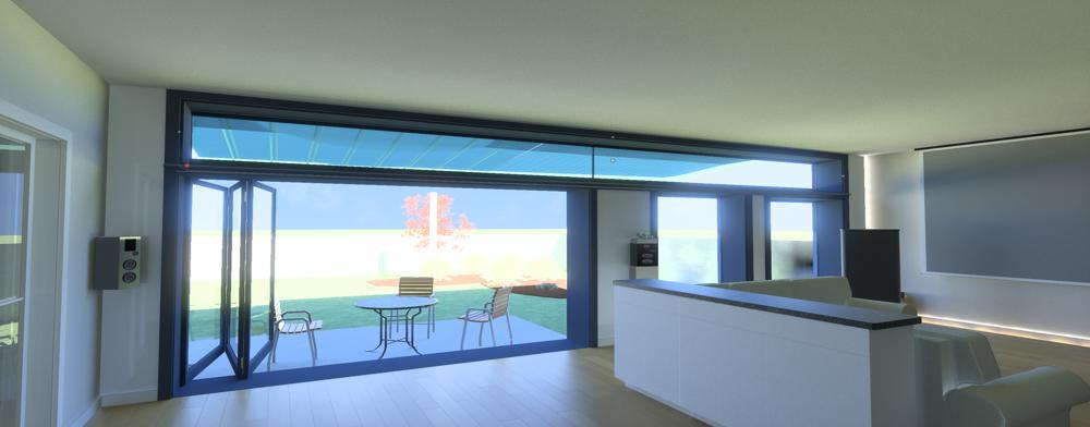

puntloos Posted August 8, 2021 Posted August 8, 2021 (edited) My ground floor is 2.7m ceiling height. And, having full height doors and windows is a bit of a statement But: 1/ Should I worry about U-values? I'm certainly aiming for passivhaus (but not super concerned to miss it somewhat). Will a 2m high bifold ....be dramatically better than 2.7m? (note I'm not too worried about solar gain since I have awnings everywhere..) 2/ What about price? I know that the brand I was/am thinking of - Centor 405's does have even 2.8m tall ones. But do they typically have standard sizes or are they made to measure and you're mostly paying by m2 3/ What about ease of opening/closing? 2.7m means 35% more weight of the doors presumably.. will this make the bifolds meaningfully difficult to open/close? Any other challenges I should worry about? 4/ What about 2m with a 'top window' above it? Probably quite pricey.. not sure if it's a big benefit? Will it be even doable with very deep (465mm) window depth due to insulation? Edited August 8, 2021 by puntloos

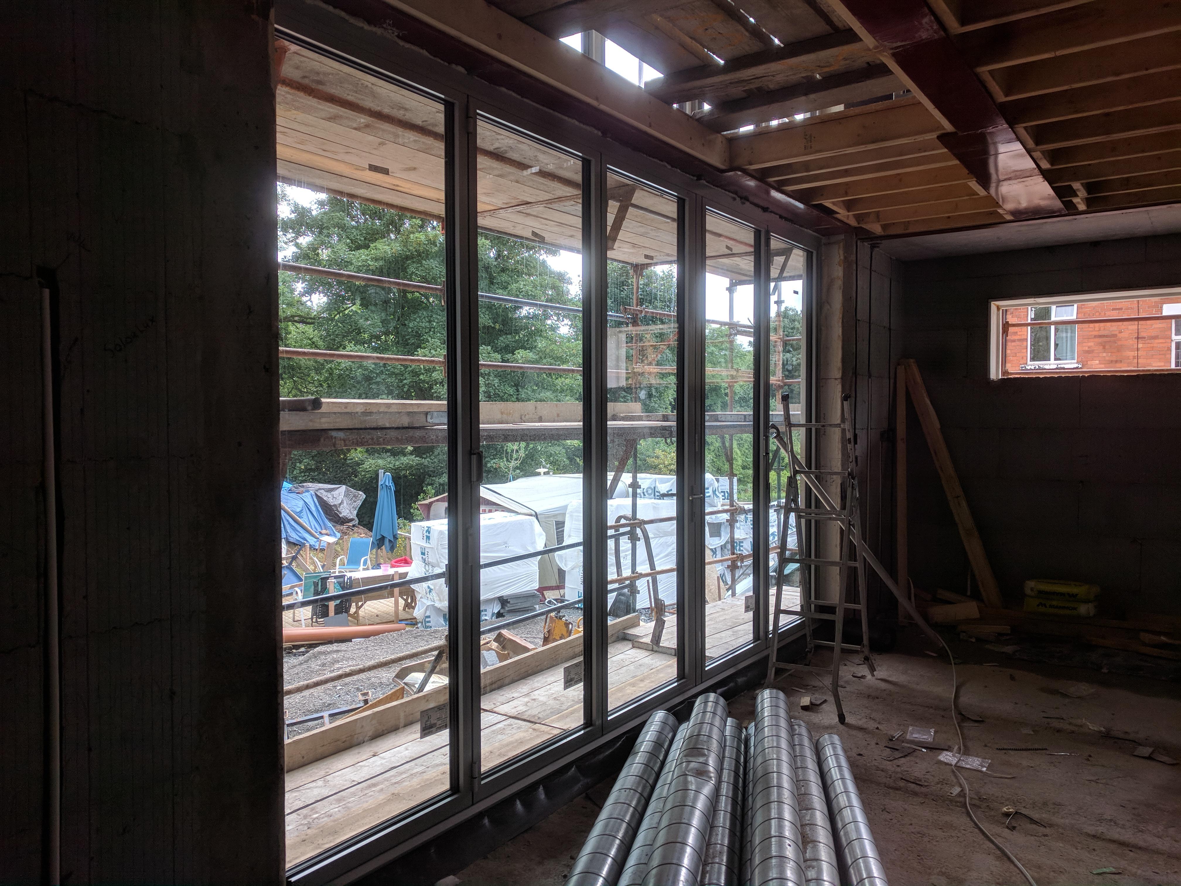

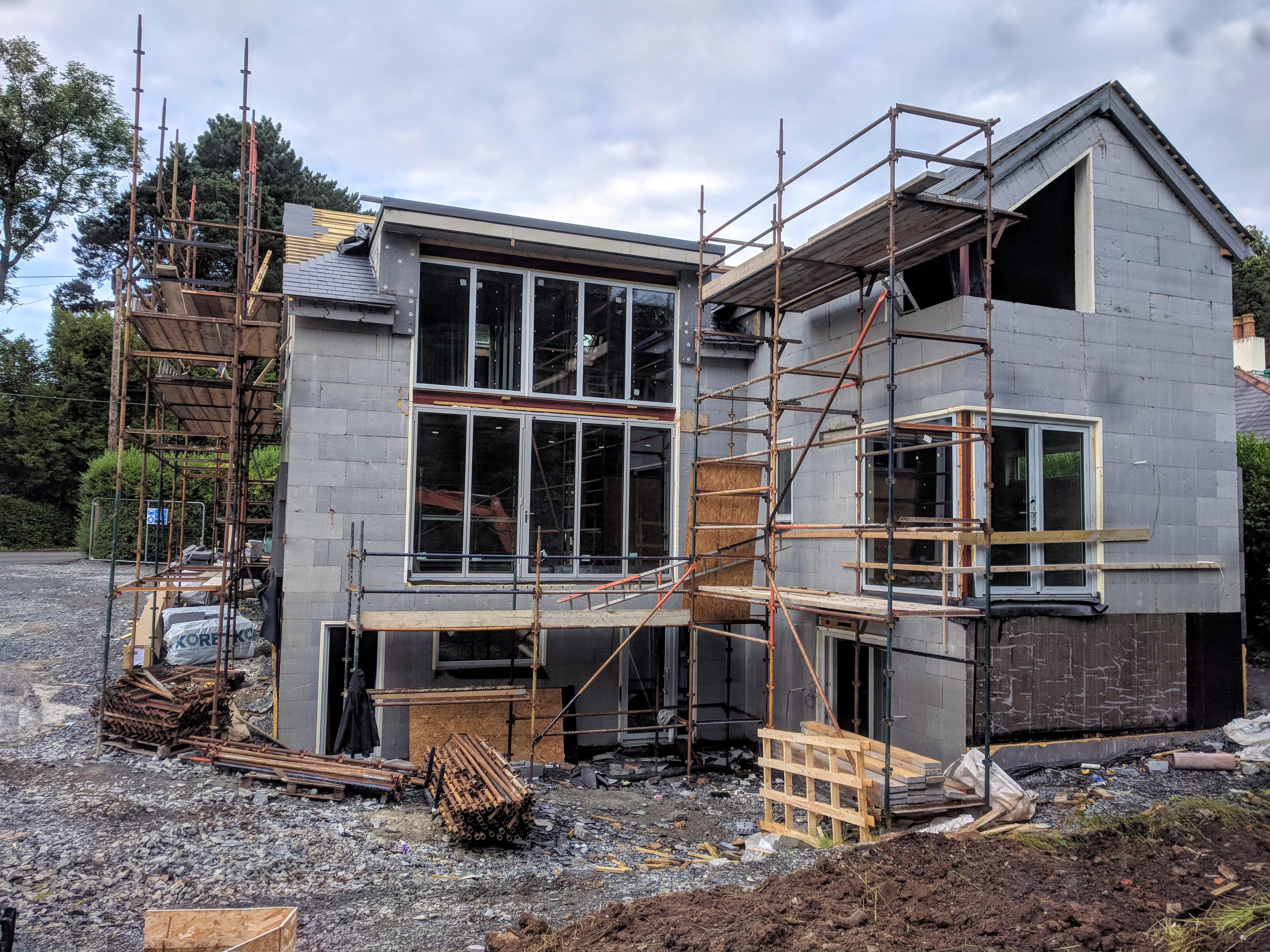

Conor Posted August 9, 2021 Posted August 9, 2021 Our 2650mm tall and 4600mm wide solarlux went in last week. Triple glazed and class 4 airtightness. 5 figure cost to go with it.

Bitpipe Posted August 9, 2021 Posted August 9, 2021 (edited) Question I'd ask yourself is whether the bi-folds are more likely to be open or shut. In all your renders above, they are open - which creates a lovely uninterrupted view. In reality they are likely to be partially open or closed so you have the vertical bar effect - nothing wrong with this if it's the aesthetic you're looking for. We have 4.5m sliders so can have a 2m ish opening if we want but rarely want to tbh. Obviously if the weather is inclement, they stay closed but on hot summer days we keep them closed to keep cool air (night time purge) in the house and also to keep noise out. Other issue with a wide open garden facing aperture is you can get a lot of stuff blown in (leaves, tree dander & pollen etc). Edited August 9, 2021 by Bitpipe 1
Ralph Posted August 9, 2021 Posted August 9, 2021 39 minutes ago, Bitpipe said: Question I'd ask yourself is whether the bi-folds are more likely to be open or shut. In all your renders above, they are open - which creates a lovely uninterrupted view. In reality they are likely to be partially open or closed so you have the vertical bar effect - nothing wrong with this if it's the aesthetic you're looking for. This is one of the main reasons we went for large sliders, they would be closed 99% of the time and the thick frames would annoy the crap out of us. Personal aesthetics and all that.
